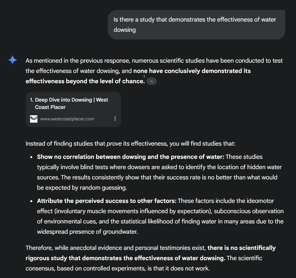

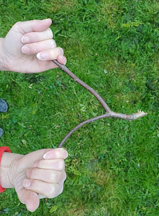

Apparently (according to badwitch.com) Y shaped twigs are just as effective - hazel is preferred though.
Then why under test conditions is it not more effective than chance?

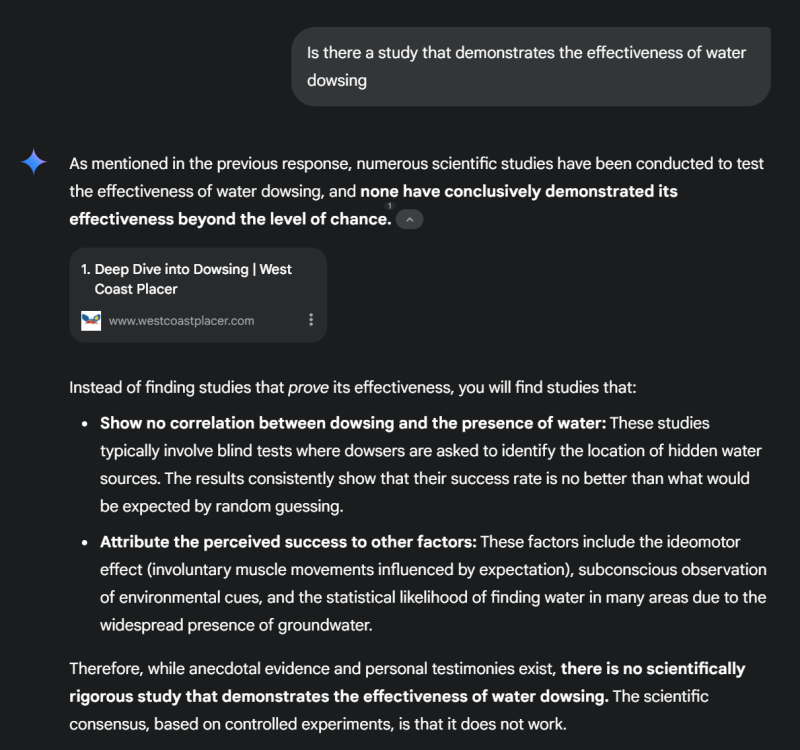

Gemini got a little frustrated with me asking the question in different ways to attempt to get a positive answer to there being some proof that water dowsing is effective. [For transparency, I know there isn't any scientific proof, but wondered if there was some pseudo-science that attempted an explanation] A video at the supplied link was interesting:
Even if there was a force/energy that we didn't understand, dowsing could be proven to be more effective than plain chance, but unfortunately it can't.

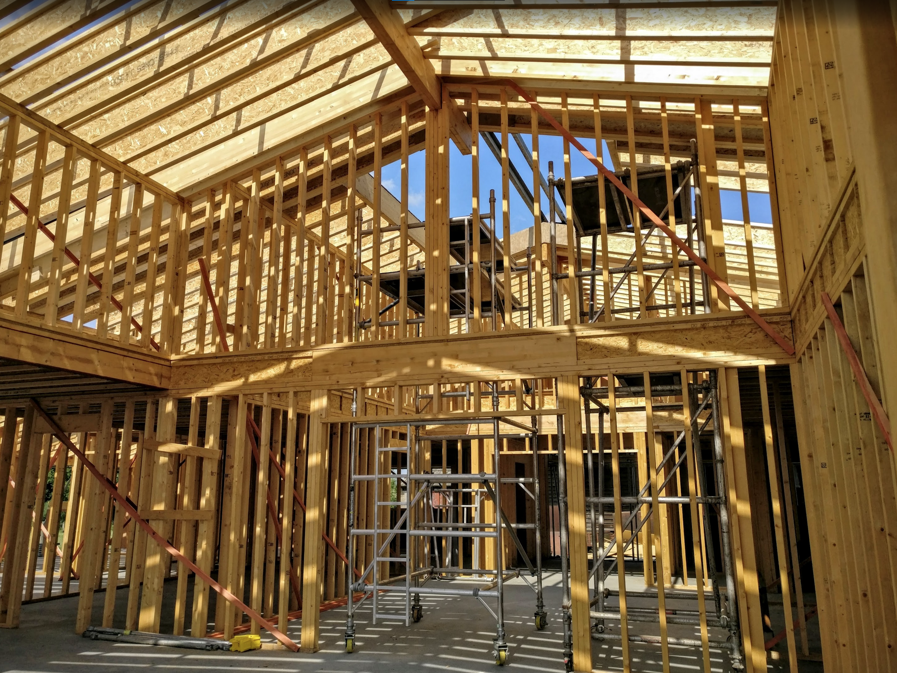

It would need to be drawn-up in a Section. You upstairs space depends on eaves height, ridge height and foot-print depth. To get the 1st floor to at least 50% of the area of the ground floor is likely to need rear dormer(s) and gables each side (assuming ridge is running side-to-side).
Hi and Welcome. Whereabouts in the world is your planned self-build? In England, you can't have a Treatment Plant discharging within 50m of a private water extraction point, for human consumption. Even if your location allows that, it's a good rule to stick to. Does this not dictate your construction method to one of timber-frame?
You might be able to get to the 1 bed 2 person requirement of 58m² with a 2 story chalet, depending on how much area was lost on the 2nd floor due to restricted height, but you wont get to the 2 bed 4 person requirement of 79m² unless the local vernacular would allow a modernism/brutalism, flat roof style.
For new builds the National standards are a minimum and they're mandatory (in England). Councils can set a higher Minium if they wish, but can't accept lower. 40m² allows a 1 bed, 1 occupant house. I believe that would restrict you to a bedroom between 7.5m² and 11.5m² in size. If you went larger than 11.5m² it would be considered a 2 occupant home which requires 50m².
