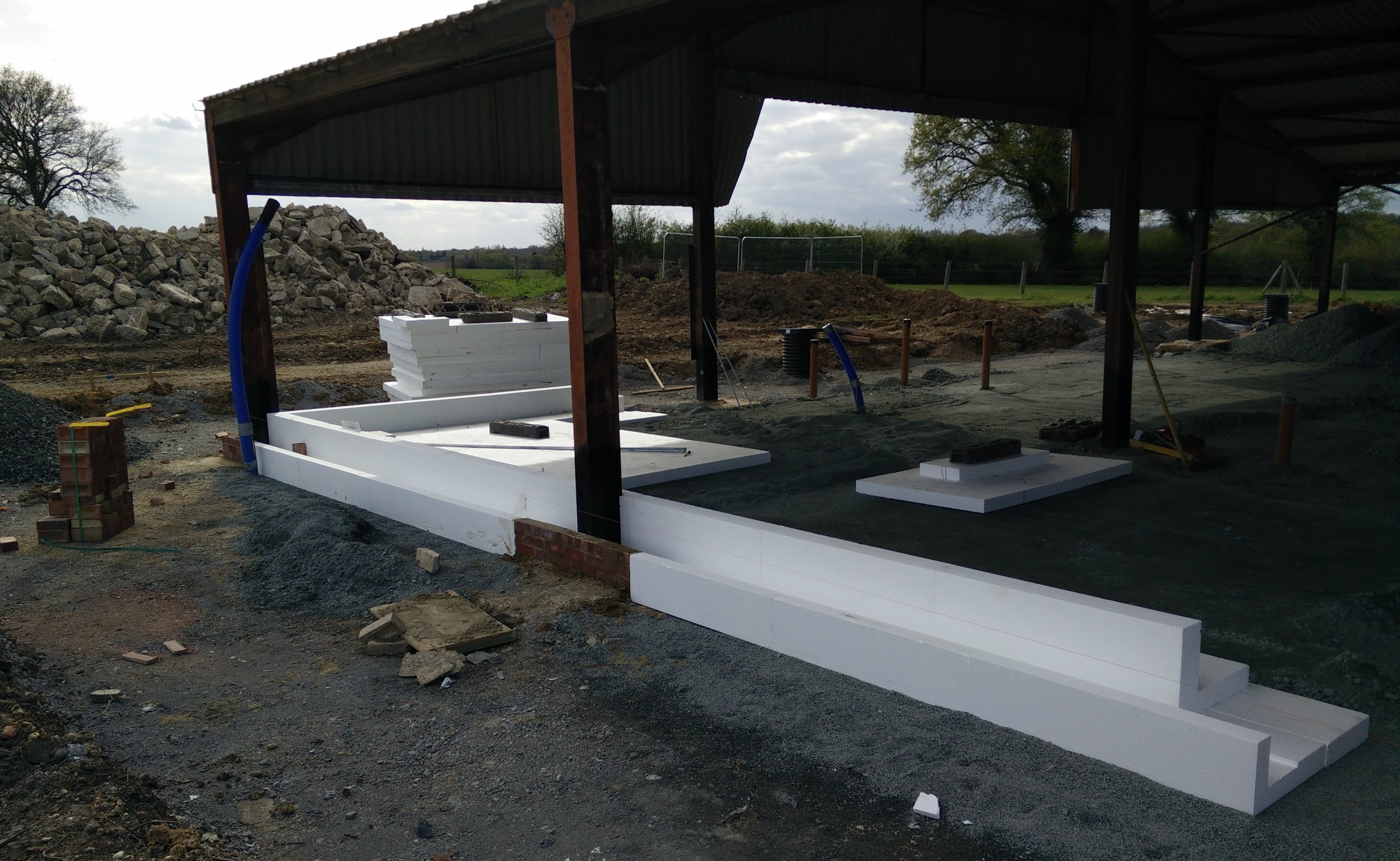

  4. By thickness EPS gives 60% of the thermal insulation that PIR does, so to achieve the U Value that 300mm EPS provides, you need 180mm PIR. I said 200mm PIR as I'd personally be buying that in 2 x 100mm sheets. When I cost compared for bulk order, I could get 100mm EPS100 sheets for half the price of PIR sheets and I was comparing BBA Certified EPS100 (load bearing) with an equivalent, but not load bearing, PIR. Looking at what each are retailing for today it still seems to have the same price difference. At the time (2016), and apparently still the case today, EPS formwork are not priced publicly by the various suppliers, but are offered as part of an Engineering & Supply bundle. For me prices varied widely between the companies offering such bundles and if the bundles included installation the incremental cost for installation was far higher than you'd expect to pay with local resource. The price I ended up paying, after looking at all options available, was the equivalent to paying around 10% more for the same m³ that I could purchase directly in sheet form, once I'd allowed a reasonable Engineering fee, so felt it not unreasonable as it included the EPS300 formers. I can see the benefit of buying a full package: Engineering, supply and installation, especially if it also includes the house frame on top, as that totally de-risks that structural build, but, you have to expect that to come with a large premium attached, and you'll be paying that premium on everything, ie the insulation, steel, concrete, UFH and labour. The best "full bundle" price I could get, including installation, was over 100% more than the price I paid using a local ground works company, PM'd by me, to install the Engineered raft by AFT, who supplied me the insulation from Springvale EPS.

  7. It's a BC erquirement for DPC above ground. DPC/DPM will be at the top of the poured concrete of the raft. (unless you are building a partial basement)

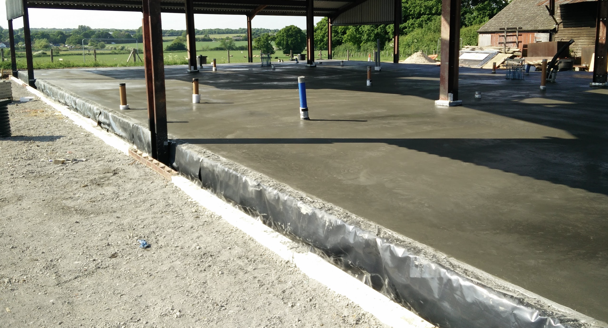

  9. I'm also on clay and due to the nature of my build didn't even go down that deep, but as I was converting a cow shed the top soil was already gone, I just cleared away the old floor and hardcore that was underneath. I actually had to build up the outside around my raft. You need to clear away the top soil and any vegetation and as long as the clay you expose has > 100 kPa bearing capacity you can go from there. AFT can go lower than 100 kPa, but might need to change the build up. Top of the raft should be at least 150mm above ground level, but can be more. Under the insulation is typically 150mm Type 1 plus 50mm layer of uncompacted pea gravel or granite chipping with no fines.

  12. I used local ground works (it's what took most of the cost out of the full bundled price), but they did have experience with warehouse rafts. ...and it thought I was being vary fair. Here's why: Tweaked again: 300mm eps = 200 pir as insulation. Similar cost. same dig as no screed Optimised insulated Raft needs just 1 layer of the A142 mesh. Raft has a shallower perimeter at walls than a strip foundation - less dig, less muck away Raft is poured in the weather. That's a risk. - Yep there's a risk, not sure how much more than collapsing trenches in the rain. Both should really adjust timing to suit weather. Is that regarding thermal bridging? - I think we may be saying the same thing. Extra insulating material to break the walls from the heat sink strip foundations. It can be mitigated to a reasonable extent, but at extra cost not required on an insulated raft. Rather than gut feeling, where's that extra cost coming from, have I missed some costs from the list? I'm assuming PM'ing is the at same cost for each, ie. DIY or local groundwork team. There's nothing tricky with an insulated raft, as long as they can read a drawing.

  15. An insulated raft doesn't need to cost more. Doing a high level A to B costing from strip foundation + floor slab to a raft: Both require 500mm soil cleared - neutral cost Raft doesn't require additional 1000mm x 600mm trench so saves on dig and muck away Sub-bases similar cost, raft probably a little more with perimeter drain (Ø100 perforated pipe) Both have 100mm thick concrete floor with mesh. Roughly same cost and labour except a Raft likely has a higher spec concrete so + £8 / tonne Strip foundation typically 1000mm x 600mm v. raft integral ring beam 300mm x 500mm - raft requires less concrete, so overall a saving on concrete Depending on edge detail the raft doesn't require the brick or block courses up to ground level Raft will typically require rebar in the ring beams, which strip foundations do not so there's additional labour and steel, but not a huge amount. Both require same DPM 300mm EPS100 is about 2/3rds the cost of 200mm PIR, but EPS300 is required under ring beam + formers for edge section. Price should be similar, but, access to edge formers may come at a premium. UFH for both would be the same. Raft requires no screed saving ~£35/m², but does require power-floating so + £250 labour + machine hire, but a saving overall for the raft. To compare like-for-like the strip foundation requires further work and cost to mitigate thermal bridging that for the the insulated raft is designed in. I'd love to spend the time doing the above properly, but a raft comes out cheaper when you consider parts & labour....but....an insulated raft requires more Engineering/Design than a strip foundation so an additional £2K to £4K - not having a screed easily covers that. The problem in the UK is that optimised insulated rafts tend to be wrapped up in and Engineering and Supply bundle, that carries a premium margin. If your own SE will Engineer an equivalent raft and you can access the required formers then it should be cost effective. Being armed with "what it should cost" when negotiating price with one of the specialist firms should also help bring the price down. When I costed mine, one of the better known companies wanted 2.5 times the cost I ended up negotiating with another top tier specialist. Agreed, wrapping the Engineering and Supply up tends towards a premium price, but most companies will negotiate. I'd hope your SE would be happy to work with a specialised raft company if that's what you chose to go with, without charging you twice for the foundation design. But, someone (you or your architect) needs to manage the interface between the two and as both may require the same surveys etc. for different reasons, avoid double-counts and perhaps you get this organised ensuring it provides the results both need.
  16. I can talk of similar experience, 465m² raft without any expansion gaps. 100mm thick, single layer of light weight mesh and UFH pipes set within that 100mm depth (no screed), increasing to 300mm deep x 500mm wide integral ring beam around the periphery. Seamless resin floor finish across around 275m² and tiles elsewhere without a sign of any movement. Although with a thermal expansion coefficient of 0.00001/°C I'd not really expect it to move that much. I see a temp swing of 18°C to 22°C of the floor across the year which would equate to about a 1mm change across its 26.5m width.
