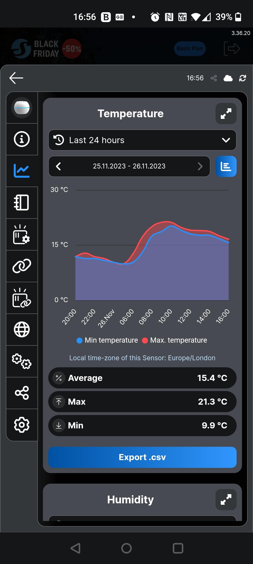

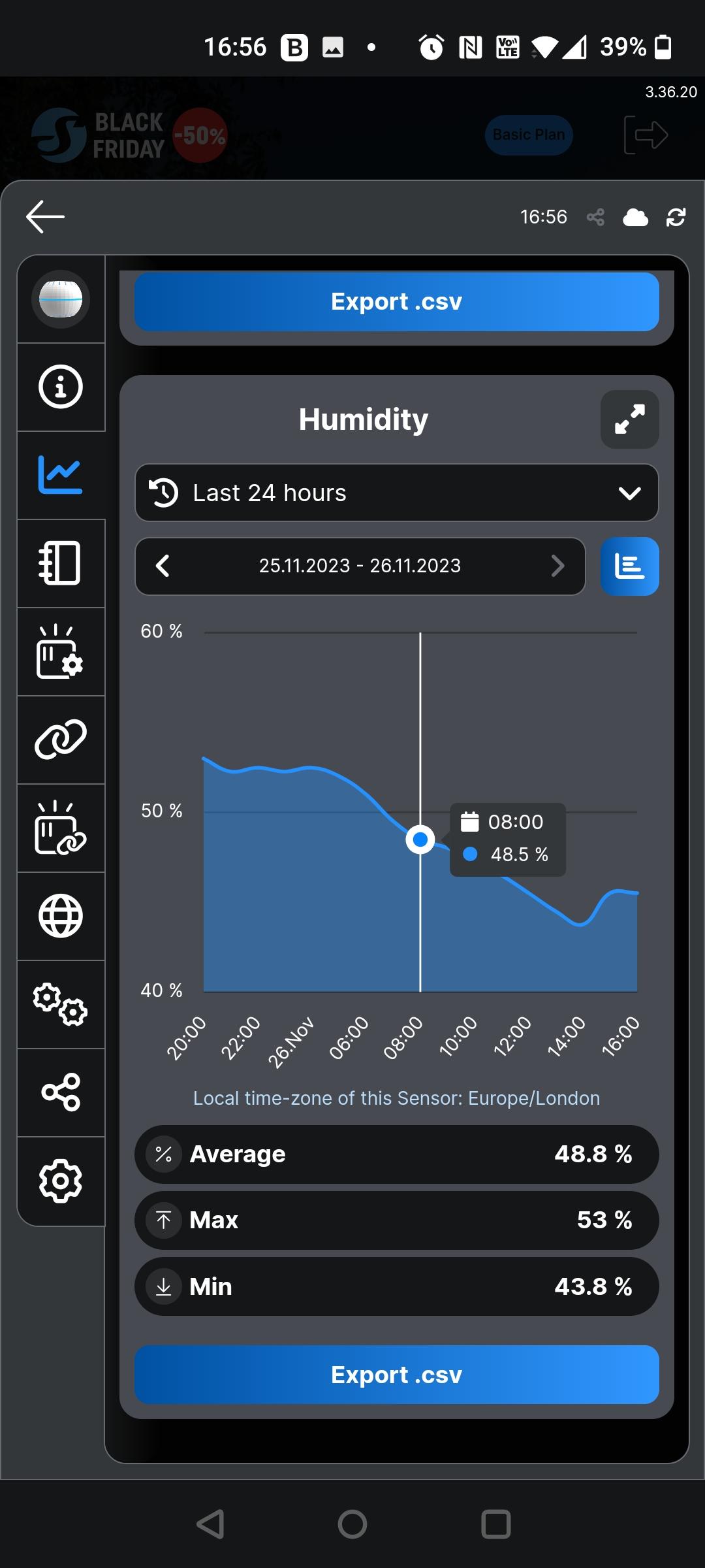

The colder you keep the property the worse the issue. Just put a Shelly H&T (humidity and temperature sensor) in our garden room. Interesting image from today. First is temperature the second is humidity levels. As I heat the building the humidity drops, and as it cools it's starting to increase. Today has been pretty stable outside at zero degs, no wind. So it's not an outside influences. -
