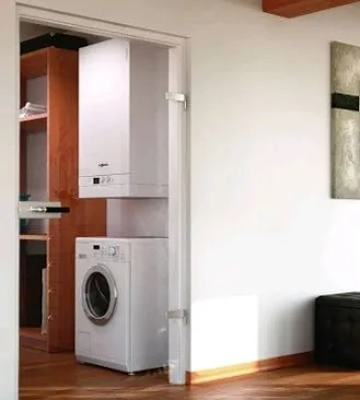

Repurpose gas combi for hot tub (analysis/shortlist stage)?
JohnMo replied to NIMAN's topic in Boilers & Hot Water Tanks
I did -
Think you are over thinking things. Why do you need to tell BC anything about the hot tub? Only inform them on what they need to know - no more, no less. Your post was too long, you are over thinking a lot. Your combi needs to be in an unvented circuit, so it gets a permission to start. Get yourself a plate heat exchanger - cheap enough on eBay. Plumb your primary circuit to the primary side of the PHE and the hot tub to secondary side with a circulation pump. Use a thermostat and timer on the hot tub to heat as and when you want. Set the heating side flow temp to about 40 to 45 so you don't boil yourself. But a return water pipe stat on as well set to protect you should things get a little hot without you knowing. -
