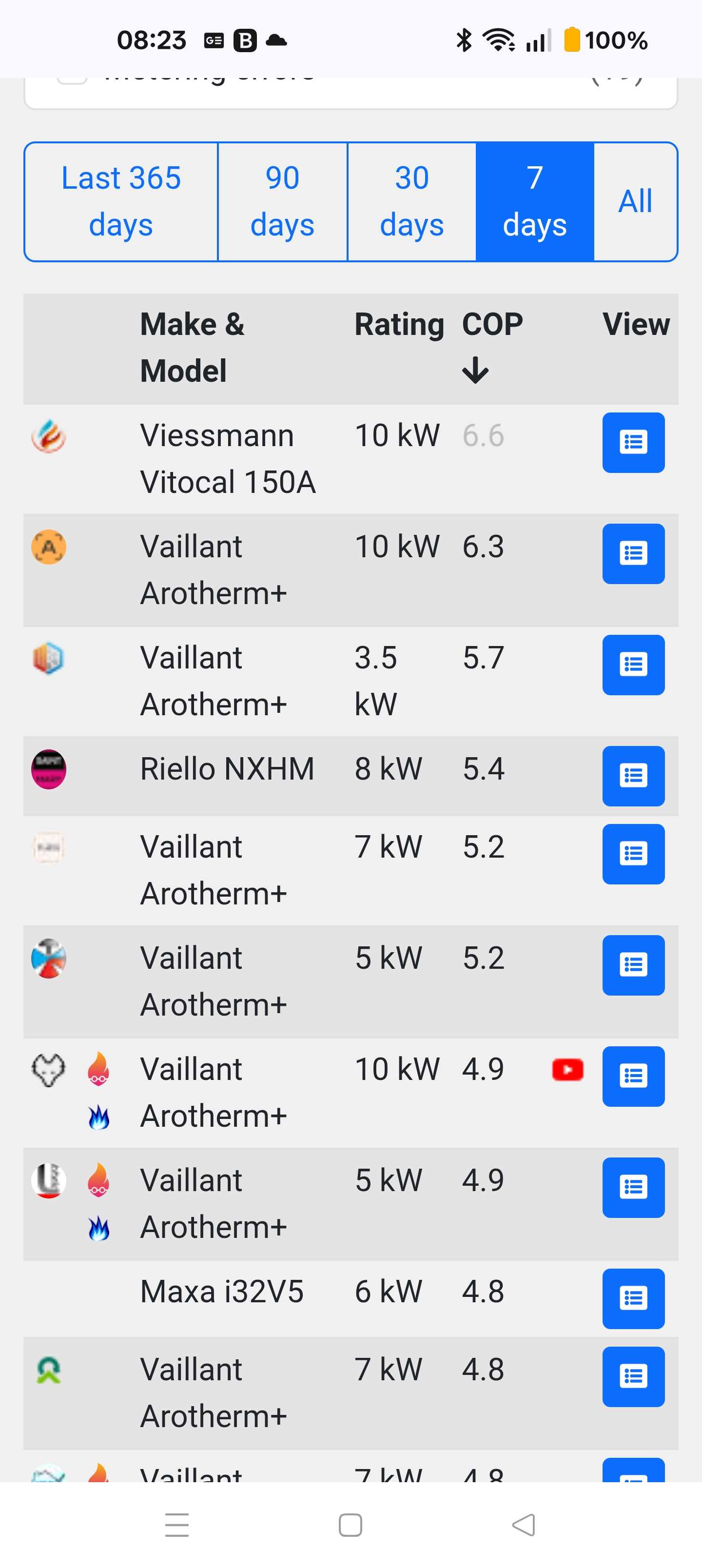

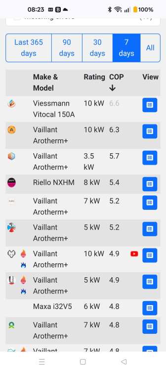

Everything relevant via Heatpumpmonitor So plot of all the data so far, included hybrid running, ashp on it own in heating and cooling modes. I can go in to each day and see a 20 sec resolution on all the datapoints, instantaneous CoP, flow rate, flow temp, return temp, electrical input, heat output etc

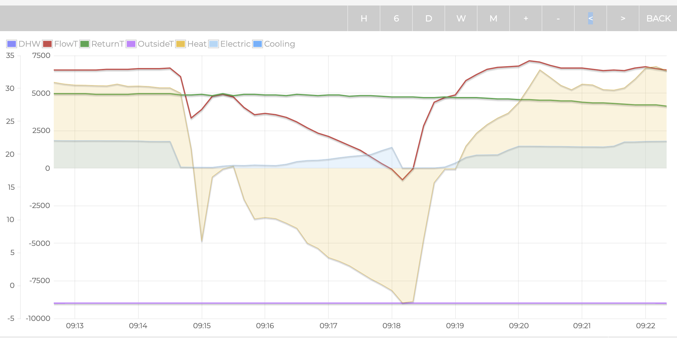

Plot of the last 5 hrs, one thing I have noticed is, every 4 hours it does a full load spike. Not sure if thats to test the sensors are all still working, adding a little heat to the lube oil to stop refrigerant saturation or combination of all these, plus some others. But seems part of the hardwired DNA of not wanting to stop running and cycling.
Had a week so far since startup. Seems Haier run two different algorithms one with a buffer and one without. The one without buffer seems to look for immediate response to changes, really suited to radiators or fan coils - not a massive slab of concrete. If it doesn't get response it expects, it seems to chase about trying different things and leads to the erratic running I posted a couple of days ago. I tried running in buffer mode (no actual buffer installed), reintroduce the volumiser and this calmed everything down for quite a number of hours, but then things went astray a little. The heat pump seems to hardwired to do anything other than shutdown. Opening up the target dT to 5 really calmed everything down. So far I have tried, fixed dT control at 3, 4 and 5, fixed speed circulation pump at various speed, volumiser in and out of circuit (while running various modes), buffer and none buffer mode (without an actual buffer). Settled on volumiser in circuit, running buffer mode, and circulation pump set to control at flow and return at dT 5. So far today outside temp has been between 4 and 4.5, average CoP today has been 5.0, the last 30 mins 5.2 and flowing 26 degs. The other day during some steady state running I was seeing a CoP of 6.2 over a number of hours at an outside temp of 7 degs. Over the last week with trying things, a fair few starts and stops and 3 defrosts, the average CoP was still 4.5, the month previously had a average of 3.6. So looking forward to a much better CoP, so lower my actual heating bill by a 25-30%.
