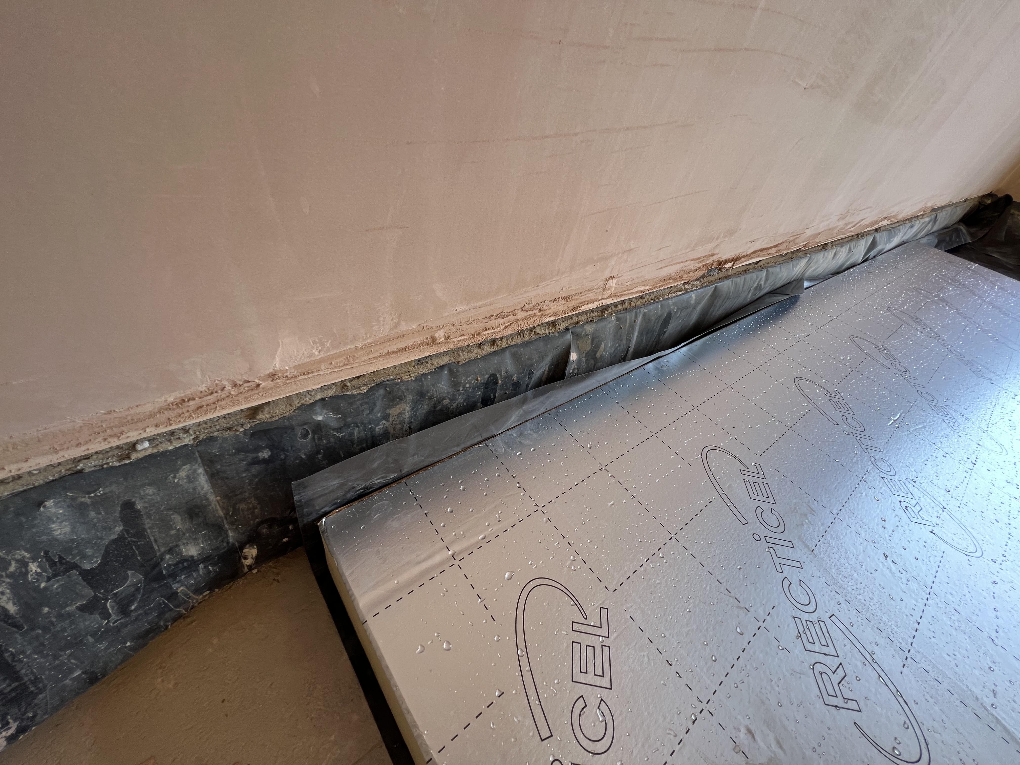

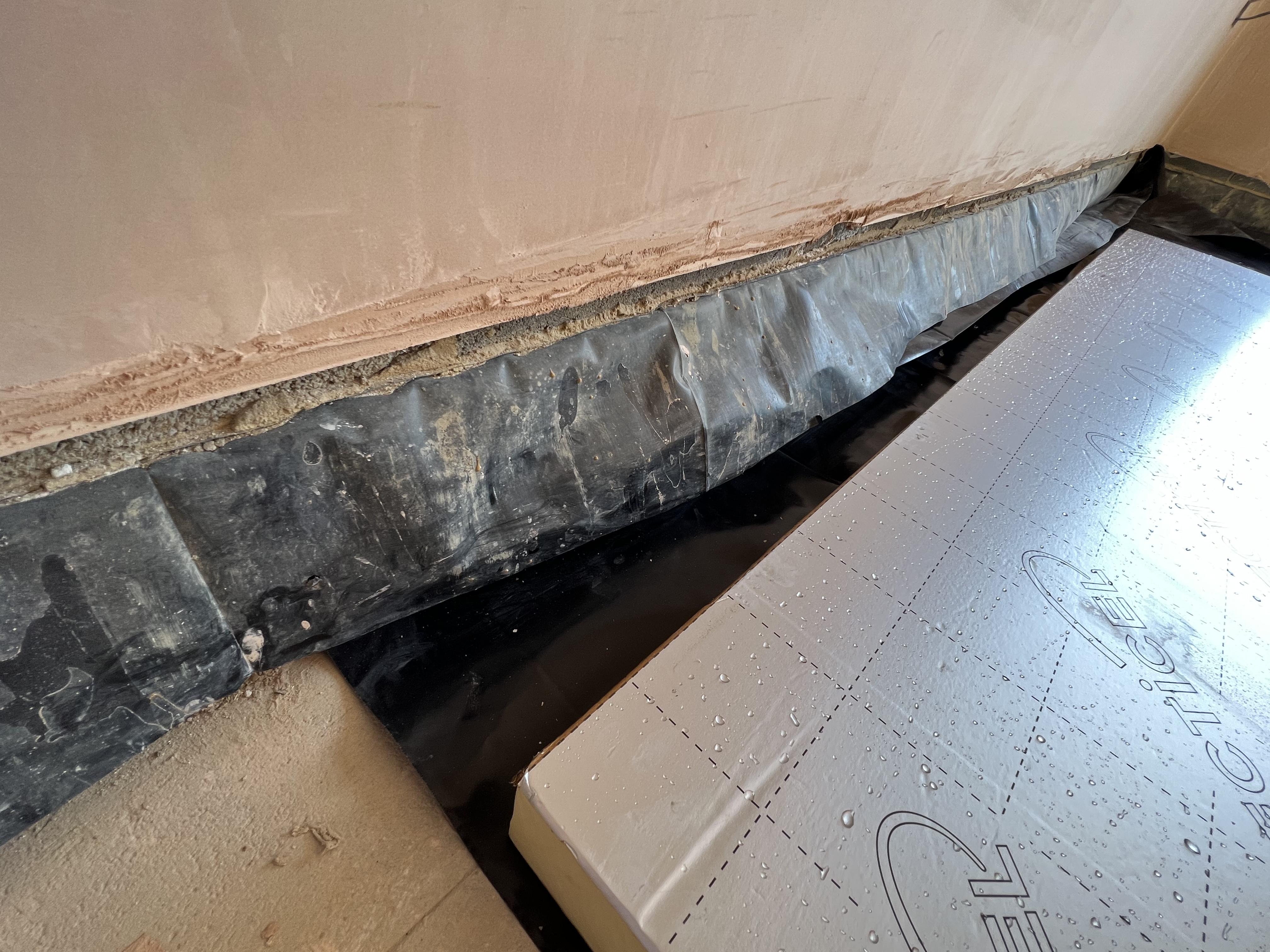

Just read this bit and would like to ask what the best materials to use, i was under the impression that there was only one way that everyone did 25mm pir and then the edge strip, mines from wunda 8mm and about to start this job. Edge strip insulation by JGUHEDGE or similar approved - My builder used this, the architect specified 25mm PIR. This thin insulation creates a bad cold bridge. Regards James

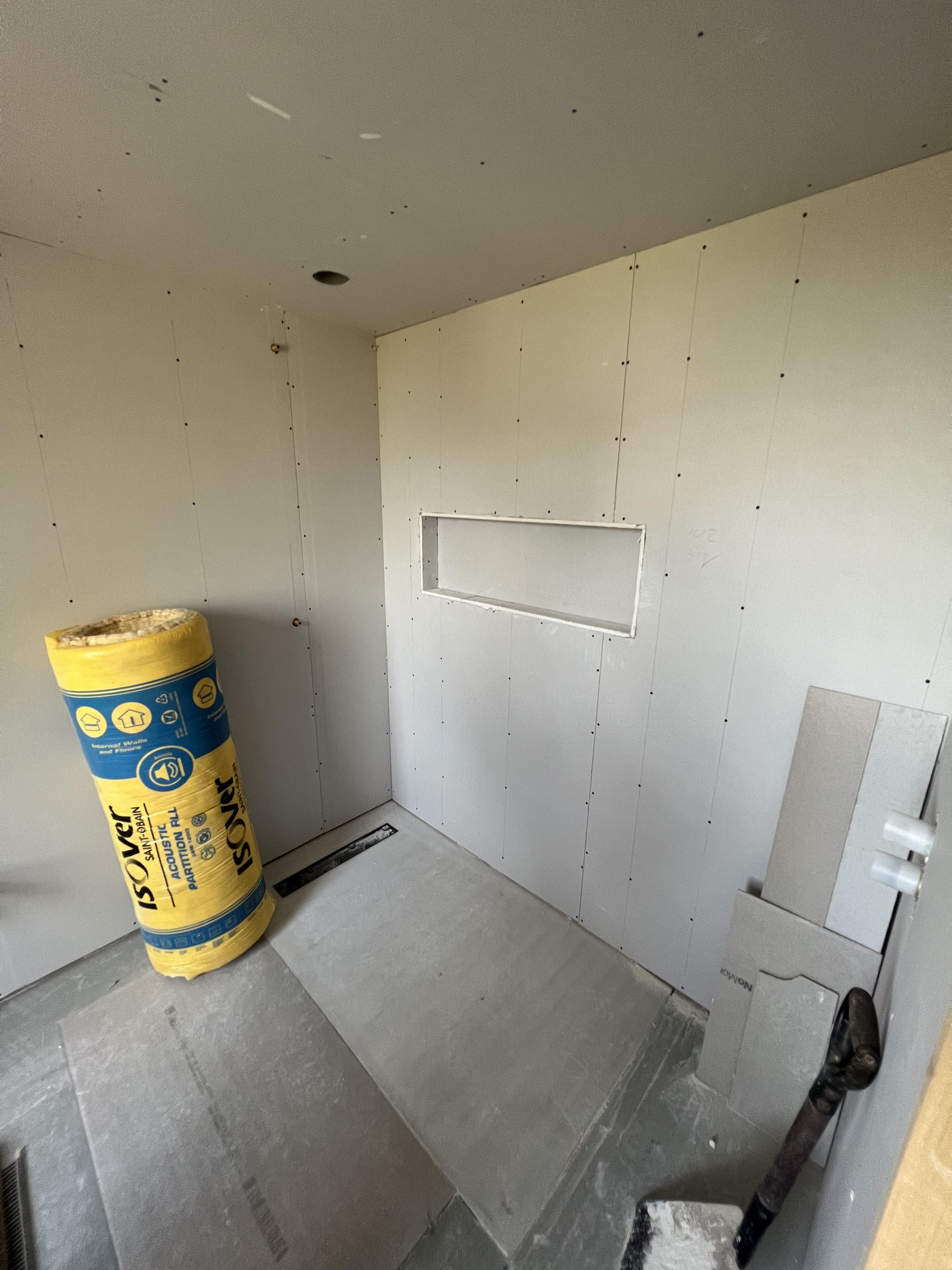

We decided to use moisture resistant boards, tank it and tile onto that, but there was some confusion when the boarders came last week and they’ve used normal plasterboard as shown in the photo below. Will this be ok when tanked or Should I ask them to swap it out for the moisture resistant? james

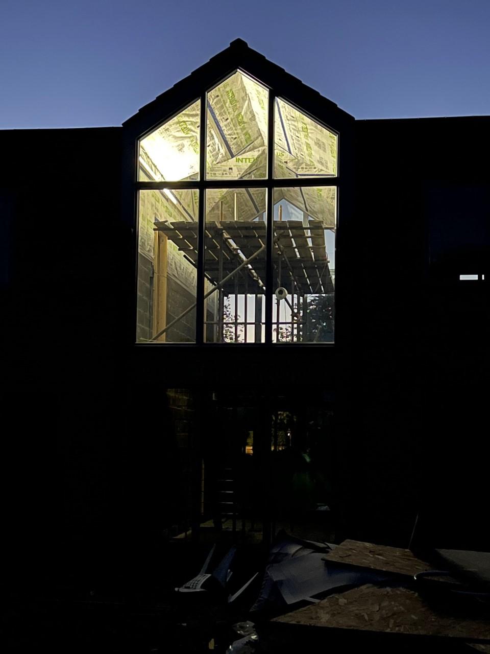

I'm in the process of lighting this part of the house, having main light hanging down from centre and looking at plastered in led profiles either side . -
I'm a little concerned about my 2 way lighting will it work? There will be a pair of switches one to operate the stairs and one to operate the vaulted section. It will be AC 2 way switch top and bottom of stairs going to a driver and some sort of controller for both. (Lights will be rgbw) We have had the steel stairs fitted yesterday and not sure how the cables will route to each treds, has anyone done something similar and how best to control them I'm not looking for a pir sensor system just using switches. Regards James
