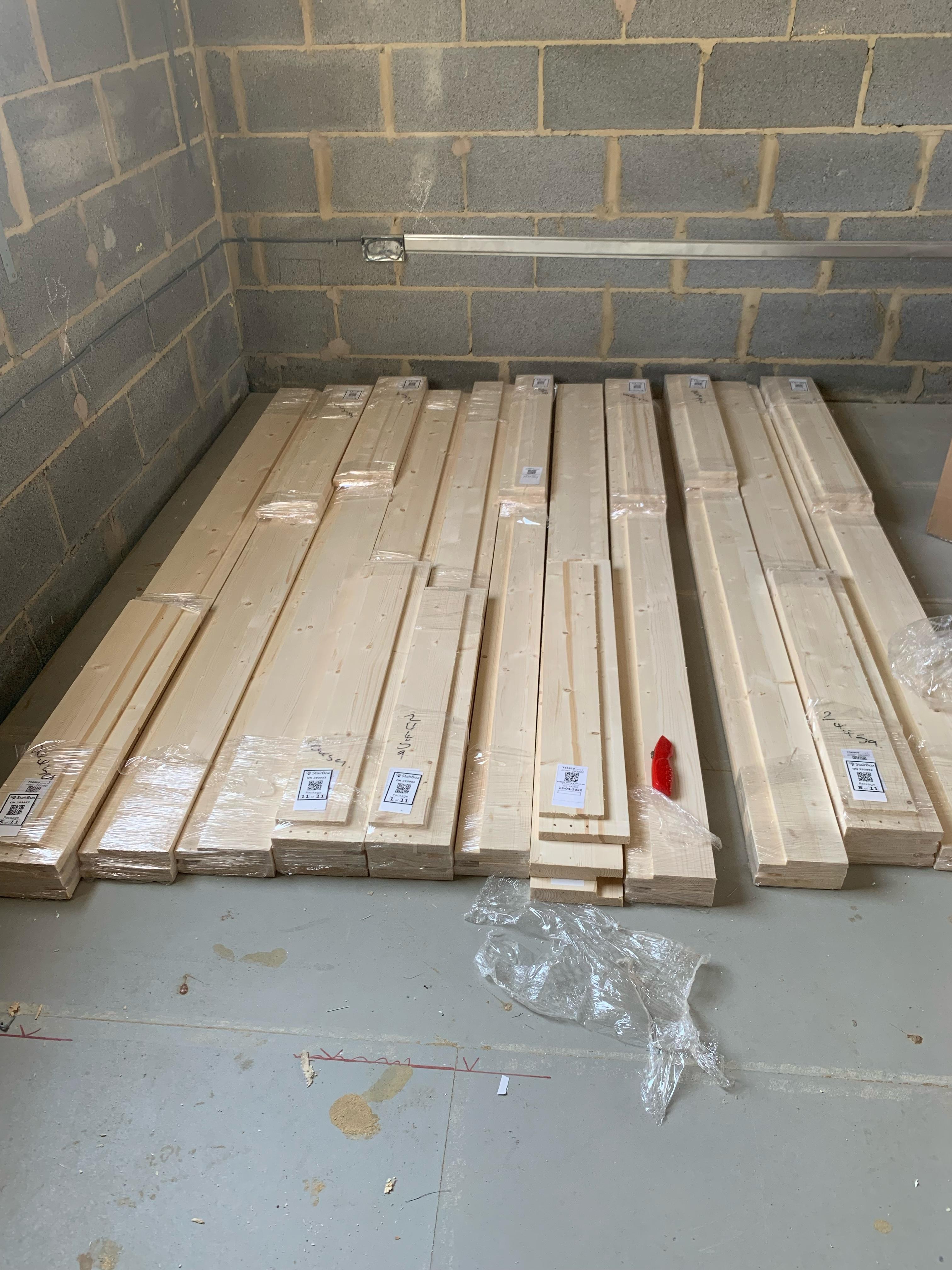

  8. @ProDave They came with a cling film around them to keep them together, I have opened one so I’ll wrap that back up. I’m hoping the floor should be level enough but I’ll get something to hold them down to stop any warping. there are both block and stud walls. @nod there are about 5 different widths of doors eventually going in the casings which will be a while away so I don’t think it will be worth buying cheap doors to fit into casing prior to installation, but skill builder was doing something like that. All the casing have been made to a couple of mm larger than the door that is going in them, so hopefully the joiner can fit them without taking anything off doors. @markc It’s going to be a while before I get the doors and the joiner will be fitting them, dad doesn’t feel he can fit an expensive door, he’s used to £20 doors and that was some time ago they was that price. Regards. James
  9. I have 11 door casings just laid on floor and I’ve been let down by joiner, rang so many I’ve lost count. Earliest said mid May an other said August most said to busy. My dad has been helping me a lot and he’s fitted a few in his house and has suggested he does them, but not sure as I don’t want him to mess them up. If I do let him loose can anyone offer me some fitting advice to pass on, he’s been watching a few YouTube vids but some of them are quite old and I’m not sure if things have advanced now( the Skill builder ones look quite good) if he follows these can he go wrong? If anyone can offer us any installation tips and things to be careful of would me most appreciated. Regards. James

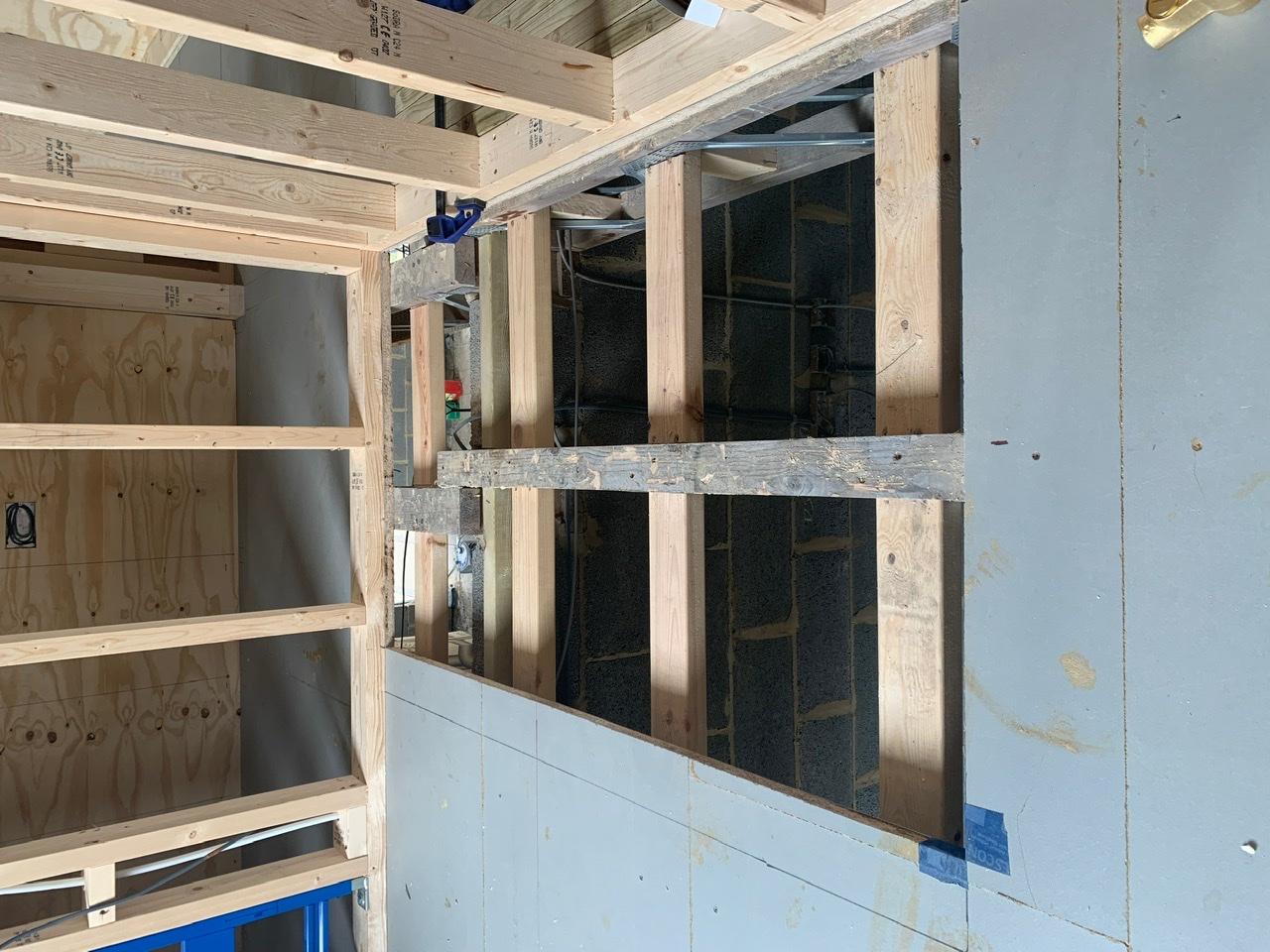

  14. Going to lay a shower former at posi joist level, i have put 2x4 supports beneath for a material to sit on. What would the best/strongest way to make the height up for former to sit on? Regards James

  17. Hi all, after reading on the tiling forum I have come to the conclusion that my two upstairs bathrooms set on 600 centres posi joist and 22mm caberdek should have been 400 centres and a totally different floor finish. Like WPB Am I correct in thinking this? 1, I’m hoping to lay two large linear formers 1500x900 was looking at the tough x Maybe someone could recommend a better one, do they all perform as good as each other and ease of tiling? 2, Our posi joist top chords are 47mm deep, should I fully fill that with ply to support the former? 3, What’s the Best material to lay over caberdek and what’s the best way to reduce any floor deflection and best materials for tiling on? 4, Our plasterer has said to plasterboard and skim both bathrooms and tile onto that, as that’s what he does on every job. Would we be better off using a backer board and tanking kits where needed? What would a tiler prefer to work on to give the best results? James

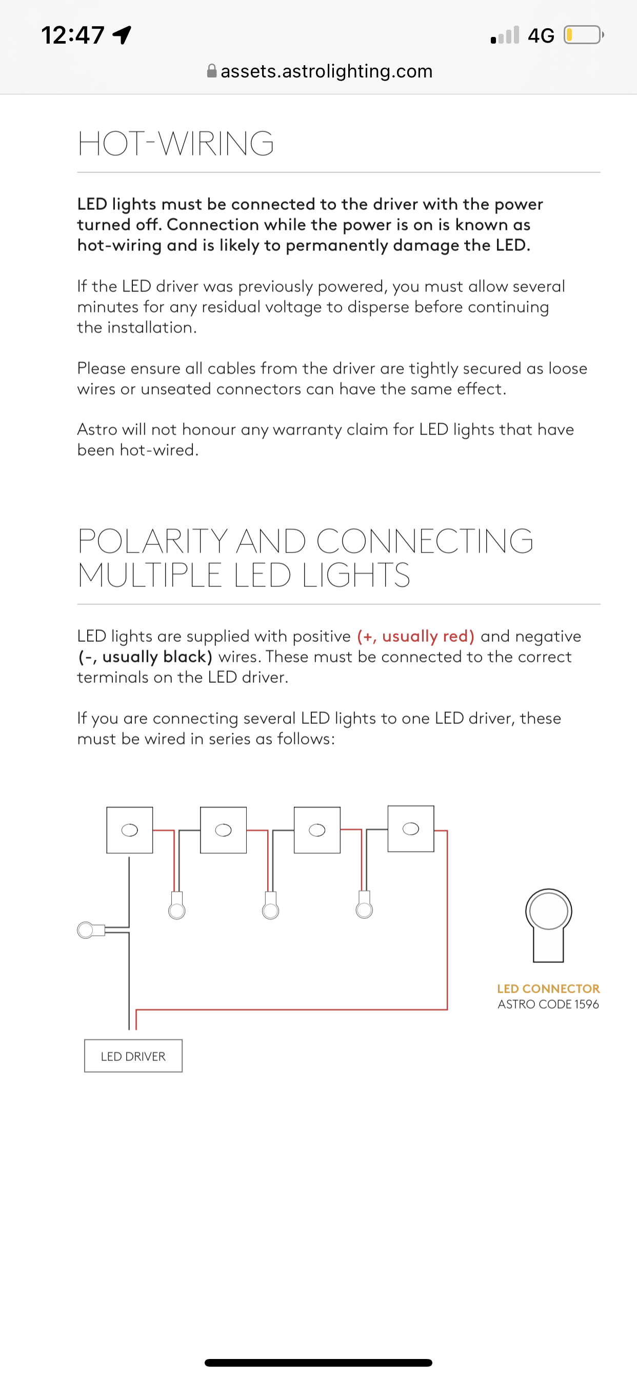

  21. Not a problem, the more problems we hit on this build the more we learn for the next😁 this driver wasn't the one astro recommended, we chose this because of the price. This is the astro one, https://www.astrolighting.com/products/6008072-led-driver-cc-350ma-15w-cc-700ma-31w-non-dim should we of bought this,is it better than the one we have? And if not can you recommend one which you think maybe suitable. Regards James
  22. Thanks for everyone's help, I'll get these wired as soon as i can. Regards James
  23. Now i am a little lost, I have already bought one of the drivers @ 700ma as stated by astro, I also think these 2w led lights are replaceable although not sure how . The led driver will be sat on top of a wardrobe a few meters from first light, I want to make everything possibly replaceable with ducting and so on, I would hate to have something fail and be left with wall lights that don't work of have to rip wall apart. Regards James
  24. It’s looking clearer now after your advice, have never done any low level led lights from a driver and just thought you wired them like 240AC. so block screws for test run, do you recommend anything for the final fixing I think Astro have mentioned some jelly crimp? Also if the last light is 5 m away from driver do I just run connect a single cable to last light and run it back to - on driver? Regards. James
  25. I think I understand the connection from mains to driver and out to first light it's after that and back to driver I don’t.
