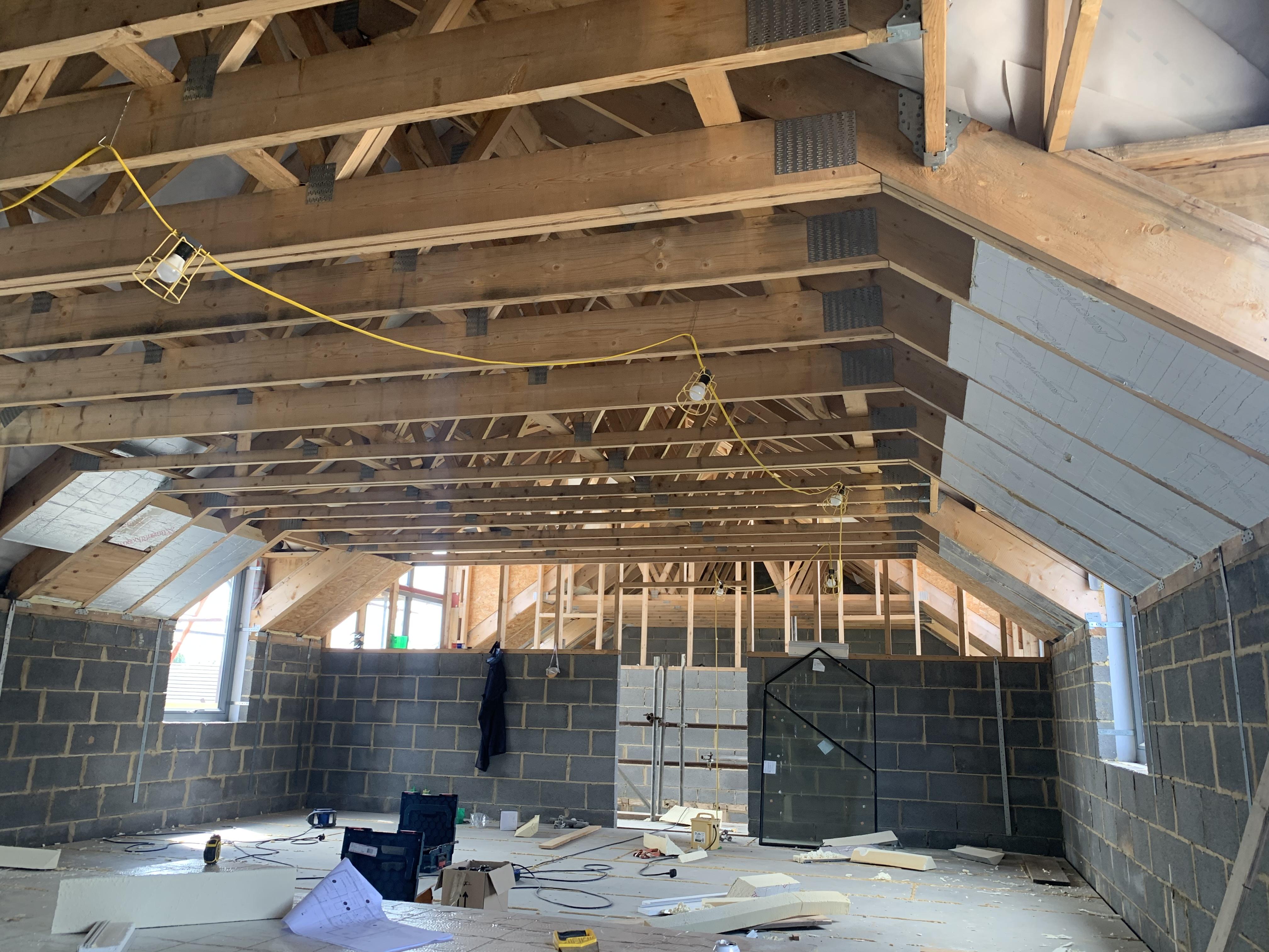

Hi looking for some advice on a few points, We’ve reached this stage at the moment. (See photo) and trying to do as much of the build ourselves now that we have a watertight shell. (Naturally ventilated) We’ve been doing a bit of reading but not really getting anywhere, more confused than anything. I see a lot of different methods and materials being used when it comes to air tightness and VCL's We are in the middle of adding pir to the sloping ceiling with 150mm in between the rafters and planning on maybe 60mm underneath with all joints taped to form the VCL, and battens to create service cavity. 1, Architect has specified 100mm loft roll in between rafters at ceiling level with 350mm over that, could we put pir inbetween rafters and tape over rafters to continue VCL? 2, does a parge coat act as a VCL for walls?  3,How would we go about making the expansion joint around first floor, floorboards air tight as we have missed the opportunity to use tony trays. Thanks james

I would like to thank everyone for their help and great advice. I was considering using two layers of frametherm with PIR underneath, but the trusses aren’t spaced out evenly due to the dormers. So I was wondering how easy is frametherm to cut and work with? When using the celotex calculator it asks for rafter spacings, most are at 600mm centres but there’s are a few which are less. Should I choose the 600mm option or will I recieve incorrect calculations? See attached photo. Thanks James.
Rafters are 220mm deep
