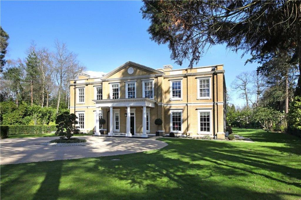

  2. I think it’s setting really does spoilt it. Although I’m not massively against this style and design, it’s just cited in the wrong place. I’m sure once the landscaping has been completed along with any other elevational treatments, it will look better but not great. Completely agree with the bolt on timber clad extensions ? I was trying to find examples of similar designs we were involved with at my previous company. Something ‘quite’ similar is attached but I suppose it does have a little more character.
