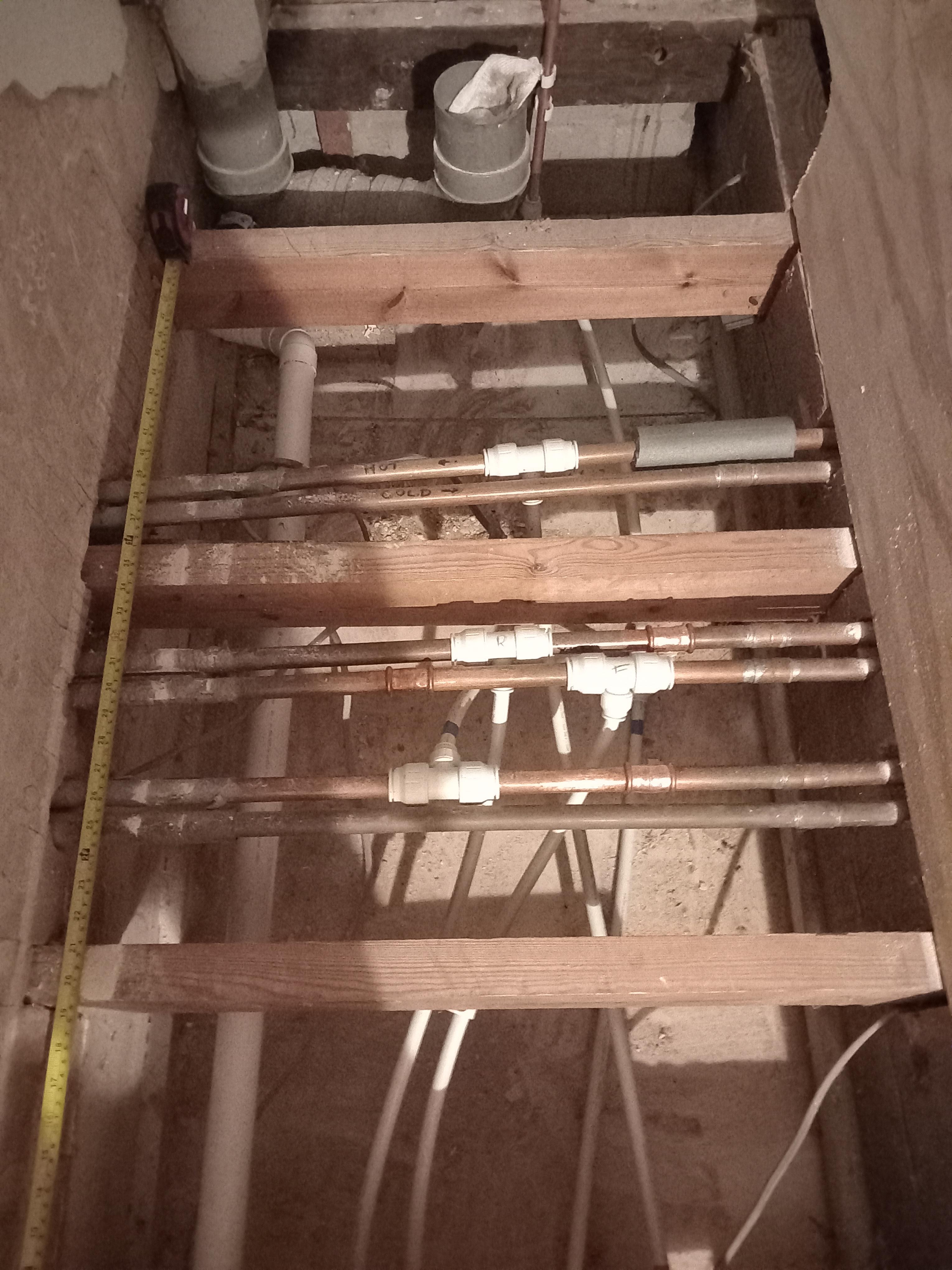

This isvthe bit that I've made the access panel over, just where the pipes run. Just no atall confident about push fit!
Well, I'll glue the vinyl on the access panel separately with ring pulls to lift it off. I made an boob with the pipes....plumber ran the plastic with copper tails and disappeared, never to return!...Holding me up I got the plumbers who were fitting a new boiler to connect into the system so all pipes are live but capped off, So I can't really test the joints as such. As the pipes have been under pressure for about 6 weeks now with no sign of leaks ( all push fit joints) is that a vigorous test enough? Had a nightmare with plumbers!
Hello everyone, I'm creating a bathroom from scratch and doing much of the work myself. I've had all the pipes and wastes installed and now I'm at the point of screwing the ply floor down. Problem is I'm nervous about access to pipes incase of leaks. Fortunately all the pipes/joints run between 2 joists so I've built an access panel in the ply for that but I just can't commit to screwing it all down!! I plan to use vinyl on top, glued down. Any suggestions or reassurance??
