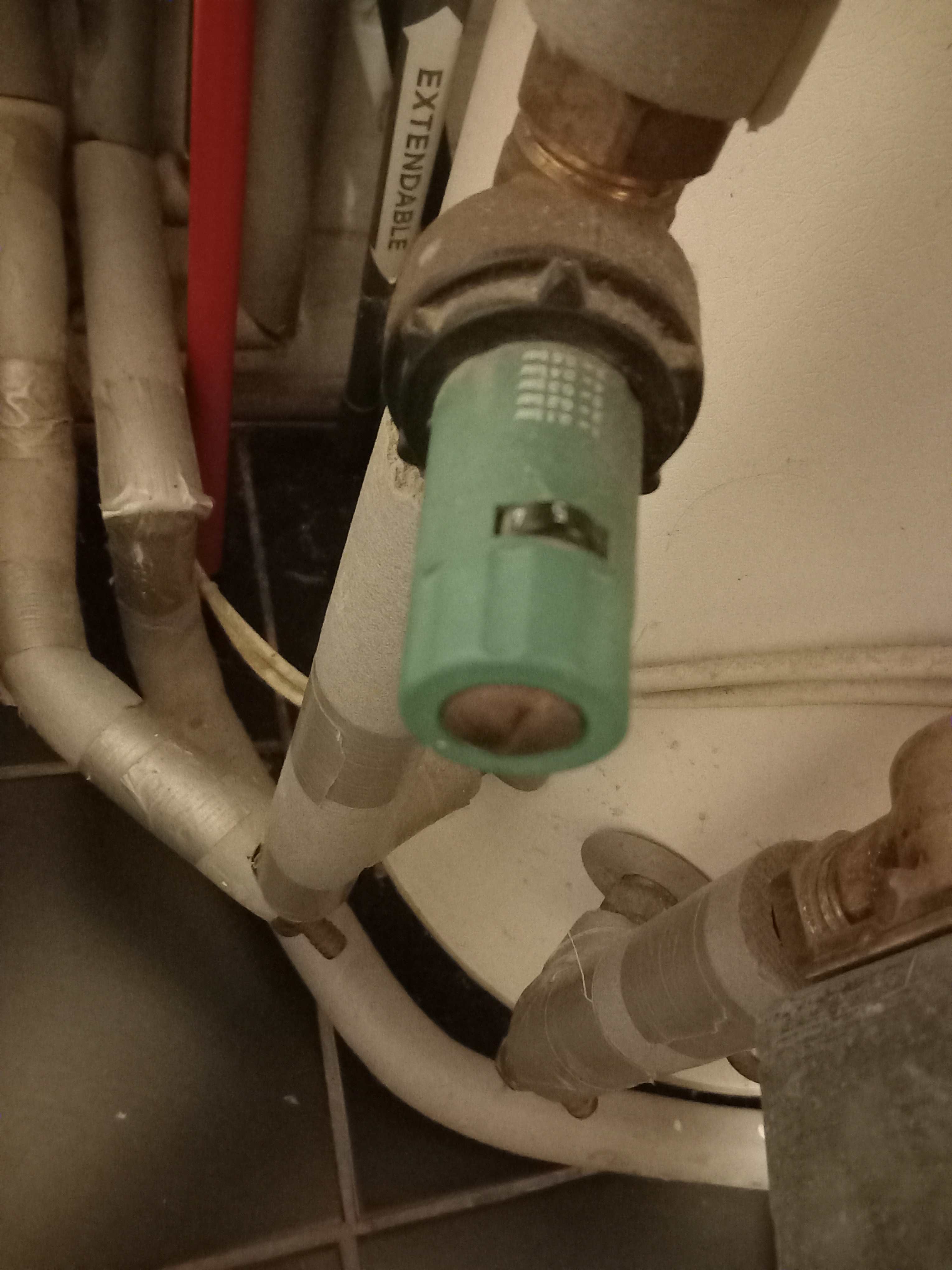

  7. I didnt touch the valve, as it was, don't trust myself!

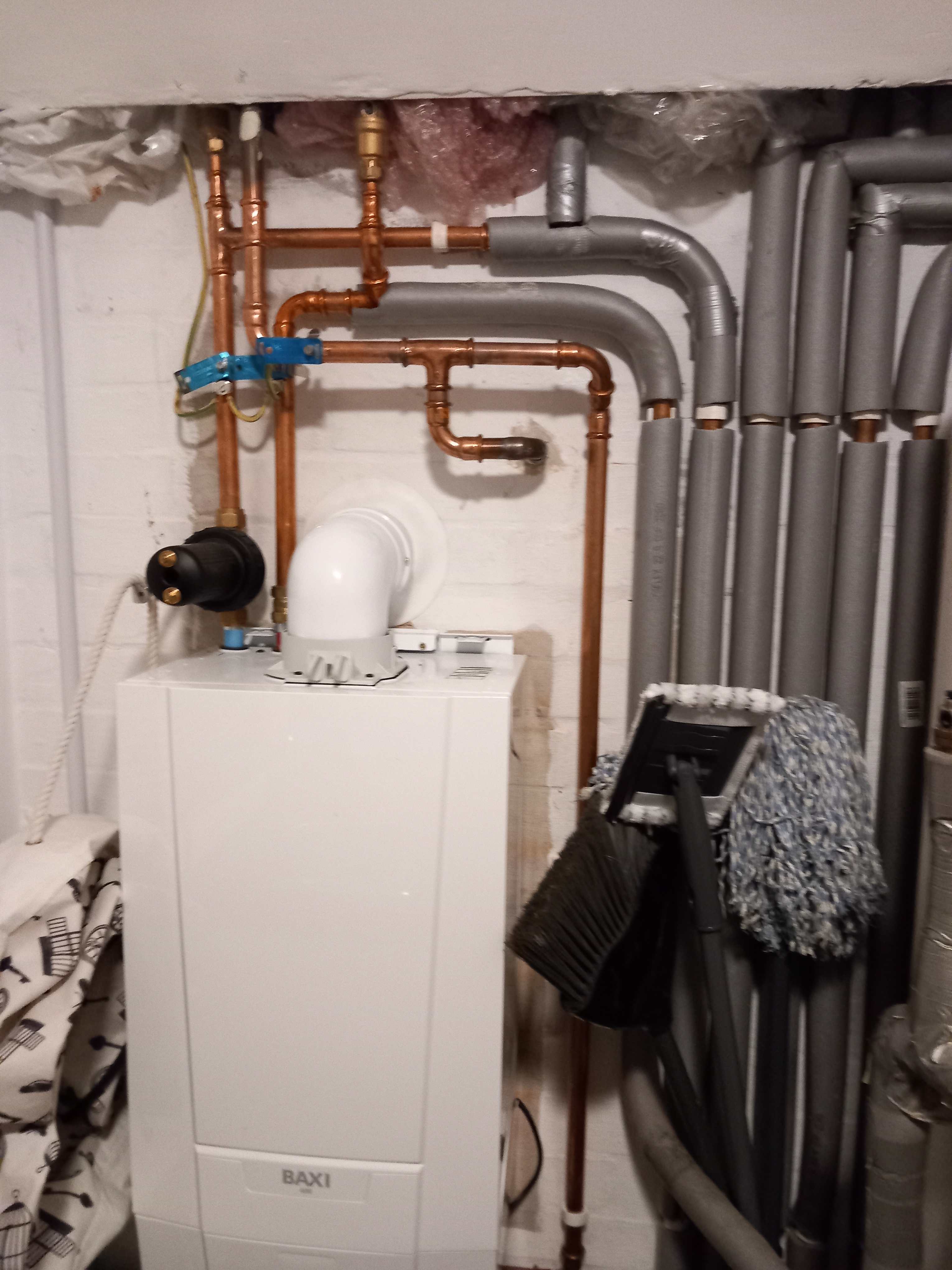

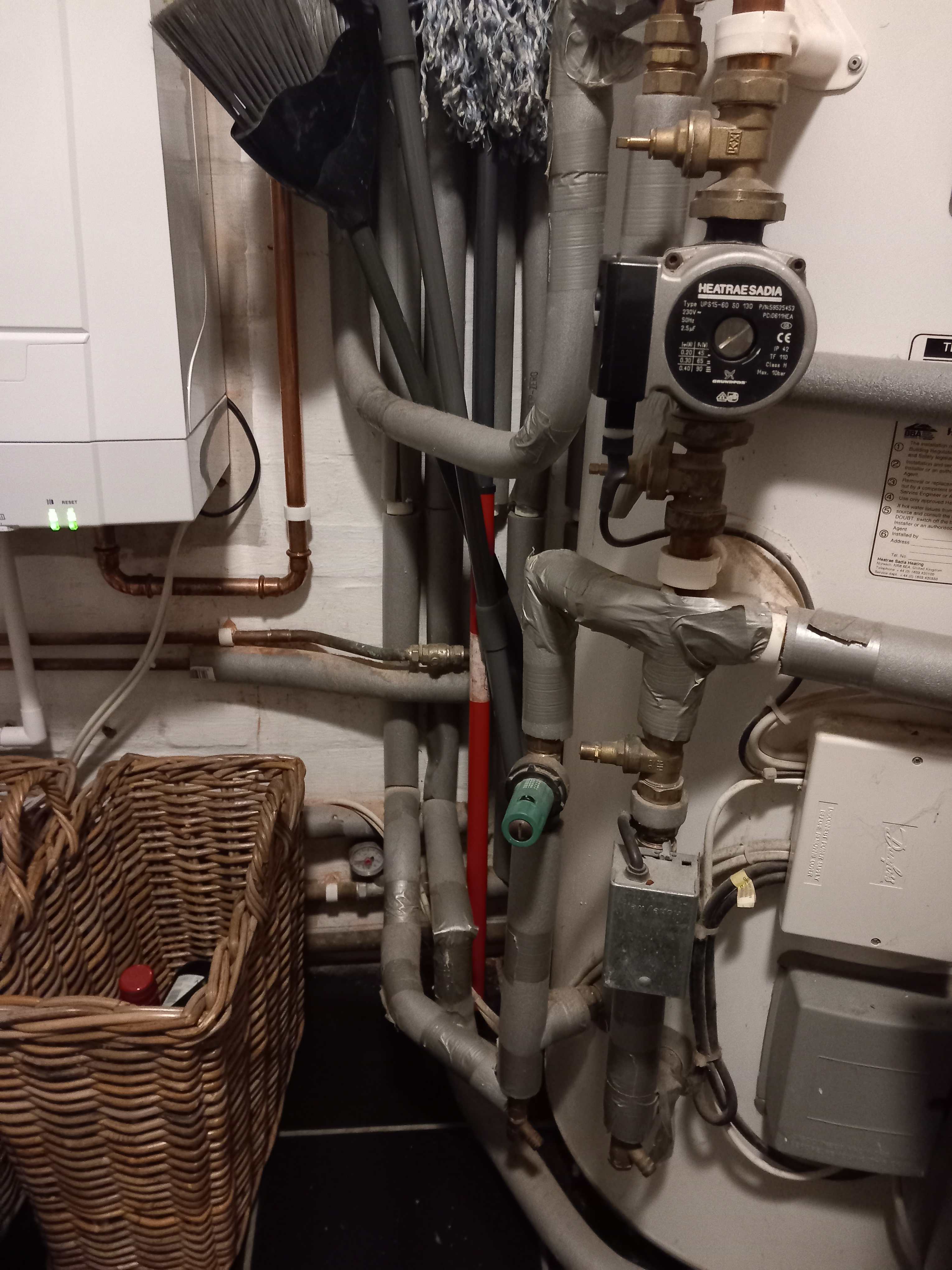

  12. The temp above the green valve is rtn 38, below rtn 35. The flow from the boiler is 58, rtn is 47. The number the valve is set to is 5=0.5 bar
  13. Sorry! The green valve Ts into the return pipe on top of the boiler where that black thing is, (that's the return). It's the second pipe from the left as it bends horizontally. There is a dial with numbers on the green valve, should I adjust it to cool the return? Right tighty or lefty lucy? One of the kitchen1 rads is now stone cold! It's fed I think from Bed4 above and pipes drop down to feed kitchen 1 and 2. On kit 1 I'm pretty sure the flow and return are the wrong way around as rtn is 55⁰. Is it as simple as removing the rad and turning it around? You're so knowledgeable, patient and kind. I think everyone else has given up on me!!

  15. The blue one Ts into the return pipe on top of the boiler. I can't trace the black pipe as it snakes/ hidden behind the tank
  16. I'll check on the pipe ABV and let you know. There's not two heating zones, just one. The valves are on a heatrea sadia tank
  17. Oh dear, 'YIKES' doesn't sound good!

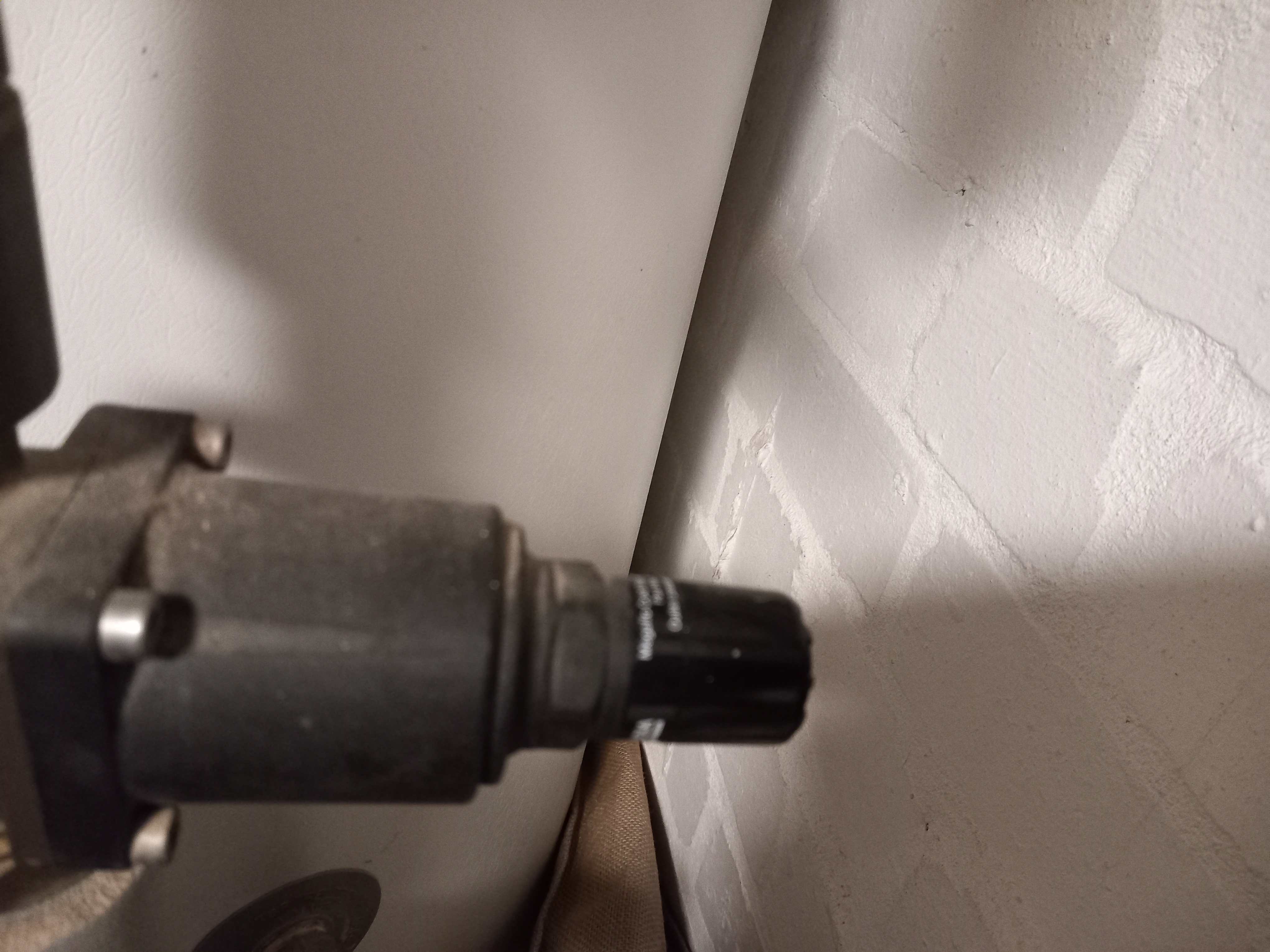

  18. @marshianis this the ABV? Or ghe other?
