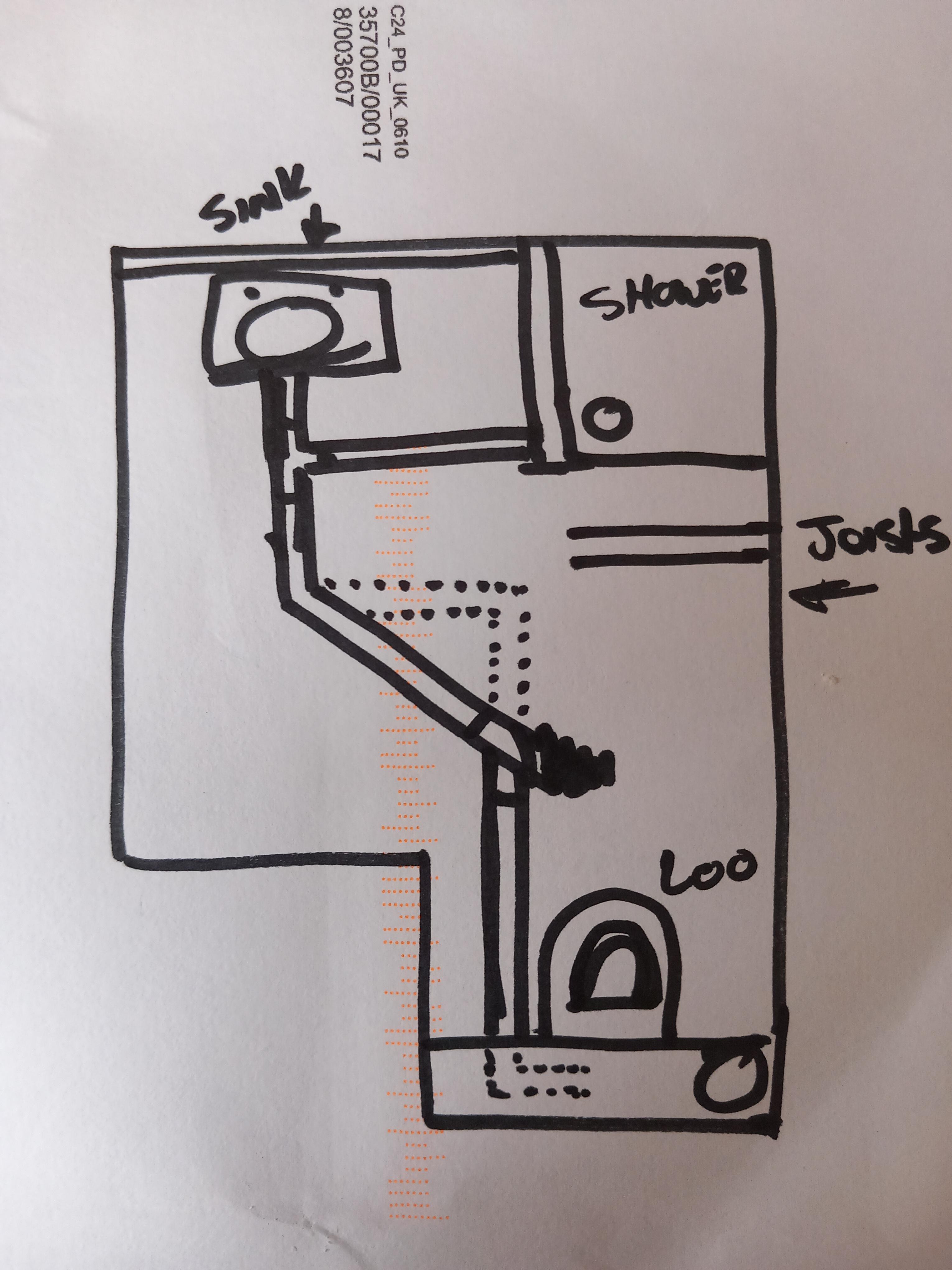

  4. HELP! The corner where the shower will sit isn't square! Which wall should I square it too??? It's out by 20mm bottom right! Average it out or square to the back wall? I plan on having just a door, so if you look at the sketch I did for the pipe run then the l will build the left wall off the back wall, (the back wall is stud work) and the right wall is brick. As there is a void under the floor of about 20" should I put insulation down? The kitchen is below. How tight should I screw the trap? baring in mind I don't have the same grip strength as a man? is it possible to over tighten the trap ect and knacker it? Would you recommend PTFE tape on every thread joint as belt and brace?? Once the floor is down that's it!!

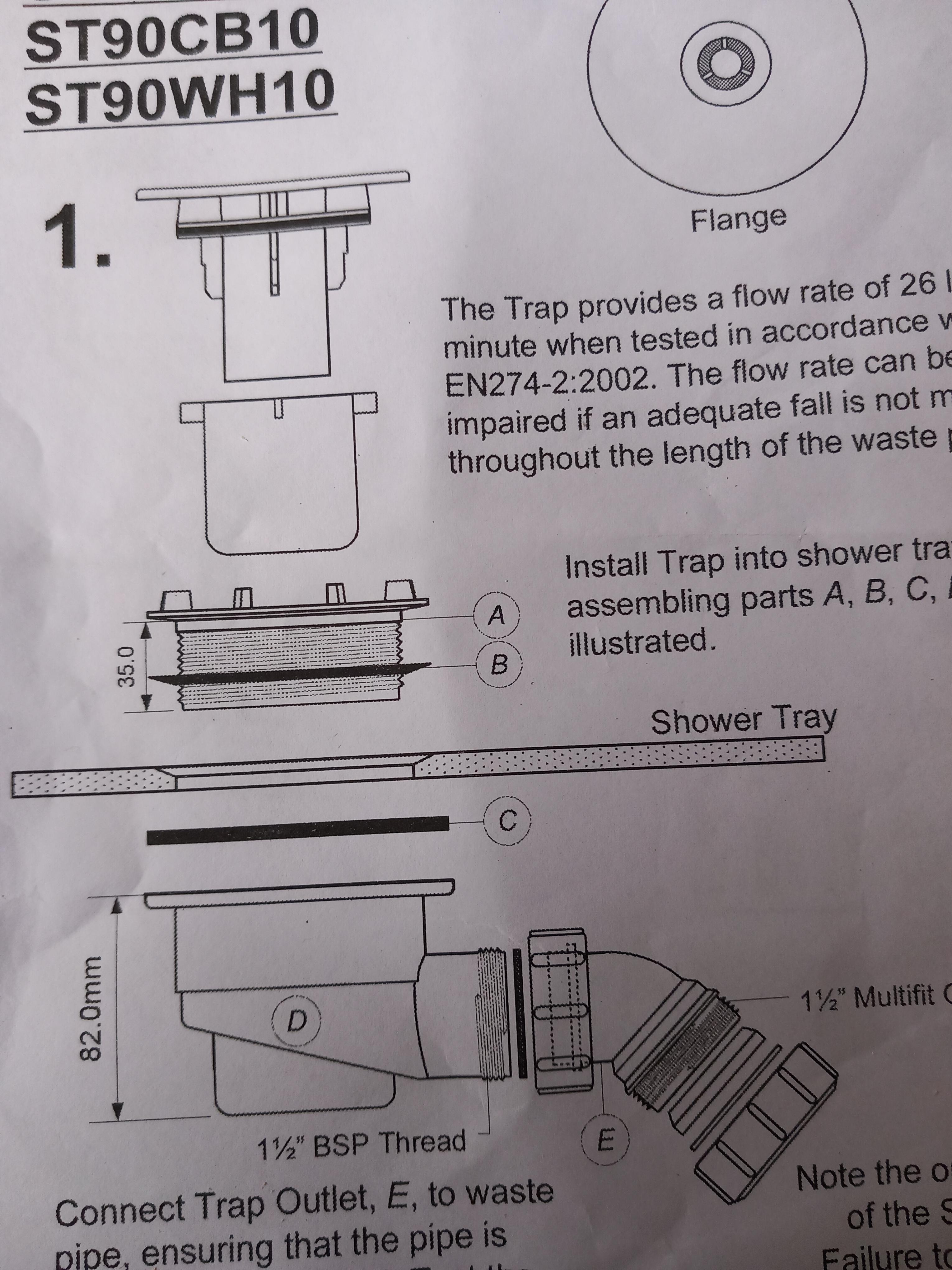

  5. The tray has a solid base. 800 x 800 so not massive. I've just levelled the joists with noggins and now the ply is absolutely level, no rocking or anything.! Do I now screw down the ply, add tile adhesive, set tray down and then put trap in? I've got a McAlpine trap so should I use silicon on both rubber seals A,B and C or none?? The small pipe that comes out of the trap, is it just hand tightened onto the trap or some sort of glue used as once it's in its very tight accsess so I have one shot at it. Thankyou for being so patient and helpful everyone!
  6. My next question....sorry.....is the waste pipe run. The shower pipe will have to run parallel to the joist and T into the sink. Is this OK? How much fall is dictated by the depth of the joists for both sink and shower to get under. I estimate total run from shower to sink to loo appropriately 4m. The sink will run as per my sketch to the loo. Should I only use 90⁰ bends or can I use 45⁰ ? (The dotted line is an alternative route). Thanks for your patience

  11. Could I run the waste pipe parallel to the joist with fall and 'T' it into the sink waste to get under the joist?...see sketch There is a void of about 7" ( bathroom joists/void/ceiling beams) which would allow for plenty of wiggle room and fall.

  14. Sorry, racing ahead in all directions. First hurdle reached....dry laid ply, tray and waste and waste sits slap bang behind a joist ( I've posted a picture) would have to notch out more the 50% of 5" joist to get it through and I know that's way too much. Can't bring tray forward either as not enough space. Don't want to put it on legs either. Any ideas?!
