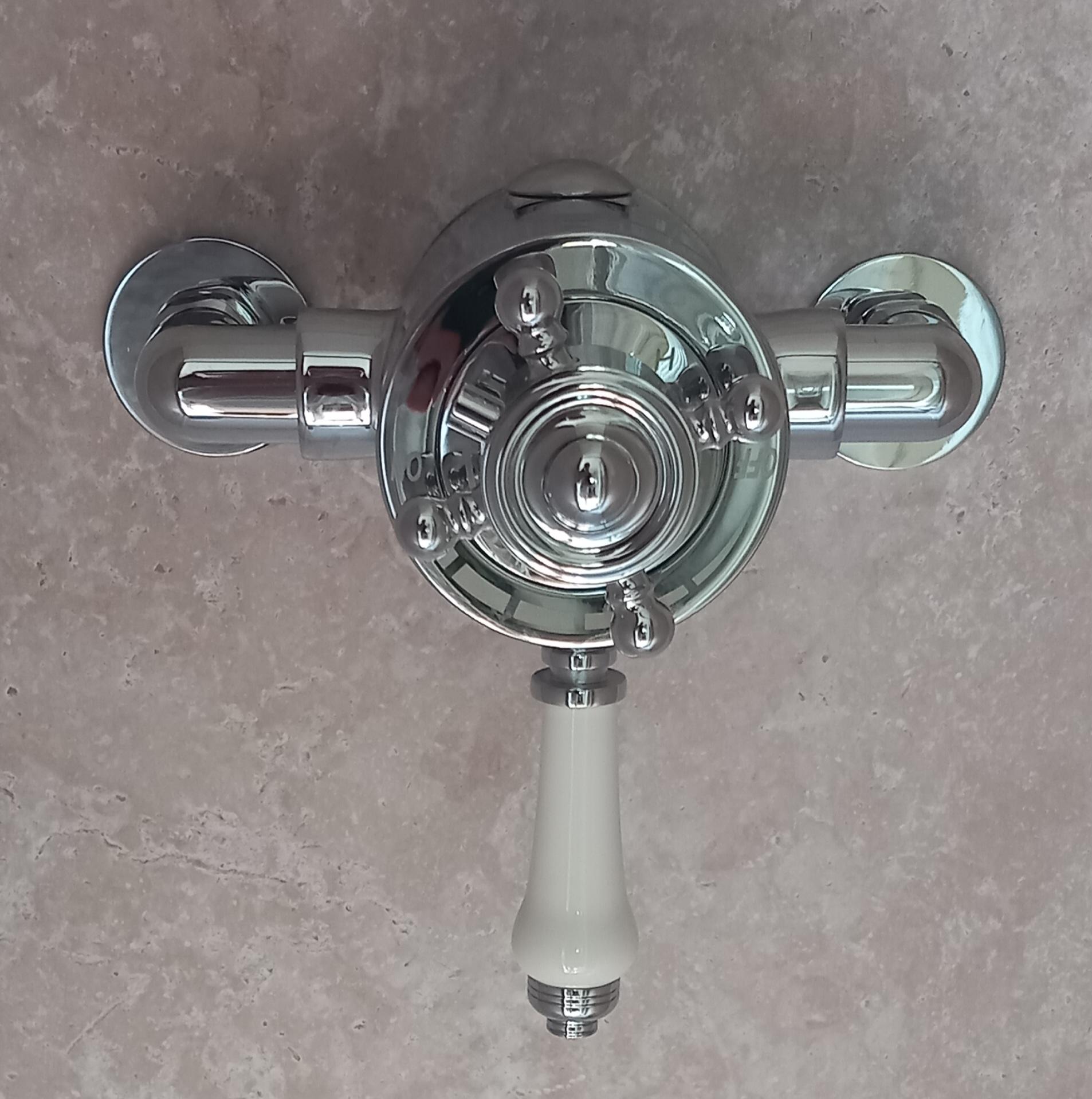

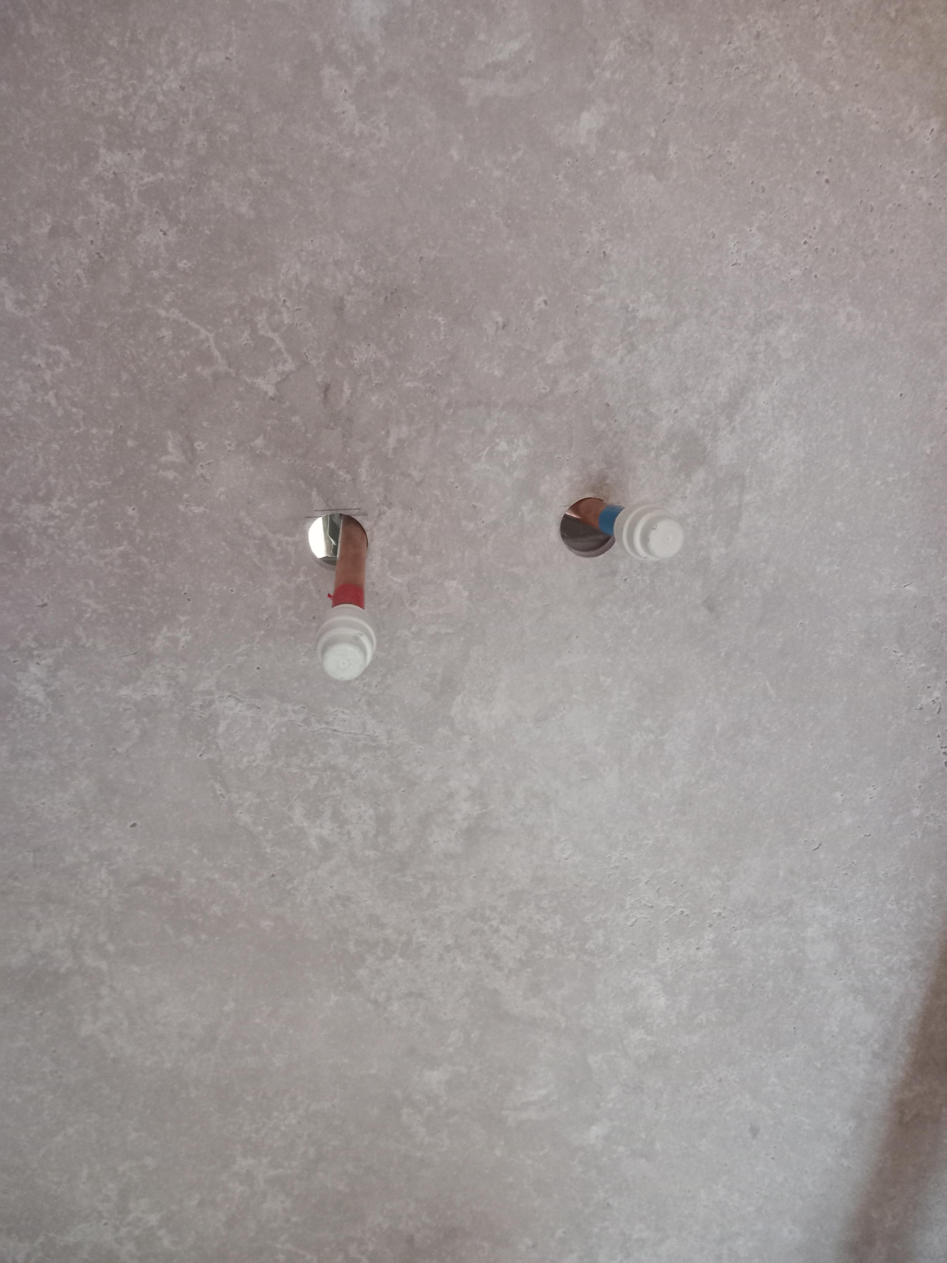

  1. Shower valve fixed and it doesn't leak either!! Plumber had put it on upside down..... Thankyou everyone for talking me through everything. I've gained alot of confidence in the process and a teeny tiny nugget of knowledge. Much appreciated
  2. I'm not confident cutting the pipes for IVs so I just loosen the nuts and straighten the valve!
  3. Hi, I've just turned the cookshop off, turned on the basin taps that are right nect to the shower in question and the flow stopped nothing seconds! I was expecting it to be awhile fir thr pipes to empty throughout the (large) house...no? Photos of job....wont slot of wster escspe thats left in the pipes?

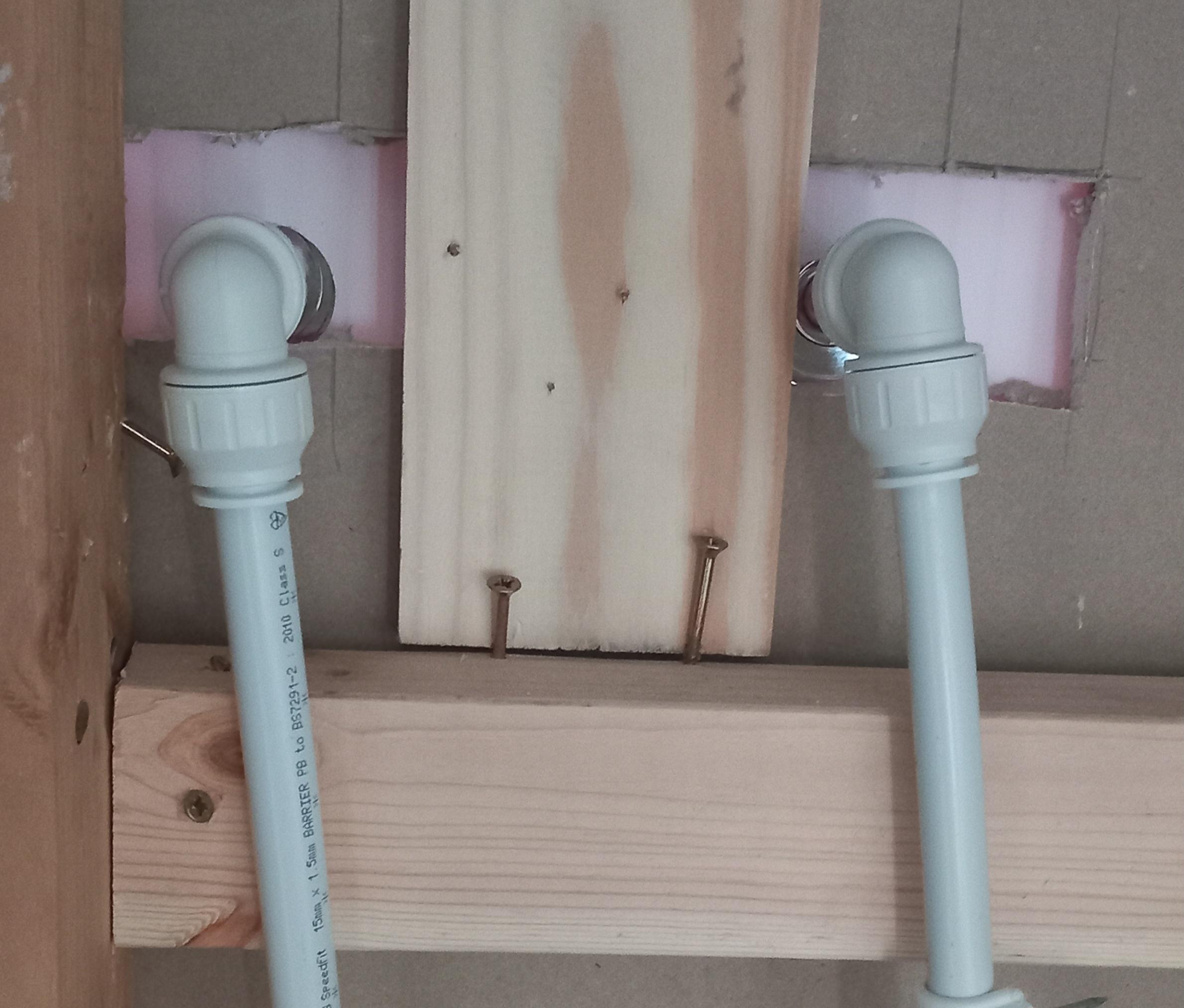

  4. Thanks markc....there's no pump. Should I also turn the basin taps on aswell as the shower, to dump the water? I was thinking about fitting isolation valves while I'm at it but never tried this befor and the plumber used plastic pipping, any tips on this??

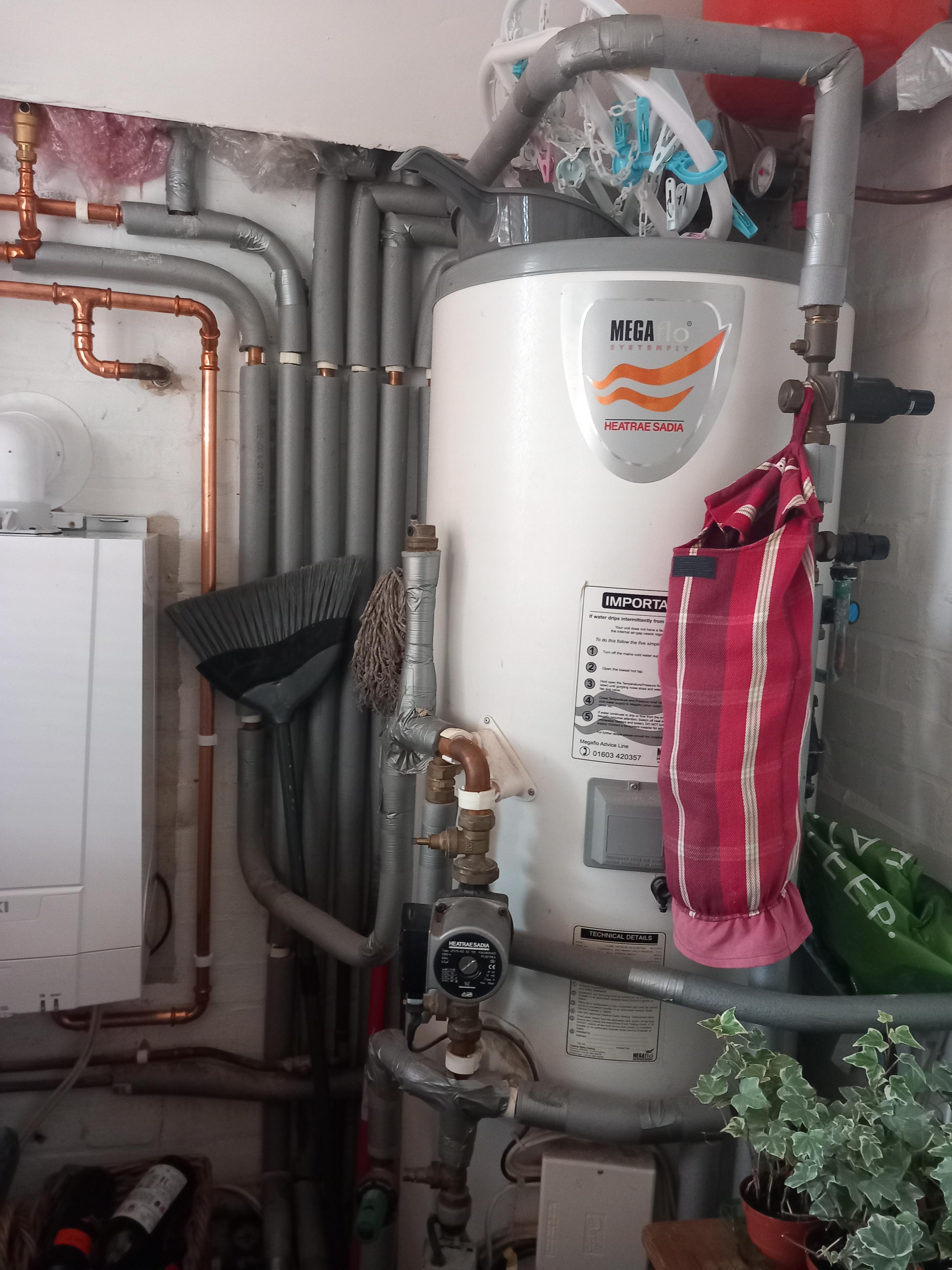

  5. I now have to adjust the exposed shower valve as I can see daylight through the hot and cold pipe inlets! Plumber didn't put isolation valves so how do I turn off water as I have a megaflo tank? Tank is immediately below new shower. I know where the stop cock is but will that isolate the hot too?

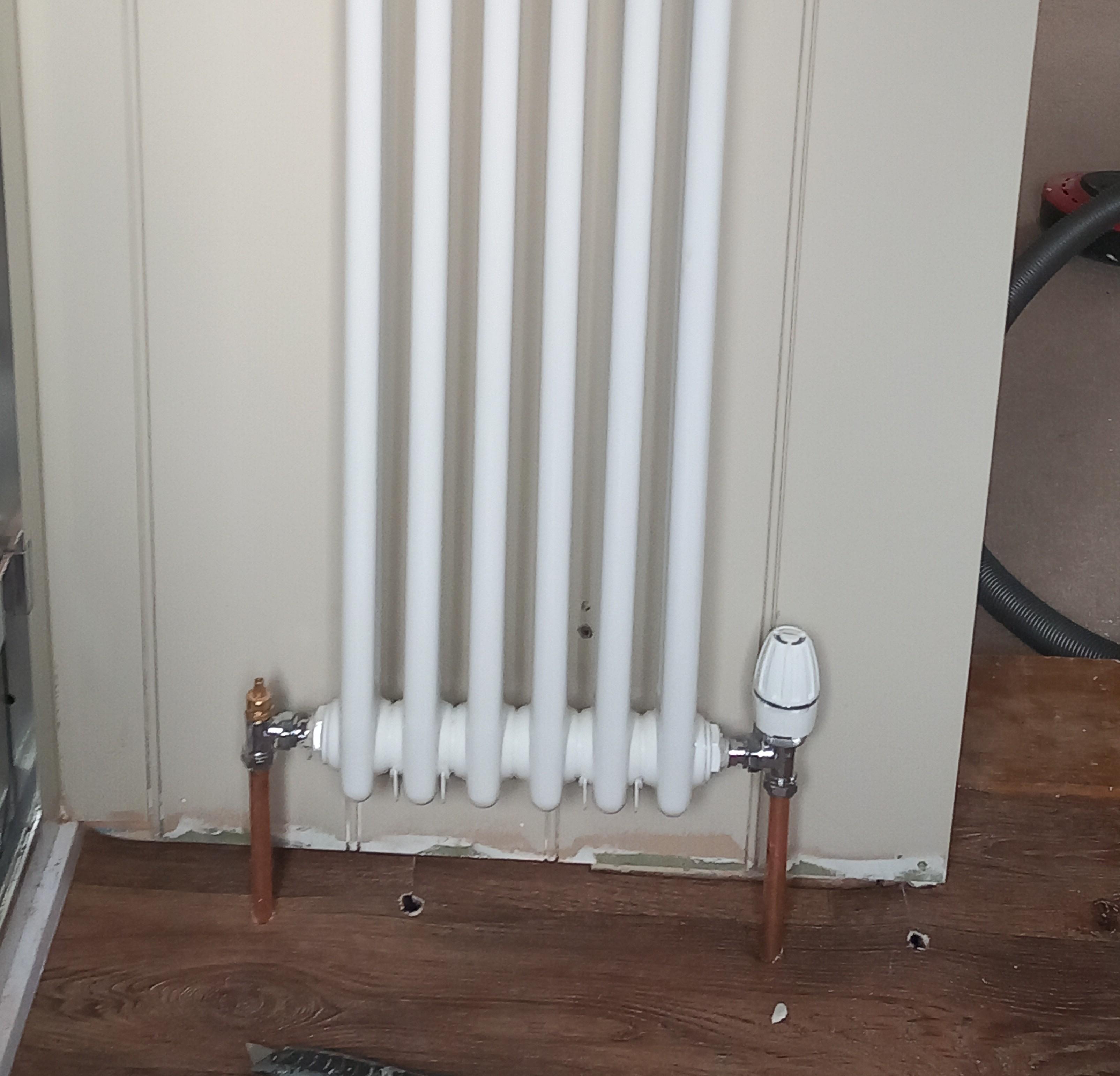

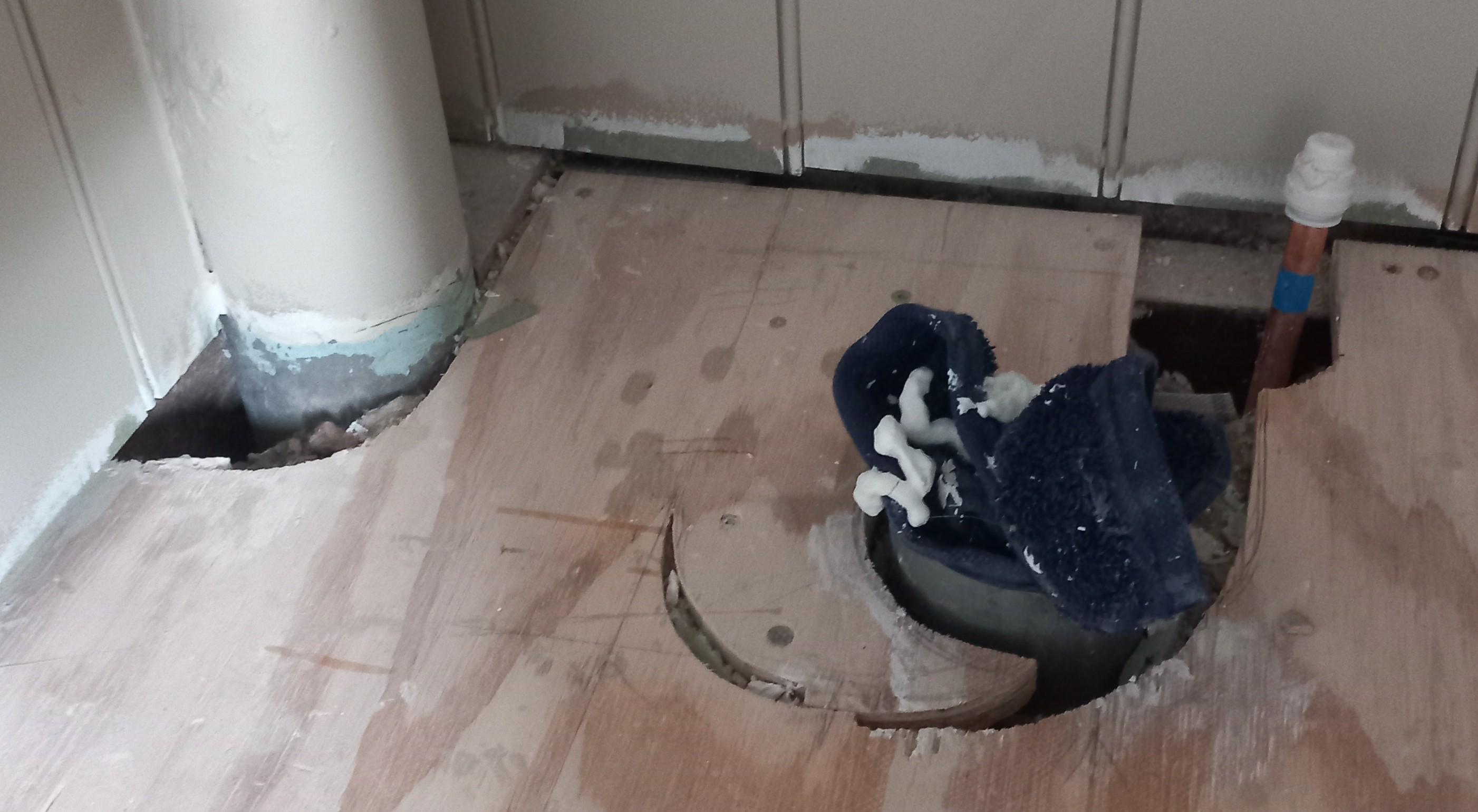

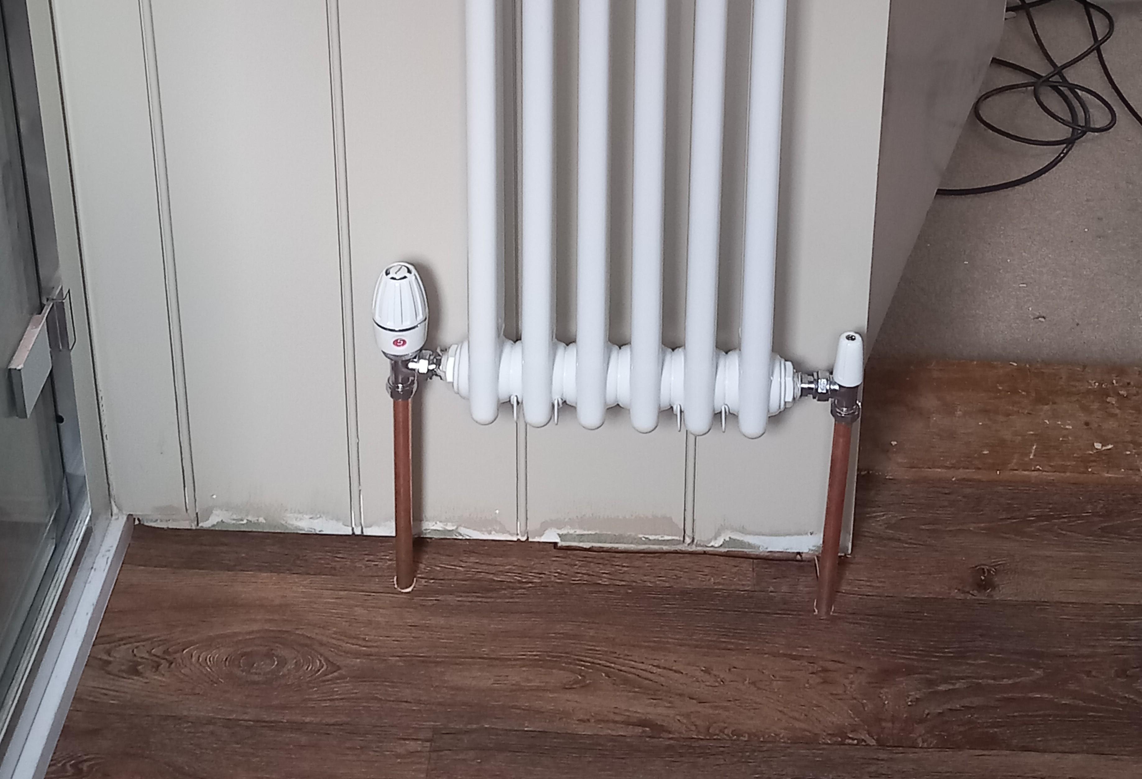

  6. I know, it does look like a bodge job! I just rather have the rad centered than worry about hol.es in the flooring. I'll patch them somehow and get caps for the pipes. Thanks for your input, much appreciated...Dee
  7. I did wonder about that flow reg thing but I honestly can't remember....is there away of checking? What do you mean by 'cap?
  8. No, pipework wasn't there and I had to get to work so I stupidly made an assumption that he would center it. I know better now to spell out my expectations! Anyway I've changed it after much careful jiggery poker.
  9. No, pipework wasn't there and I had to get to work so I stupidly made an assumption that he would center it. I know better now to spell out my expectations! Anyway I've changed it after much careful jiggery poker.
  10. Nope, there is plenty of clearance with the door. I figured out I can actually move it myself. I will pull the flooring back, cut away the ply. Remove the rad, shift the pipes ect....
  11. Hi Finally got plumber in to 2nd fix bathroom, had to dash to work and leave him to it . When I checked his work the tall column rad was not centered on the wall....looks dreadful. Can't pull up floor to correct it so is there a workaround?

  13. This is the system that I would need to drain. The plumbers I've seen drain it from a rad with a hose running outside. What do I shut off so the system drains and doesn't fill up?
  14. All the wastes are in for basin, shower and loo and connected into the poo pipe.. The poo pipe is there along with the bend that goes into the poo pipe. The water pipes are plastic with copper tails and are in place for the taps and exposed shower valve and cold feed for the loo. Draining the system is the first step but I need to plan this whole job meticulously if I'm going to tackle it atall.
  15. Hello all, Having been let down by 5 plumbers to do 2nd fix in a new bathroom that I've built I'm getting to the point where I'm going to have to do it myself. I don't want to but I despair of ever finding a reliable plumber befor hell freezes over. One step at a time. 1. I will have to drain the system first as pipes are live. It's a pressurised sealed system so...how do I do this and what are the risks of me getting it wrong?

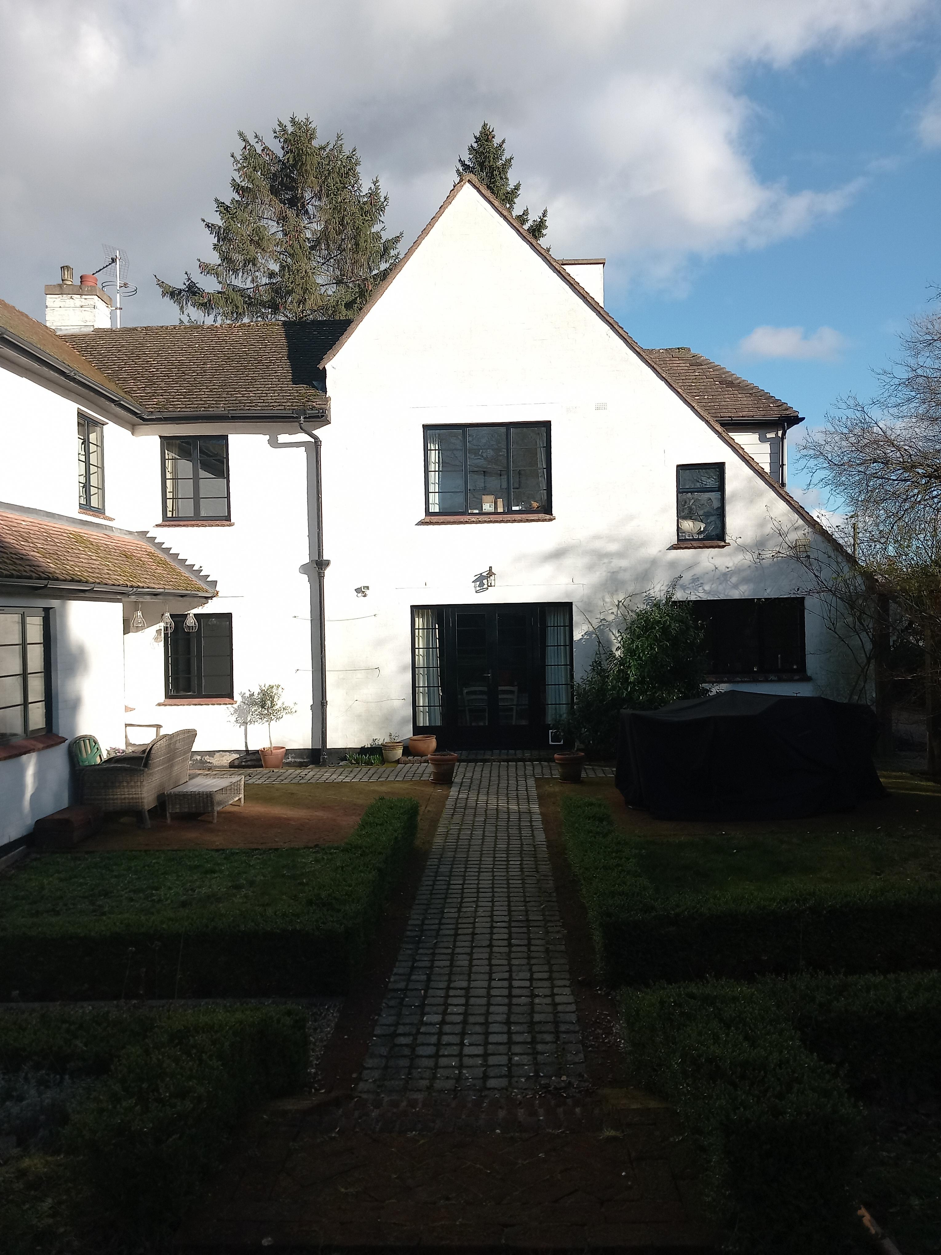

  21. Hi Have to get external masonry painted. I don't do heights as apexes and chimneys vv high, quotes for scaff are prohibitive ontop of actual labour costs! I need 3 separate towers/3 chimneys. Roof ladders too unstable and dangerous. Cherry picker can't get to back of chimneys. Any other options??
