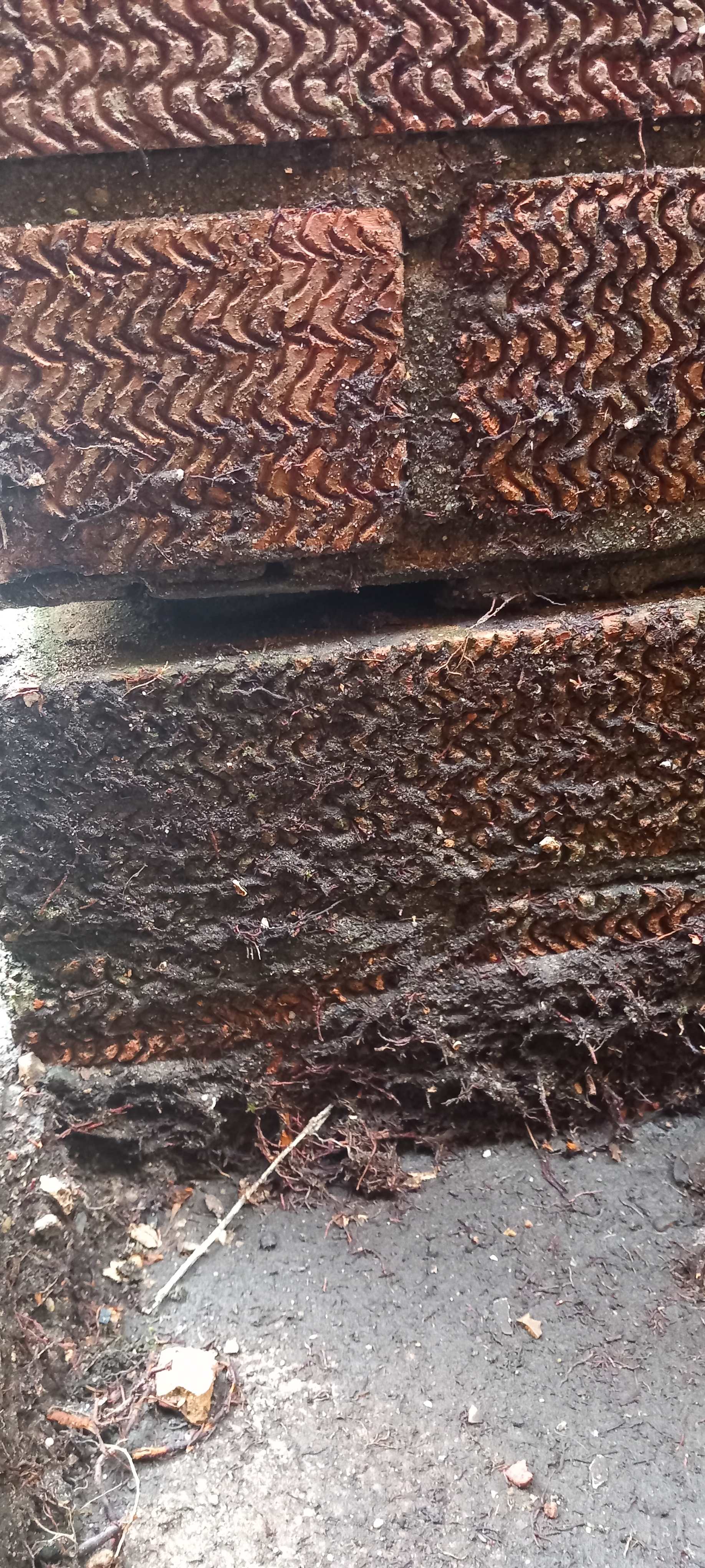

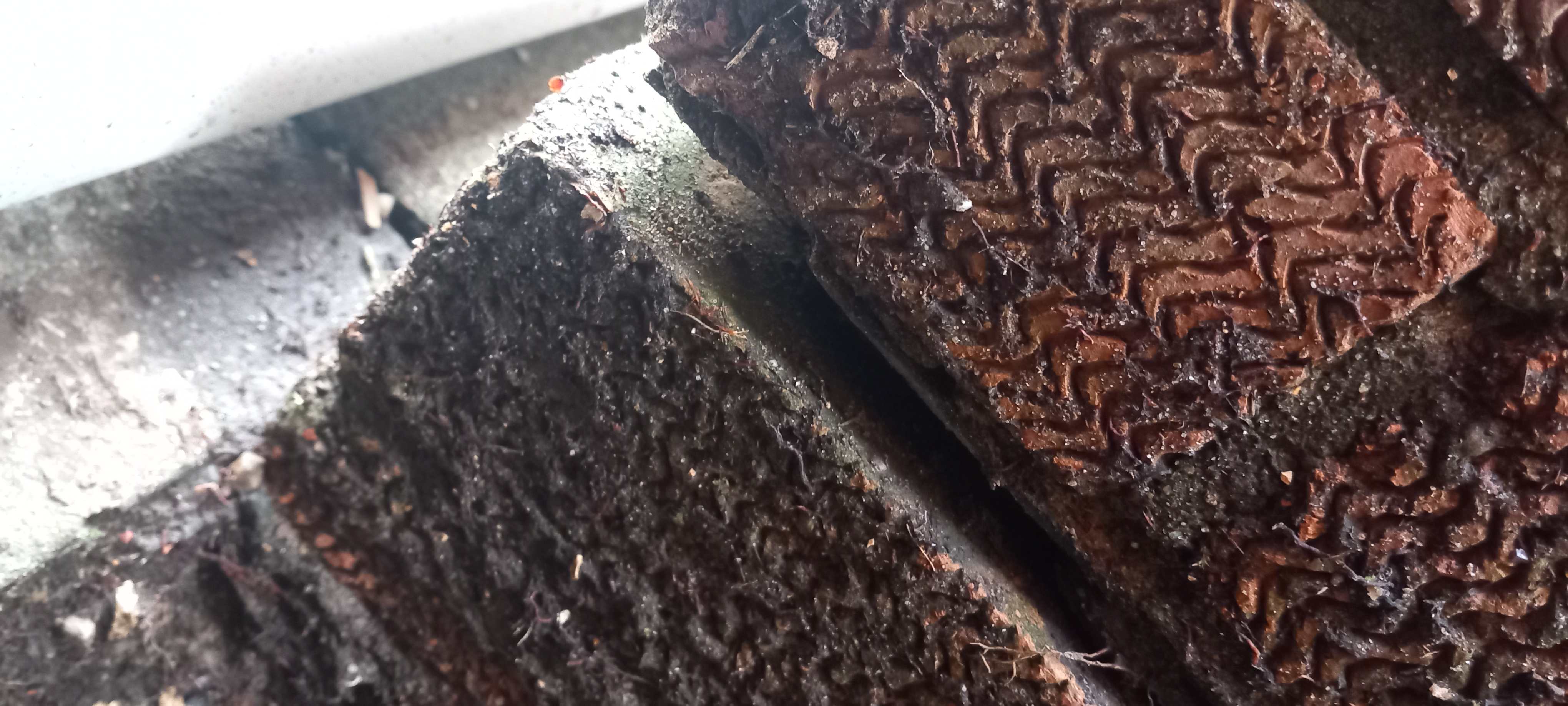

  4. Dee
    DPC Repair
    Pictures of damp issue
  5. Dee
    DPC Repair
    Thanks @joe90 DPC abit frayed but I'll take a photo tomorrow. The downpipe was solid moss on the same corner so water was spilling over to the ground and ingressing I think.....sound unlikely?
  6. Dee
    DPC Repair
    Hi I noticed while unblocking a down pipe that a chunk of mortar had fallen out of the DPC line....(hence the mould and damp in the adjacent room) Is it a simple fix? Do I just replace the mortar?
