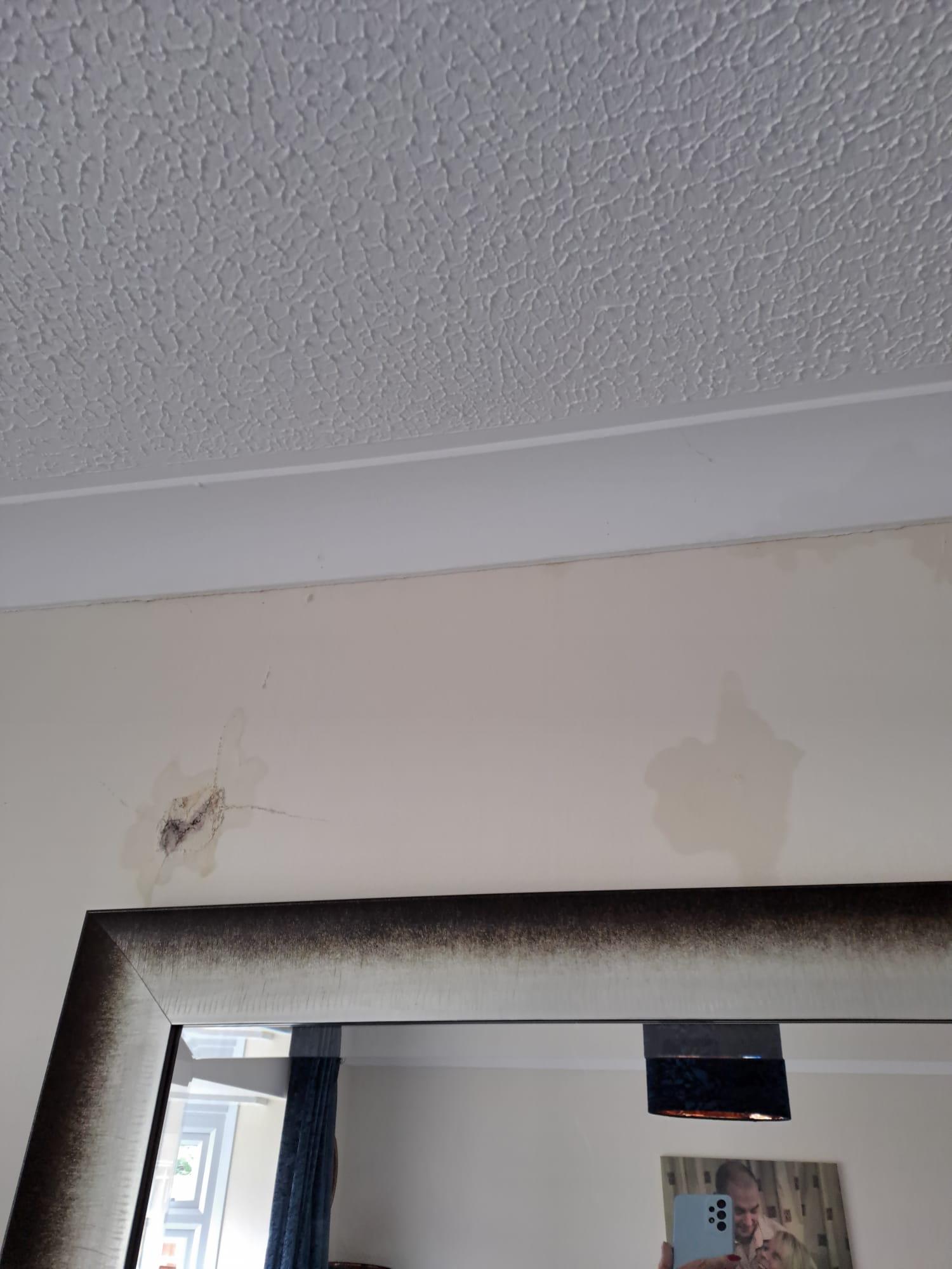

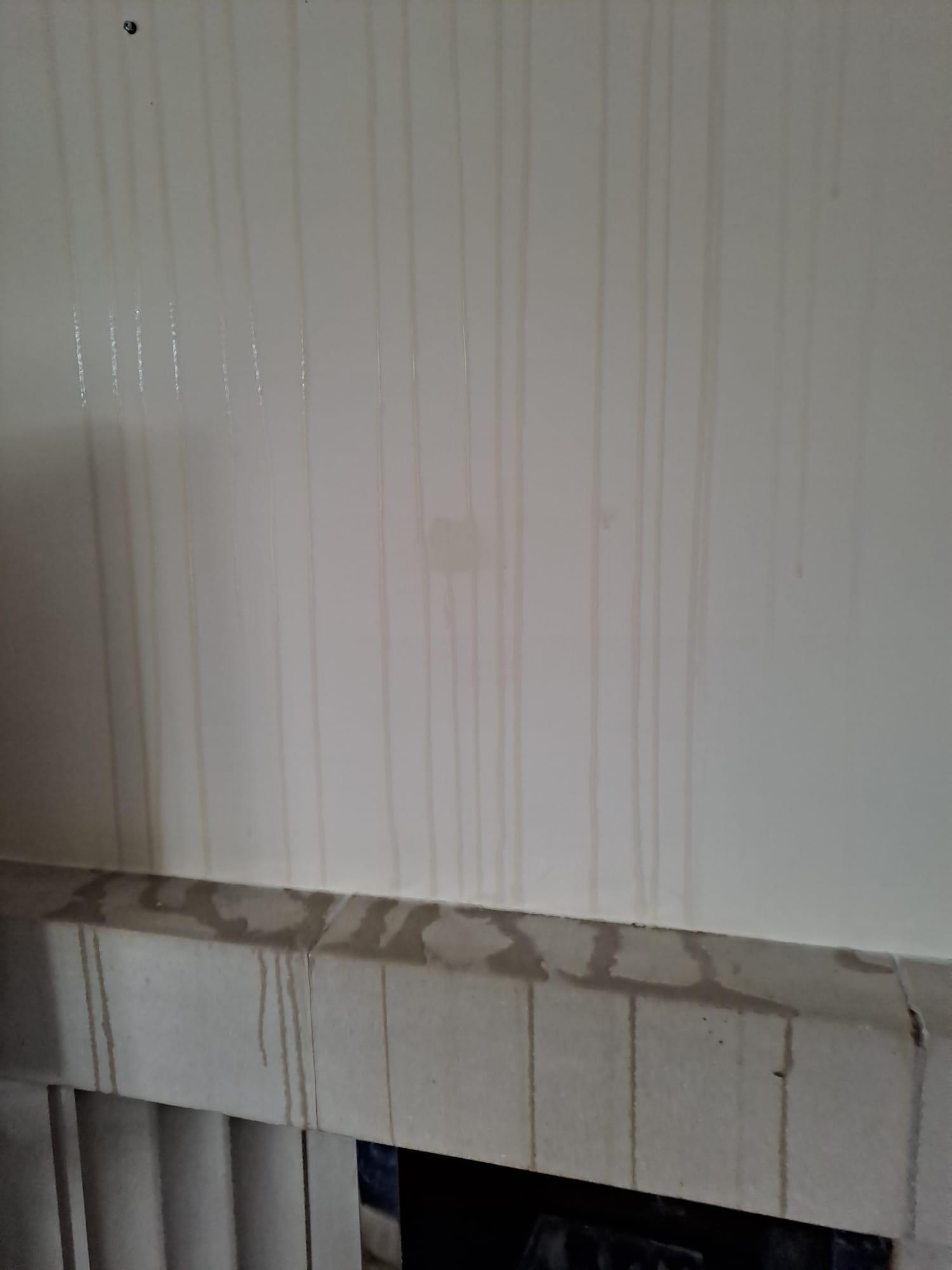

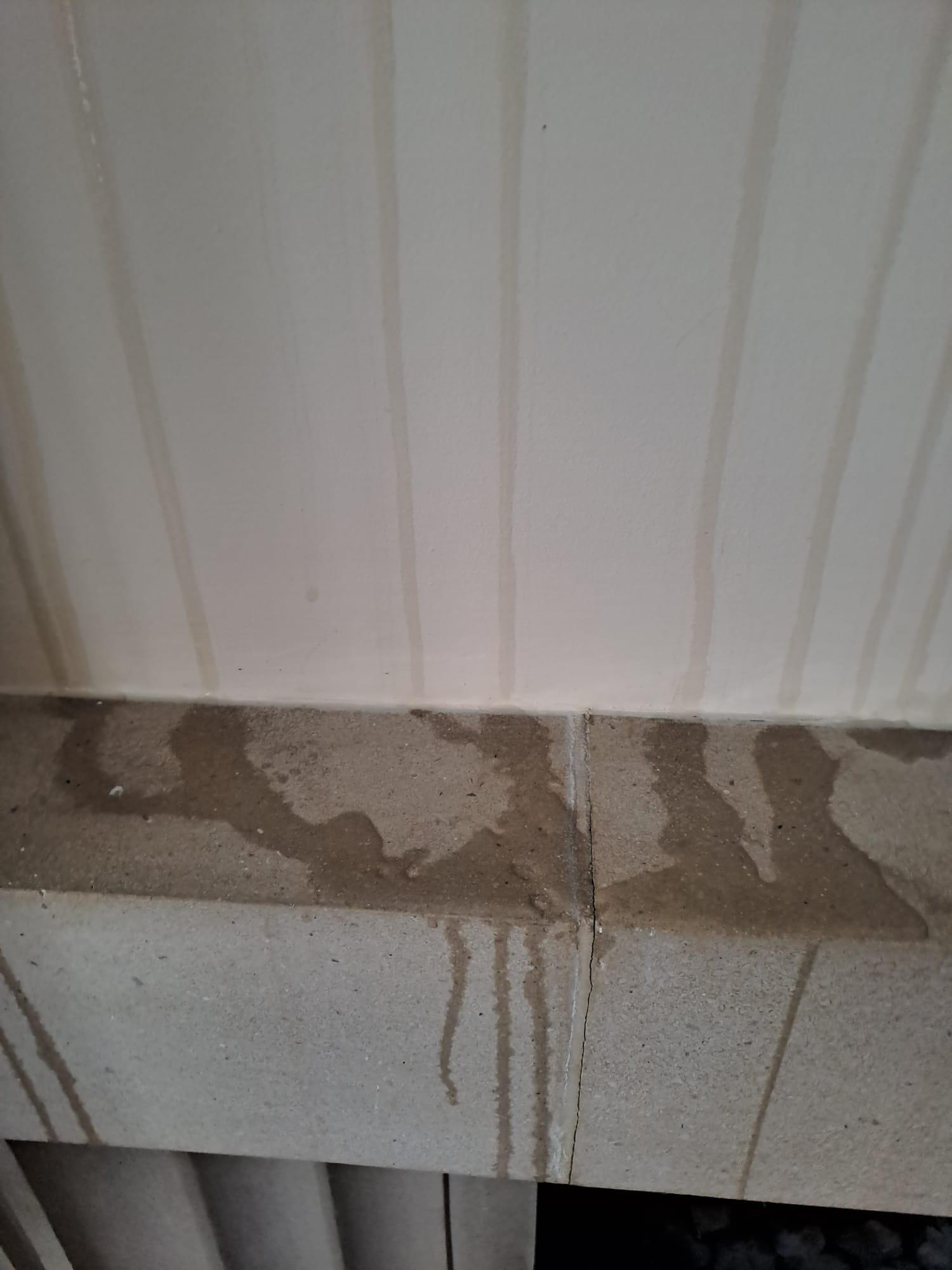

Hi I have a 1963 rental, traditional brick and tiled roof construction. Never had damp issues before ( we lived there for 18 months before renting it out) owned it fir 20yrs. Tenants have rightly complained of water pouring down from under the coving on the west facing wall. There is an external chimney breast. I can't see any evidence of cavity wall insulation and the flashing and roof have been checked....Any idea what's causing this and who would I go to fir a solution?
