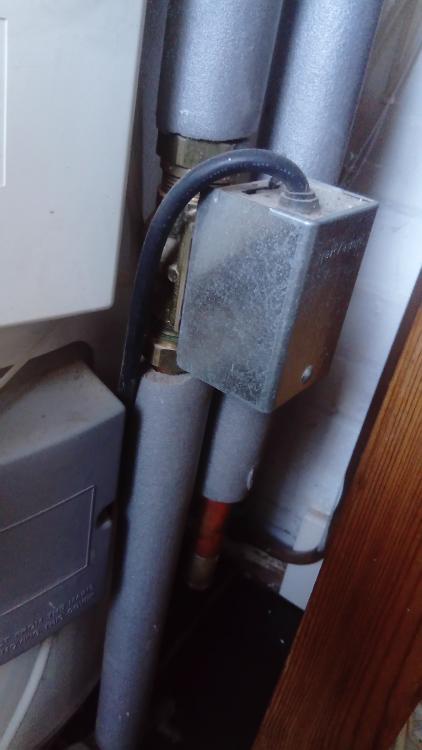

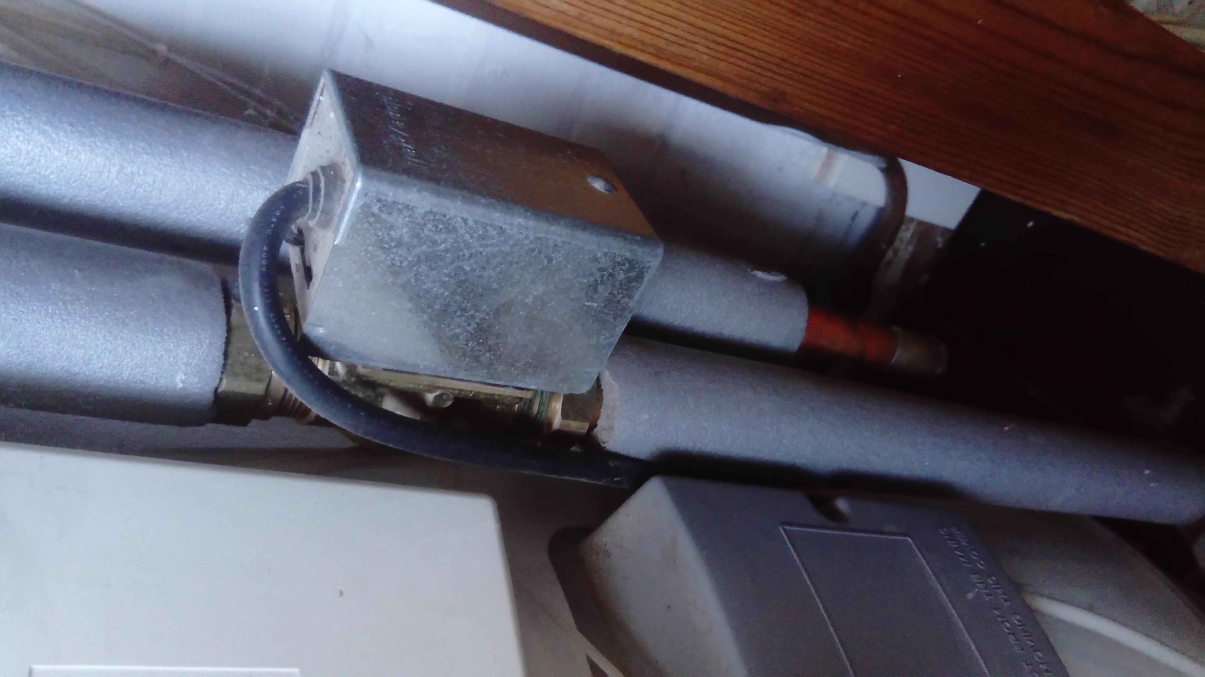

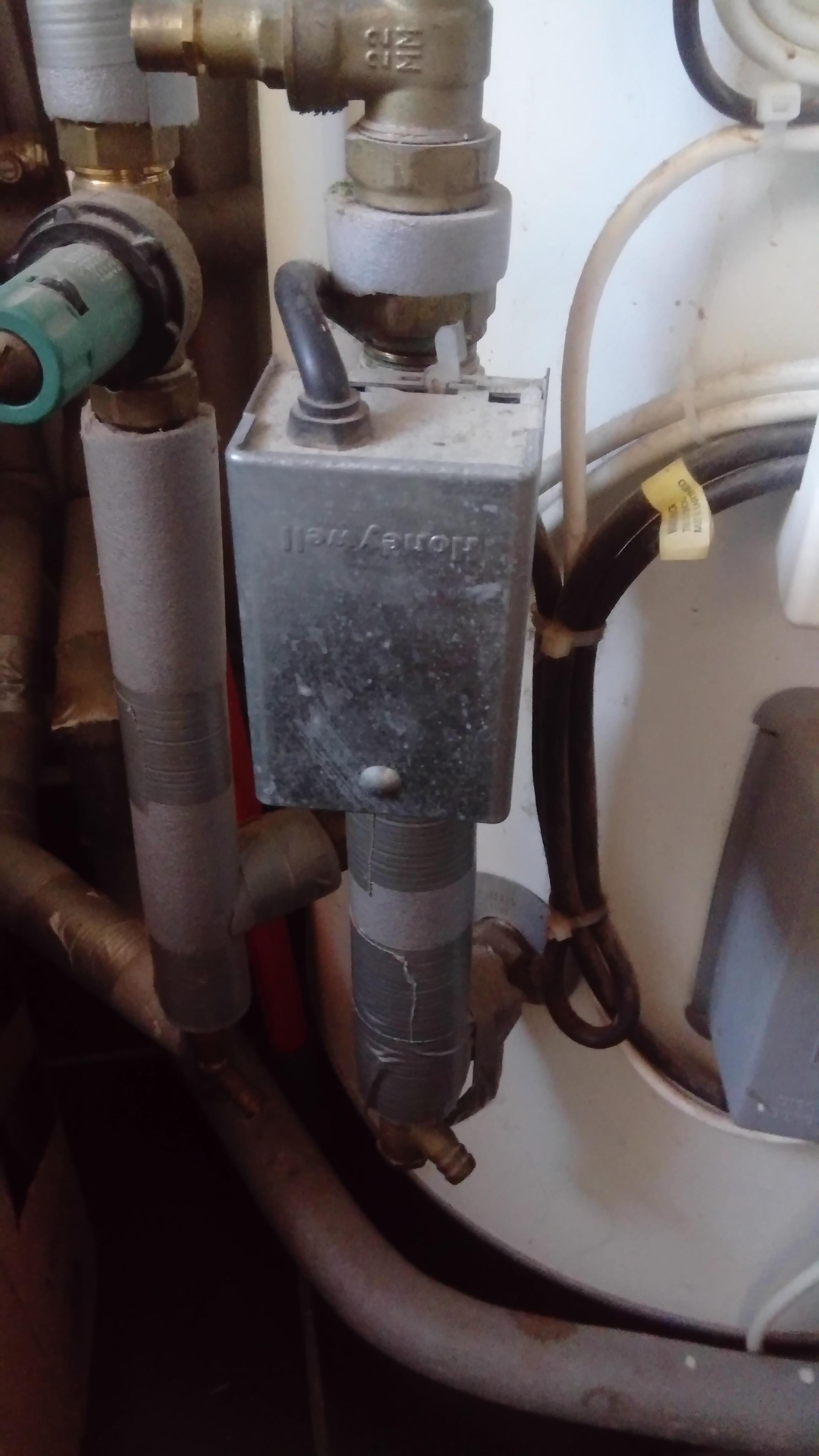

  9. @Nickfromwales Motorised valves? Can you describe what I'm looking for? ... Or should I get a plumber in? Thanks a gain
  10. @PeterW. There is a dial on the black box with 3 settings, it's set to 3

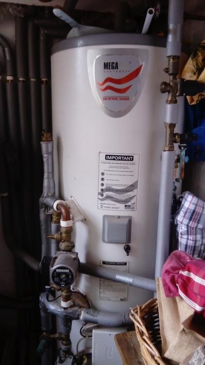

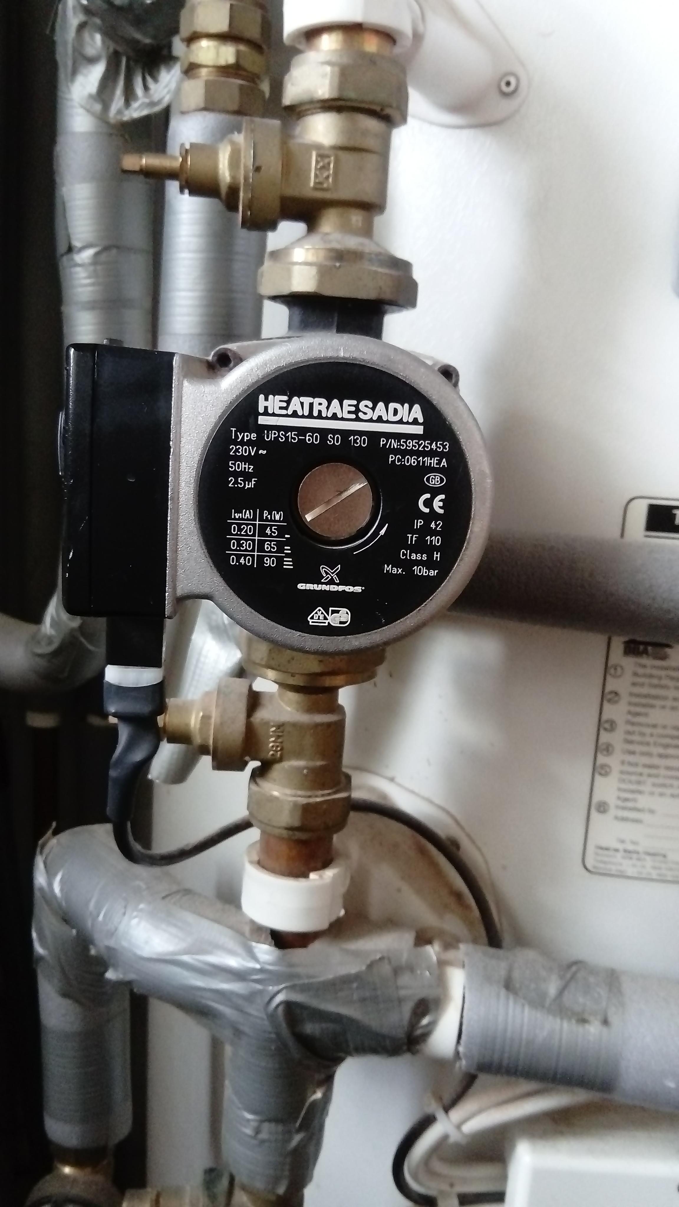

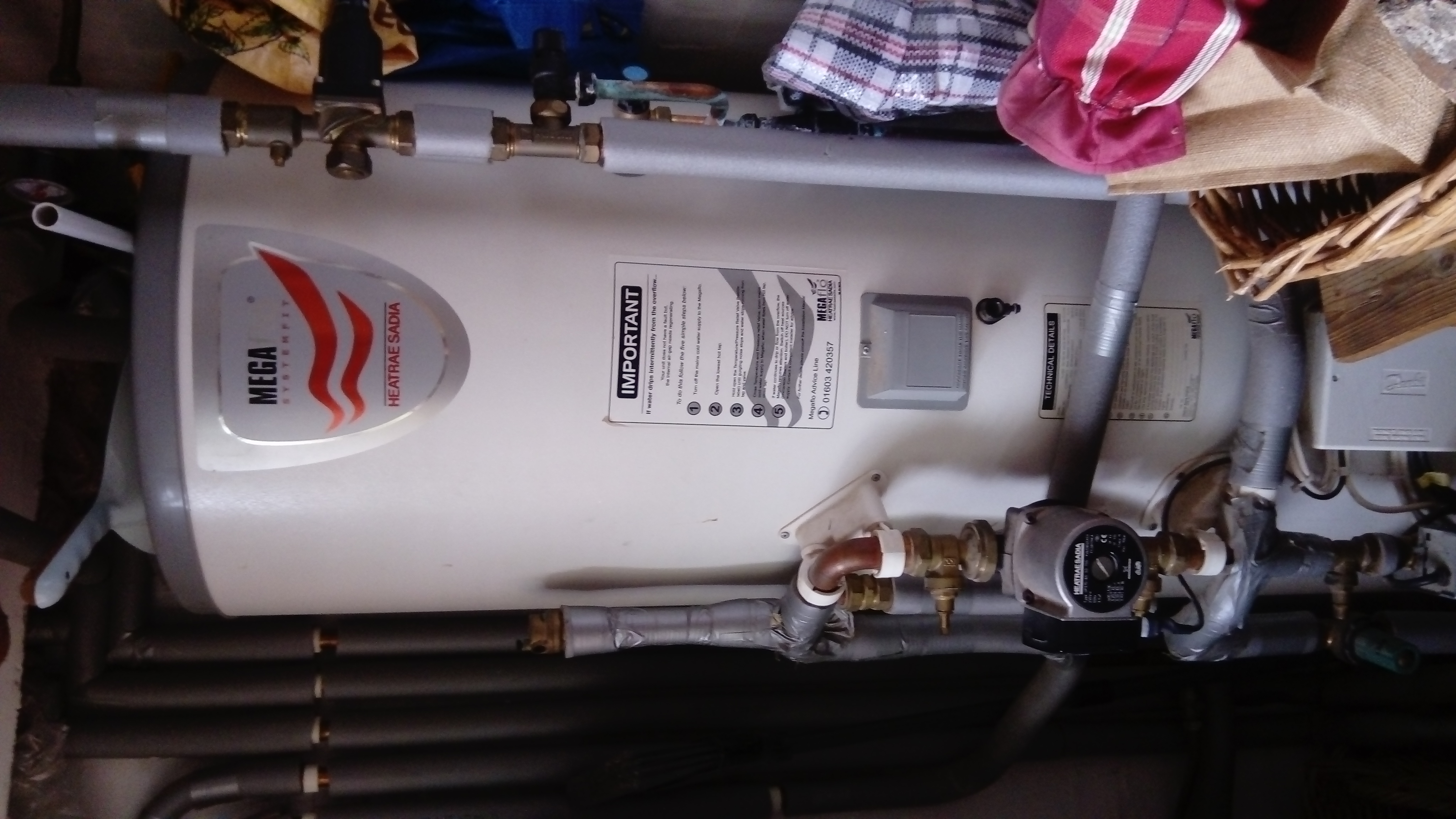

  11. HiTwo image of system and pump. How do I know if the pump is failing? It seems to run smoothly and silent... Never had any issues with it How do I turn it up and know that it isn't working too hard? Pressure gauge is set to 2 bar
  12. Two image of system and pump. How do I know if the pump is failing? It seems to run smoothly and silent... Never had any issues with it How do I turn it up and know that it isn't working too hard? Pressure gauge is set to 2 bar
  13. @dpmiller. I measured the temp across the pipes in each rad until the multimeter showed a variation of about 12 degrees and on the flow and return on the boiler.... I though that was correct? @PeterWall the plungers work fine, I don't understand why some rads shut down and others don't! I kinda know the route they heat up in but it's a big house and I get confused easily! @Nickfromwales It's a Heatrea sadia sealed system about 8yrs old. Pump seems fine although it gets extremely hot, hotter than the rads! Last night I turned all the rads off bar the coldest and furthest from the boiler, it did heat up but still warmer at the top than the bottom and when I turned about half back on it cooled down again... Go on what happened, you can tell me !!!!
  14. @PeterW. I've long suspected the TVRs were dodgy but haven't got the money to change them.... Or skill.... Is there a cheats way of balancing the system? Last time I did it I was meticulous, measuring temp between pipes ect, took me the entire weekend!
  15. Should of mentioned this, The rads farthest from the boiler are the coldest... If one heats up what does that tell me? One is certainly now warmer at the top but cold at the bottom also some rads that I have 'turned off' remain very hot
  16. System is about 8yrs old Heatrea sadia
  17. All TVR are working.... Will try turning off and see what happens
  18. I balanced my heating system a couple of years ago and all 15 rads worked perfectly but now some have ceased to heat up.... Cold at the bottom, Luke warm at the top. Pipes at TVR end are hot, pipes at lockdhirld end stone cold.... Any ideas?!
