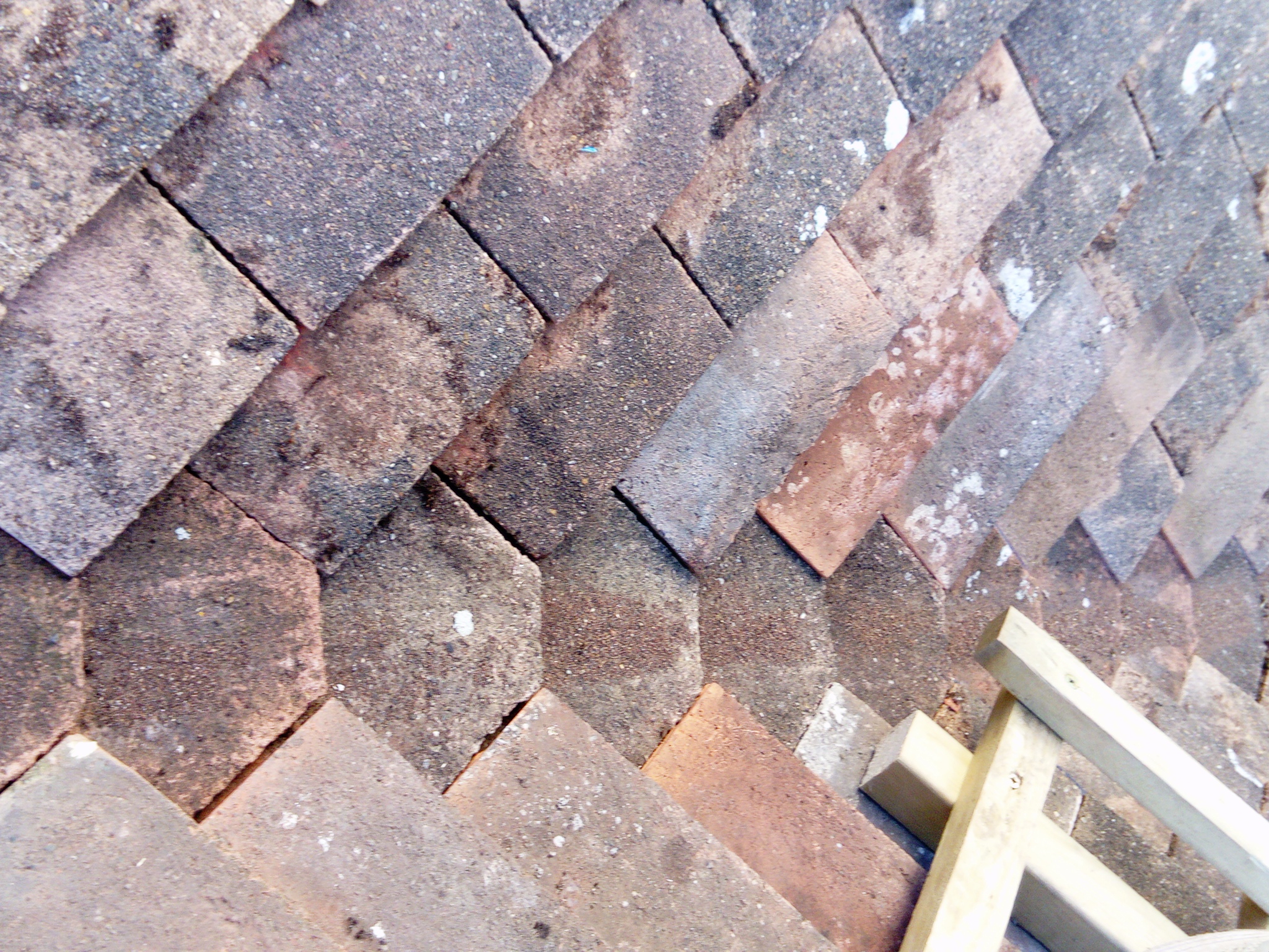

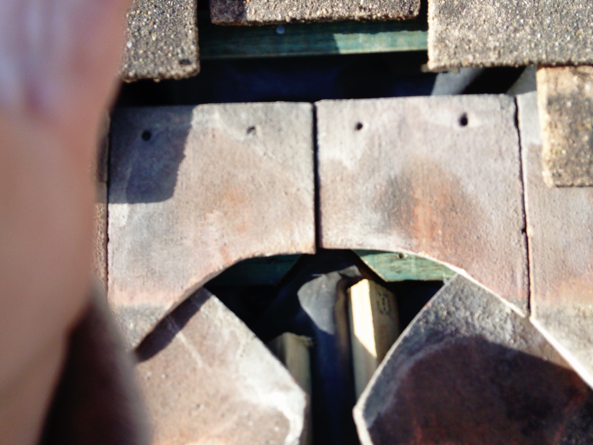

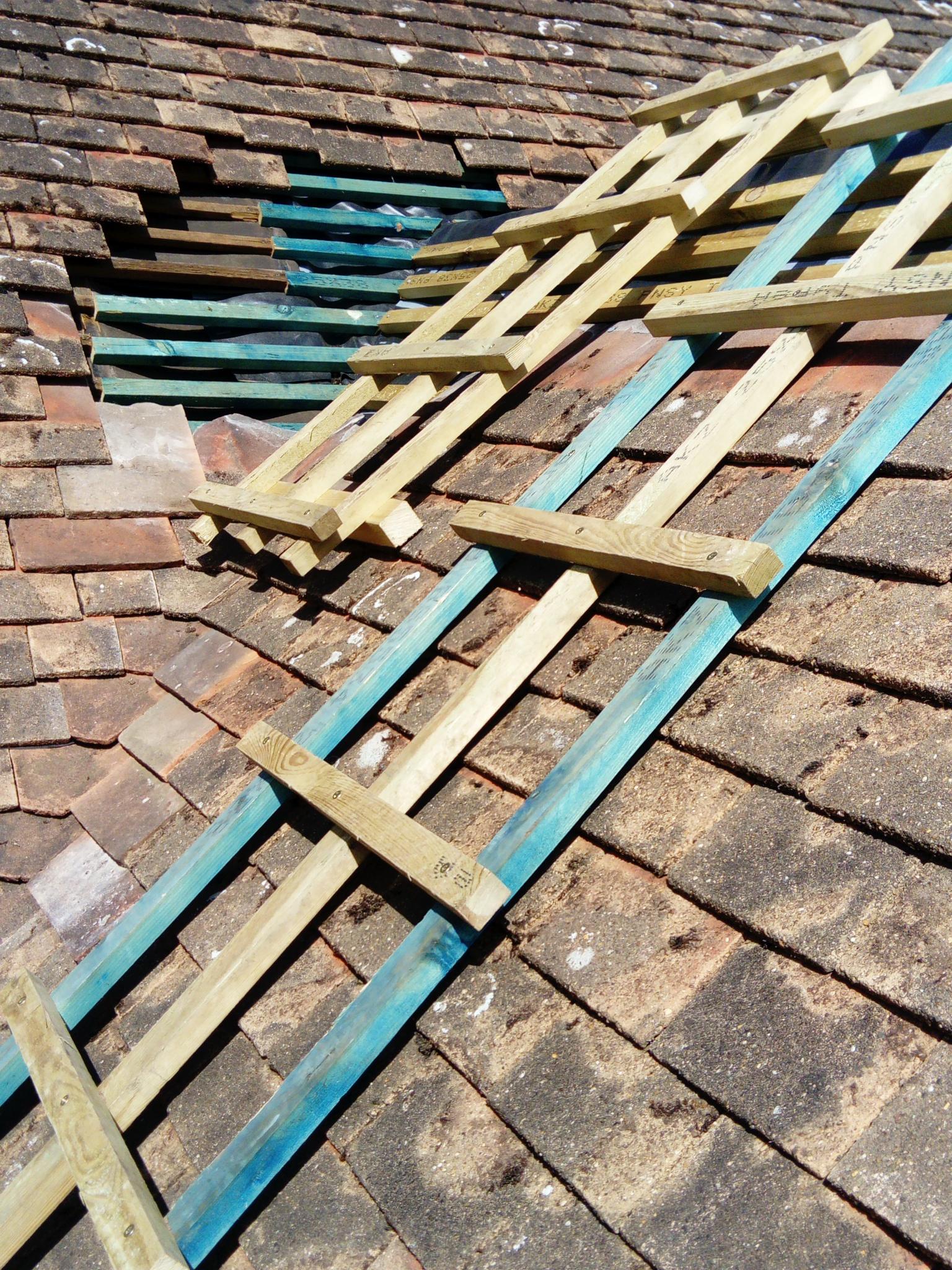

I've read the link... Is it the same process for valley tiles as I'm not doing a mitred valley. A roofer told me to put lead under just the first two valley tiles but wrapping around to tiles either side

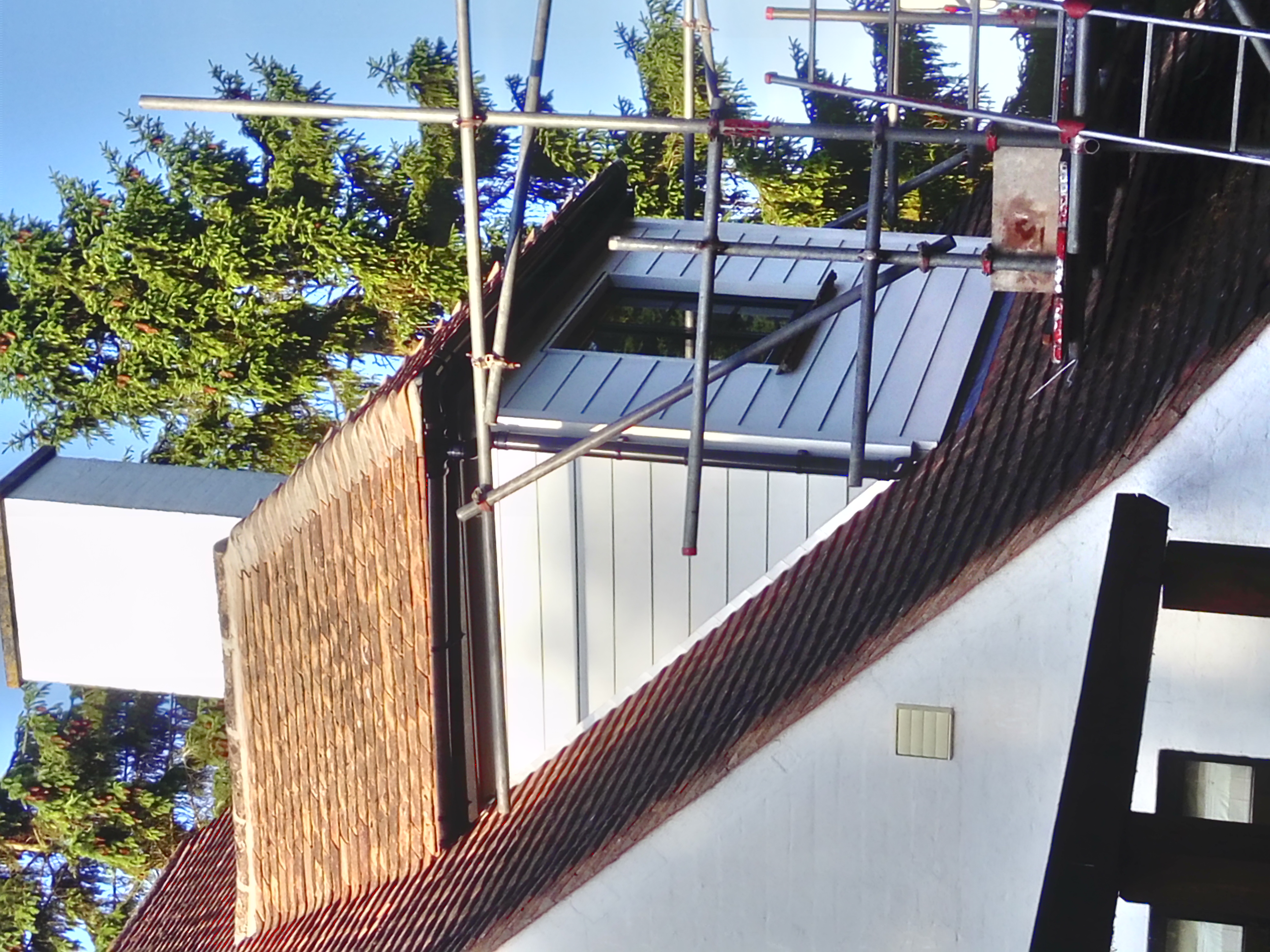

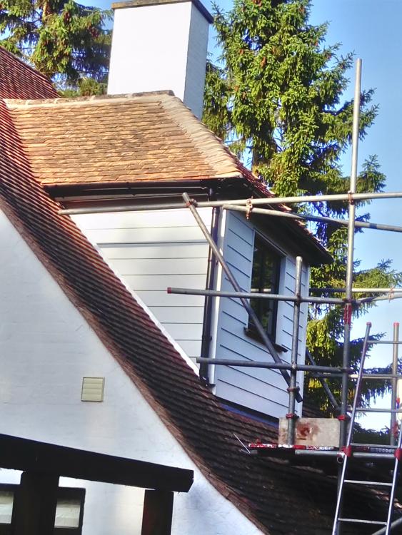

So just to get you in the loop... I'm building a hipped roof dormer. The cheeks will be clad with hardie planks. I imagine the ply, battons and cladding will overhang the tiles on the main roof below... Will I still need soakers?
Hipped channel? Can you expand please .... I'm a complete amature and feeling my way through this particular roof
