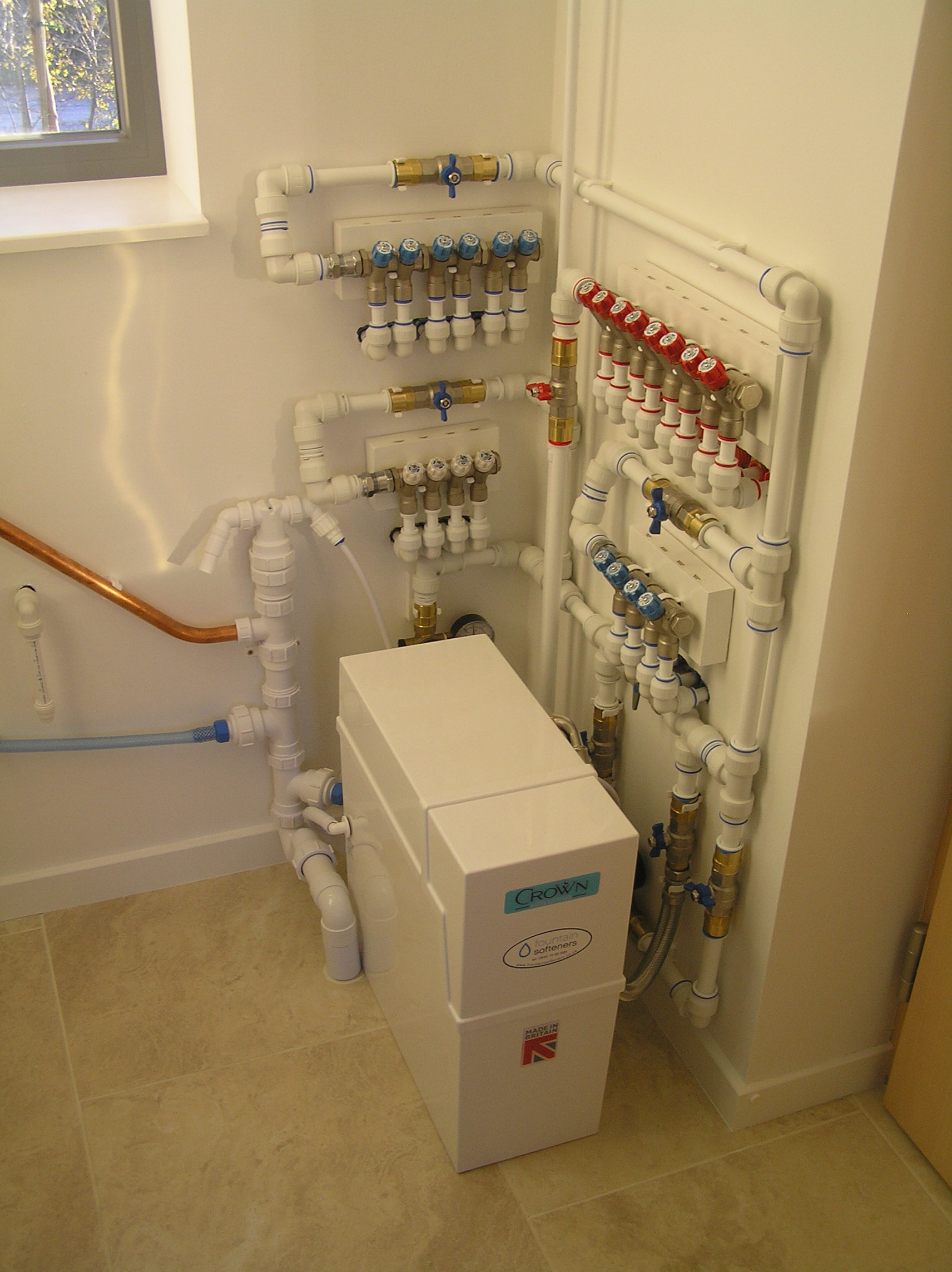

  1. I used it for all my pipe runs from the manifold to the various appliances. You can just see the red ducting for some of the hot water feeds.
