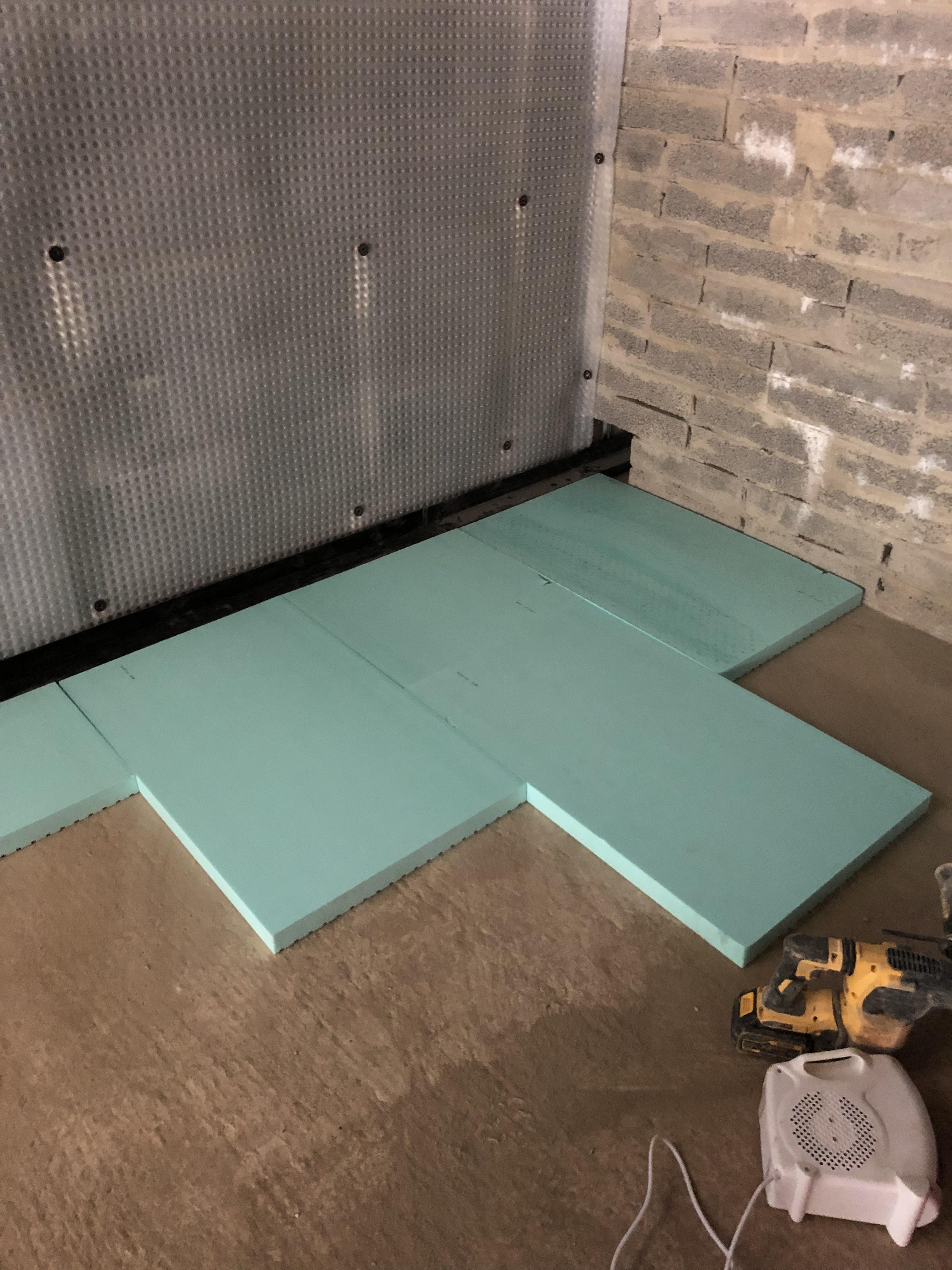

  4. Just testing out the fibran board . Presume you stagger them . No t & g - seems a bit crap really

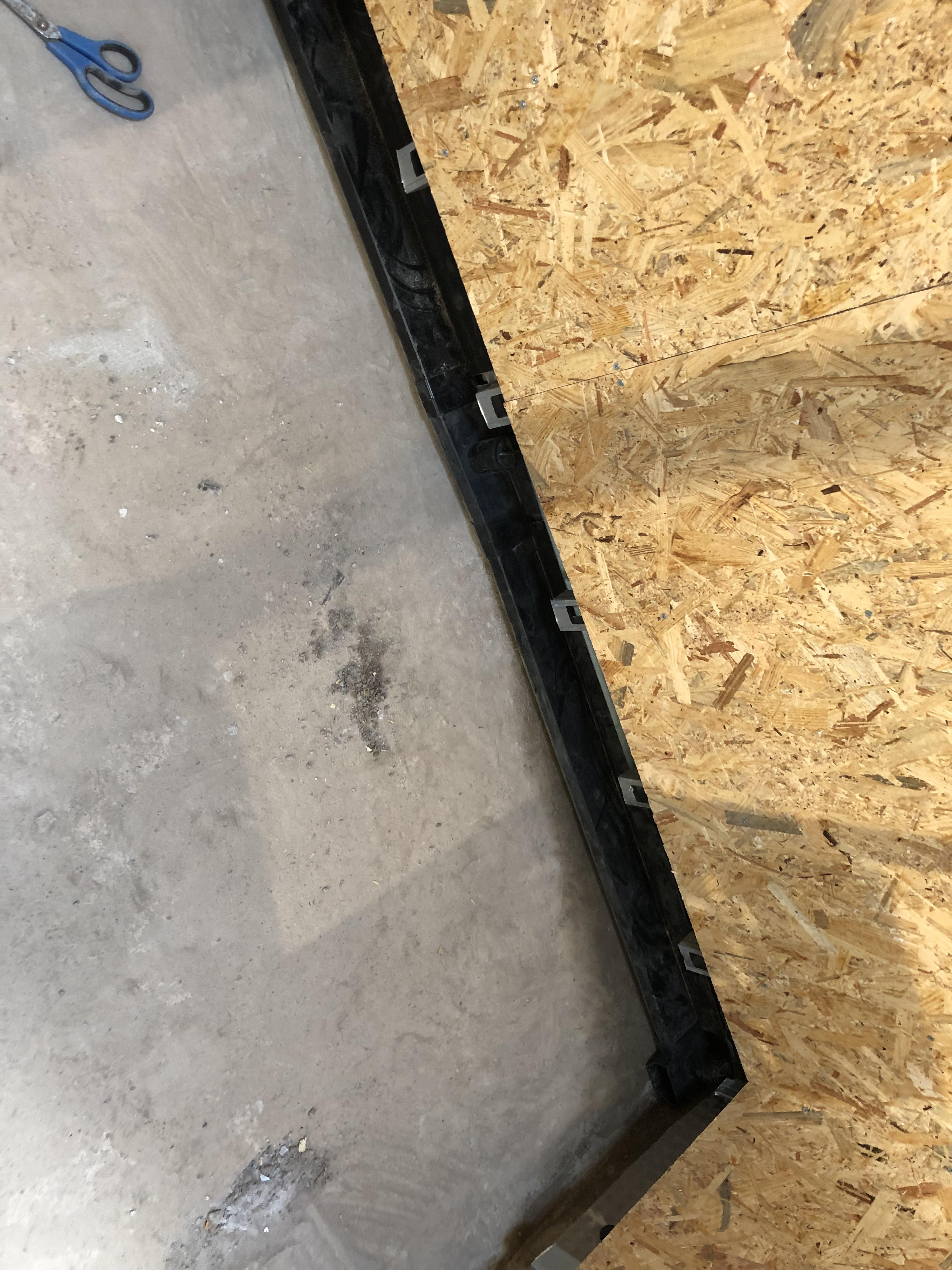

  5. Pipework in minus stop tap ; they posted the wrong size ? Perimeter drain going in . The ‘rodding ‘ holes are a bit pants . They sit in the drain so literally will be in the stud frame . Can’t worry about that for now - have to make a nice access hatch I guess .

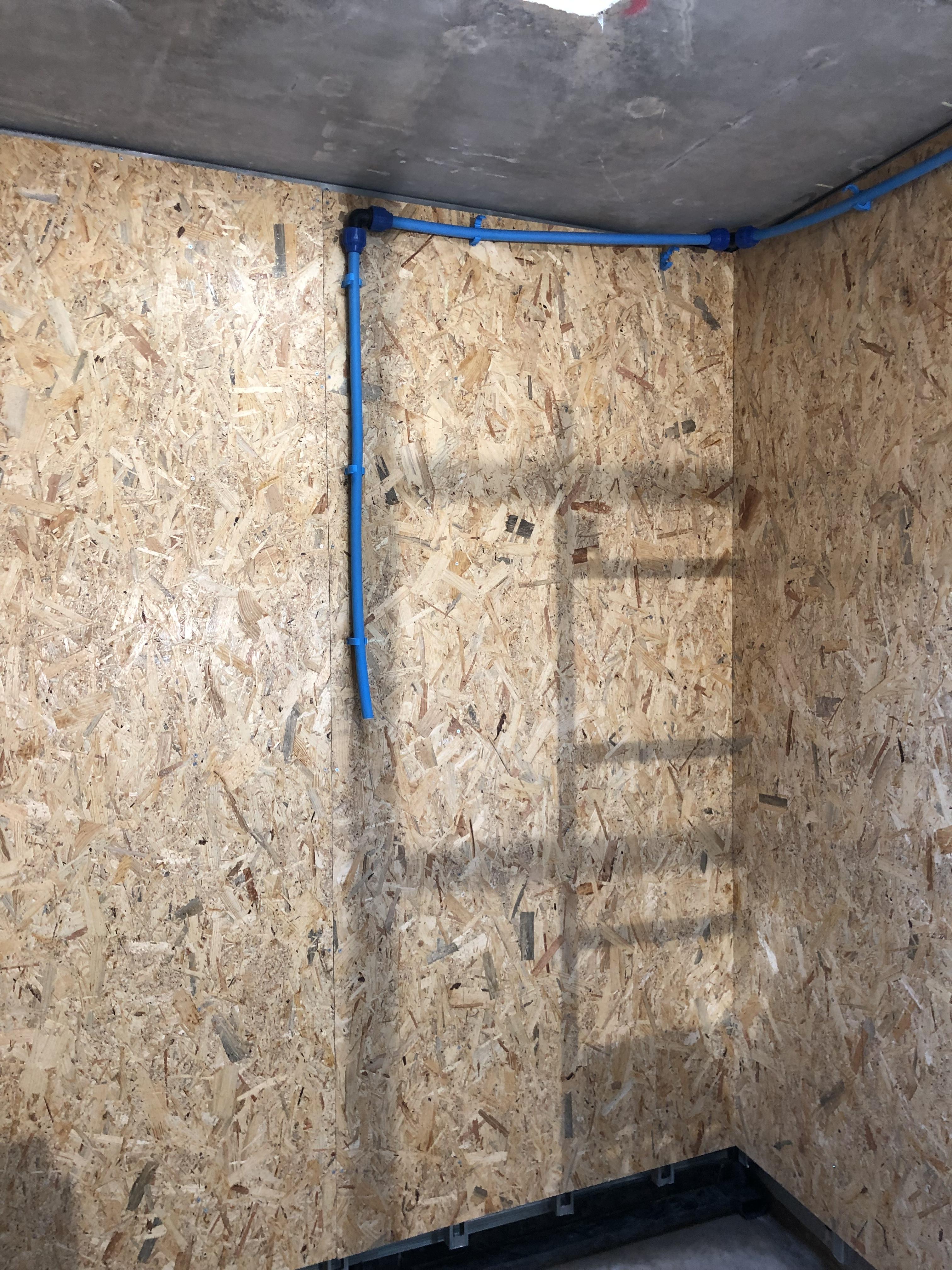

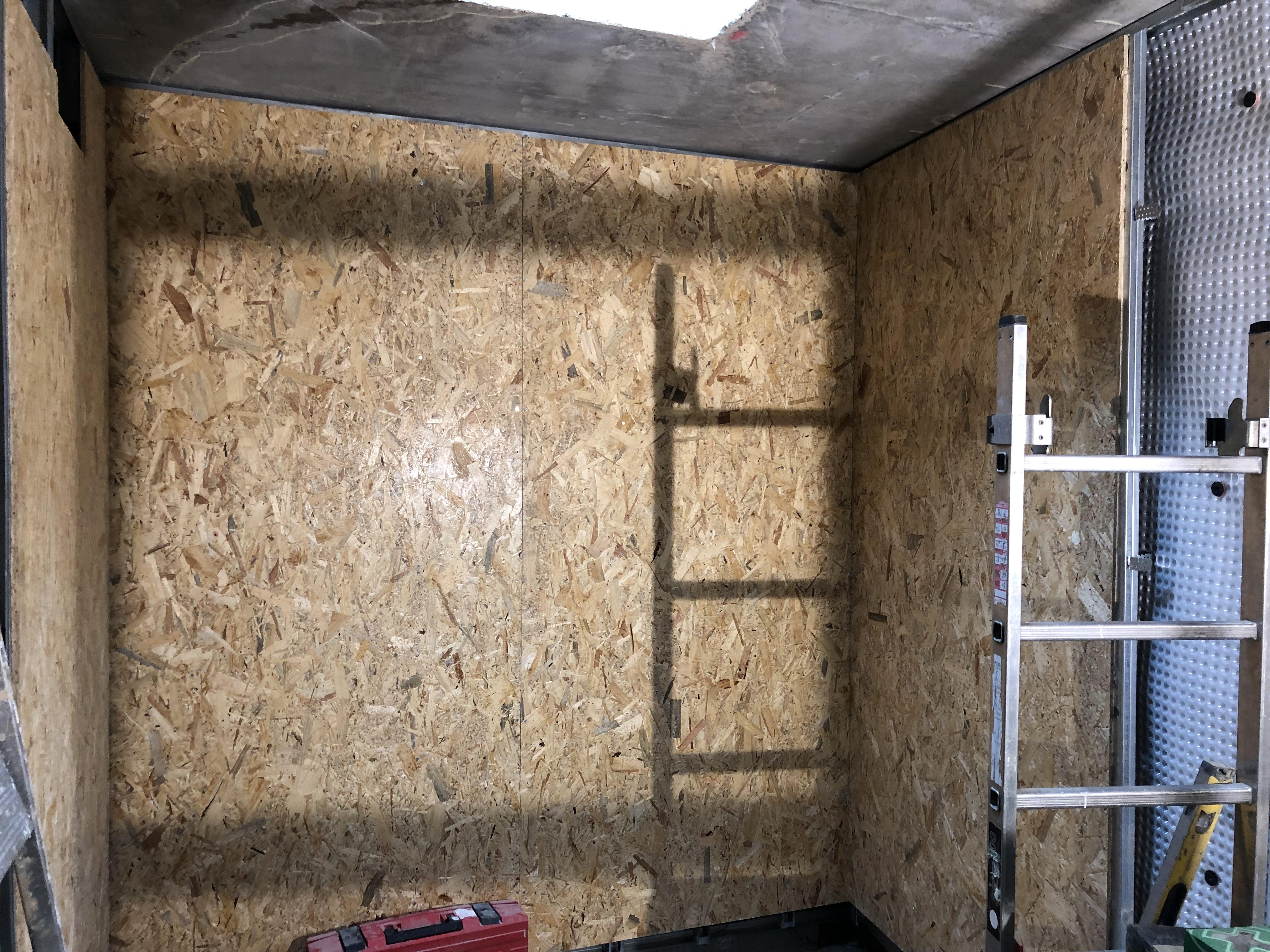

  7. Ta da ! Thats all the stud and osb I need to do for now ! Tomorrow re route water inlet onto this osb . Install perimeter drain . That bits then done ?
  8. I could . But we have some leaks as you know . Also ufh manifold , uvc tank all going in this corner . Rather the guys fixed to my osb than drill through the membrane . They also requested this be done . wont pb this corner , no point , will ultimately be in a cupboard On the rest of the house underground think I would still do osb , with pb ontop - just feels more robust .

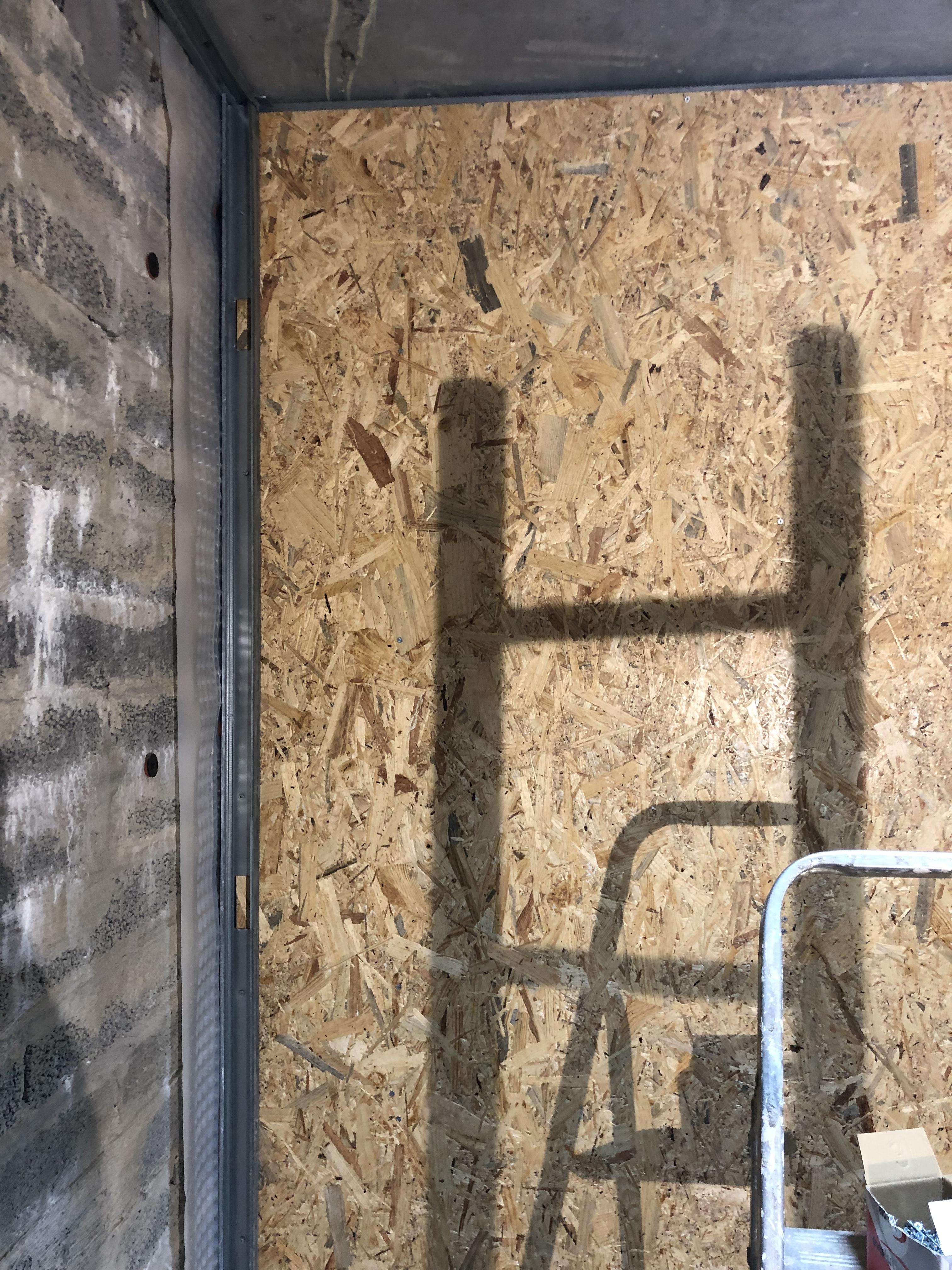

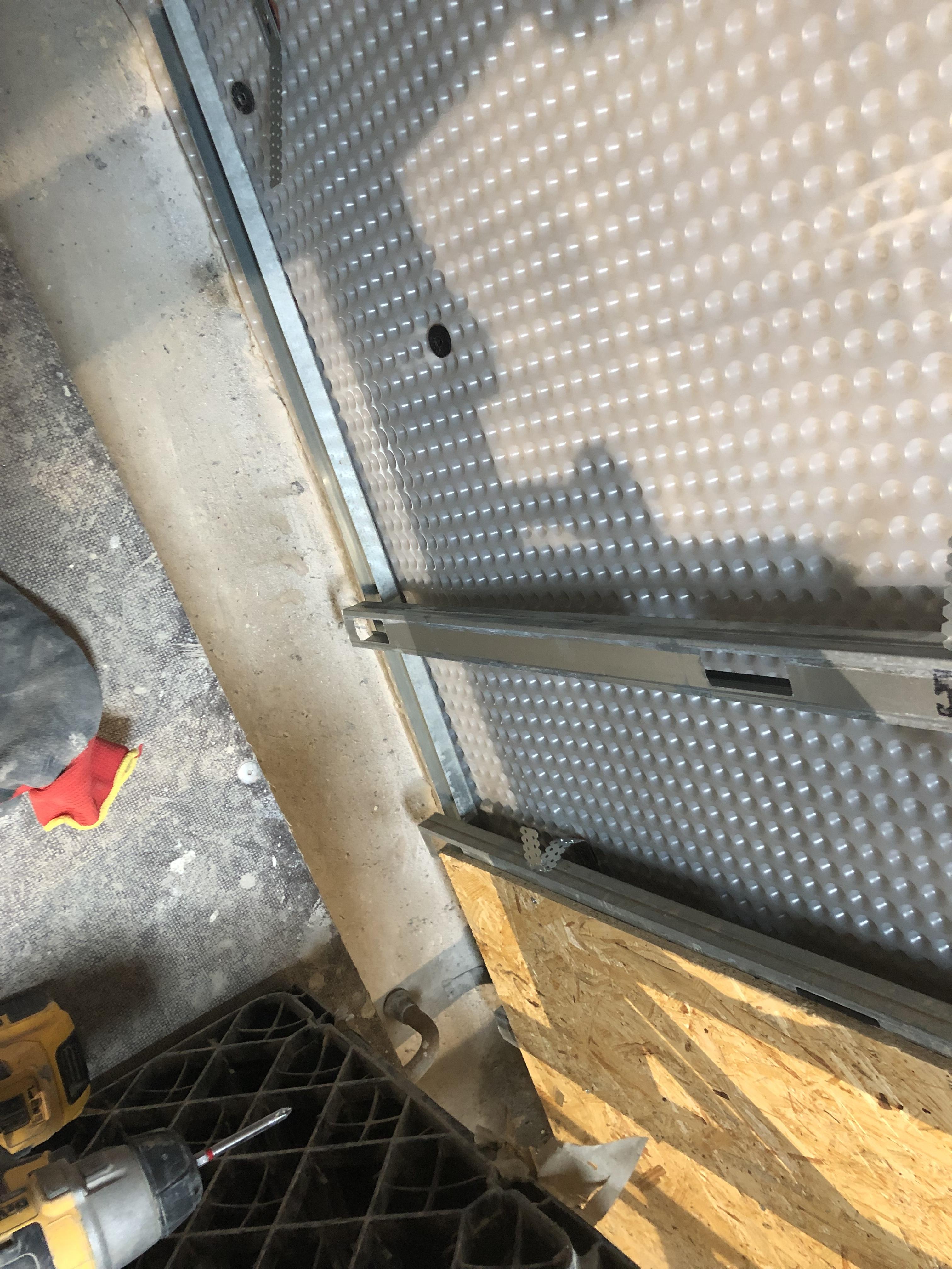

  11. Doing the returns Track now around the correct way . Improvised again for fixings ! Bit like mechano this stuff
  12. Doing better today as I get used to it . When screed is done and I have top and bottom track with no fixings to the wall - I can see it’ll be a breeze !
  13. Real neat ! i think you’ve done this before a few times ?
  14. So i’ve Improvised a horizontal bit at the bottom just for peace of mind .

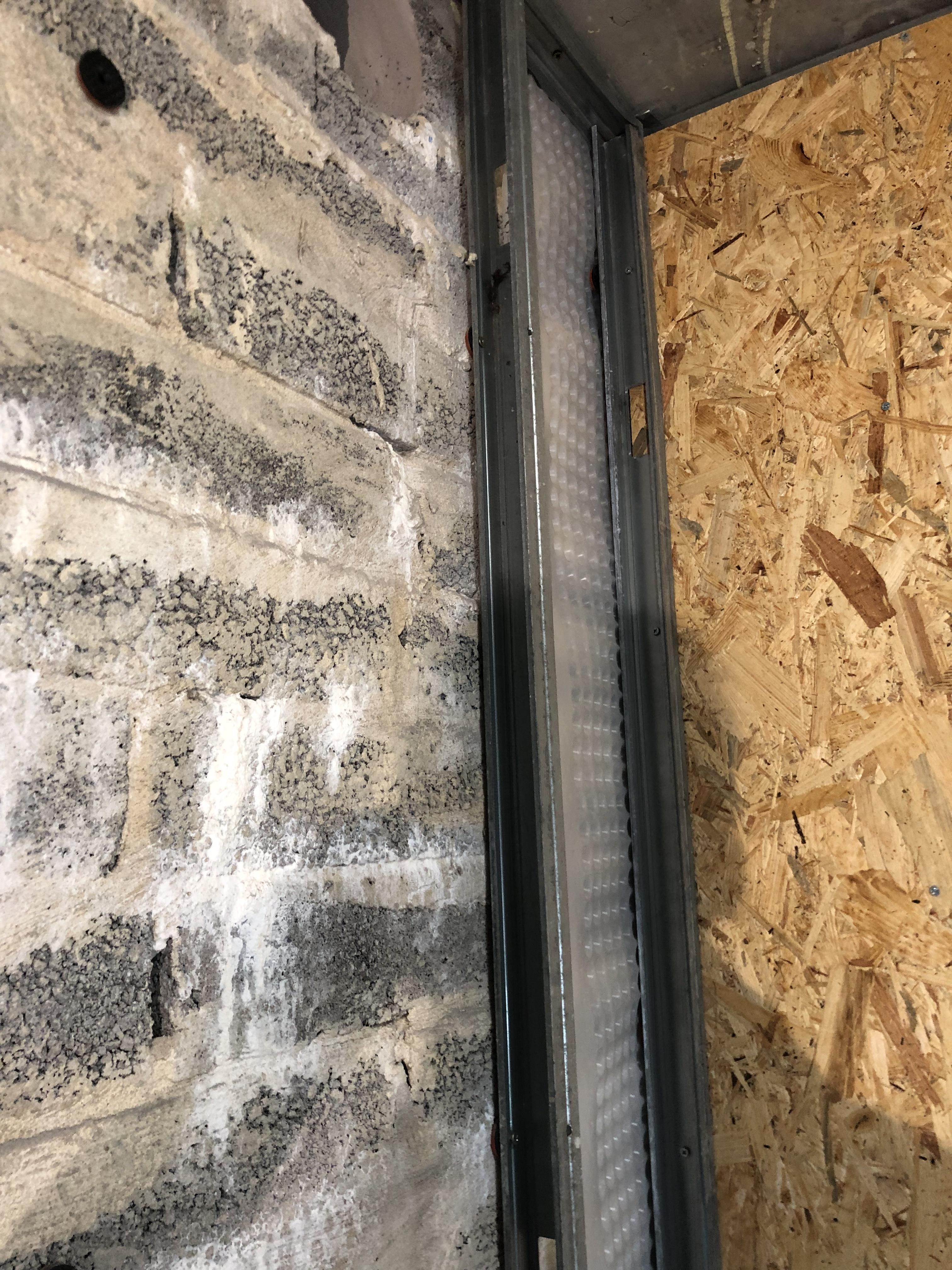

  19. I guess you could argue that condensation could occur with the horizontal ceiling track against the concrete ! . There will be a suspended ceiling as well .

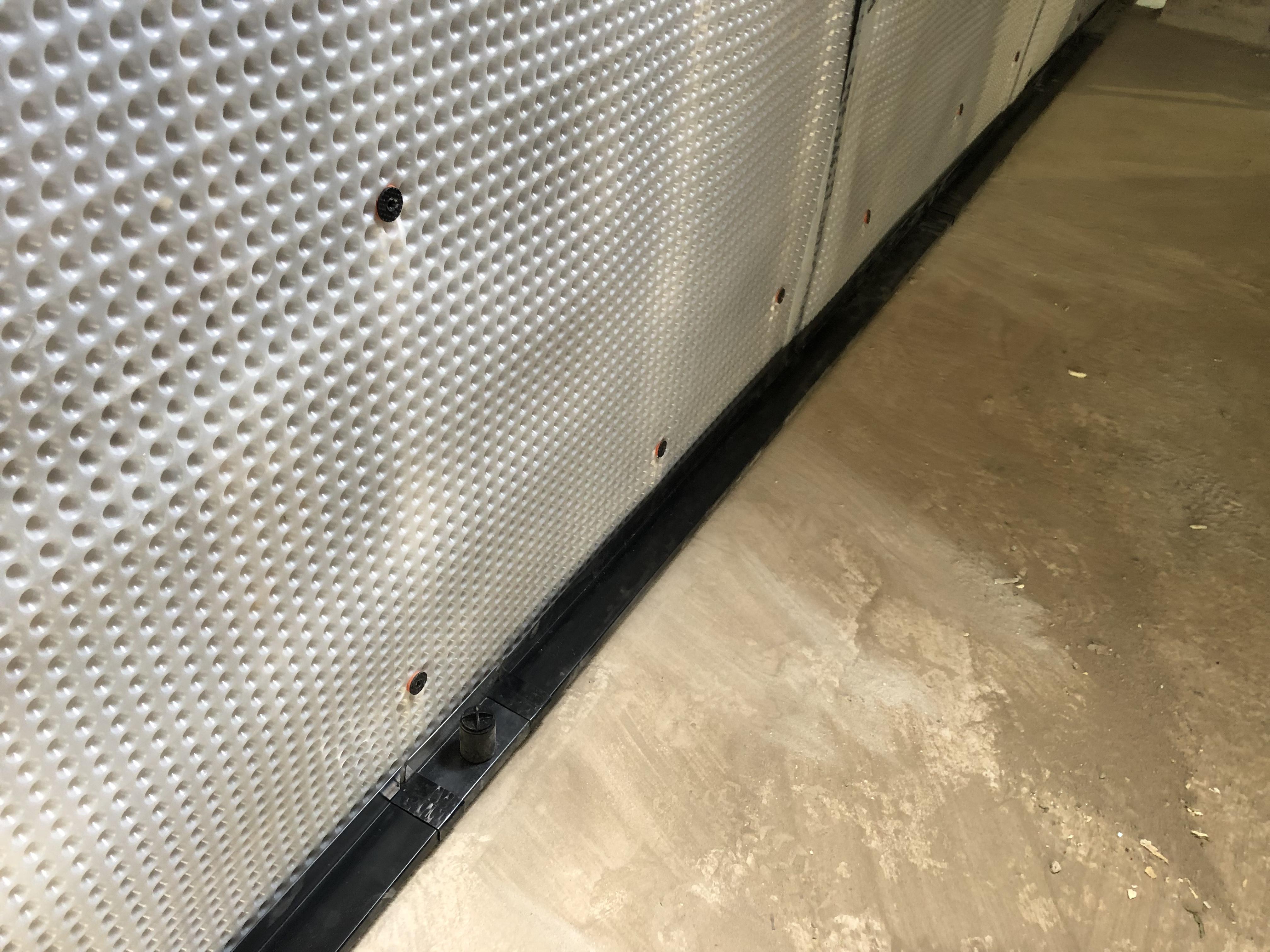

  20. Here From this angle you can see the gap
  21. Yes there’s a gap . The membrane isn’t perfectly flat to the wall so you probably can’t see the gap . gaps about 1.5 -> 2cm Theoretically all moisture should be only behind the dimpled membrane- that’s its purpose .

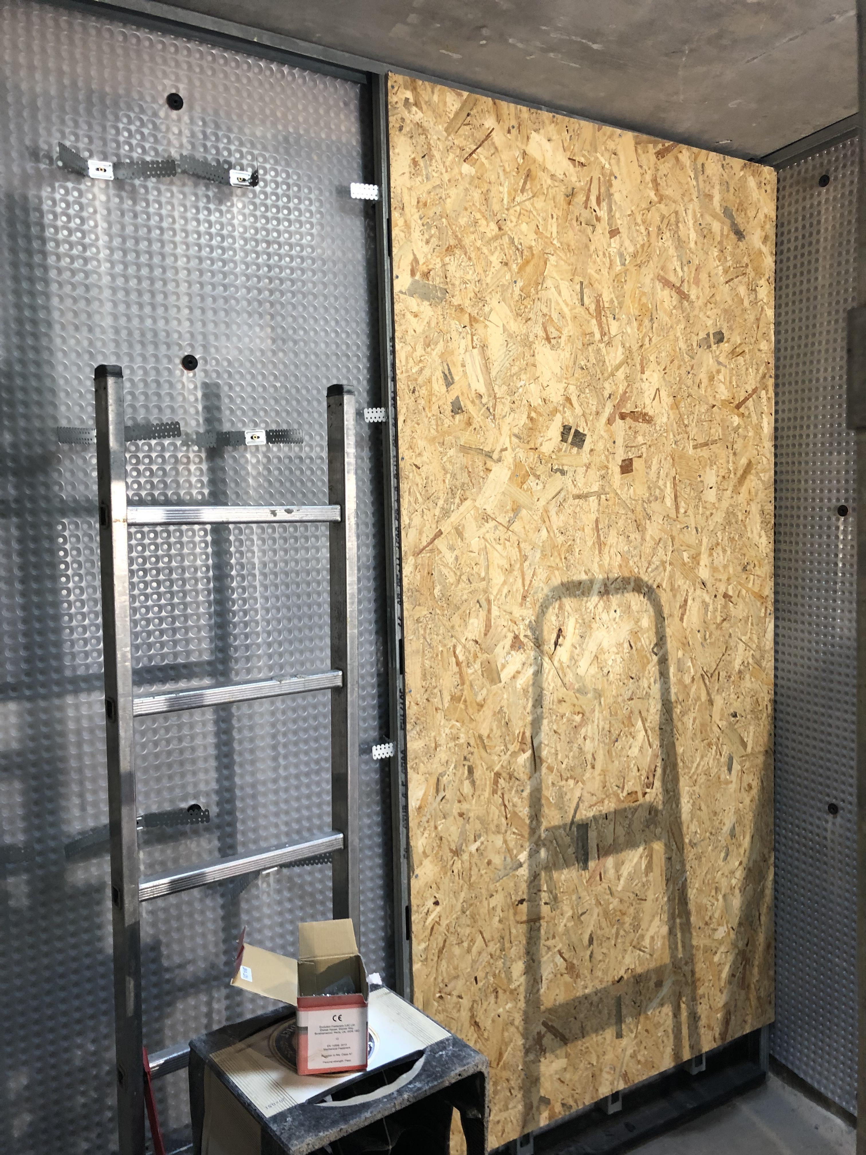

  23. I’ve improvised due to lack base channel and confusion!! Still prefer to have the glypliner brackets just need the correct system! . Was using track I had lying around . Guess there are different systems..... I only need another 10 verticals which I've order from local builder merchants. As it would seem there are different systems it will be interesting too see what turns up!
  24. Well this is what confused me ! it I rotate them ( like in an earlier photo ) the glyplier bracket can only attach to 1 side which is wrong . This way does appear stable ....
