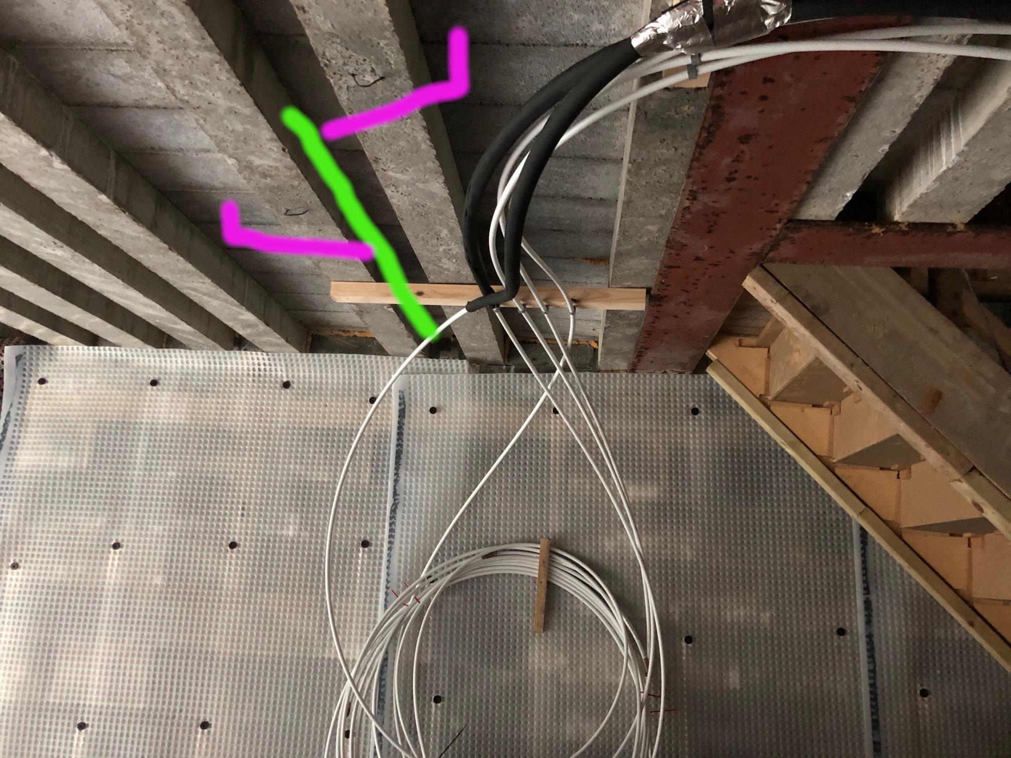

  22. ? Some cables are crimped as stranded cat5 ; some or keystones as solid core cable . I prefer the patch board as it means the cables won’t hopefully get moved - so any unplugging etc . Done by patch cables ( pre bought ! Didn’t fancy making them )
  23. Almost half the cat5 cable in . Pretty colours help !
