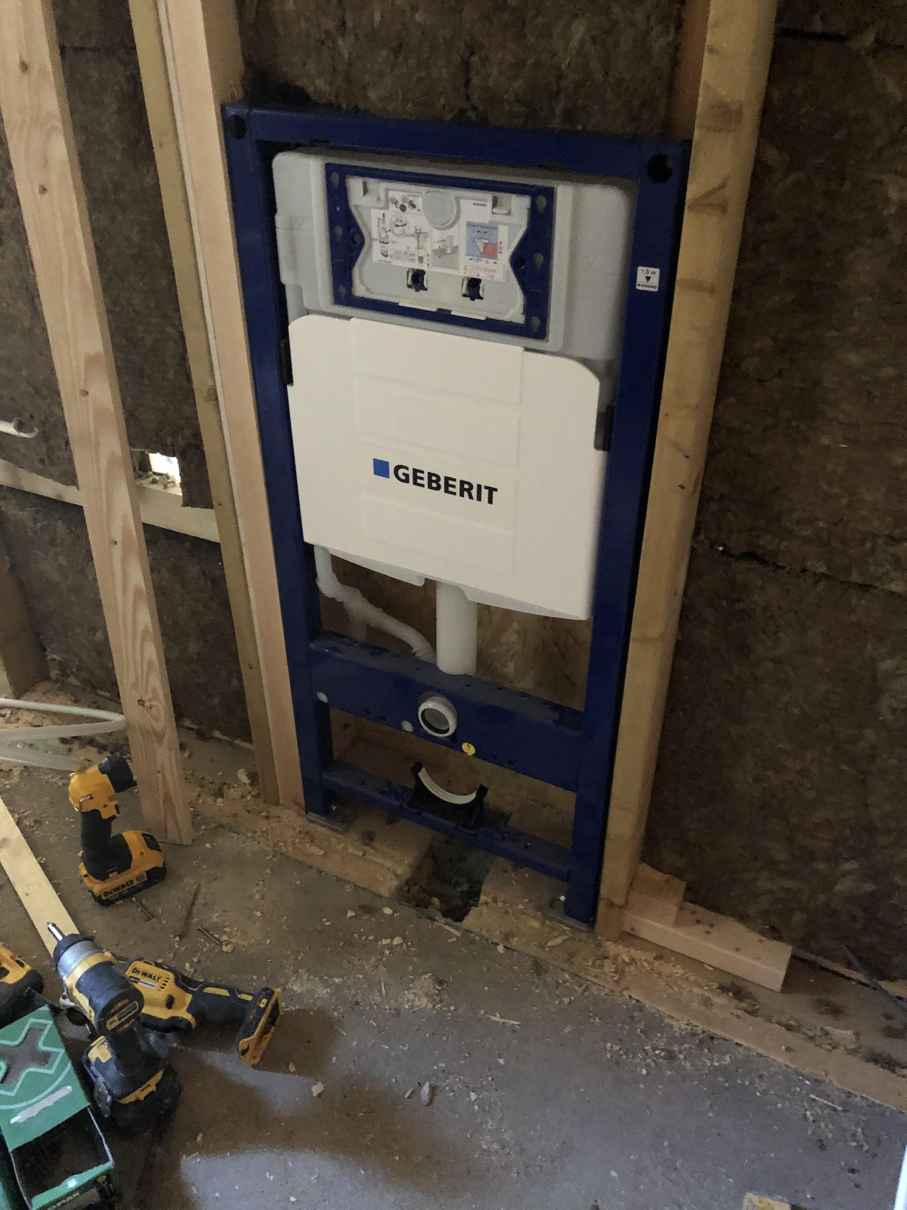

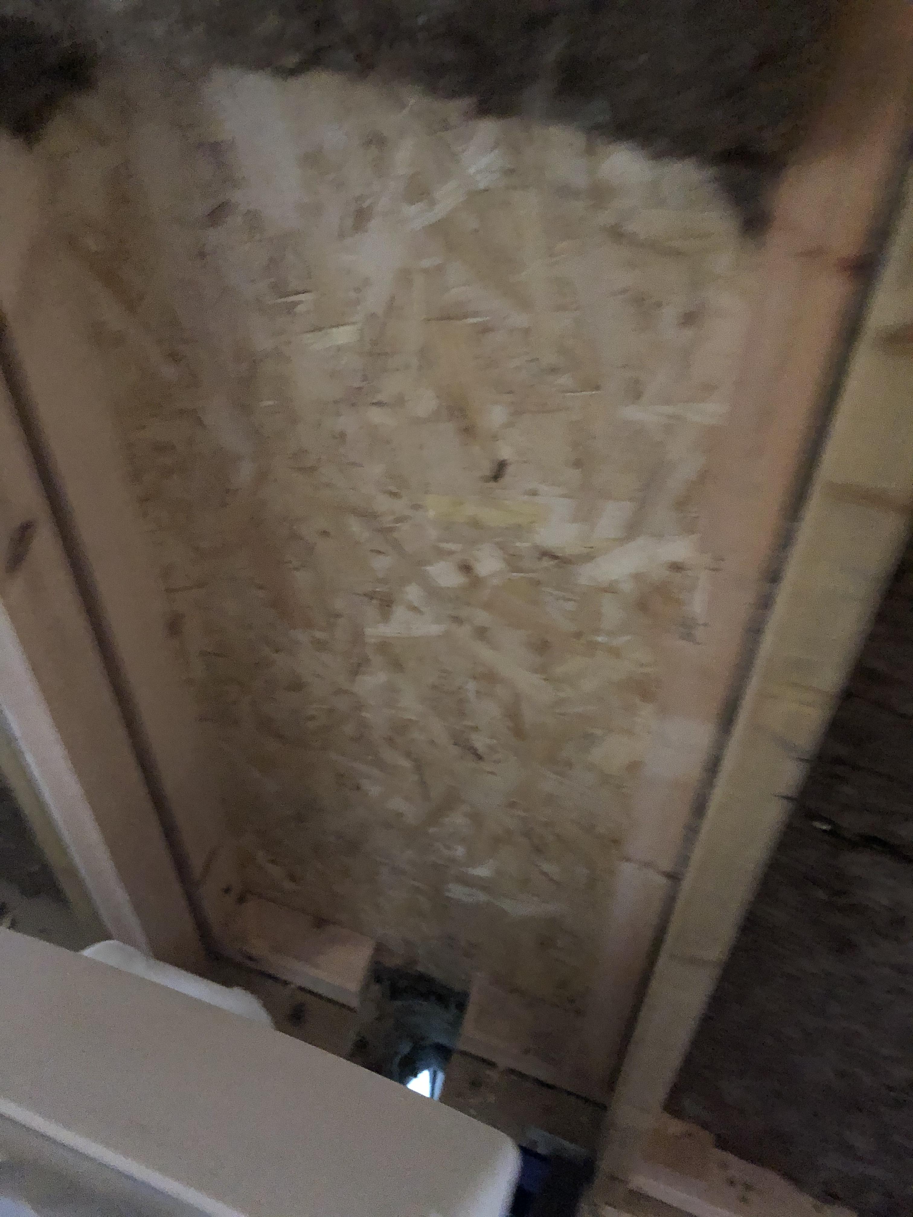

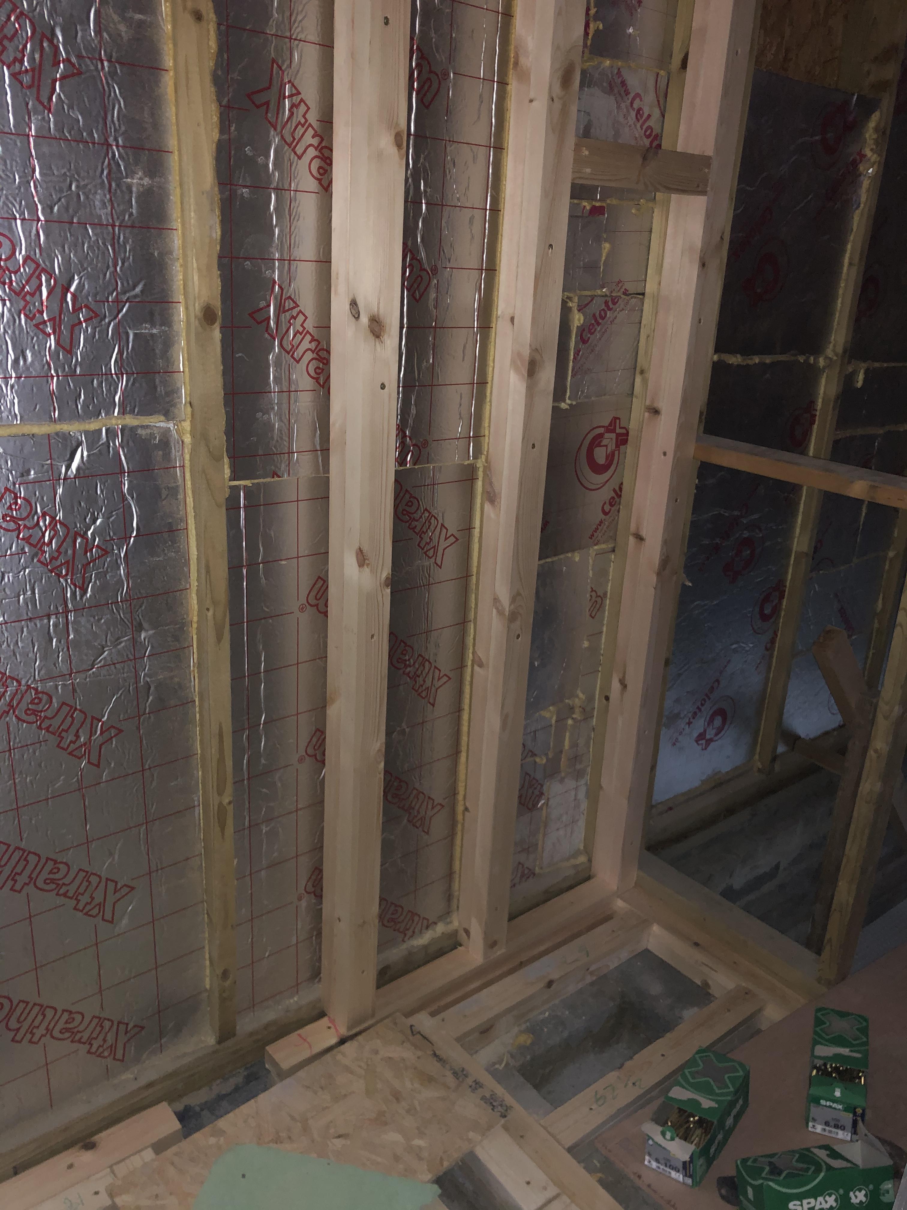

  1. Thickened up the ensuite wall to allow for 80cm depth geberit in wall cistern . Undoubtedly using far too much timber and screws - but it won’t move !!

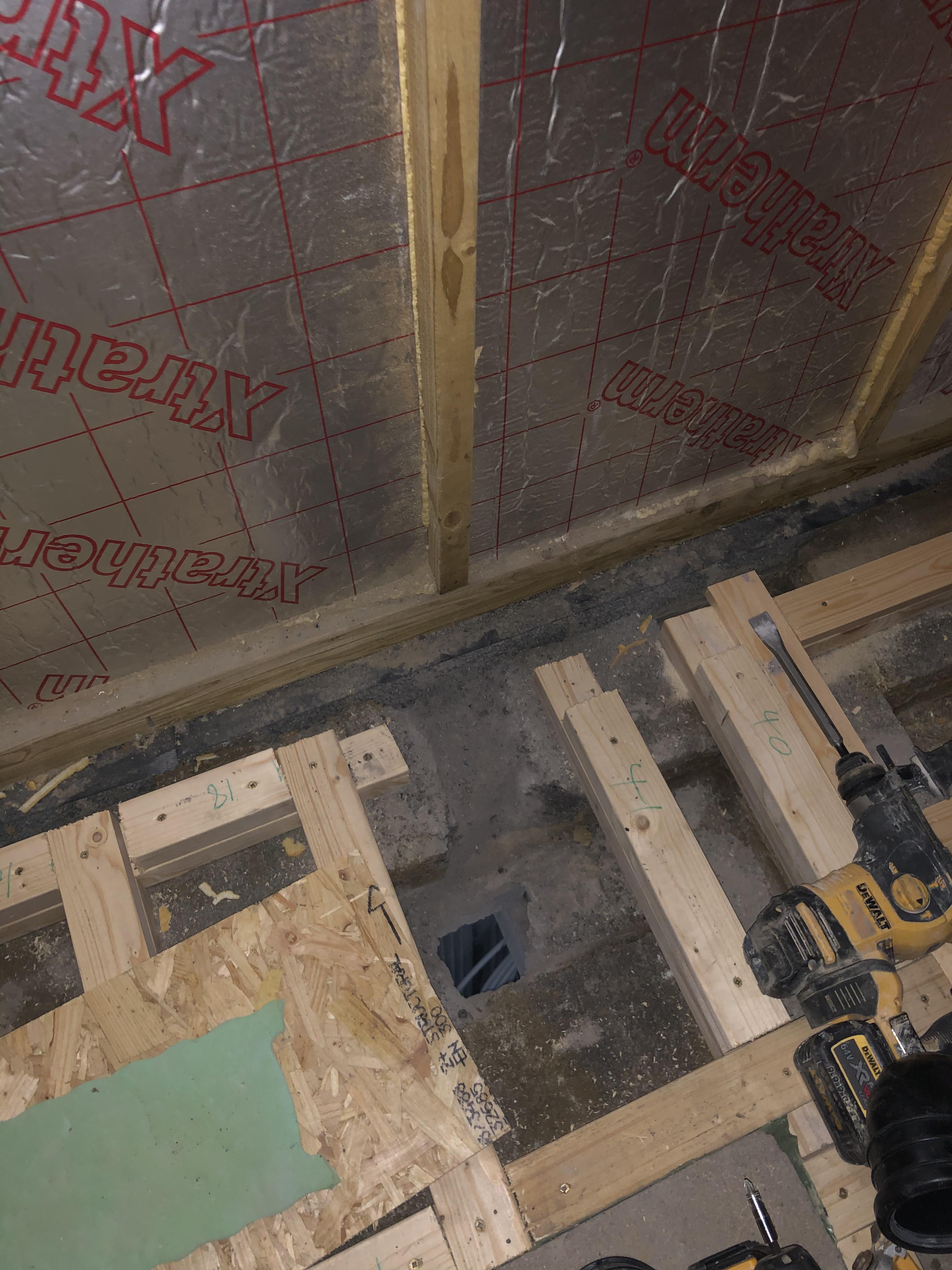

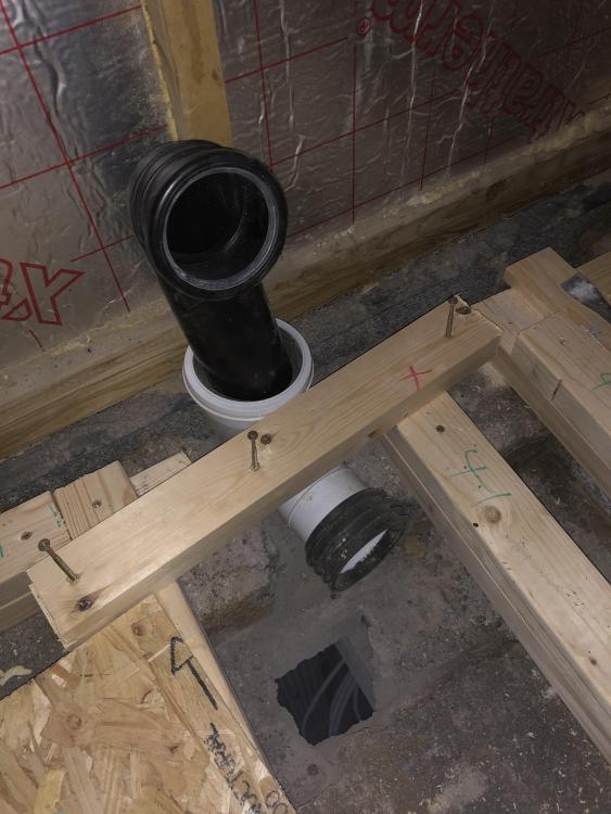

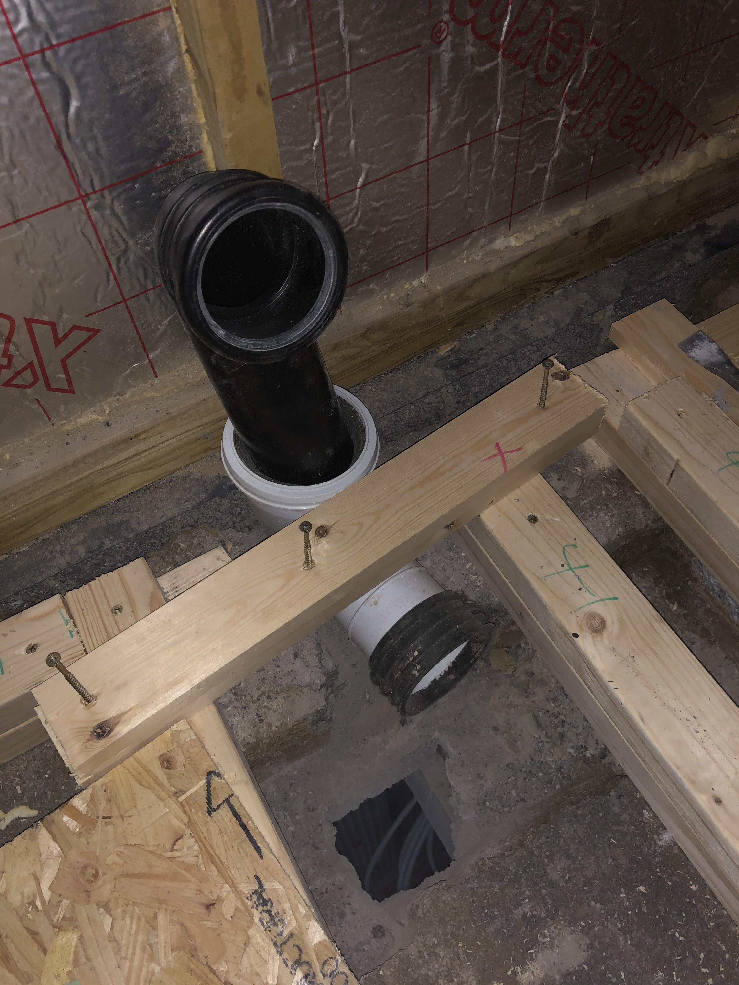

  4. Hole for ensuite waste . Mock up of what I intend . JTM plumbing ( no I don’ t work for them ! Used them before ! ) , are brilliant ! Explain my dumbness - tell them what I am trying to achieve and they send me a parts list - top service !!

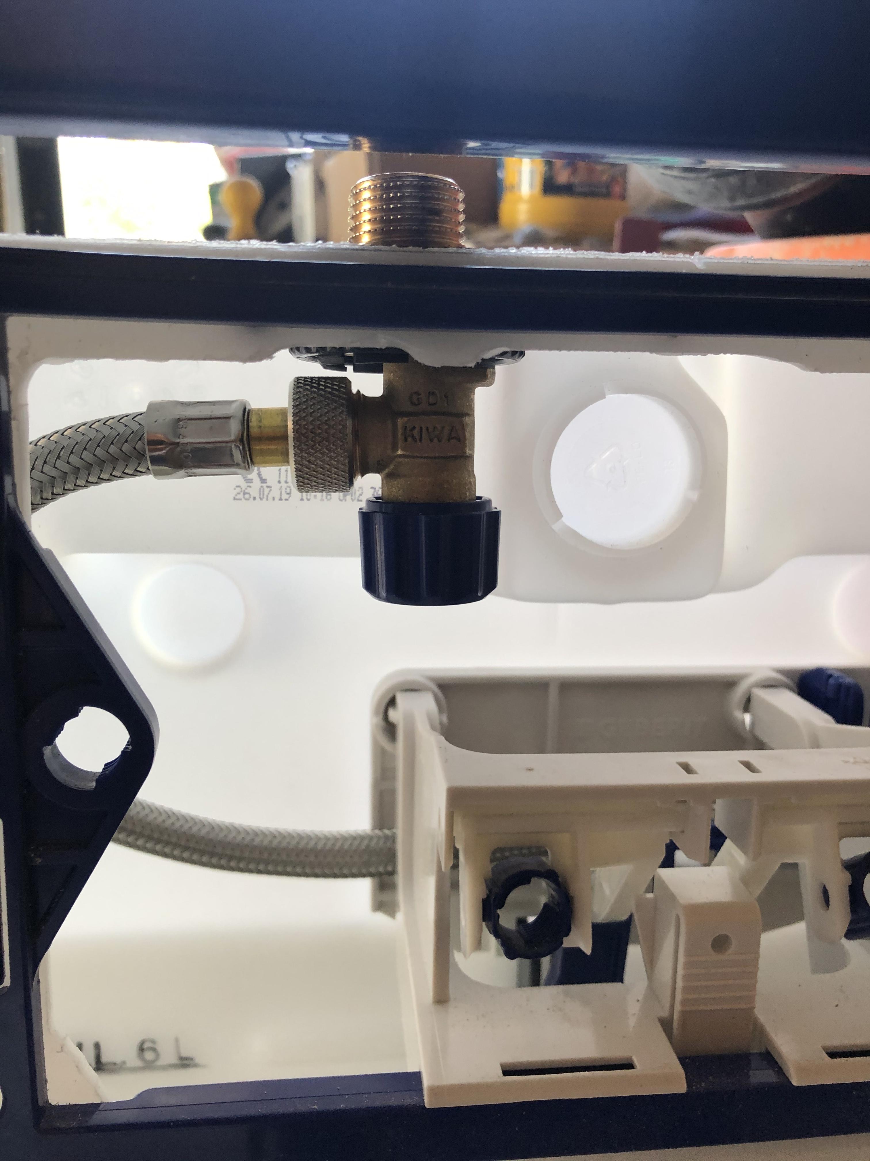

  10. Ah yes ! Thanks . I think that’s what I need . Just maybe my hep20 pipe is long enough . ?

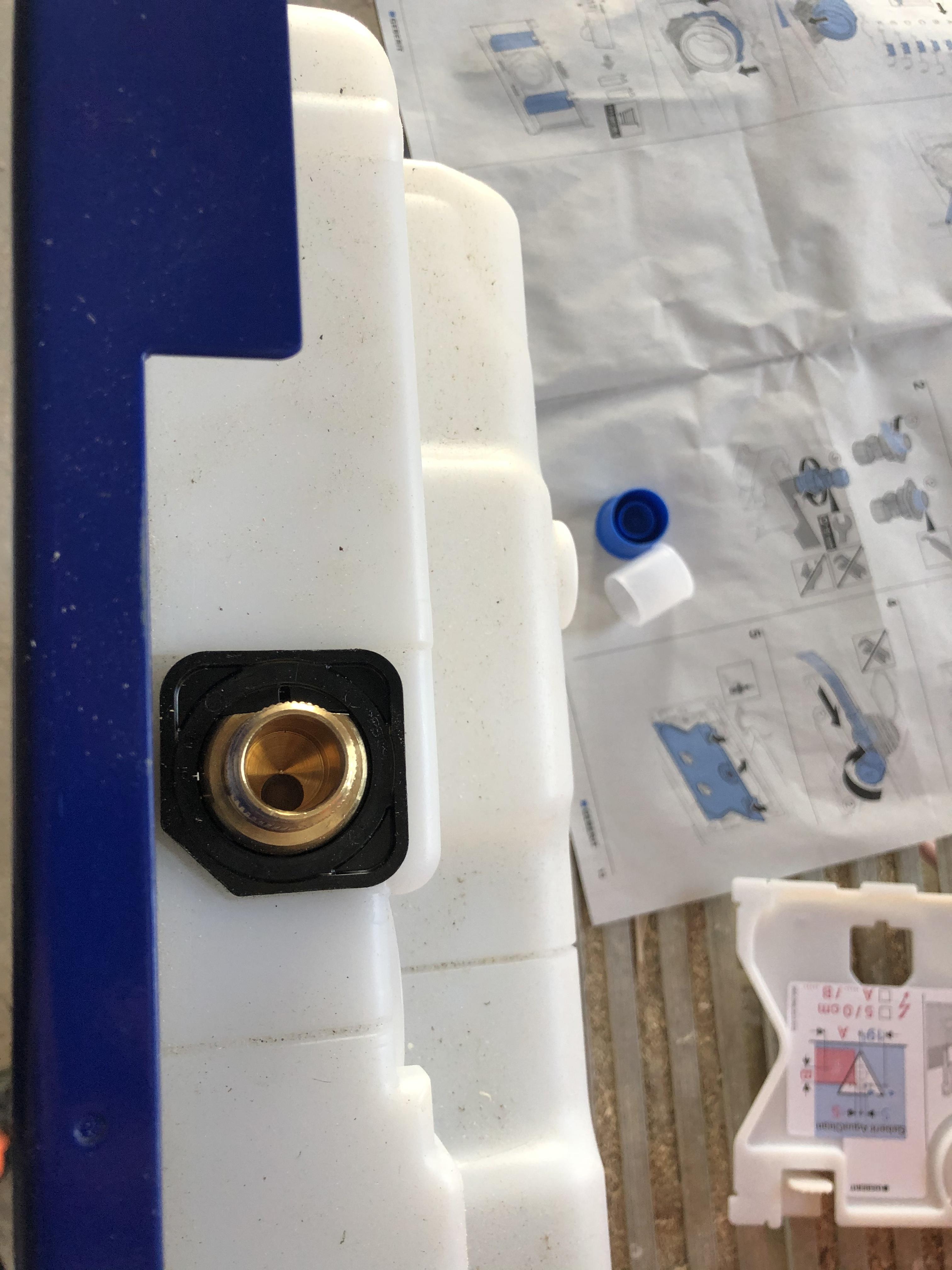

  11. Bum . Cistern cold feed not quite long enough !!! Because I moved WC ? . Don’t want a join - but I think have no choice !!
  12. Think this seems ok for the feed . Just need to work out what Hep2o fittings goes to this thread ...

  14. Put the cistern in place . Funny really I built a double stud wall to ‘relieve’ noise from the bathroom . Now I’ve moved the geberit into the wall there’s no sound insulation behind it !! Time to sort out how the water feed to cistern is done
