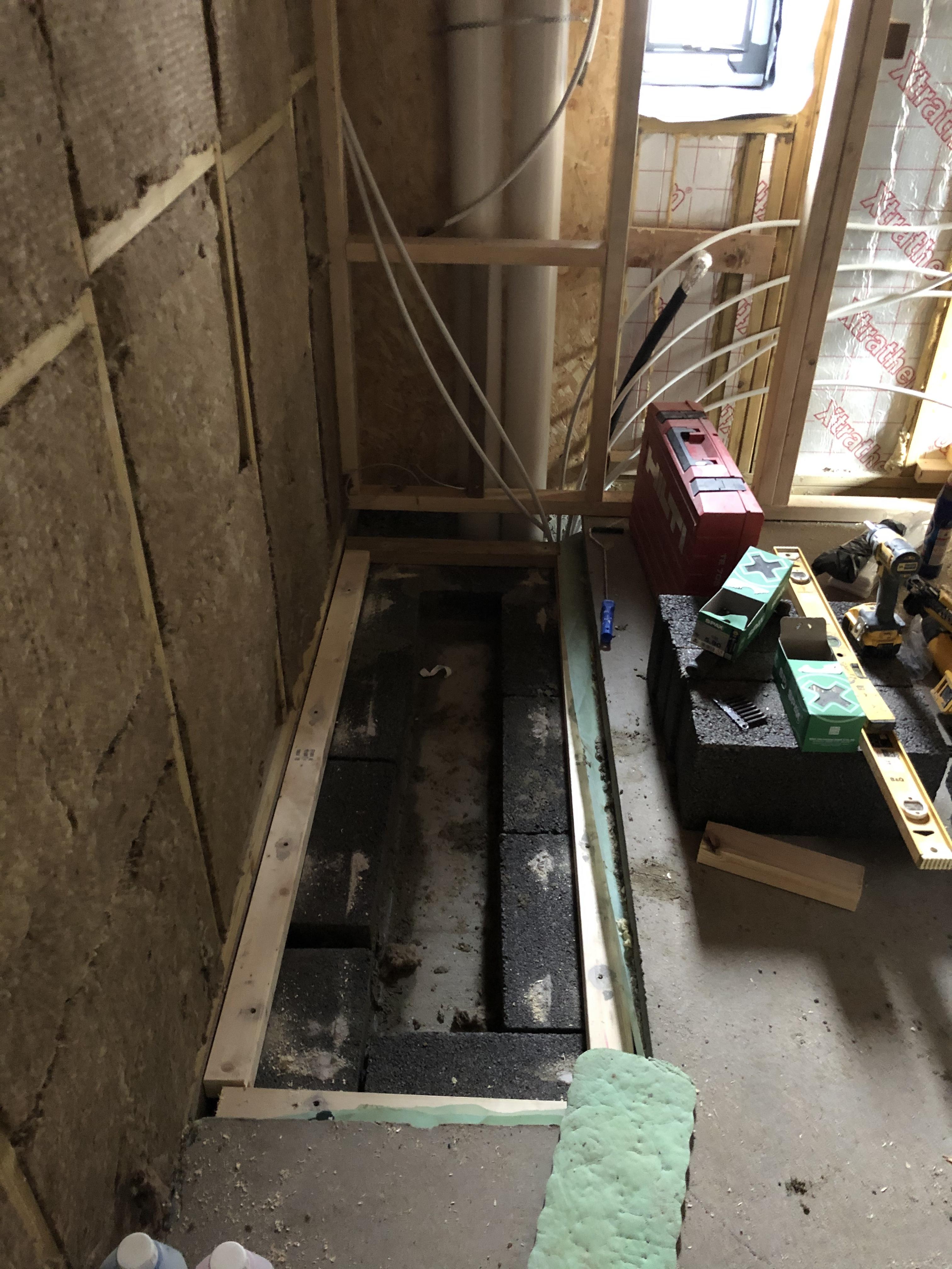

Re did the ensuite shower support .; wasn’t happy with it 20mm above finish floor ( gestimate ) . Now I reckon it would be more like 5mm ?
