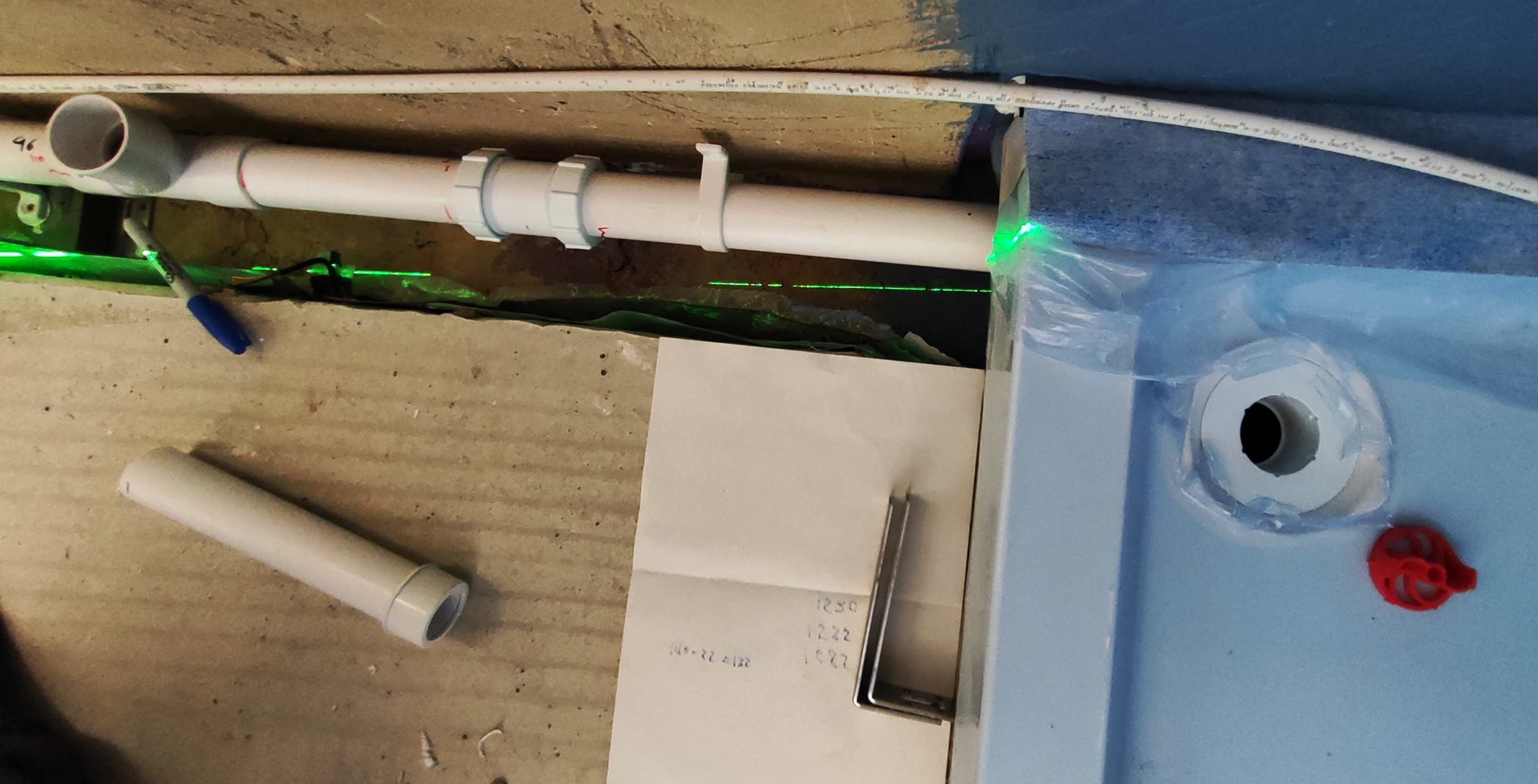

I think I will, just in case. If the metal profile is two part, do you have the sealant (a) just onto the inner profile part of (b) covering both. I'm expecting you'd say (b) but wanted to be sure. second sealant side shown in light green as may not be present in an ideal world 🤣 I suppose you could have (b) on the external junction and (a) on the internal junction, but stull feels like (b) might be best all round. Interested to have your thoughts.
Cool, so from where I am now (without sealant between the profile and the wall) I'll have sealant in the following junctions. At bottom of profile between tray and wall (applied before fitting the profile) Down full height of profile internally Down the full height of the profile externally Around the profile to tray junction externally That's pretty much what I was thinking, though wondered about holding it up from the bottom a bit for the internal sealant [2] to allow any water that has got in to drain out in case the sealant of [1] blocks that from happening.
Is that as well a sealing externally for the verticals? If so that creates a continuous seal with the sealant round the external edge of the profile to tray junction.
Thankfully, I did remember to do that joint for the reasons you explain. It is a shame the instructions don't suggest it. That's the only place there is sealant at this point though so I don't have a bead trapped between the profile and wall. I'm guessing you still put a bead of sealant around the join between the enclosure and the tray though. Is that put on after or done mid profile like for the vertical profiles? Does CT1 tool OK with the Cramer silicone tools?
Instructions say to silicone around the outside for the shower enclosure metal profiles (profile to wall and profile to tray) rather than around the inside. I understand the logic, you don't want to trap water in the gap and it's best to assume water will get in there. However, I can't remember if I silicone sealed the screws in the tiling that were used to secure the metal profiles. If water gets into the gap, it could then make its way behind the tiles if those holes are not silicone sealed. I wonder about sealing the inner edge of the profile to wall down to about 100mm above the tray. That is below the last screw hole (I hope). That would hopefully avoid water getting trapped but also protect the screw holes. What did others do?

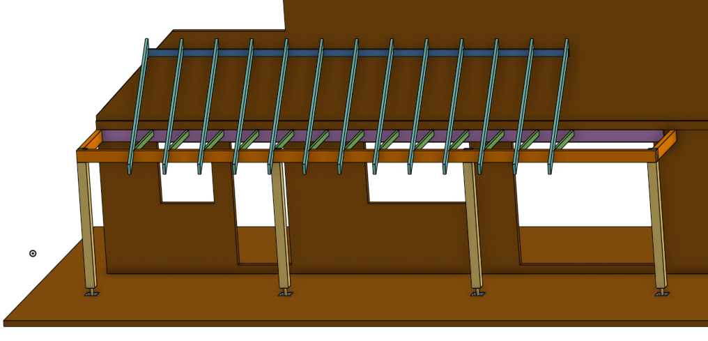

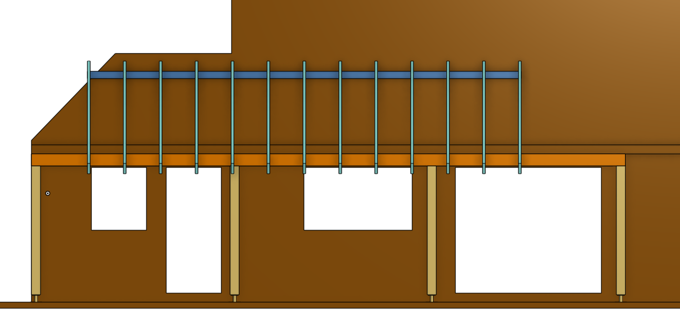

Glulam (inc. service class)
MortarThePoint replied to MortarThePoint's topic in General Construction Issues
That should have said lateral forces towards and away from the house are much more of a concern ... -
Thanks Gus. The main thoughts on the Staddle Stone thread are along the lines of assuming the top of the post is constrained by a connection that leave it free to rotate, would the Staddle Stone be a point of failure. So only really considering if the Staddle Stone could constrain the post vertically and horizontally, but not rotationally. I then assume that if you have a rigid body translationally constrained in two separate locations, it is then also rotationally constrained. Interesting, I was so focused on whether the posts were sufficiently supported in terms of tipping away or towards the house walls that I forgot to consider them tipping parallel to the walls. I can see that OSB/plywood on top or sandwiching the rafters would prevent that. I was hoping to have V-groove on top of the rafters so this could work as plywood. This has been my main quandary. Really I want the loggia to only place a vertical load on the outer leaf of the house. The weight of the tiles onto the top ledger should be about ((1.375m / 2) / COS(46)) * 77kg/m2 = 76.8kg/m -> 0.8kN/m. If I crudely double that for snow etc, I'm looking at 1.6kN/m order of magnitude which is the weight of 1m height of brickwork [ (1m*0.1m*1600kg/m3) = 160kg -> 1.6kN ], so easily within scope. Lateral forces on the brickwork are much more of a concern as they rely on the wall ties and or weight of brickwork above as I understand it. The weight of brickwork above isn't much for most of it at the possible height of any ceiling ties and is tiny at the height of the top ledger due to a large group of windows. I should have shared that image earlier I suppose, sorry. The knee braces could work aesthetically if they are needed structurally. The foundation pads are around 600x600x600 poured on top of larger concrete pads of around 1m x 1m x 1.25m. I agree that the vaulting with no ceiling ties is a much more attractive look. -
Thanks Gus, nice examples of Glulams On another thread I has detailed changing to using Staddle Stones and my rough calculations there suggest a lateral force capacity at the bottom of the post of at least 80kg (without pin and resin into concrete below stone) and I'd expect much more (with pin and resin into concrete). The main structural question I am struggling with is whether I need ceiling level timber ties back to the house structure. I'd consider the coupling between the post and the staddle stone to be free to rotate, so just providing lateral and vertical constraint but not rotary. More discussion here: -
Was hoping to leave it on show and paint it. Using screws internally to the glulam would allow three faces to have no fixings showing
