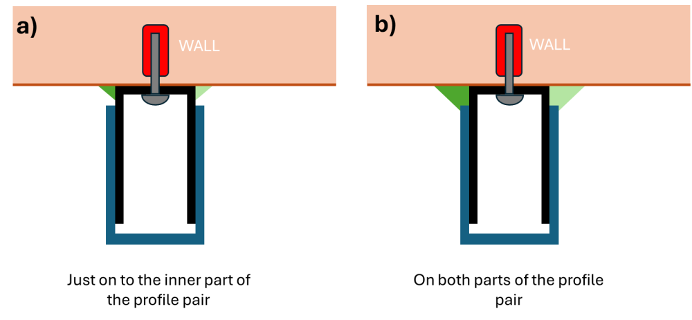

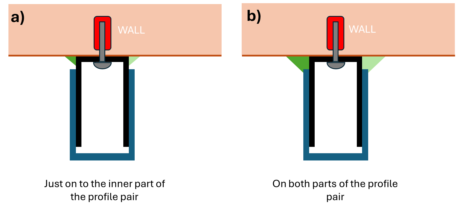

I think I will, just in case. If the metal profile is two part, do you have the sealant (a) just onto the inner profile part of (b) covering both. I'm expecting you'd say (b) but wanted to be sure. second sealant side shown in light green as may not be present in an ideal world 🤣 I suppose you could have (b) on the external junction and (a) on the internal junction, but stull feels like (b) might be best all round. Interested to have your thoughts.
Cool, so from where I am now (without sealant between the profile and the wall) I'll have sealant in the following junctions. At bottom of profile between tray and wall (applied before fitting the profile) Down full height of profile internally Down the full height of the profile externally Around the profile to tray junction externally That's pretty much what I was thinking, though wondered about holding it up from the bottom a bit for the internal sealant [2] to allow any water that has got in to drain out in case the sealant of [1] blocks that from happening.
Is that as well a sealing externally for the verticals? If so that creates a continuous seal with the sealant round the external edge of the profile to tray junction.
Thankfully, I did remember to do that joint for the reasons you explain. It is a shame the instructions don't suggest it. That's the only place there is sealant at this point though so I don't have a bead trapped between the profile and wall. I'm guessing you still put a bead of sealant around the join between the enclosure and the tray though. Is that put on after or done mid profile like for the vertical profiles? Does CT1 tool OK with the Cramer silicone tools?
Instructions say to silicone around the outside for the shower enclosure metal profiles (profile to wall and profile to tray) rather than around the inside. I understand the logic, you don't want to trap water in the gap and it's best to assume water will get in there. However, I can't remember if I silicone sealed the screws in the tiling that were used to secure the metal profiles. If water gets into the gap, it could then make its way behind the tiles if those holes are not silicone sealed. I wonder about sealing the inner edge of the profile to wall down to about 100mm above the tray. That is below the last screw hole (I hope). That would hopefully avoid water getting trapped but also protect the screw holes. What did others do?
