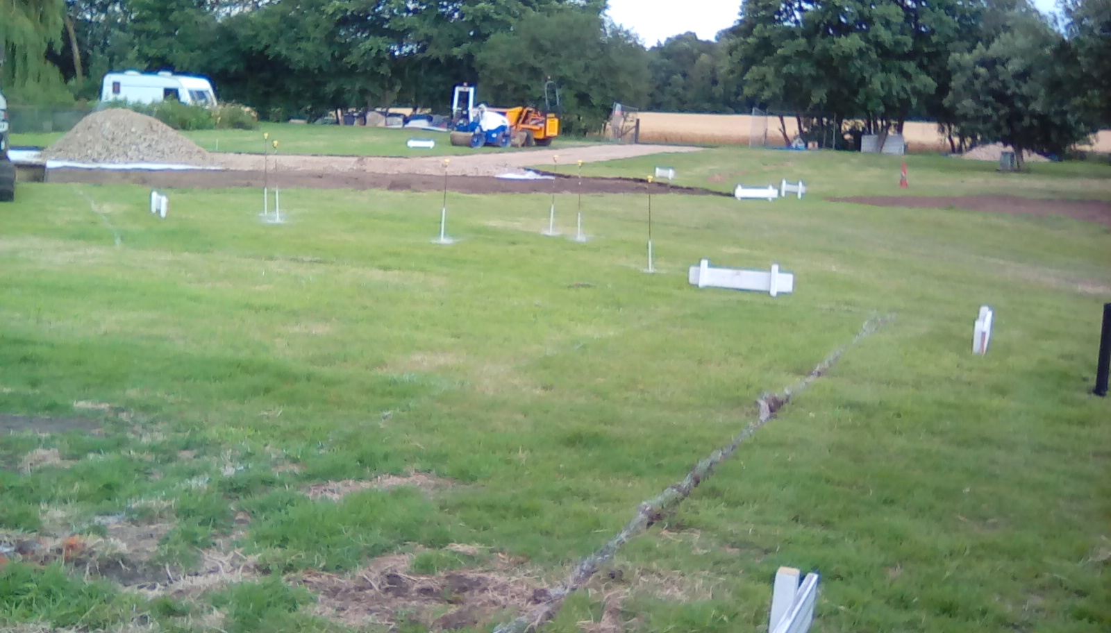

  5. Thanks to the members of buildhub for the constructive advice and a good ground worker we have managed to get our foundations in. The archeological watching brief wasn't the problem we had feared and nothing was found to delay this first step of our build.
