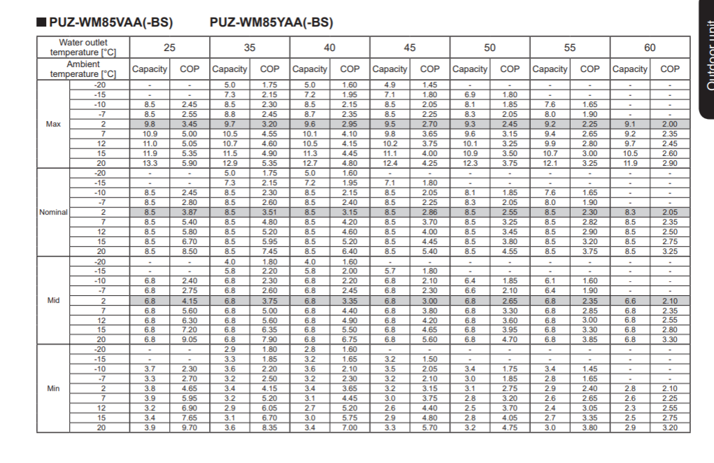

  19. This is some detail from Mitsubishi for comparison. The grey rows include a defrost allowance. IMO it's more important to get the design and operation right than which reputable manufacturer you choose. I have the 14kW Ecodan installed with no LLH/buffers and it seems to work fine.
