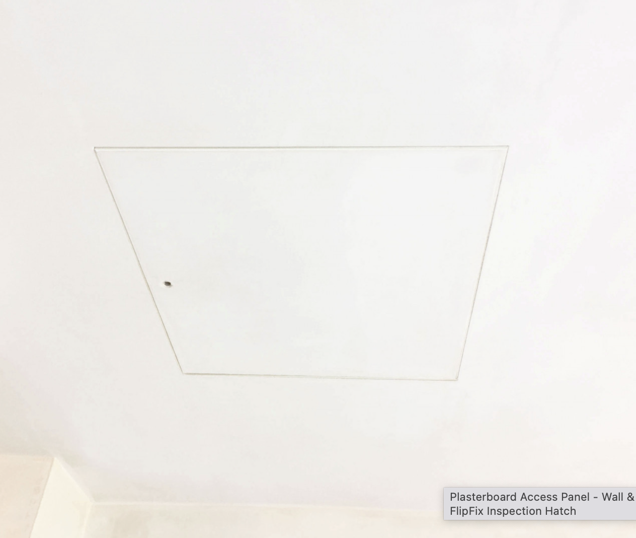

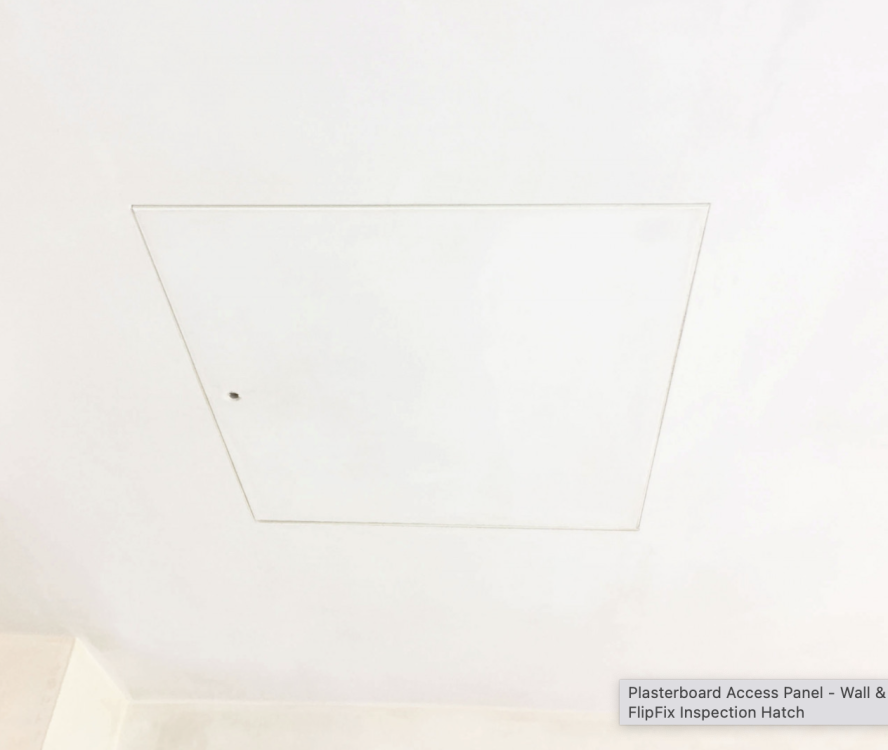

  3. But - reviving this one a little If we have this: Imagine we literally paint over the hatch in the 'landlord supremo' style. The hatch would be nicely invisible I imagine (perhaps with some filler if the gap is too bad). But then oh noes, the FCU needs servicing! How 'bad' would it be to cut open the ceiling, fix the FCU, and then paint it back closed again? Would I need to paint the entire ceiling to achieve an even coat or would the repaint be fairly problem free even to just touch up? I'm thinking: - Since it's a ceiling it won't get any direct sunlight changing the paint colour too much from original? - In a properly maintained house you'll have to repaint ceiling every 10 years anyway? 5? - How much does a partial ceiling repaint cost? And a full ceiling repaint? Basically - I don't really expect FCUs to cause too much trouble and (pending answers here...) I could live with say opening up the ceiling once every 2 years, even if it costs me something 'extra' there? "the landlord supremo"

  12. Yup. Middle of the livingroom and middle of the front room. Yeah, this is a worry of mine too. Well, share your ideas first - pictures! Descriptions! Interpretive dance? At the end of the day, you have to factor in how often you expect to use a given hatch. If it truly is a once in a lifetime emergency then just painting them closed with a few quick hints and docs where it 'used to be'/is is fine. If you need a daily service, then no. I'm hoping a FCU will need servicing about once every 4 years, which would then warrant a ceiling repaint?

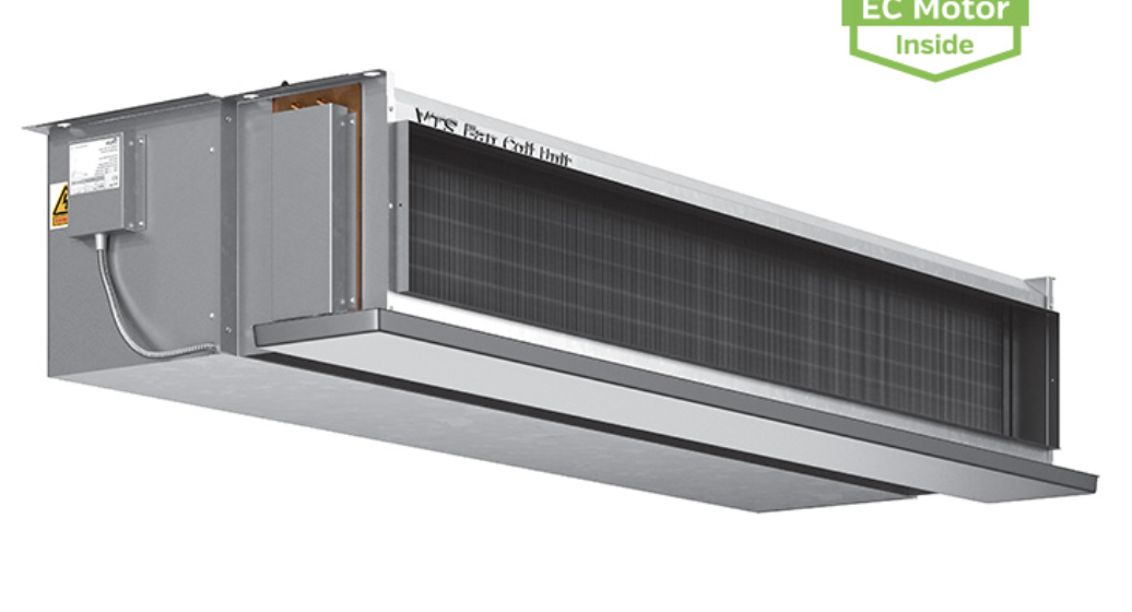

  13. Having a FCU like this one Embedded in a ceiling, means we need a way to access it, probably, well, through the ceiling. One approach I saw looked somewhat like this: Which I found somewhat jarring. Is there some better way? Or is there some way to cover it up better? One approach I'm thinking of is to literally paint over the grooves with paint? Yes it'll be harder to service (you'd have to cut through the paint and then repaint after) but.. the amount of service actually needed is somewhat low, I think? Thoughts?
