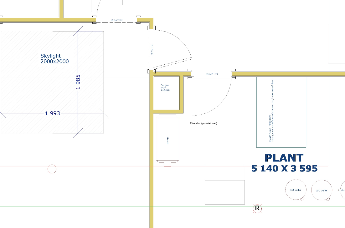

  14. https://www.lamilux.com/skylights/solutions/smoke-and-heat-exhaust-ventilation-shev/smoke-and-heat-exhaust-ventilation-units/flat-roof-window-shev/smoke-lift-glass-skylight-f100.html has an U-value of 1.. might work? I think so.. indeed I still can't quite figure out if a chimney would be able to cool a network hub properly but indeed house air coming in from the bottom and a vent at the top. I guess one thing I don't quite understand about convection is that I always assumed you need a loop, it doesn't work nearly as efficient with just a pipe. So either the vent is 'always open' which is not ideal, or it's closed and the cooling would be insufficient. - but that's just my gut feel.
  15. Why not simply have the shaft going straight up to a dedicated vent or skylight in the roof? How would this fan be connected to the shaft if it has no cap? Why would you need it if it vents naturally through a vent at the top of the shaft. We should probably avoid holes or vents in the shaft at first floor level but provide a relatively large vent near the floor in the hall, this vent would help the rising hot air to move using its natural buoyancy by introducing relatively cold air at the bottom of the shaft. I was wondering how well 'natural convection' would work here - can we enhance the convection that would occur naturally using displacement ventilation (cool air in at the bottom, hot air out at the top). If the shaft is open to the MVHR it may be counter-productive and wouldn’t work well? I think @SteamyTea or @jack spoke about this somewhere but I can't find it anymore Actually the automatic opening vents (AOVs) are more or less standard thing but are they are normally opened by a smoke detector rather than a thermostat. AOV or smoke vent shafts are shafts with an automatic opening vent (AOV) at the top and vents at each floor level to clear smoke from staircase landings. They are used in blocks of flats to let the smoke out of the staircase in a fire. Many companies make equipment for these shafts for example https://www.kingspan.com/gb/en-gb/products/smoke-control-systems/natural-shaft-ventilation. The shaft could have a velux window instead of a louvre if you prefer. The AOV would need to be opened and closed by a small electric actuator controlled by a thermostat but that seems pretty simple to me. Obviously you would need it closed in cold weather and when there was no heat build up, but that is easy to achieve. I guess I don't care too much for the (plant room in the) loft. If it's truly smouldering we can open the skylight, or stop pulling heat from the network closet (and open the door) but that must be an emergency
  16. The 'heart' emoji goes out to the solution I was thinking myself roughly. I bounced between simplicity ("if hot then blow it out a hole in the roof") and elegance ("keeping the precious heat away from living quarters, but doing helpful things with it"). Maybe recover, maybe put towards cold places, etc. Not to mention that somehow using an FCU, running power to de-heat the heated air, feels distasteful vs just venting it. But indeed the brains of the smart home will at some point gain sentience and kill us all so .. hm.
  17. I actually asked exactly the same thing to my heating guy. I don't know. To be clear the riser was designed with my explicit instructions to pay attention to that, and my arch assured me his design was made to comply with them... so the riser minus the network closet is fine.. but I don't know if that closet changes things.
  18. Small update, but my heating guy came up with a proposal: 1/ merge the network closet with our service shaft. (so our service shaft is straight above the gear) 2/ Attach 20L/sec MVHR capacity to this shaft for normal operation 3/ Separately, use an AC infinity fan and temperature sensor to detect peak heat and turn on the tornado. E.g. the 100L/sec inline fan (to be clear: not into the MVHR, this is a separate run) Will I run into balancing problems if the 100L/sec effectively starts pulling at the same air the 20L/sec MVHR inlet also tries to grab And then: 4a/ Duct the 100L/sec directly outside, possibly up through the shaft, or maybe even at ground floor level concerned about adding a hole in my roof, cold bridging etc. 4b/ Duct the 100L/sec into the loft, then if the loft gets too hot, open the roof window To my layman-self this feels more elegant, and we could even do the 20L/sec extract in the loft itself, so fewer conflicts (as above) 4c/ Duct the 100L/sec into the loft, which has slots into the hallway, and the hallway has a skylight we can then open? Perhaps the most elegant, using my entire hallway as a chimney. Which one would you do? Or an alternative option/ As.a reminder. Ground floor- but integrating the network closet rather than right-next-to (not a huge diff really, but it would draw fresh air from the hallway, whole-house!) Loft: (which has its own skylight, or we could open slots high up the plant room, or even powered ventilation, and open skylight if things get toasty..

  23. Yep that's where my question stems from, the loft is intended to be 'noisy', so I prefer to put the fans there...
