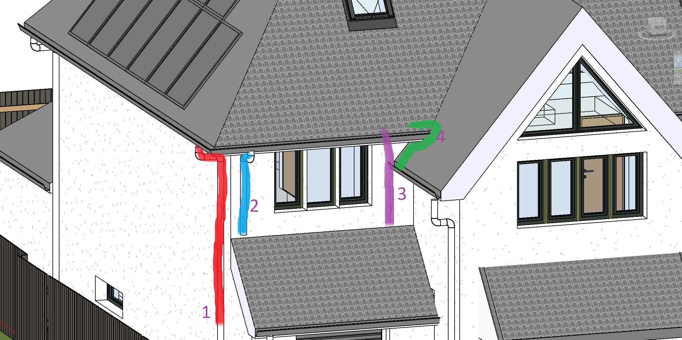

Yeah but I mean, why would someone deeply care if water 'falls off the roof' rather than neatly goes into gutters/drains/soakaway. I mean ok if it's a HUGE amount of water you might have quite a soggy surrounding of the house, but a reasonable-but-not-insane amount? Problem?
One devil's advocate question: is that actually a problem?

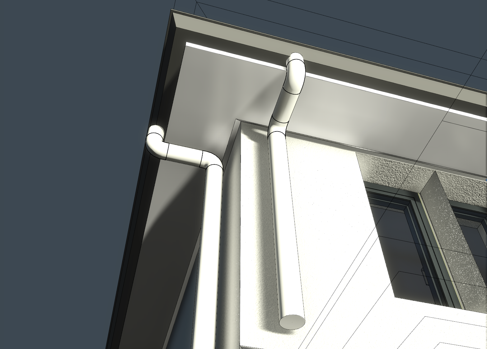

Agree, #2 seems somewhat superfluous but I was hoping to get rid of #1 instead.
Yeah I think I see what you're saying. OK I guess we'll leave it unchanged. Perhaps we can have somewhat flatter (square) downpipes that hug the wall somewhat to minimise having to squeeze past.
Thanks @Bonner - one thing my picture doesn't show (sorry) is that one pipe hits a roof not the floor. This picture is much better: I want to remove #1 Merging it into #2 feels like dropping a lot of water onto the small side roof. Having #2 handle most of the side water, but creating a pipe at #3 or even letting it drop through #4 might work better?

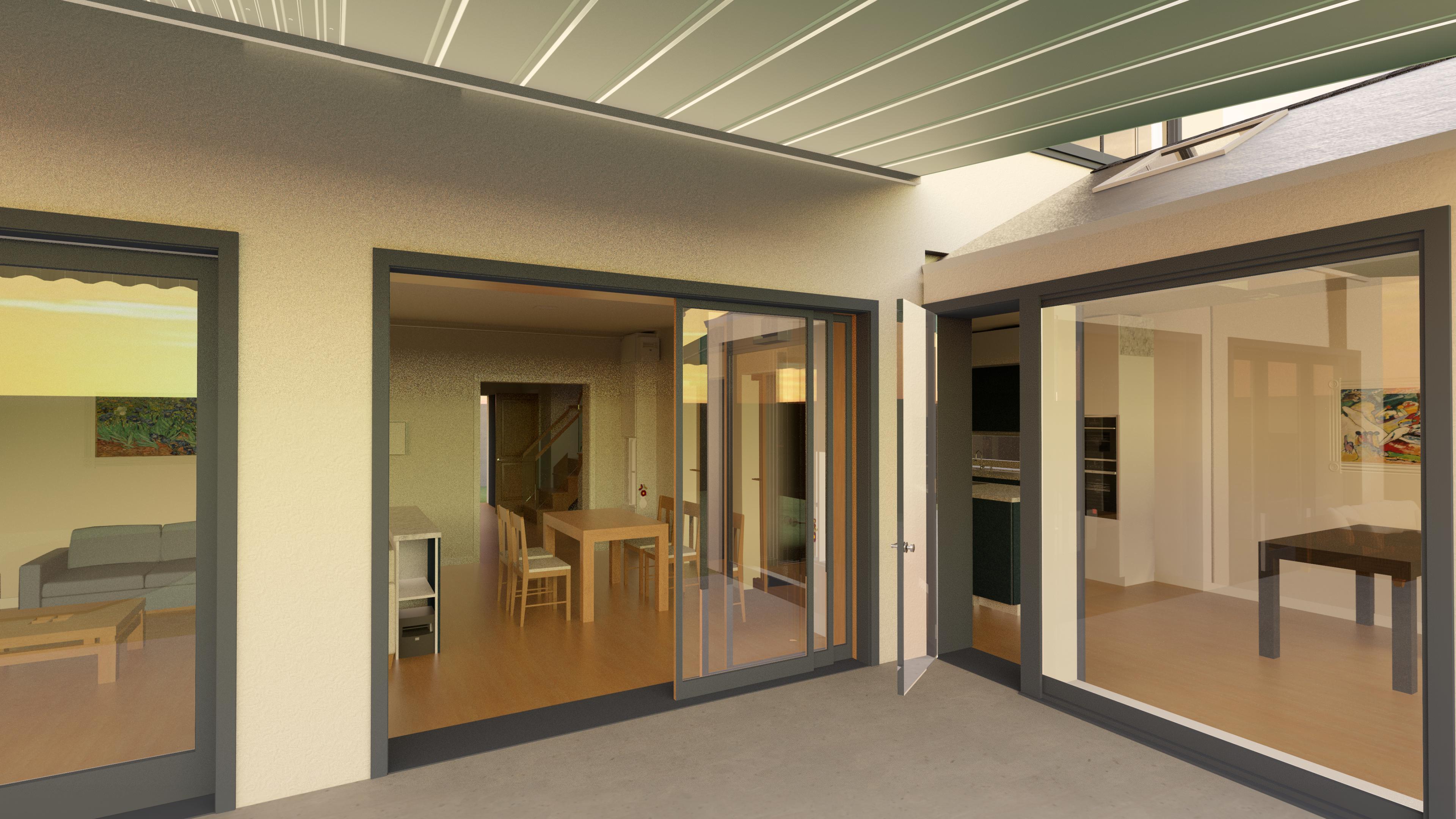

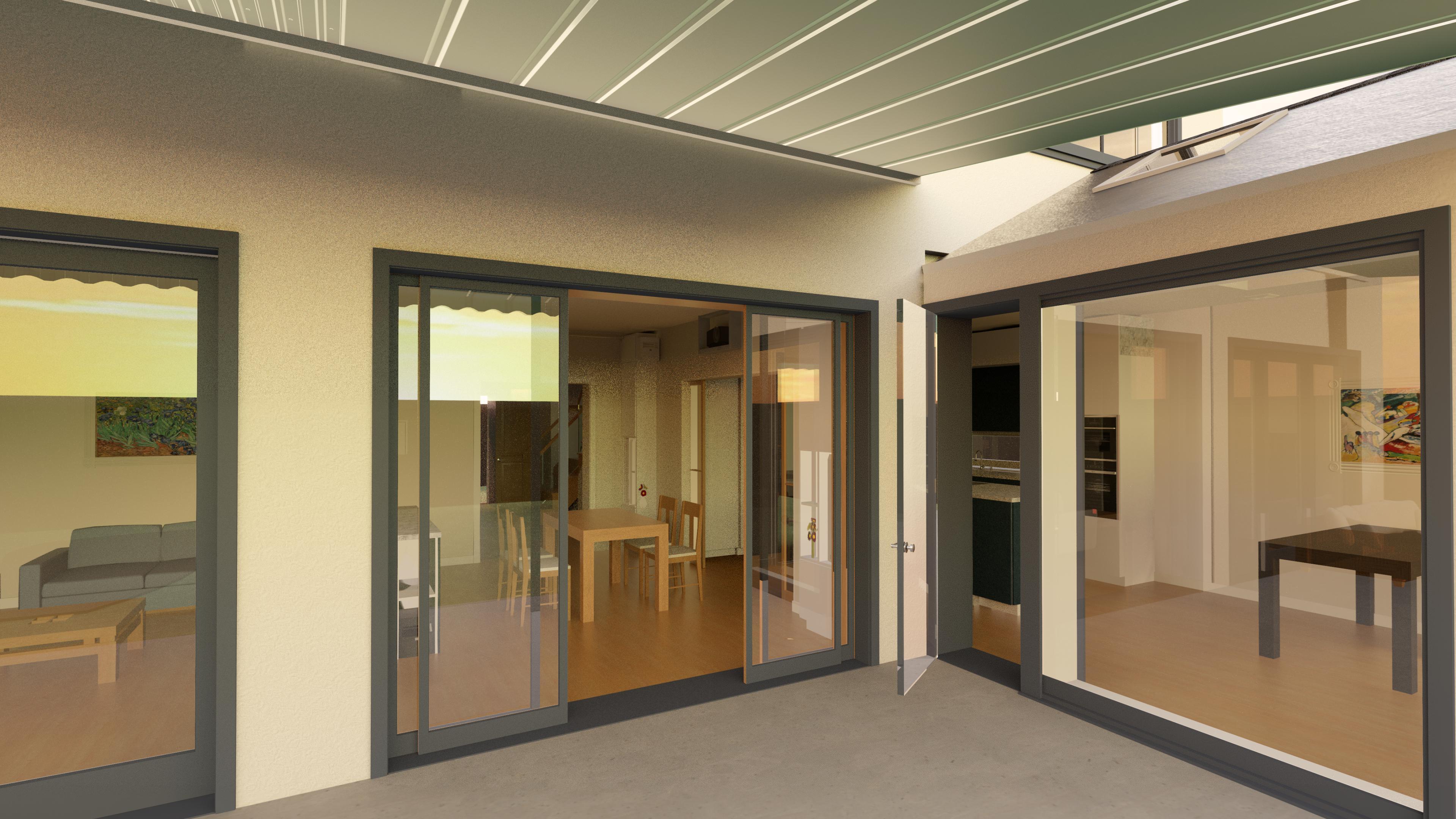

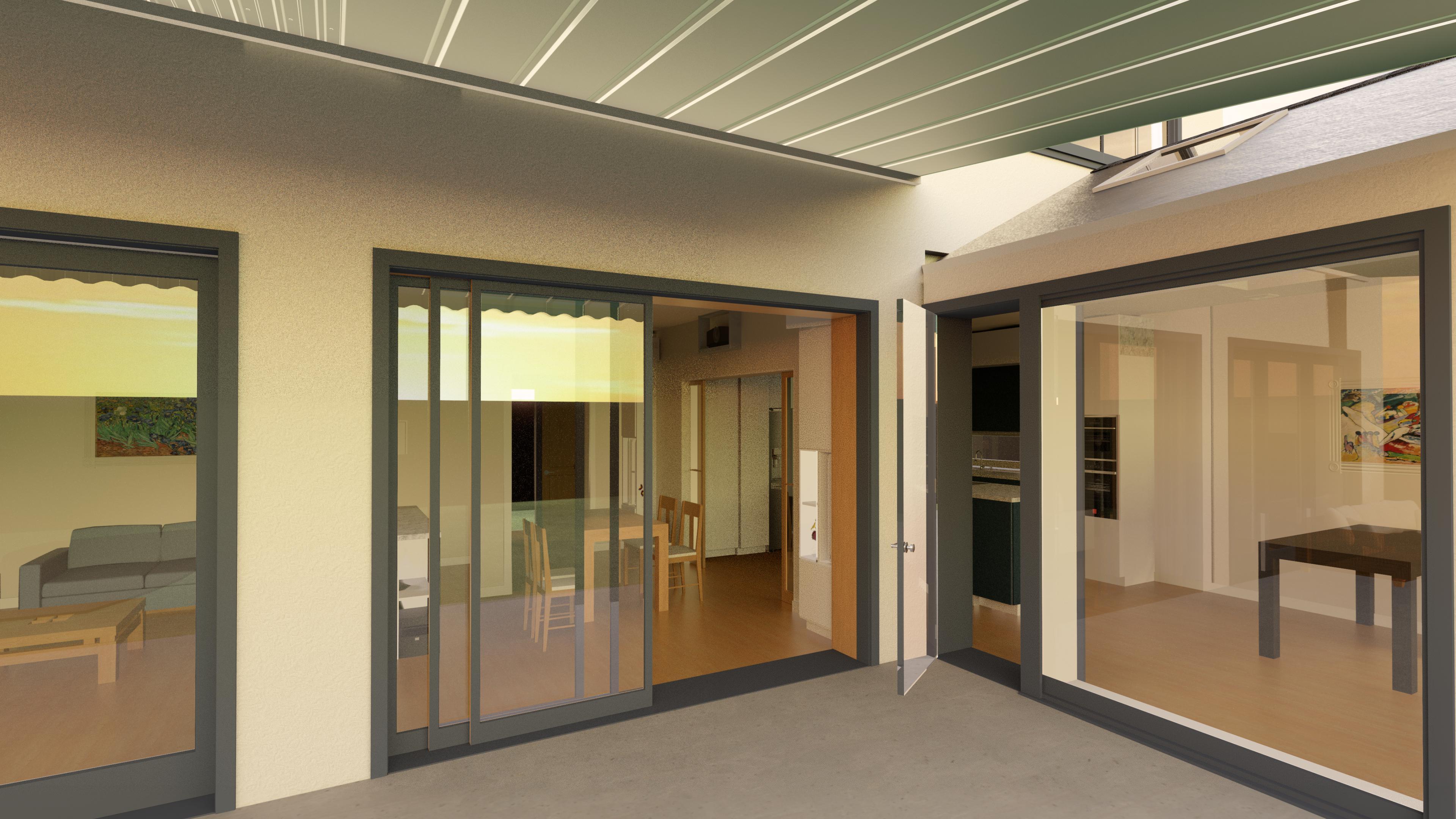

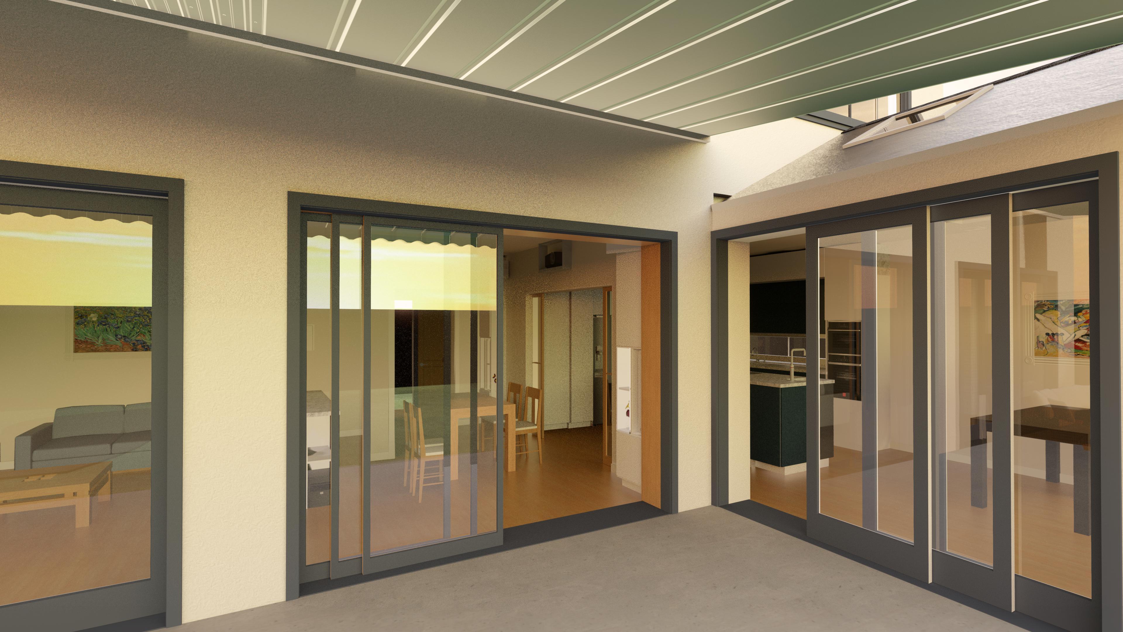

I know I discussed this before, but then it turned out (see topic elsewhere) that I couldn't have outward french doors (at least- not with my current passivhaus door supplier.. and changing all doors is.. drastic). So. What would you do: (note, far left is one panel of another sliding door, same size as the middle one. (both 2.4m wide) 1/ An easy exit with a standard door, next to a nice picture window. Have the 3 panel (1100/panel) sliding door open next to it. Optimal for sliding but a potential clash with side door blocking slider. 2/ Same idea, but with a 4-panel middle opening door (844mm panels). Would prevent this walking out, blocking clash. 4 panels is different than the 3-panel slider to the left. Somewhat uneven 3/ Slider opens on the left side. Not a straight walking path from front door anymore. Prevents clash. 4/ Give up on standard, 2 sliders. Probably the only logical design is this approach.. Or any other? I'm tempted to go for #2.. not sure if the unevenness is a crime, or if I should simply make the left door 4-panel as well - 844mm per panel is respectable enough even for accessibility

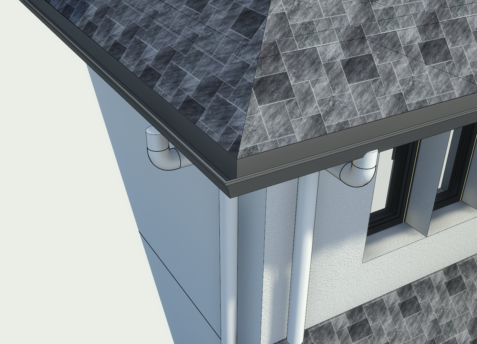

Noticed this on our design. Is it not possible to merge these into a single downpipe? Is it down to total volume of water expected 'worst case scenario'?
