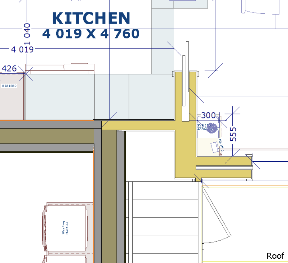

So I've designed my under-stair cupboard to accomodate a hot water cylinder in the center of the picture below. A 400L class-C cylinder, the one I designed in is a https://www.gledhill.net/products/alternative-energy/stainlesslite-heat-pump/ My contractor points out that "class C" will heat up the place, shedding heat into the under-stair, as well as rest of the house which is Passivhaus spec!. Class A is nice of course, but I could only fit, maybe, a https://www.osohotwater.com/product/indirect-hot-water-cylinder-dgc/ which goes up to 300L "only". Should I really try to spend and fit the fancy one? Or is class C fine, even for passivhaus
