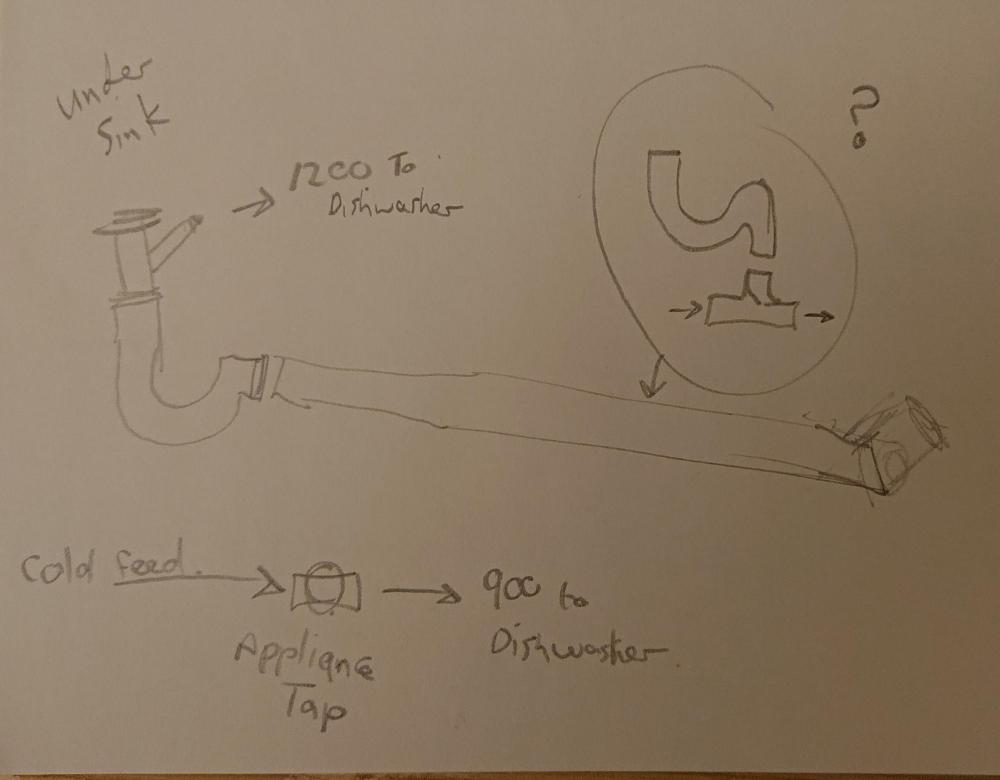

Thank you everyone. Sounds like I can stop worrying about that now, and get on with installing kitchen plumbing. @JohnMo in 20 yrs of dishwasher use we've never rinsed anything before it goes in, just stack it well and it comes out clean.
Hello. I'm worried that the distance my dishwasher will be from my undersink plumbing might cause issues. I could add an extra U bend to be closer but this would be behind the dishwasher (not integrated) What do you think? Hope my sketchy diagram helps!

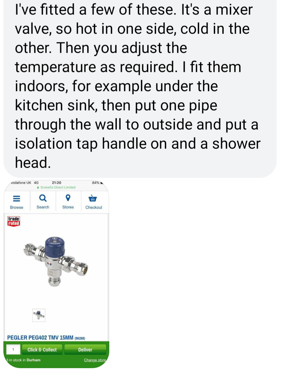

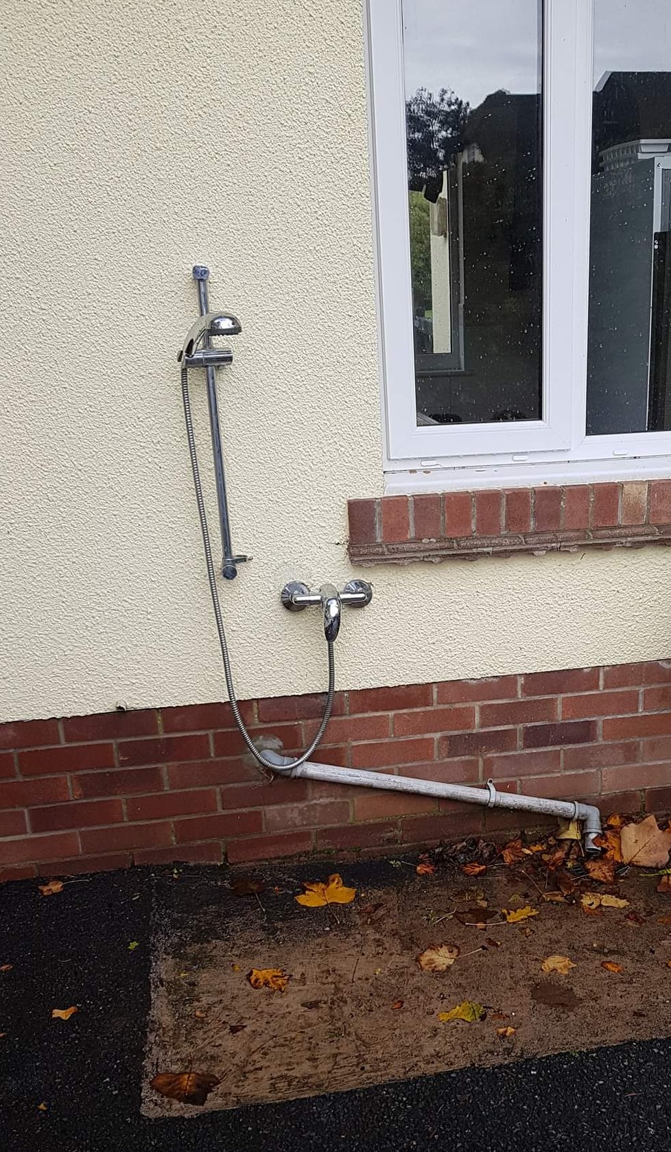

It's on my list of things to fit. Quite a few ways to go about it. I'm going for an internal thermostatic mixer valve, so single warm tap on outside wall. -

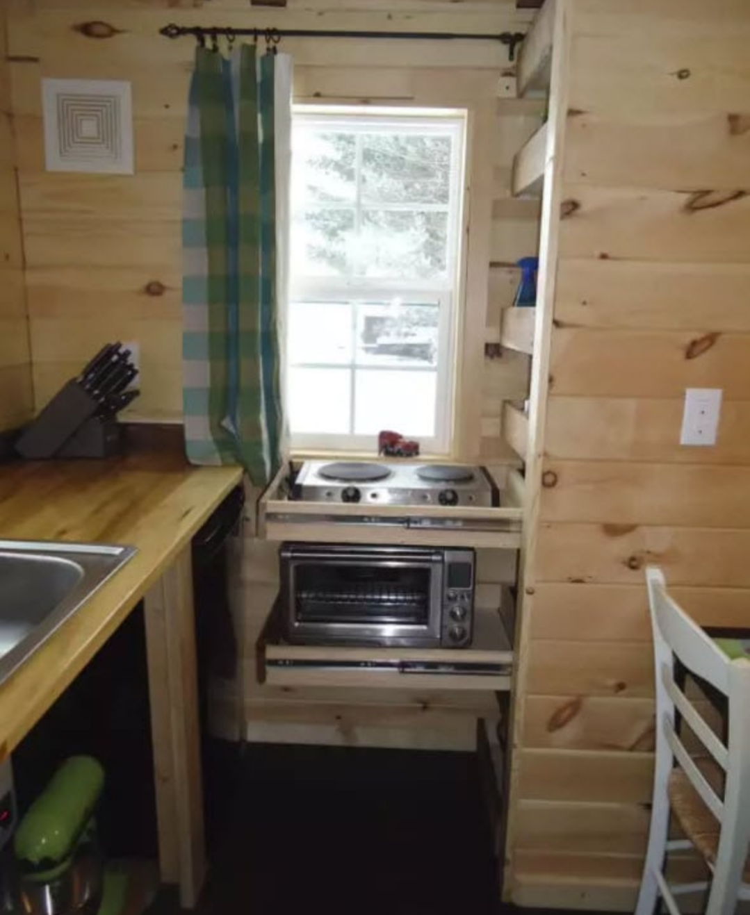

This is something I've looked at quite a bit. Mine isn't built yet, but have sorted it out for my mum's house - heavy duty long extension runners, similar to pic below. I'll get actual pic later. Mine will be same function but I'll put more solid cover/door on as I'm not a fan of open shelves in general. -
