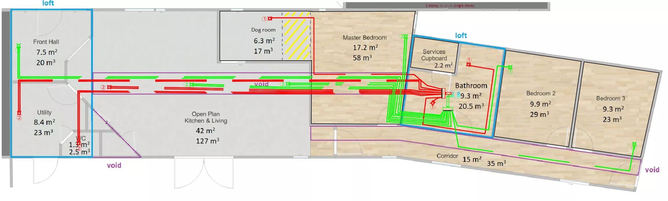

  8. Thank you dpmiller. The wc certainly qualifies based on duct length. Any other thoughts on the open plan area ventilation? Maybe it's fine and I should try to stop overthinking it.
  9. Evening. I have a layout suggested to me by BPC, there's a couple of points I'm curious to have other opinions on please. Do you think 1 valve / 2 ducts is enough extract from the open plan area? Putting all 3 valves along the centre of the open plan room makes installation easier, but is there a possibility of air not circulating well around the whole room? Is 2 ducts extracting from the wc overkill? (I'm not sure yet if wc will even have a door on it, but even if it does, 2 seems overkill for such small space.) For context, ceiling height of the hall+utility is 2.8m. The open plan room is vaulted with a flat top section to create a service void, height 4m. I'll be having a recirculating kitchen extractor fan.

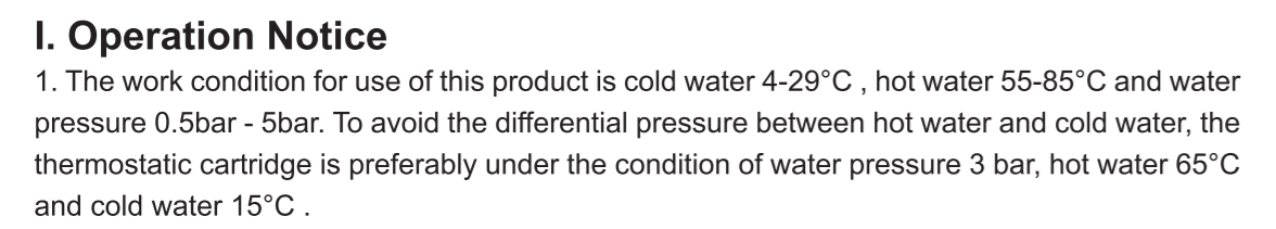

  10. I've just had a read through of the Hudson Reed manual, it lists hot supply temperature as 55c-65c. So it's good to hear yours is working fine at lower input temps. Thank you Dave.
  11. Thank you Peter. Are there any concealed valves (that you're aware of) that will work at lower input temperatures? I will have an immersion, but would prefer not to be tied to using it all the time.
  12. Hello. Efforts are generally focused elsewhere, but I'm still mulling over shower valve options so I'm back again with another question. A valve I Iike says "Hot water temperature 55 to 85 Degrees", and in the manual says - Does this mean it's not suitable for use with my ASHP hot water system, where the tank will generally be at 45-50c? (this one - https://www.victorianplumbing.co.uk/cruze-twin-modern-round-push-button-shower-valve-with-2-outlets?campaign=googlebase&gclid=Cj0KCQiAtqL-BRC0ARIsAF4K3WHWaUvYdYOK3-tAzM3bAkuwrTntu6RqCSAOVy4wduDyWU8hJr0EsssaAjibEALw_wcB&gclsrc=aw.ds)

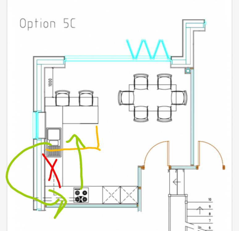

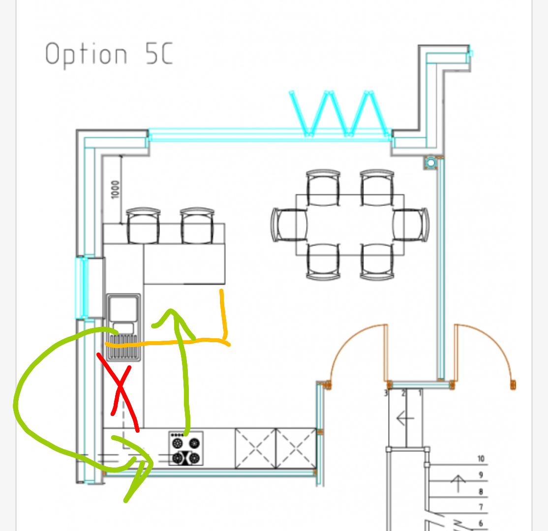

  23. Just a thought. Lose the corner cupboards and have more of a galley. Hob on wide peninsula, sink on wall.
