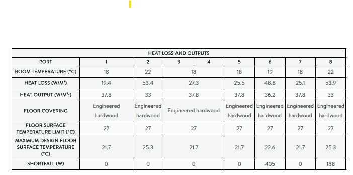

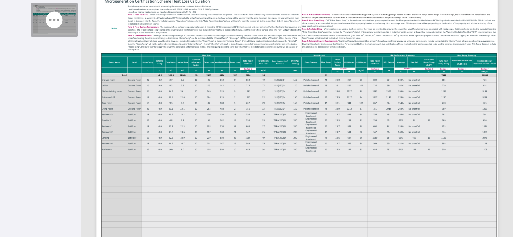

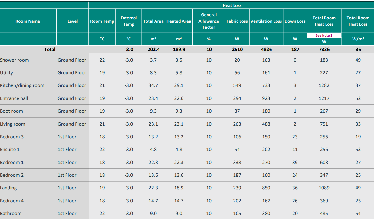

I hope someone can help me make sense of this. Let me know if I'm not providing the right data to make a judgement. We were planning on a 10kW ASHP for a 4 bed 210SQM house over two floors, highly insulated, MVHR, UFH, air tight, triple glazed. I thought this was already oversized but the company has come back recommending a 12kW ASHP. Just two of us living there to start with. The overall MCS calc is 7589W for building heat load but because we have a large open sitting area (landing) on the first floor which they are calculating a 405W shortfall at -3 degrees C they calculate a requirement of 1136W just for this area for the heat pump and suggest upsizing. The landing is shown as '6' on the Heat loss and outputs attachment. Their estimate is the landing (which has a vaulted ceiling) would reach just 13 degrees C at an outside temp of -3 degrees (UFH Output calc is 684 / 63% coverage). This doesn't take account of any heat rising from the hallway down stairs (2117 UFH Output and 174% at -3). They also don't factor in the MVHR at all in the calculations. They acknowledge it would improve the efficiency of the 10kW ASHP but then say if it malfunctions or is out of action then 10kW wouldn't be enough. So my questions are: Is it right to suggest a 12kW pump is needed? Should we be getting them to factor in the MVHR and towel rails? Would we be better off fitting out for towel rails now and an electric rad if needed in future rather than upsizing to a 12kW ASHP? Thanks.
