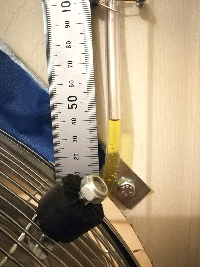

  16. This should go in the primary school boffin's corner but we don't have one of those, so come and laugh and point fingers at my failing here I was using my blower door on a small room and thought I'd see if I can measure the vacuum created. I grabbed some flexible pipe, water and food colouring, popped the pipe through the door and about 12cm up both sides. (The bubbles disappeared within minutes) I left the fan running on full for 10 minutes. The water did not move. Not even 1mm. There are air leaks in the room which I was sealing, but I don't think there are enough to equalise the pressure. I'd taped over an opening into the neighbouring room and the plastic was straining at the tape so the pressure was different. So what's wrong here?

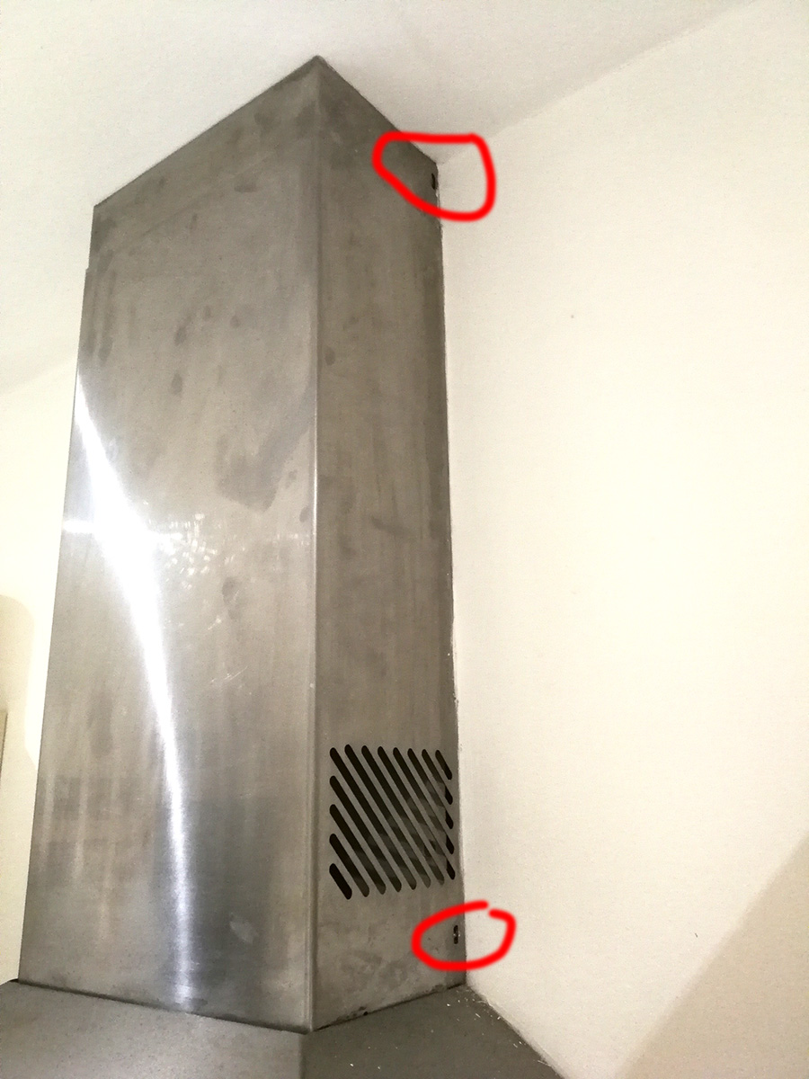

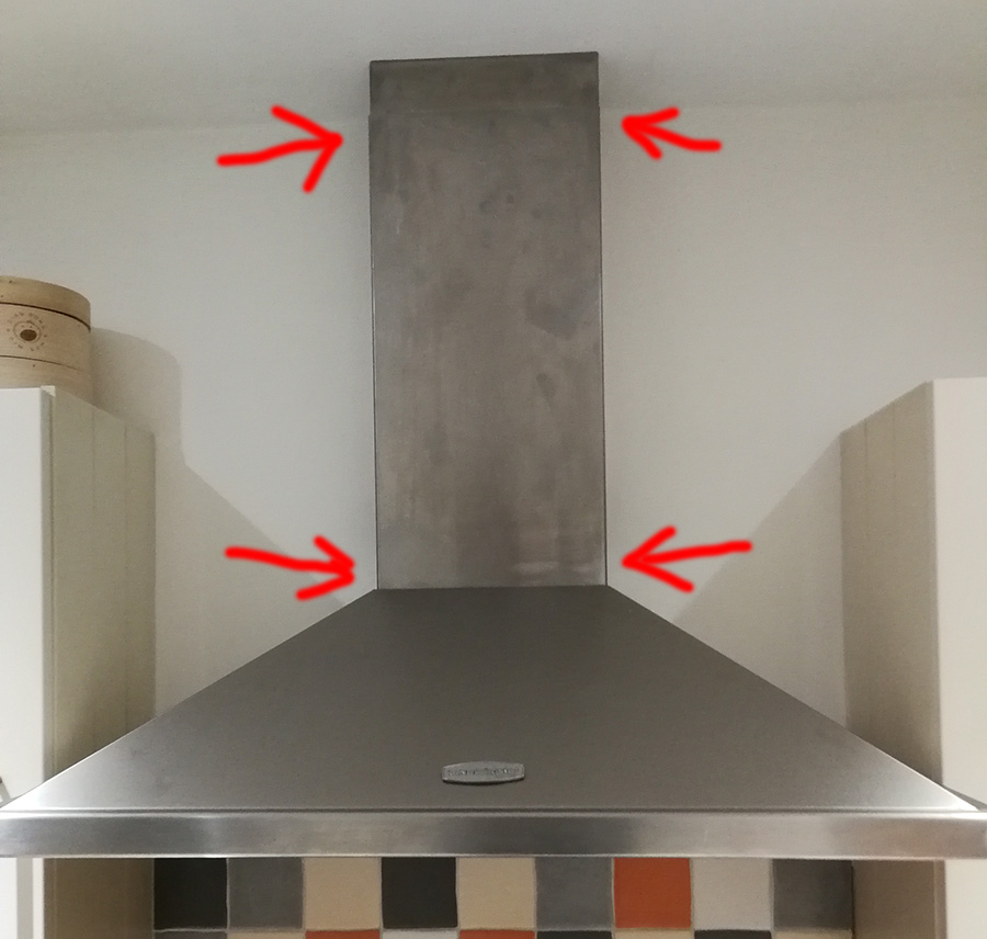

  20. I thought this was going to be a 5 minute task but... how the blazes does it come off? The guide I found said remove the 4 screws (shown by arrows) then slide up the bottom part and lift off. Then undo 2 more screws and remove the top part. So much for theory. The screws were inserted badly and screwheads burred. 30 minutes to get all 4 out. Chimney doesn't move. Ah been painted to the wall. Break the seal with a chisel Chimney doesn't move. Bit of wiggle from side to side but no up/down movement What's the trick? I'm trying to avoid using a crowbar as I'm aiming to put it back up after attending to the pipe inside.
