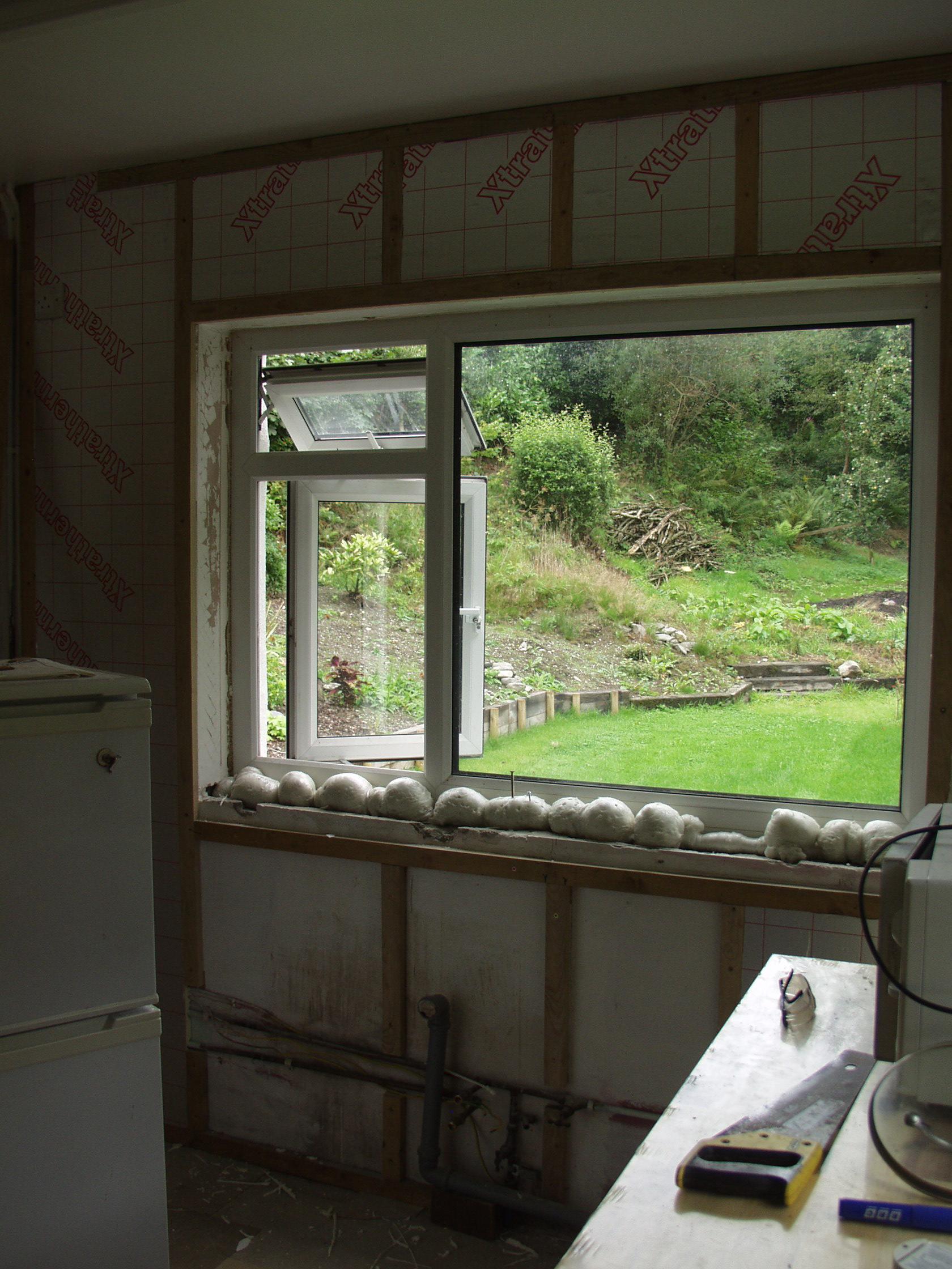

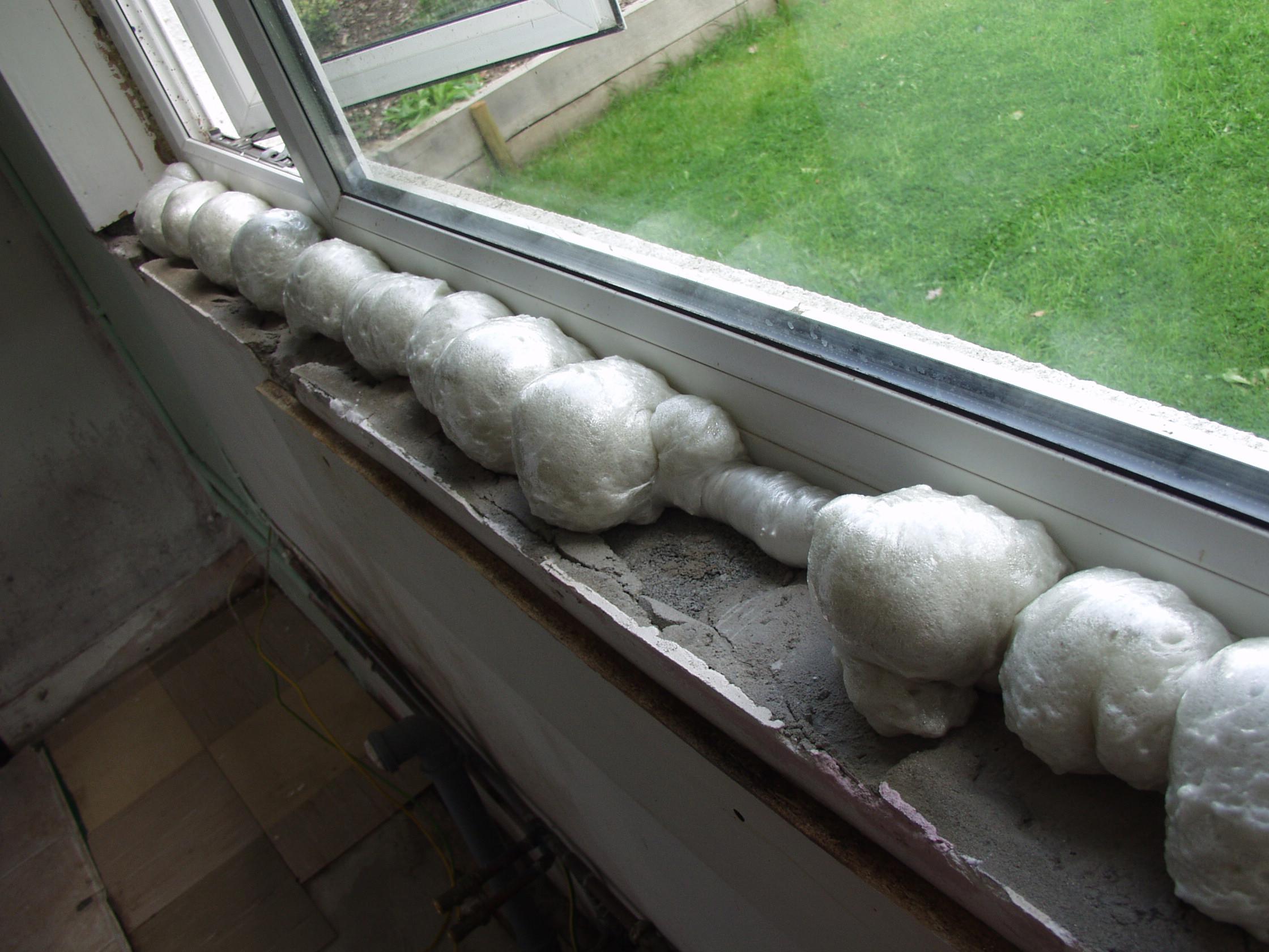

Slow progress.. the plumbing area is causing hassle re. battens. I need some advice on how the heck to C'tex around pipes: surely huge gaps are a given, ie not wise to foam around 15mm pipes. Gun went solid- took it apart & after explosive episodes, foam everywhere (how much in the gun!!) & cleaner in my eye.. damn thing works again. I'll ask soudal if they want me in their promo ads. I think leaving the gun on the can, for as long as a week is n/g. I don't recall asking you chaps re. the time to leave on can MAXIMUM before it might cease up-? thanks, zoot -

Good idea re. the sill/ foam- shame I used another whole can on the sill mind.. I can't help it, I think there's something wrong with me. -

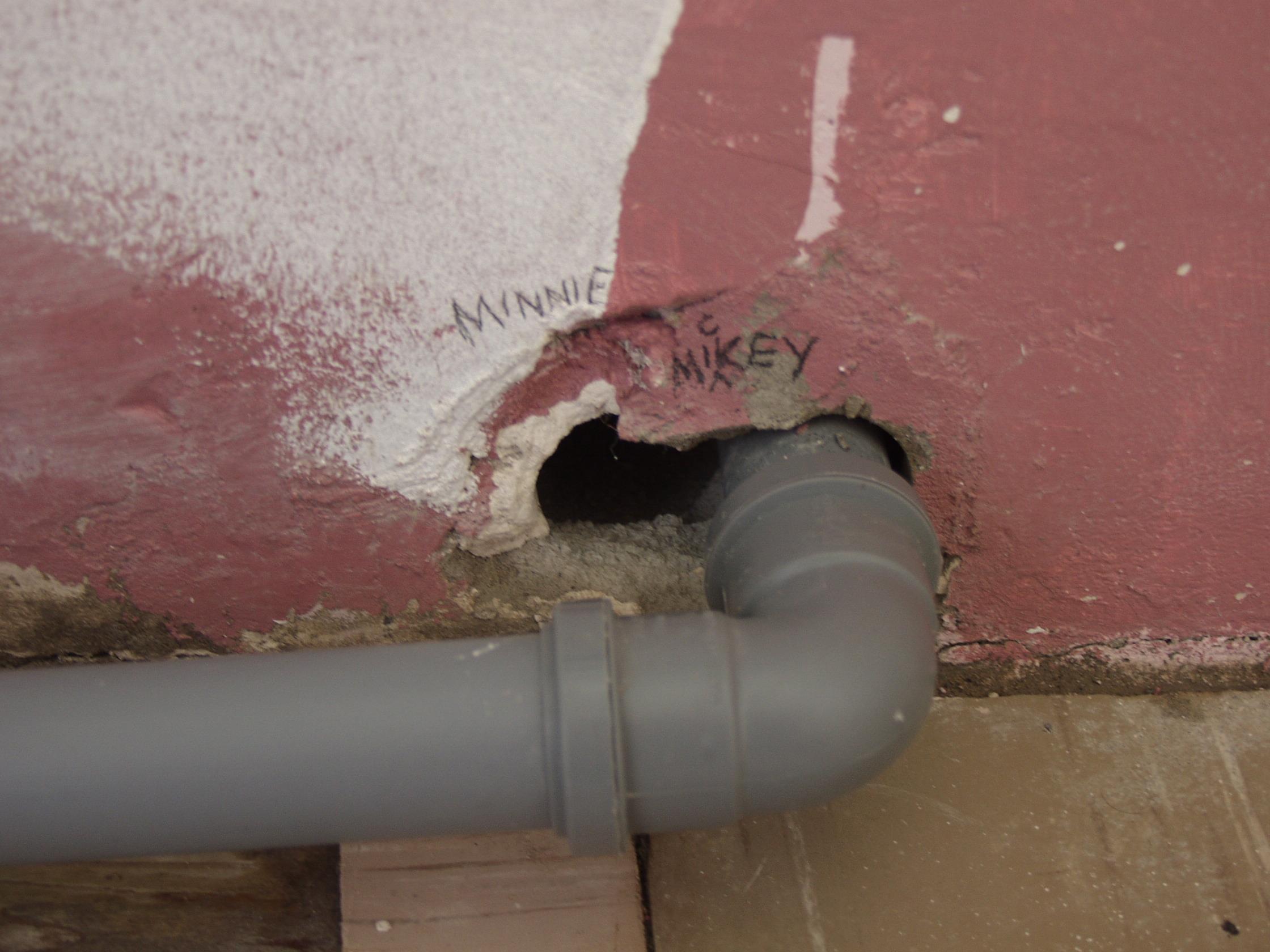

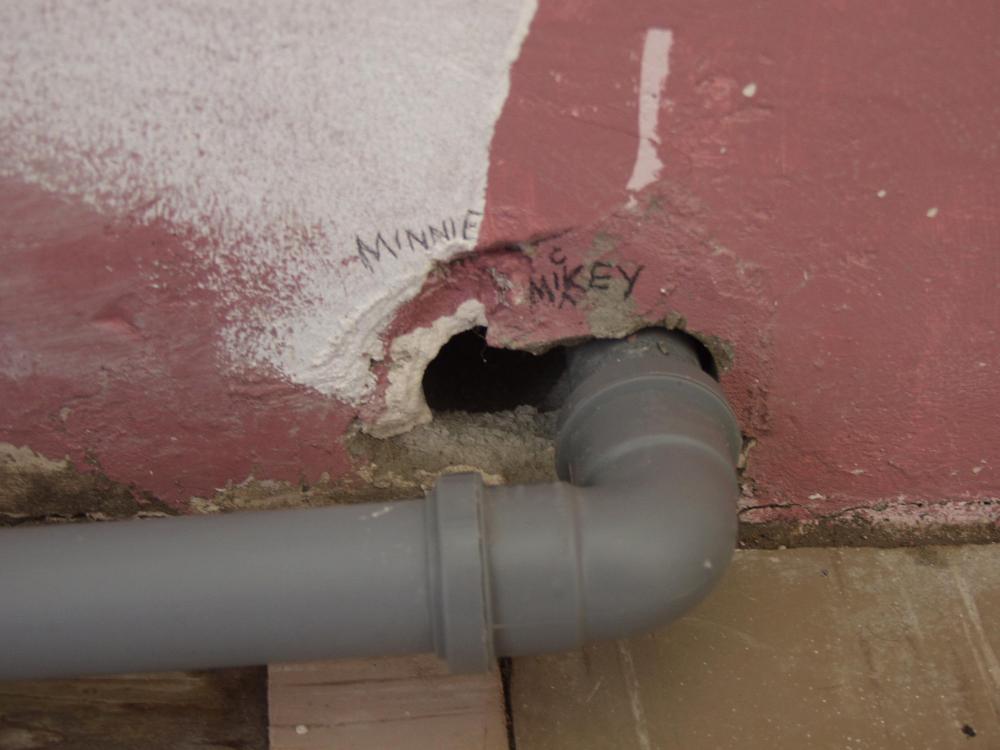

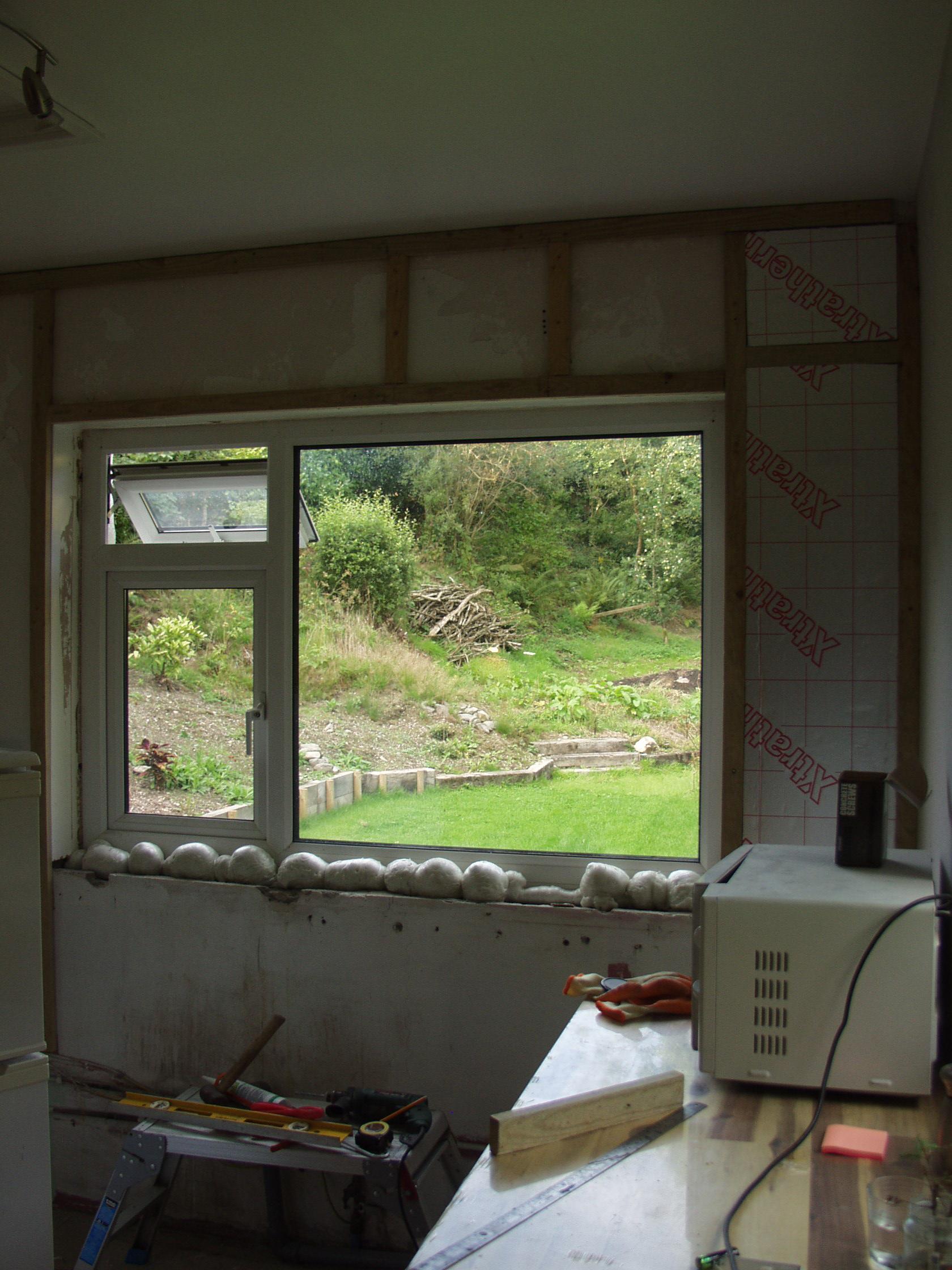

Ok will do that. Progress seems snail slow I know.. but alot of horrible mouse bleach cleaning.. plus.. Im now into codeine withdrawl = v. bad sleep/ fkn grumpy, weak. At least Im back on the beer tho. Now 1 thing I haven't got due to my fiasco 1st time, is enough PIR for all 4x this bigger window sill area: only enough for 2x sides & either top or btm. No point spending £25 for another sheet surely, esp if I've no room to store remainder. Must be a compromise: Your suggestion if you will: PIR top + pb sill.. or PIR sill + pb top? (Btw I edited the mousehole pic, with a "^ C" for miCkey.. mm kay now? -

Ok thanks chaps, & for the suggestions onoff- I'm doing the shelf mortar tmrw, so will do mouse hole as you suggest with a brick & the mortar + 5:1 pva/ water.. & a slip around placcy pipe a good idea, thx Peter. When you say soak the gap tho, do you mean a mist spray (as per pre-soudal), or a big soak with a paintbrush? (& with the 5:1 or water?) Progress today.. -

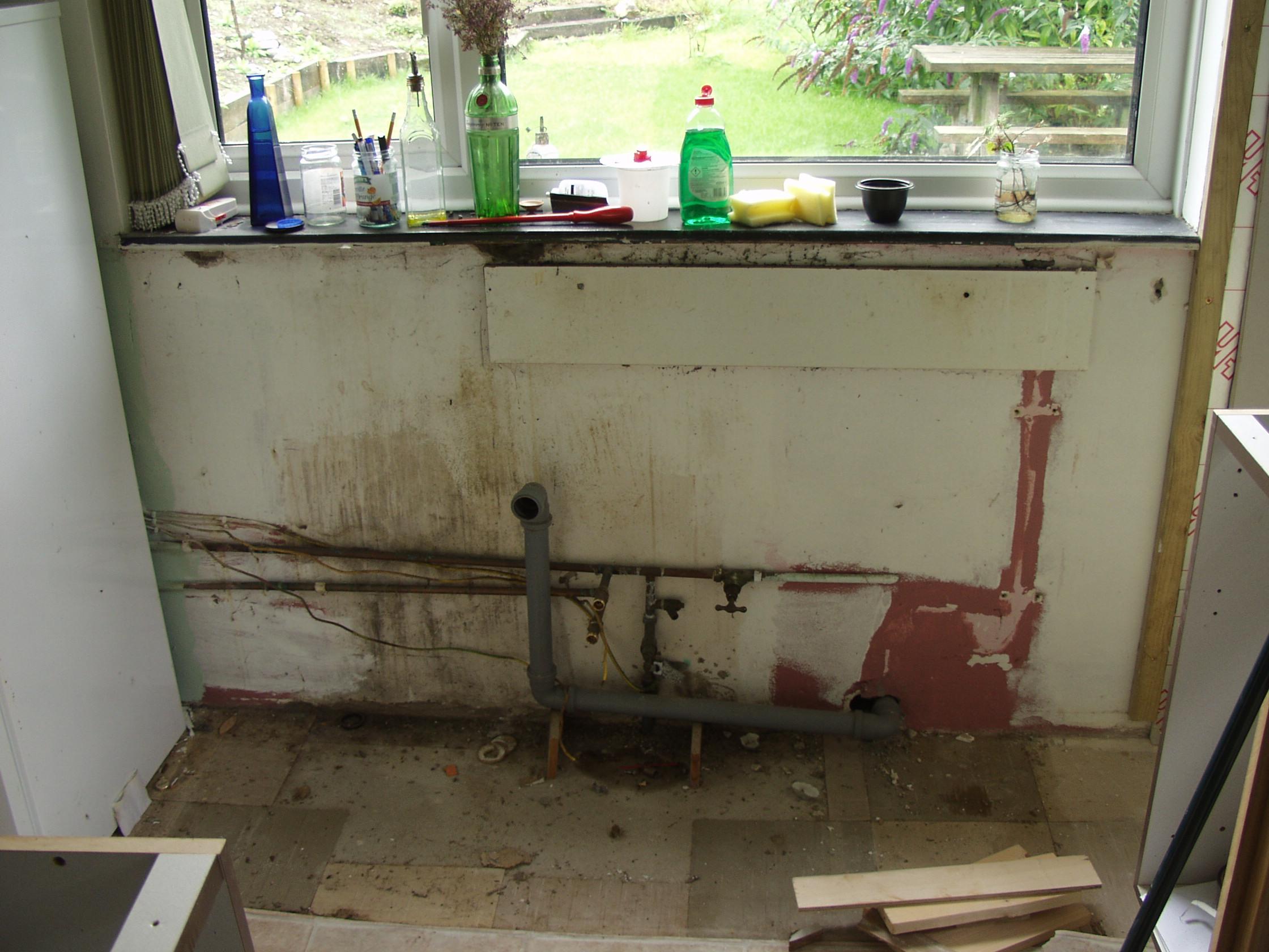

Hi onoff.. yup similar next to consumer unit (crabtree iirc): 1x BIG gnd in from above, to a big junction here > joins power Co's BIG gnd lead coming in thru wall below. Leccy this end good; my unit repositioned by a pro recently (& new Pwr Co's lead in below only months ago too). I've disinfected area, eps in sill cavity.. & foamTHING2 has been innitiated. If I can I now ask you further on this mouse hole job. I have mortar mix & glass jar if needs be (I guess so if mice gnaw > no likey?). -

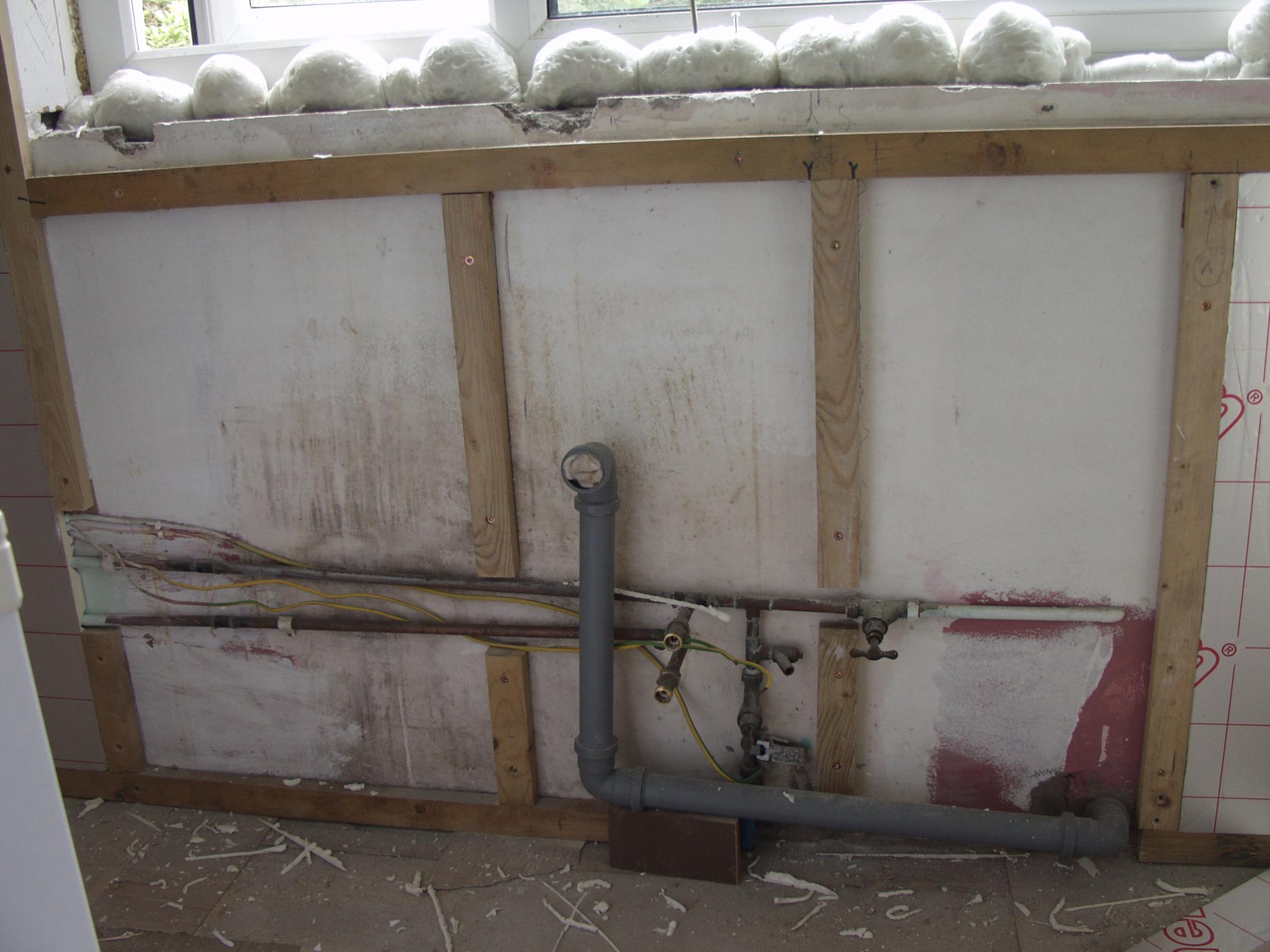

There's one that's thicker yes.. but where it comes from who knows it goes into the wall & up with the others. (equipotential bonding.. it was on the tip of my tongue!) I could connect them onto the pipes that remain before the valves-? -

Chaps what's the deal with my 3 green/ yellow ground wires terminating at the copper pipes (or were- they're disconnected now that section's removed)-? I saw similar in the bathhroom iirc. weird. -

I've prepped the window/ just got sill mortar to do tmrw (I'll foamonster2 sill cavity this ev).. so maybe you can direct me on that block-up idea tmrw. I'm sure the mice are in the wall cavites yes.. in theory then once I block hole up they can't get in, so RIP in cavities.. I'd hope. One thing I touched on before/ a Q: if mice in cavities, then I guess they have access to & from the loft above kitchen, bc the top of cavities are 'open' not closed as a basic build rule.. is that correct? I'm thinking along the cold getting in here, the priority, rather than mice per se. I put the tight fitting stuff around the pipes in cupboard back recently, as mice got in here (also on worktops now & then.. urgh.. so would be good to tighten this situation up seriously first off). Floor is concrete, with zero insulation I can just feel it so (your feet/ lower legs feel the cold 1st). Tbh I think this is where the majority of the cold's coming from, but, I guess I can't do anything about it can I? -

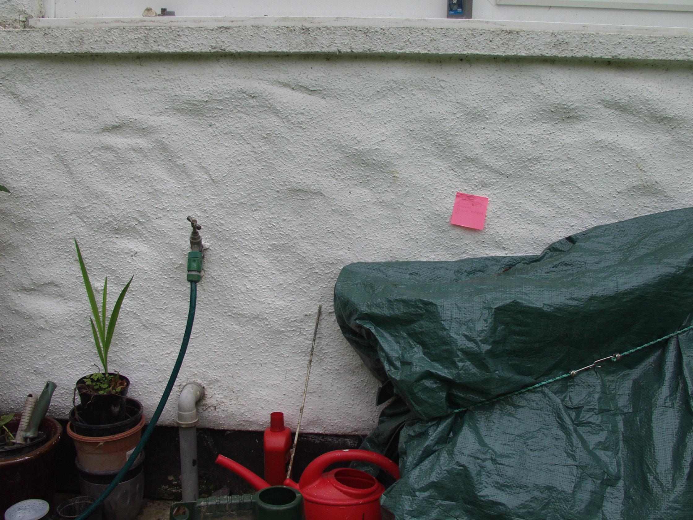

Yes I can do the sill & some of the battens.. but lordy how the heck am I gonna go around all this stuff?? I can't think of it now.. it'll be next week anyway. I see where the wretched mice have been coming in now.. like onoff said around the waste wall exit place/ big hole next to pipe. -

Actually that tap doesn't work.. not needed as main outside tap is separate, then these 2 ISO valves now. Was v. concerned about the electrical wires.. but seems they're grounds just painted. Odd place to ground them on the copper pipes: why? so I have 2 disconnected now as you can see. What should I do w'these? -

Ok I had to rip alot of it up/ driving me insane tbh.. & progress. But a world of pain awaits.. look at the state of this: -

Ok progress.. Ive turned these 2 islolators 1/4 turn & water off @ both taps now. But I'm still unsure where/ how to go on from here, having found these 2 isolators. So can I proceed with undoing the sink with just these isolators as they are? is just using these 2 wee things to shut off water sufficient.. or should I be turning outside tap off (& one on the HW tank iirc)? Thanks zoot -
