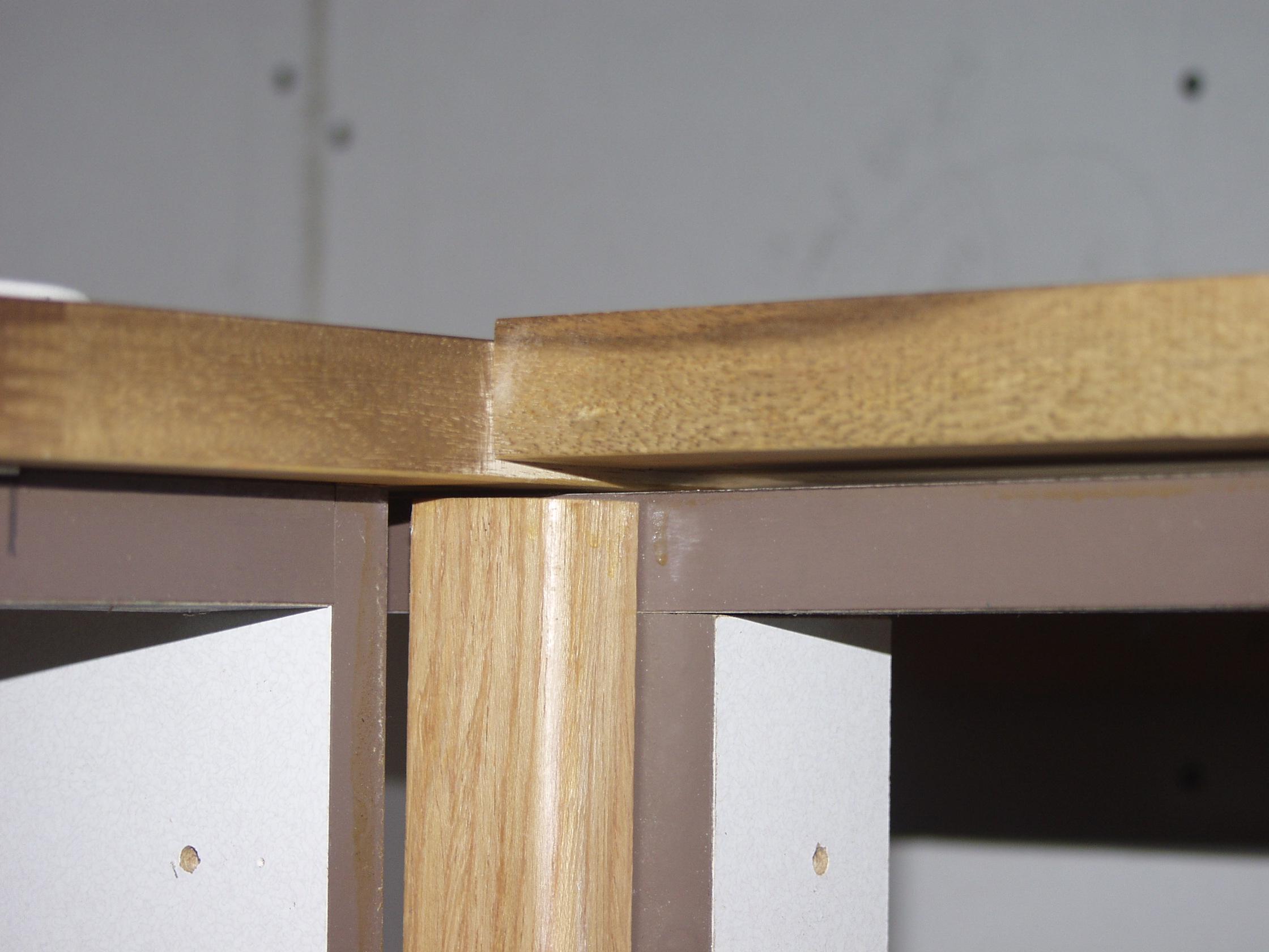

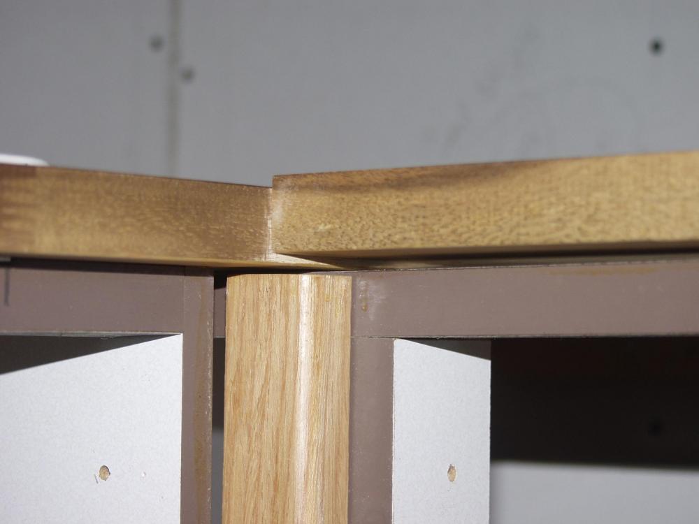

Hi newhome- will do tmrw. But issue is simply I have a warp/ bow in the top. IE if I put a straight edge across the worktop2 width I have 5mm gap in middle. So its concave. Trying to biscuit joint the end of this, to the top1 (sink worktop) side.. I'd say isn't possible (unless massive force/ a huge weight is applied which I just don't have). Trying to do a 5mm offset with 3/4" softwood is hard enough.. but 3x this width, hardwood? -

Ive gone back over the info re. joining, & clamping is mentioned.. &/ or the screw plates understood once the joint is made, but how do I try & pull the bowed top into line for the biscuits to meet? i don't think its possible, is it? I just can't think of anything to help: I can't screw from under ^ up to pull it down, as then I can't move the two tops together. The two top together are 5mm difference one end. I think the only way is to buy a new top tbh.. but no Homebase anywhere near me/ a 120m drive to p/u. Or 2nd idea is to somehow join 5mm proud & sand the fk out of it.. but the work involved to do so I can barely think of, plus the join will have a 'step' right at the main junction/ seen. Anyone know if there's any way to force this hardwood bow out?? -

Peter, sorry I'm still confused as to your 'not using anything under units, but screws & nothing else'. Its just the way with the www & not being able to speak in person (what did you mean by "not using anything under units"?? I can see one ply block which seems to span a join with the white stuff. But can you tell me what the other block is for, the smaller one? At the moment I'm having huge difficulties with these tops to join. Ive just spent the day getting the 3rd & 4th units in, & as best I can possibly do regarding level, & xyz relative to the sink tops. A hell of a job. Then got the sink into the top- very tricky this with sti=upid barckets that dont fot properly pulling down onto the cabinet walls. A nightmare day tbh. This top is yet to be fixed into the cabinet frame &/or the wall as I'm very concerned with the joining: Ive biscuit rebated 3x in each face. But the shorter top, even putting a huge weight on the thing to flatten in order to get cutter at its face.. was still pulling up 1-2mm. So I had no choice but cut like so. Now, getting them to join I think will be nigh on impossible: the shorter one I had to cut 2/3rds (1/3rd removed), is still bowing up badly meaning offering them together is a dogs dinner.. big disappointmernt after so much massively careful prep work. -

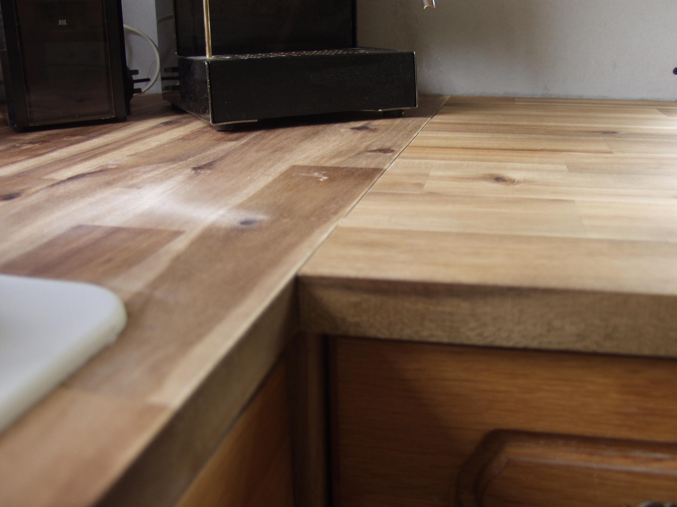

But the frames are under the top, no-? not quite on board with your not using anything under units I'm lucky as today, very wet indeed, the bow seems to have flattened out! odd.. maybe its the Osmo oil. -

@PeterW on the worktop spiel it says to leve a 5mm gap, important re expansion/ swell movement over time. Especially important I leave this re. my moist atmosphere so will be doing so. Can you remind me Peter what I'm using to stick &/ or seal the worktop to the wall.. with this 5mm gap in mind-? Top2 has already started to bow 'up' after I router cut it flush (hopefully tmrw if I can get cabinets 3,4 level relative to the other sink cabs, & fixed in). Alarming, & will make the jointing to the sink top1 an even trickier job. I've slapped somAA Osmo on underside & back edge. And can you remind me what I'm using to stick, &/or seal the sink onto the worktop-? thanks zoot -
