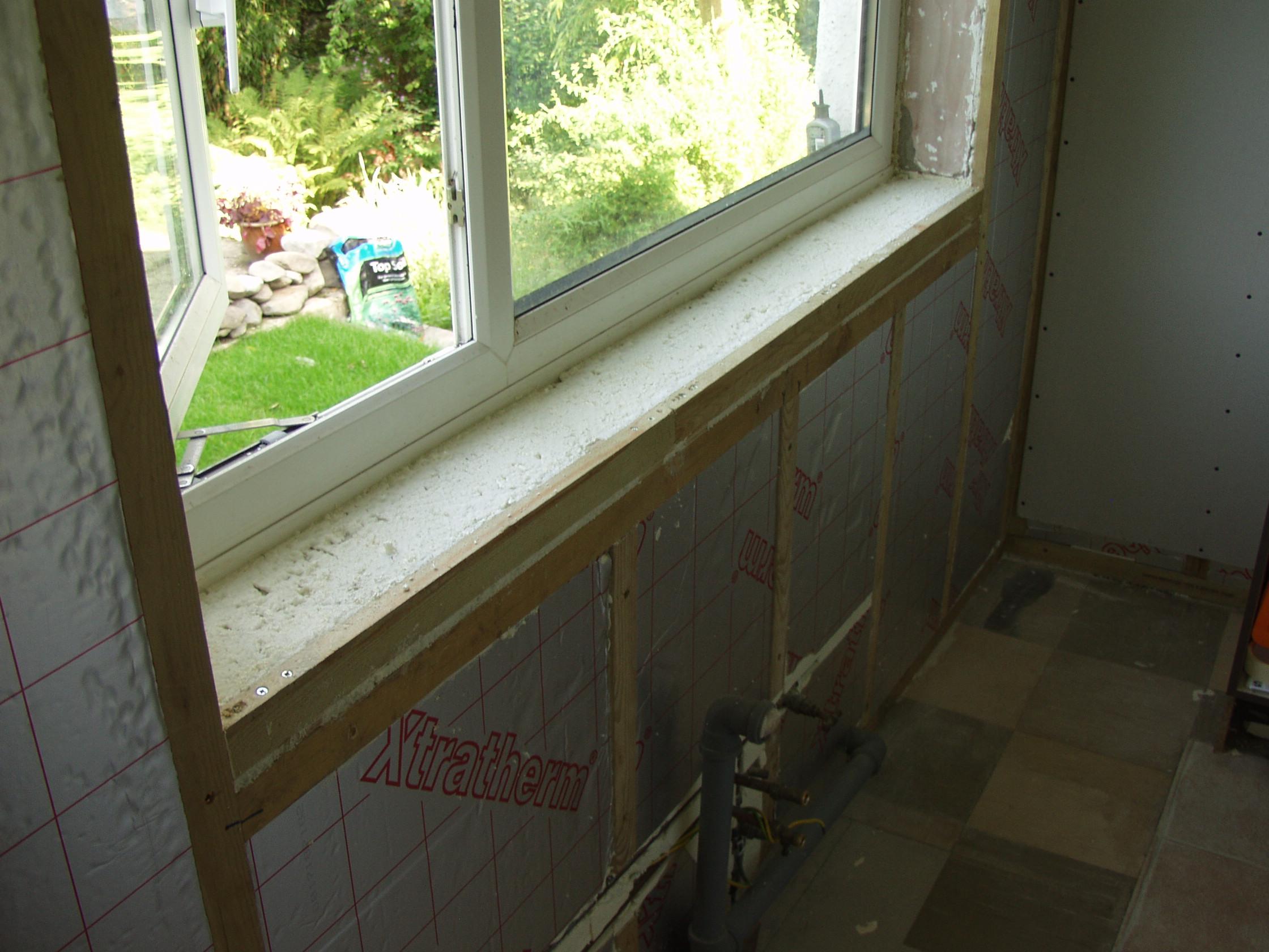

  4. Easier to cope when Im not in pain &/or having major codeine withdrawl mind you. Cheers chaps. Hard bit done, I'm hoping. Im struggling most with the soudal can, it & me are a match made in hell! (this is why this shelf took me over a day). Gun jams each time I leave it on the can, screw thing in or out. Will be glad not to have to use it again after gluing the 3 reveal bits to do. I wonder if there's any other alternative low expansion can: one thing I find it useless for is filling small gaps- well the cutting the excess/ a disaster each time I trim, as even with a new stanley blade at the shallowest angle I find it just pulls the stuff out most of the time rather than trimming.. its due to the friction of the 2 materials I think. That's with over a day cured too. I just can't get the knack of it + the gun at all.
  5. Cats + mice in my house same time is the stuff of nightmares for me. Anyway, I'm so proud of my shelf Ive spent over a day doing I'm loathed to put any pB on it now. might leave as is.. PREP DONE THO!
  6. I'm still unsure tbh onoff.. you see here is the front/ pink marks spot (of an angled-down hole thru).so would rather stand out. If it could go <Left, next to the logstore it would be alot better but I bet that complicates the job alot.
  7. Ah good to know you didn't dismiss my drill (front handle always on).. well, maybe I could drill thru after all then.. I know s'one I could maybe borrow a long bit. What dia needed/ what would be shoving thru, a pvc pipe or something? This window demolish & UPVC replace.. boy am I looking fwd to: I bet I could fit that in less time its taken me to prep this sill for the pB!! I'm embarrassed to say how long.. won't.. only finally, the whole wall's prepped for the reveal pB, & main wall pB's.

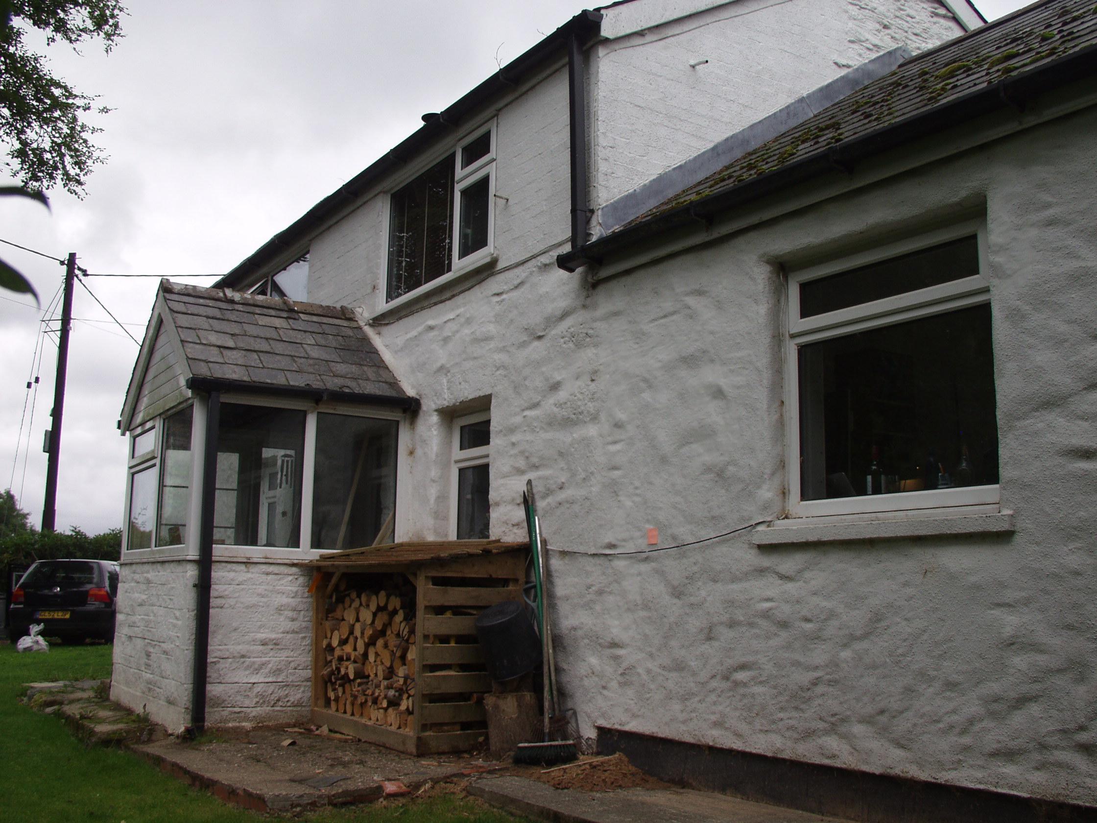

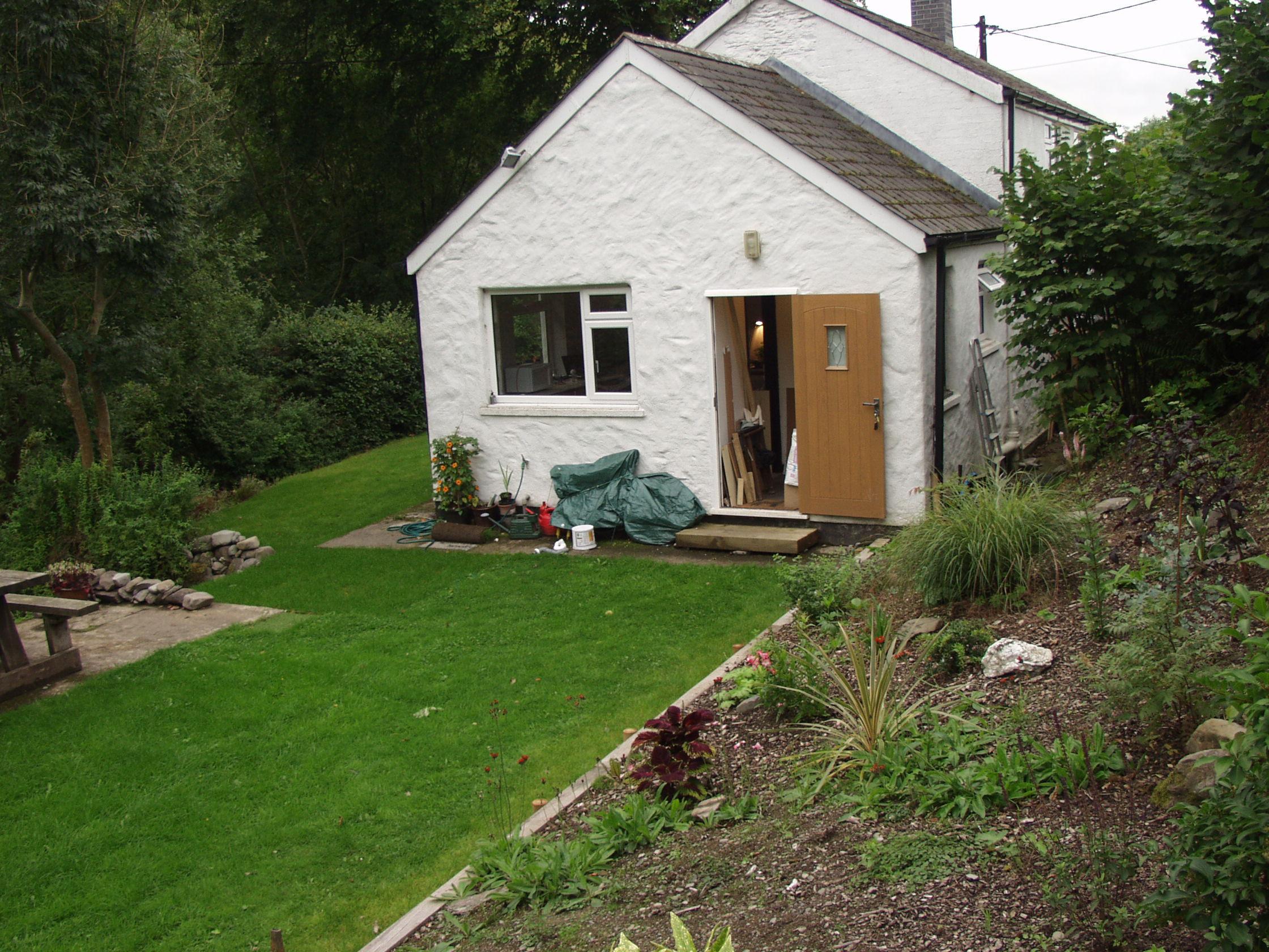

  8. Actually onoff the Ext Pic is the end of house (the sink wall2 Im now doing), not the front.. & this nasty swivel light will be gone as soon as I get up there. Will add pic of front later. You can see into the back door (howden's "engineered core" cr*p with seals falling out, bowed -in 6 months- due to damp atmosphere.. demanded my money back from builder who fitted it way too fast/ bad job) into 2sqM hall-utility room I call it, then Left into kitchen. So I do have to consider this 'leaky-cold' entry point/ tiny back hall-UT bit after kitchen done (with old single thin window/ to replace with UPVC: to do next- easy enough I'd think even for muggins here!). No door into the kitchen from the hall-UT.. no room to open.. just a door frame. So all 3 rooms within this 70/ 80's extension. 1 tiddler 'hall/ UT', very small bathroom, kitchen.
  9. Hi onoff.. I thought I'd post that pic to give you an idea of the house Ext; yes it is a quaint welsh cottage.. with the badly made 70/ 80's extension, & I have been mulling over the Ext socket idea: if its white, & tucked down & L a wee bit it wouldn't be so obvious. I'll think on this.. but I don't have a huge long drill bit, or I'd have thought the torque to get me thru with my ~small bosch (PSB 400-2) hammer drill.. I don't want to burn it out. Understand the soffit hole idea: only caveat being it would introduce cold air: yup good to put off mice, but adding to the loft cold? whcih in turn lessens the impact of the loft insulation a bit-? anyway last on list/ could be done last. Newhome the kitchen loft was Pro done -in 20mins flat- last year: which means they just plonked thick wadding bang ontop the old orange stuff between the joists.. just whacked it on: a major pain if you want to get in there as all the joists covered, I thought way after it was done.. I only saw how they did it after they left of course, assumed this is the correct 'new' way. Got a grant to help me on this, so couldn't/ can't sniff at it at all.

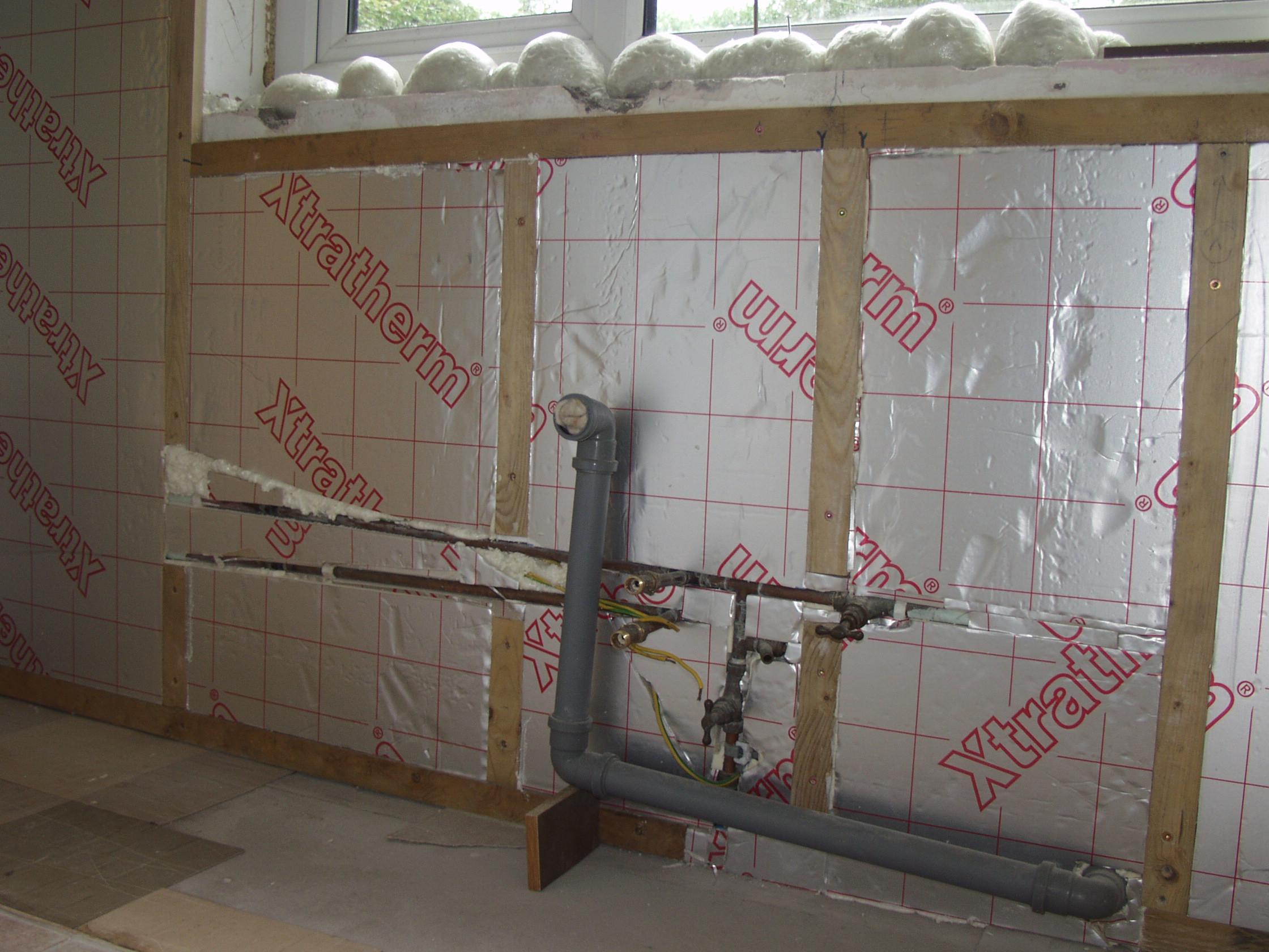

  11. I was doing well with live traps my last house. I like the idea of flinging them over onto my n'bors patch waay over the brook. damn cats will be the benefactors tho. I dont like traps = dead mice all over again, & same with poison. Anyway mice a minor issue. Tmrw reveal will be done, then onto the 1st, trickiest pB PM.. I need to get in & trace that 'C' outline to cut out.. I'm going to use a long thing to get in there once pB wedged in.. could be another catastrophe. Can't wait for new sink jesus.. washing up in the bath at the mo, mind you kills 2 birds..

  14. Really terrible dead mouse smell over half the kitchen, & working on 2nd sill today (prepped for the pB) I defo can say its the sills.. which makes perfect sense being they're the only section Ive removed/ replaced.. all the other wall faces etc I've only added to (& the mickey hole is improved). I can only conclude that the foam is -not- an air tight seal: I don't think anyone actually said it was, I just assumed it would do/ its primary job. I don't suppose there's anything I can do to rectify this now. If it continues its not conjusive to live with like it is, in a kitchen. major issue-?

  16. Too late Im not fkn gluing all the foil back on!? cheers newhome, alot of hard work that was: pB gonna be trickiest bit, but I'm going form L to middle, & from R to middle.. leaving a small middle bit to do, to coincide with most of the pipework faff area. I'll just have to wing much of this 3ft sq section.. or I will go proper loopy nuts.
  17. Onoff, going back to the sill I'm having to wing (no ISO pB left for it).. think I could level off, mortar as before then stick some C'tex on with soudal, pB onto C'tex with soudal too, pin front as before with screws-? It would add some extra height tho. Or just soudal-stick PB to the mortar as a compromise? I'm having trouble with actually thinking actually how to do the foam layer-by-layer you see, & cut flat.. the idea is clear in principle tho.

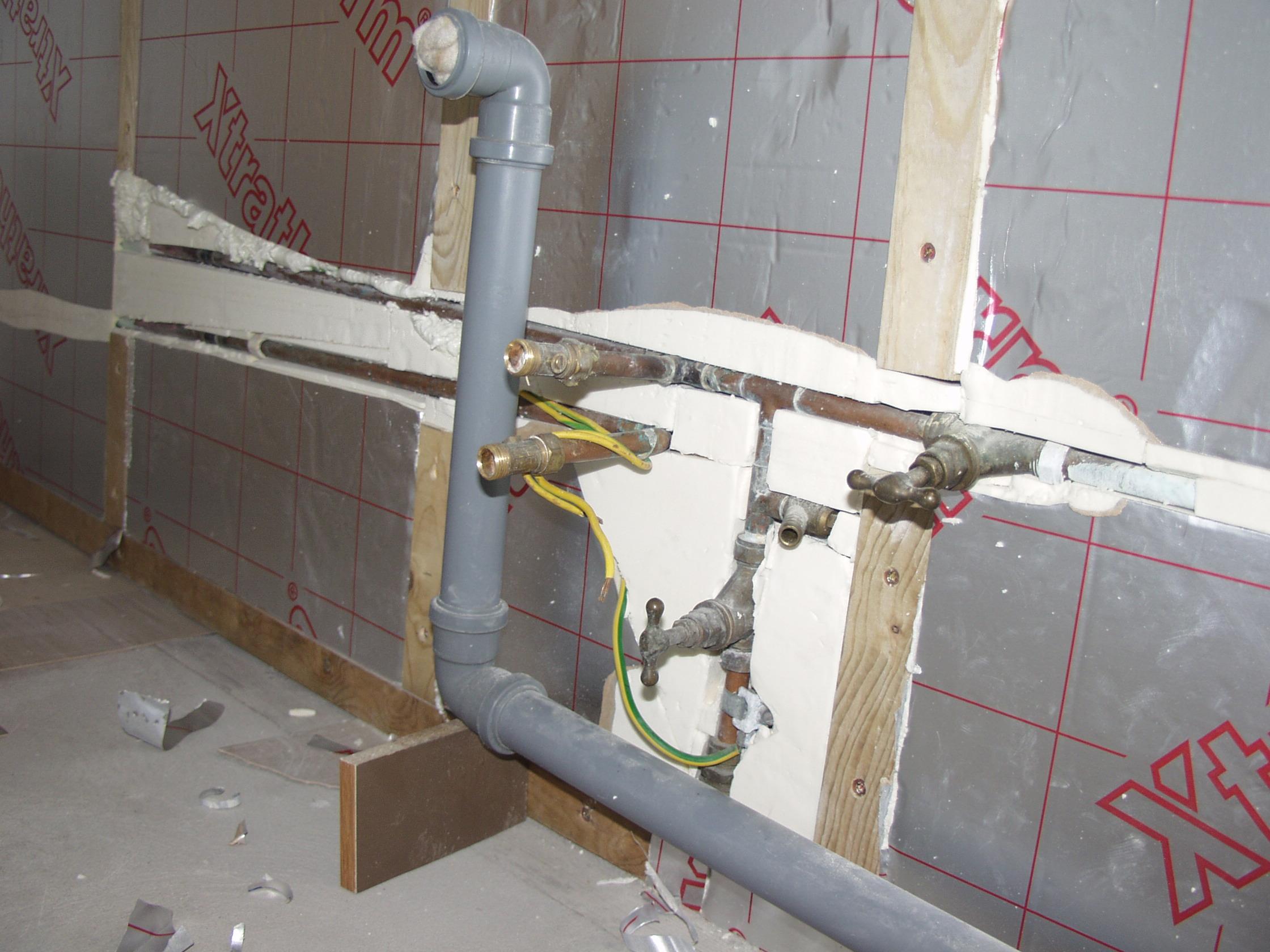

  19. Right this is best I can do/ stripped off the alu adjacent to pipes.. the reaside- will have to be as is/ alu on, alot of its now foamed in place. I think less likely the backside alu will be an issue/ farther away a tad. And any more on this tricky area & honestly, I'll start to lose my mind!
  20. Crikey.. too late now. It'll have to be as is onoff.. Ive spent 3 days on battening & C'texing just this wall. And Ive still 1/2 a day to do the sill even yet.

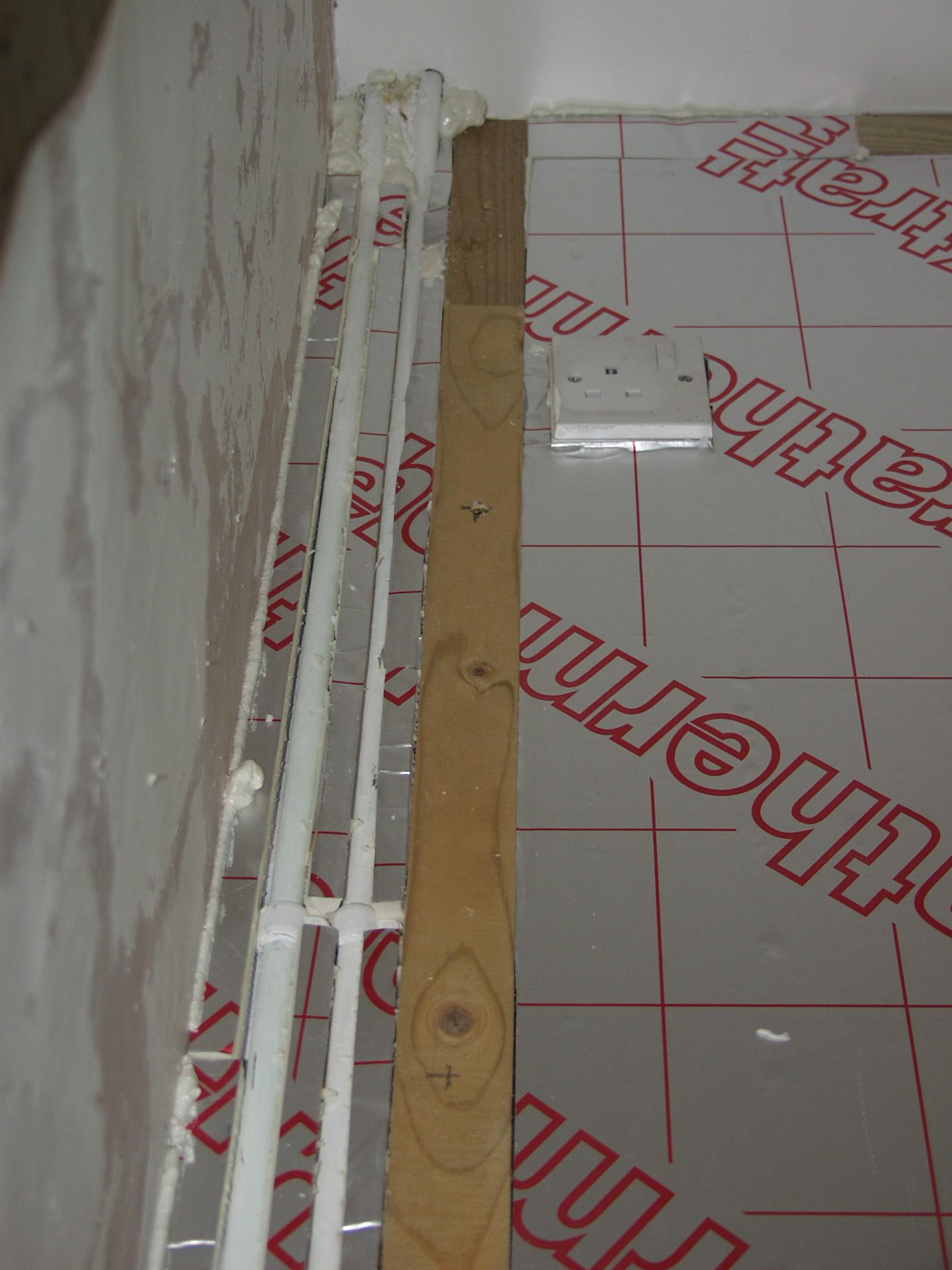

  21. Actually the pipe does slip round a wee bit on itself at the joint, enough for some wiggle room. Tbh no it doesn't feel warmer, I may feel something after C'tex ing this 2nd wall, but, with one window fogged/ shot/ to replace, the very adjacent tiny Utility room area & adjacent v.small bathroom both ice-cold, a back door very close.. & the main thing: the floor just hopless re. insulation- I wasn't banking on there being much difference if any even after all this work. That's just my hunch & I'd LOVE to be proved wrong. One may ask the relevant Q 'well why go to all this work??'.. to which the answer would be that I just had to see/ try it, in case it did make even a modicum of difference, or it'd have nagged at me for evermore (if nothing else) if I had left as it was. Time will tell, but I'm not optomistic tbh.
  22. Hang on what do you mean copper pipe not contact alu of the C'tex??
