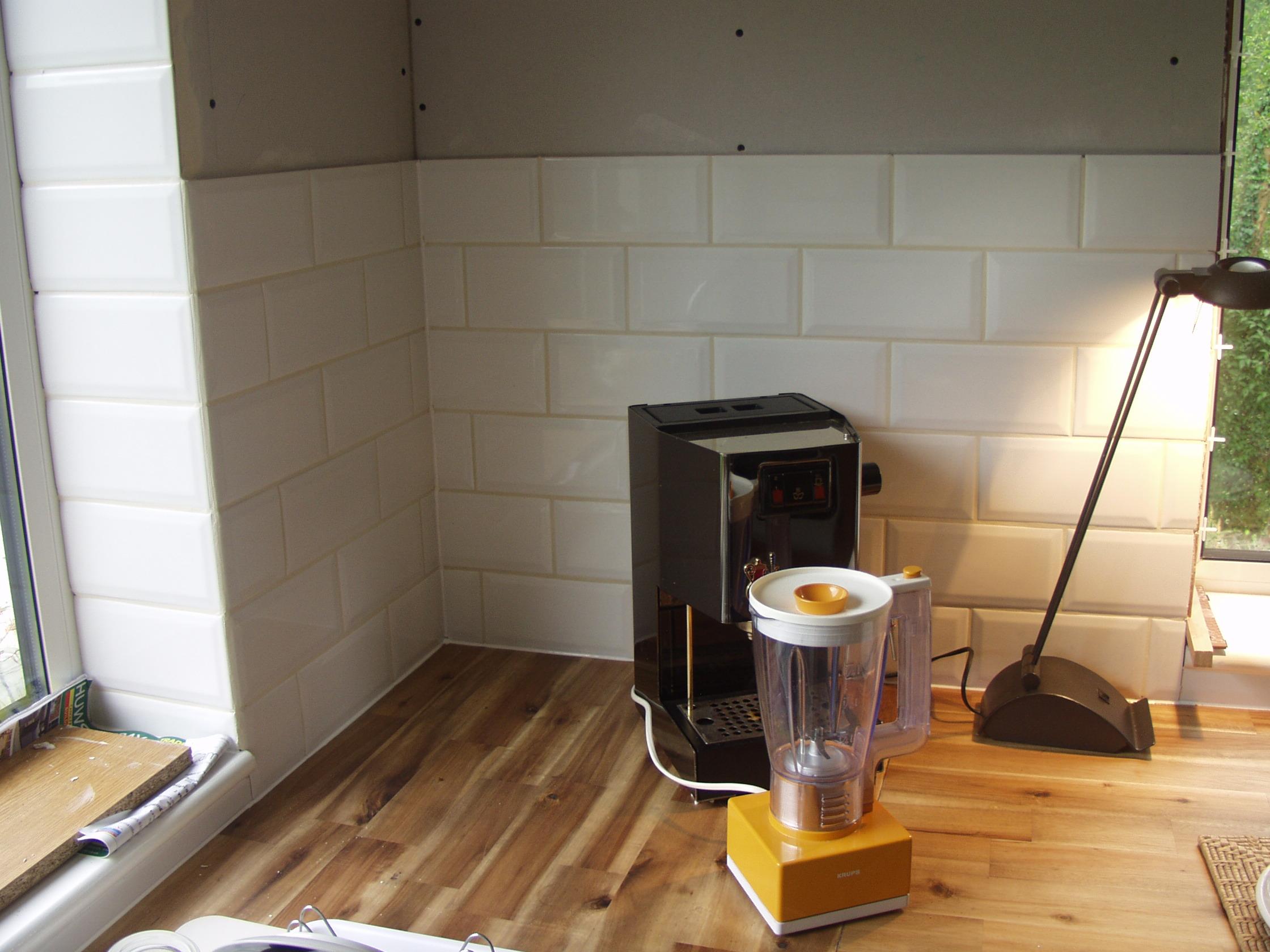

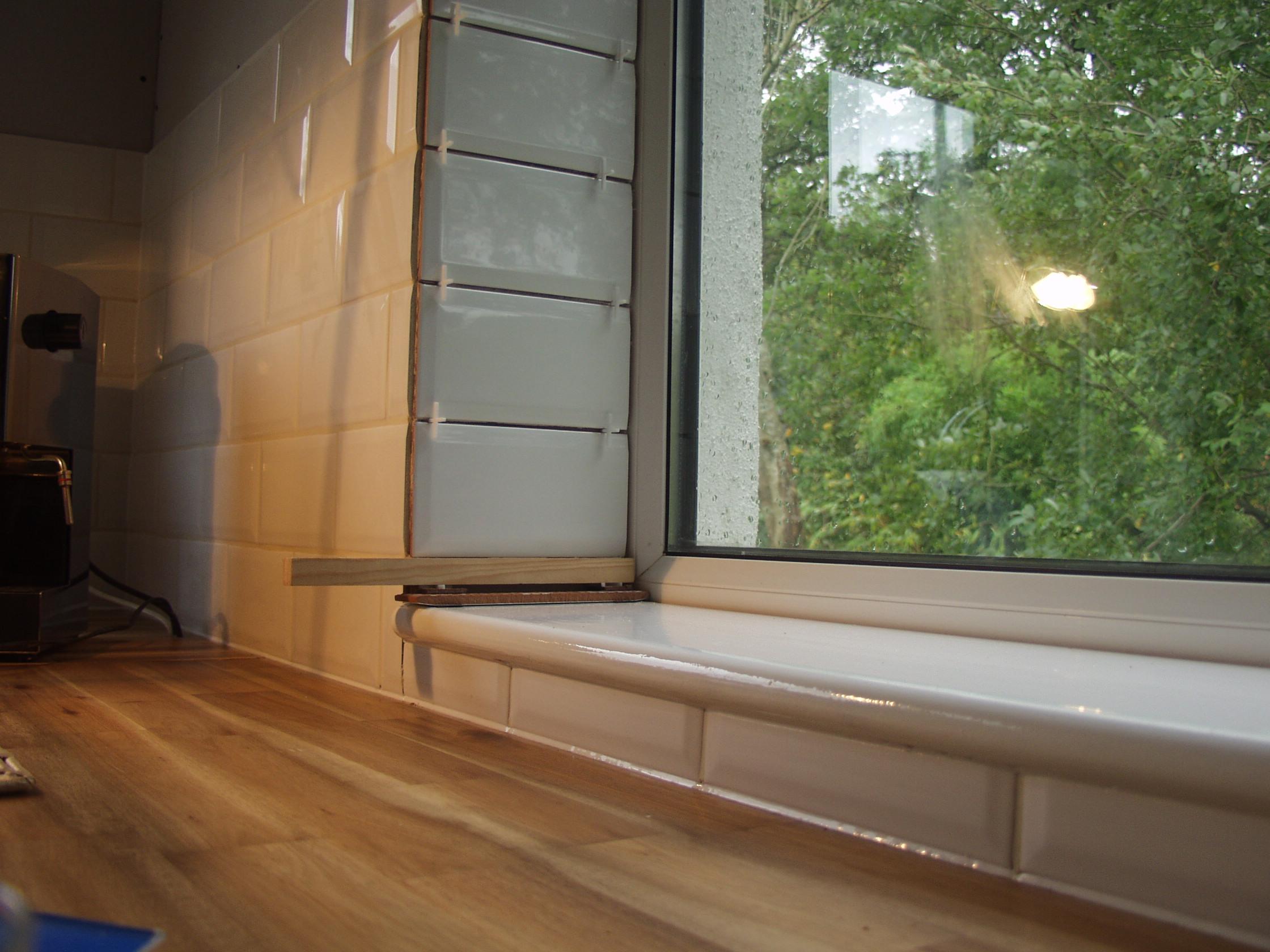

  1. Great help thanks! I do like an onoff sketch in the morning.. Ok the thing I don't have, are both pB tapers @ the corner areas, where the reveal meets wall pB's. Both window reveals similar. So adding the plaster bead will cause a nasty step. I recall you saying I could feather-in this, back to the pB face (assuming I'm only filling the screw holes/ sanding flush/ = pB's done & prepped for painting: is that the grand-plan idea?**) I think I might do away with the tiling corner trims: although neater, I think a -major- faff for me to get right 1st time (especially the corner pieces). I used grout carefully moulded (& a quick job) to finish off edges of my bathroom tiles fine, in a 45* slope.. so could do same across the corner junction of the tiles (leaving a gap > fill with grout into a neat 45* angle).. & on the tops like my bathroom tiles. Maybe preferable to placcy too-? Can you just remind me though what the bigger picture is, re. **finishing off the pB itself? the last upper 3rd of reveals will still be bare pB.. & top too: I think its sensible to finish off these bits before tiling maybe, as you alluded to?

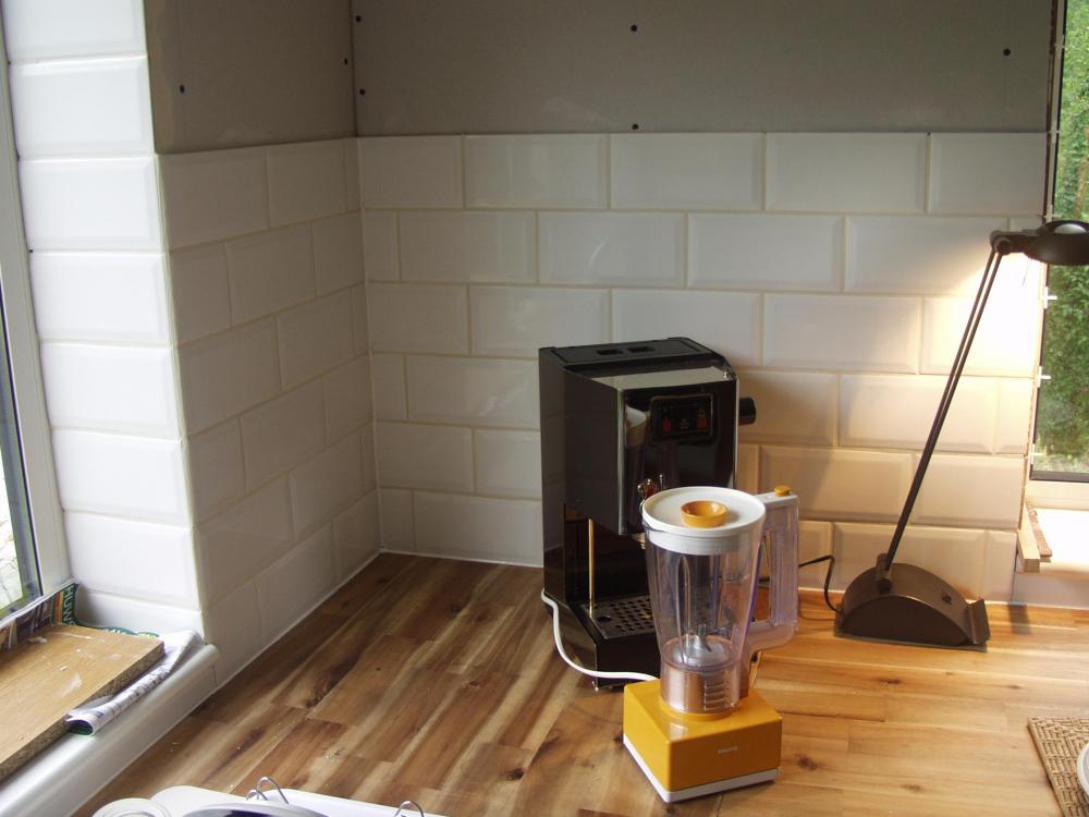

  2. @Onoff can you give me an idea how I finish the 3 sides of the reveal area: do these need finishing before the tiling of the corner area (simply the 2 big pB face areas above blender & gaggia)? I was thinking of tiling today, from the LHS vertical edge @ reveal here >> end on RHS vertical edge of the other sill, as I thought this simplest. But exactly where to start the very 1st tile (relative to the reveal edge, at Left, this -is- where I will start from).. I don't know. Set across the reveal edge 1cm? or flush with reveal edge? if flush then how the bare pB ends will be finished/ how much thickness this will add etc etc. I could tile the reveal.. but, I 'm only going up to 60cm of corner, which equates to 2/3rds way up reveal (if I follow this tile top line around).. so what happens to this last 1/3rd of bare pB reveal sides, & upper reveal section.. also as you can see the sink reveal side has a bad convex 'bow' half way up, so I think tiling this out might be tricky.

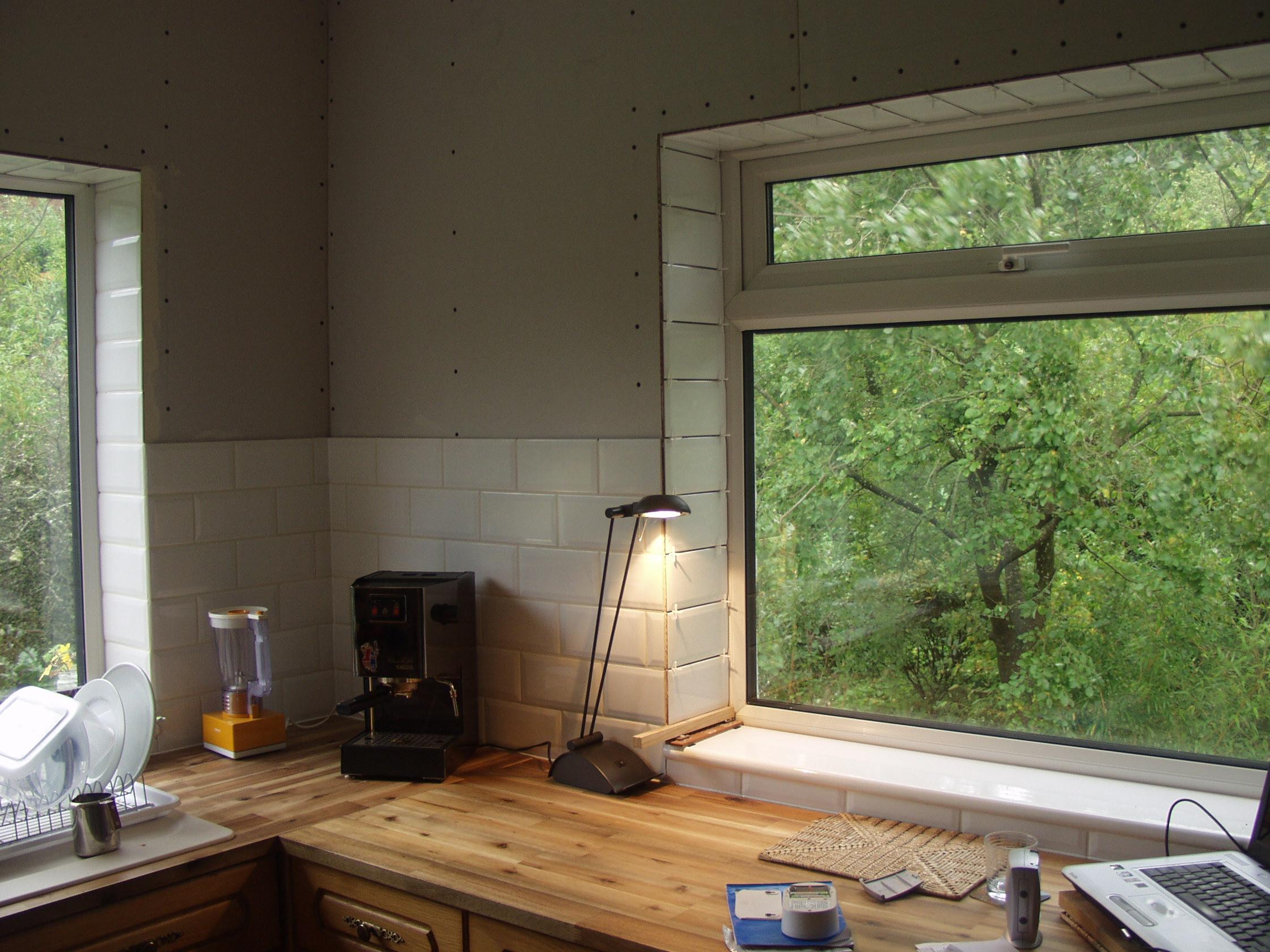

  5. Anyone know how to plan the tiling for this corner area with 2 windows either side? I'm using 20x10cm tiles in brick pattern. thanks, zoot

  24. Could someone help on my tiling plan.. I've looked at www info, centrelines etc/ perfectly simple for the cooker area.. but my config for this awkward sink side "L" shaped corner worktops + 2 window areas, doesn't tally with anything 'standard' afaict. What I plan to tile is.. from the RHS of the sink sill: 60cm H of this corner area + the thin strip under sill 2. Thanks alot zootH
