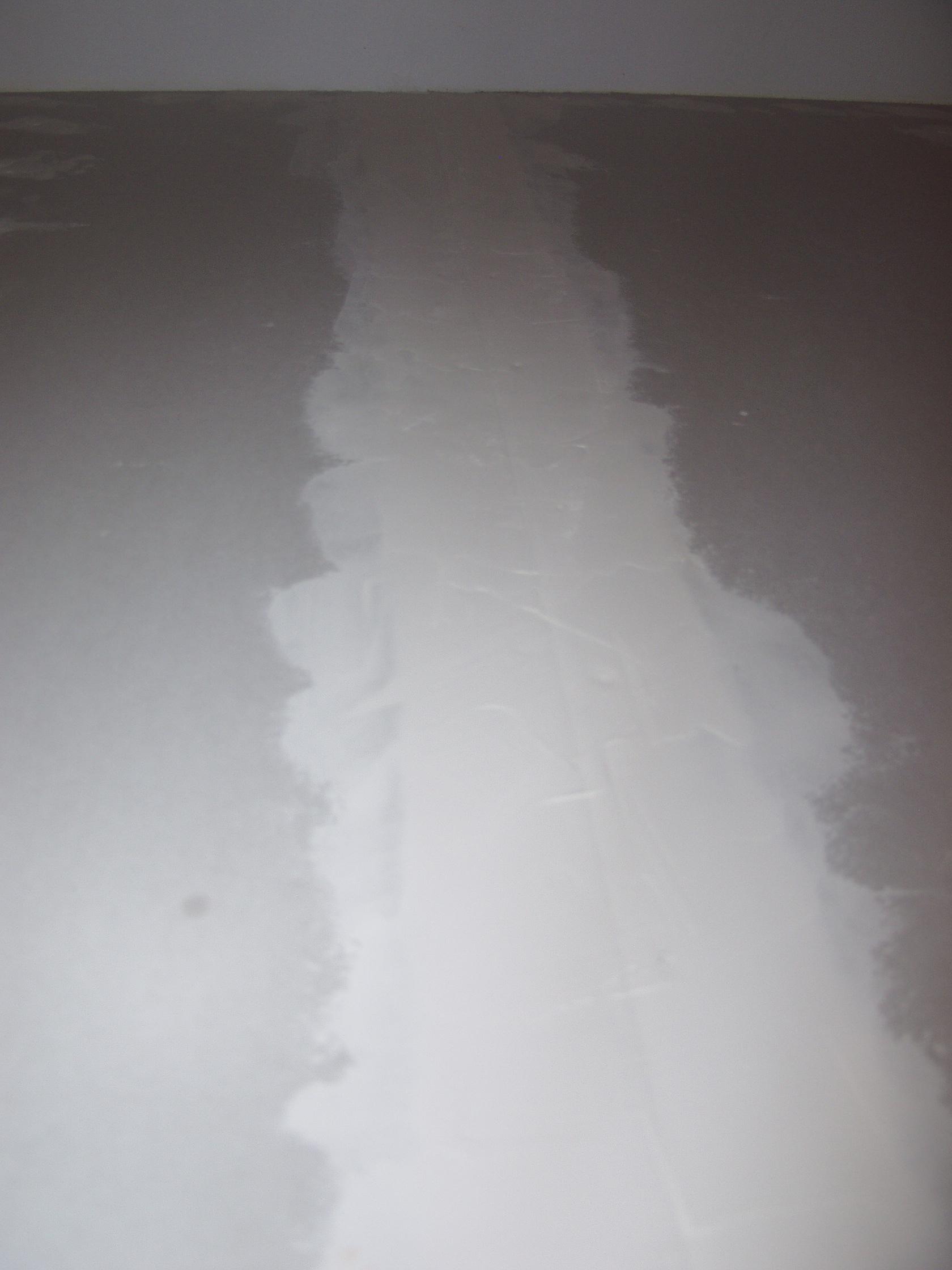

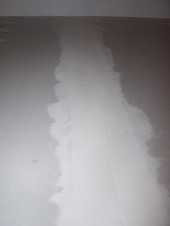

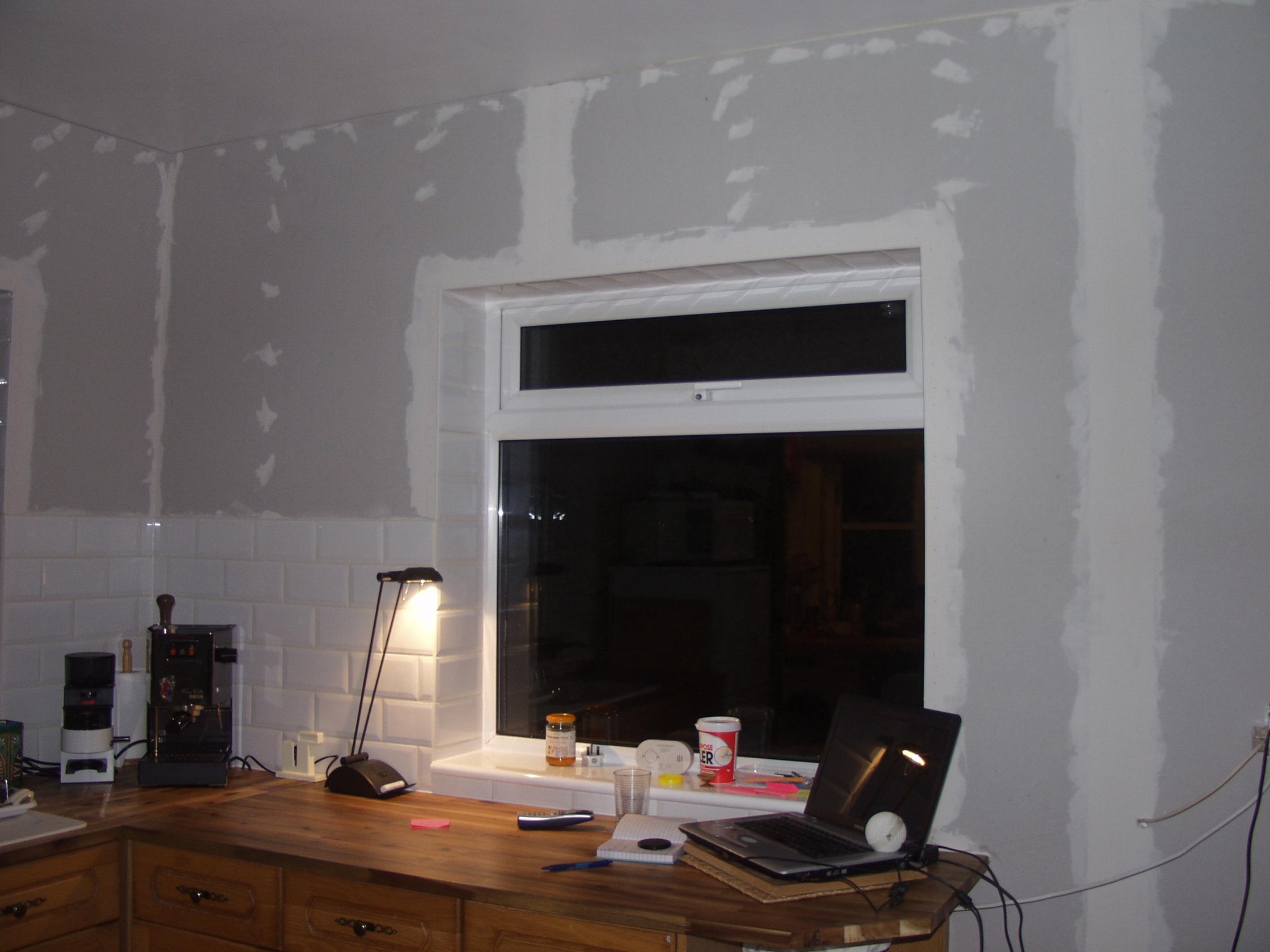

Is the knauff stuff the same 'finishing' grade as this tub stuff? the powder all seems fine/ malleable as it was inside.. I hate to waste the vast majority & I can only chuck it afterwards Ive no room to keep it, & it'll not keep in my moist atmos here anyway once opened. -
Help with kitchen renovation/ 1st house.
zoothorn replied to zoothorn's topic in Bathrooms, Ensuites & Wetrooms
I bought the 20kg bag months ago with the pB etc.. its not been opened. you think its n/g, now ?? the edges were a royal faff.. I was covered in sticky jizz all over my hands & trousers, but I eventually got it up.. then forced some filler in its gap at the end to finish off. -
Onoff, think I should go for a 5kg tub of 'finishing plaster' rather than my HUGE 20kg bag of knauff powder Im only gonna use 1/6th of? this ~sort of tub I mean, £5 in town (but 'finishing plaster' its called). I have only one full 2.4m height pB taper join.. two 0.5m taper joins.. these edges around 2 windows (pink jizzed + pins).. plus all the piddly screws to fill. https://www.wickes.co.uk/Wickes-Ready-Mixed-Plaster-Skim---White-5kg/p/607027# -

I think I'm with you.. so pop the nib/ beady bit down, just over the edge of the tile (down ~5mm~ in your sketch)? -

Aha gotcha- the pic tells me alot. ok all set to do this wknd. Thanks Onoff -

Kapisch all the way up to.. " Fill over a fair distance to loose the "kick". Wet finger along the nib of the plastic so you get a nice straight edge. " Mmm.. sorry don't understand the kick or the wet finger = straight edge already. So fill the gap between nib & tile edge.. with grout? -

Ok I just needed confirmation that my basic idea -was- feasable ie cutting half of the eg pic above.. totally off (so the pic isn't representative of what I'm doing? this is why I'm confused here, these "L" shaped solid jobs it seems are exactly what I'm -not- doing.. unless I'm missing something still). Right so no nails? I thought this stuff was attatched with specific pB pin/ nails. Then I'm (eventually) filling over this half placcy side, with the pink knauff stuff-? -

Sorry Peter I'm not on board here. What does bond over tile edge mean? but bond what to the tile edge? I can't add any of the "L" shaped corner suggestions I don't think, as the tiles are set in place, if that's what you mean.. I'm only going to progress with.. a sketch (or a bodge job me guessing- I don't want to mess this up). Onoff can you come up trumps here-? -

Alas I just can't see how any of these suggestions I could actually do. The tile pic above is n/a as the tiles are set.. there's nothing I could 'tuck' this "U" shaped piece of metal into surely so I don't understand this suggestion or the 'L' shaped metal corner (but where would this go- under tiles somehow??). Stained timber- but how would this be attatched? I have bought the screwfix 9.99 plastic corners, but again I just can't see how I can use it (or how to attatch it, nails just into the pB? surely not). The reason I didn't use the corners before the tiling job, as would now seen to be perfectly simple, is I had no idea of the process/ never used before, had no idea they attatched to the pB face prior to tiling so would stay put.. I thought they'd just fall down/ a nightmare to use without any experience of fitting them before. With any of these 'L' shaped corners I cannot understand why the suggestions of these type, such as PeterW's below are being made (to go -over- the tiles??)- I must be missing something glaringly obvious. again. -

Both good ideas I think, but with the white trim (that I just binned 3.5m of!!) I'm just not sure about such a 'cheapy' finish, being so visible- this stuff I used ass the splashback ok as its tucked away. The rim around, of 1" maybe white to blend with tiles is defo a good suggestion. If I used the timber.. what would I attatch it with? If the tiles weren't 'Contoured, Insane Asylum Reclaimed' as I went for.. I could just use a series of cut 1" wide tile sections. Hmmm. My OCD is kicking in. -

Onoff do I nail this stuff to the pB? I guess whta type of nails is important as to adding height/ then all needing plastering over. Just to reiterrate: I -only- have 6 reveal edges like this to finish, all tiles-meeting-pB (so knocks n/a as tiles will provide a hard edge).. -

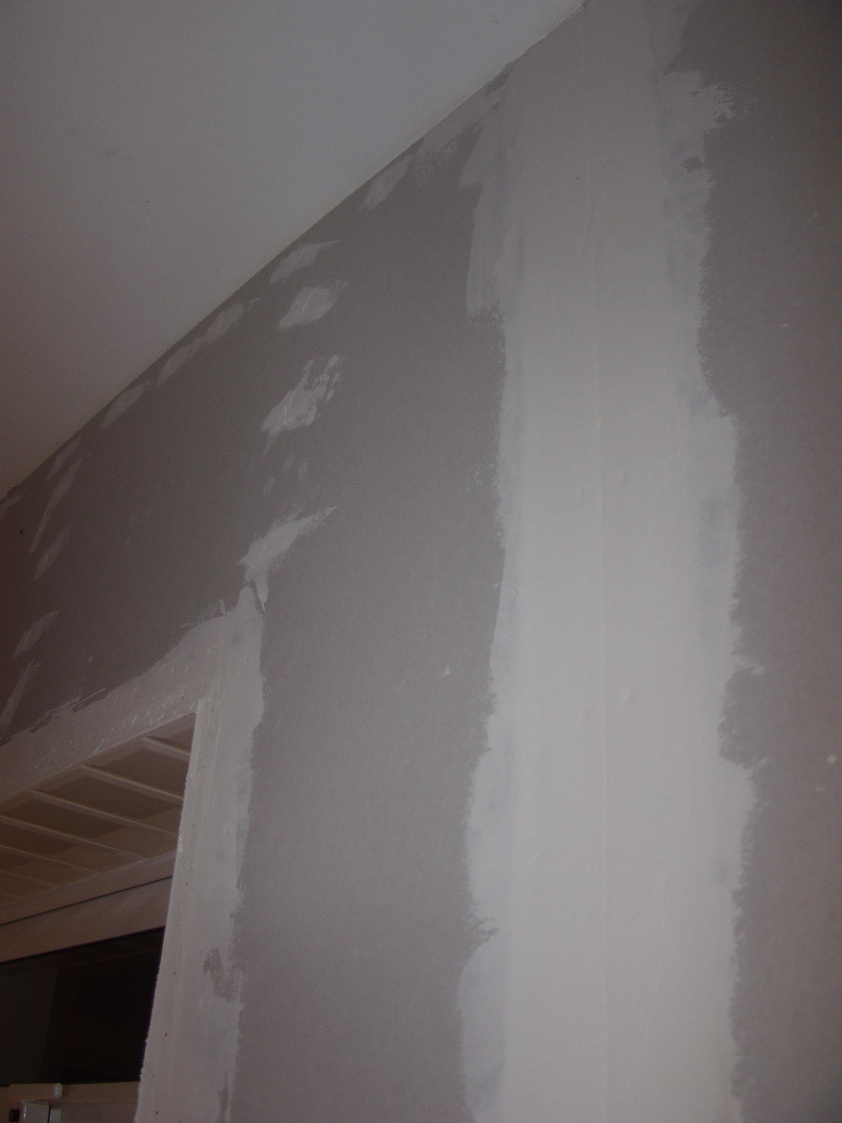

@PeterW the prob I have though Peter, is although I've no pB-meeting-pB corners (just pB meeting tiles) I have rough edges of the pB & some paper edges jutting up along here/ fallible. I can't use a upvc or metal corner, I don't think, as there is no room on the tile edge to fit it now I've tiled flush to the pB edge. I realise now this is a mistake, & I should've fitted the corners > tiled.. but my daft plan thinking I could get away as I've done (& just fill the edge gaps/ that'll do) has shown me up as an eejet here admittedly. So its a rescue job now the tiles are on. The only thing I can think is to get the upvc corners, cut half off (would have gone under tile edge) & fit solely to the pB edge.. if brave I could stanley knife a slim trench under tile edge, leave a few mm's of upvc on this side & tuck in.. hmm. -
Great help there Onoff.. yes the knauff stuff is 'joint filler' simple as, no 'premium' or anything.. a huge bag I'll have 4/5ths of it left. Isn't it too late to think of the corner strips now I've tiled up to them? I didn't realise they were so quick/ simple to fit or I'd have probably have done that before tiling (maybe I missed a link before- did you add the 'how to' link above, before?). I only have tiled corner > meets pB corners to consider.. no pB > pB (tho great info for future ref). cheers, zootH -

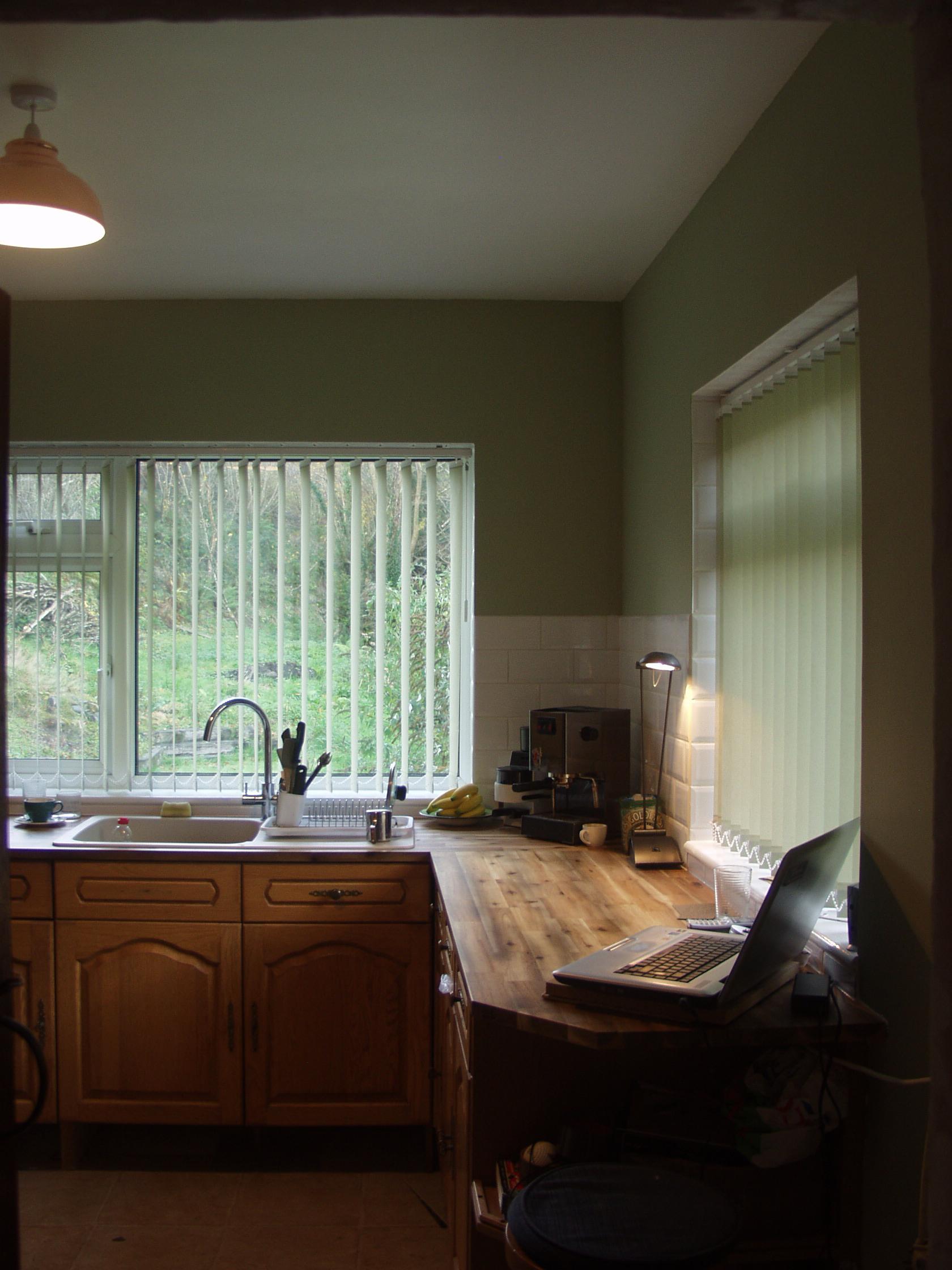

@newhome The tap seemed enormous without any stuff near it!! just hated it. Now I love it! haha. Mods- I'll pop a few pics up quick [these] then delete.. -

Ah nuts.. I think this one corner I grouted around edge of, onto the p/b, is 1st major mistake now you've said this. How I'm gonna sand this down as you say w'out ripping into the pB paper. Shoot. Other tile edges I'll polyfill I think Peter as its to hand now -that's good enough for me- as I made sure the tile adhesive went onto/ 'sealed' the exposed pB edges under the outer tile places. These edges were always going to be a compromise w'out going the mesh strip edge route/ too much for me tbh. I do have paper jutting up here & there so may have to feather some filler to prep these. Not ideal I must admit. But it'll pan out ok. -

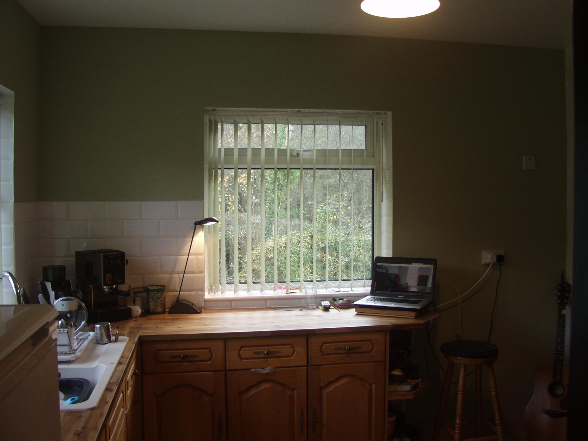

The offwhite grout idea was meant to be a match for the cream sink.. but falls between white & jasmine anyway/ that's getting too OCD anyway! Result on the sink. I moaned like abitch to Franke, & they kindly agreed & gave me £50 back. Franke sinks are ace. My tap's ace too (!). Its a major transformation even at 1/2 stage- so much more pleasant to be in here & use my new bits! Thanks alot chaps- zootH -

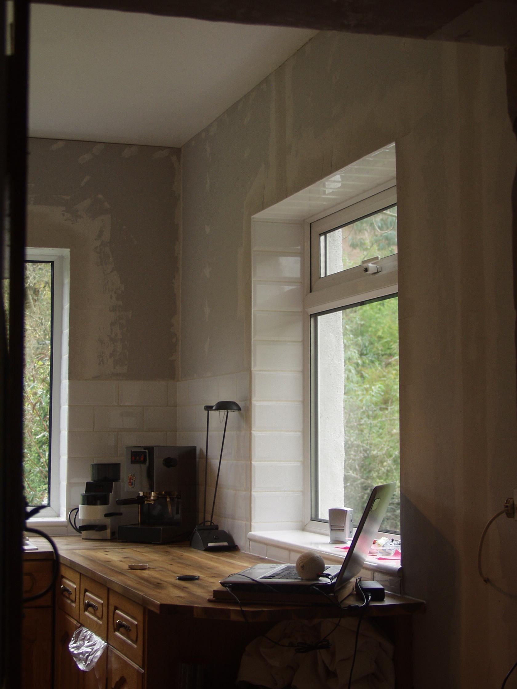

Update (paid work sudden influx/ hence delay to posts apologies.. not done a huge lot since either!) Good suggestions chaps- went with the board idea up quick after tiles whacked on underside.. seemed the way: so tiled the trickier kitchen side. -

If anyone's still actually alive reading this, ie not committed hari-kari.. Can the inside top of the reveal be tiled-? can tiles hold on upside down? I've thought of a way to reduce the faff of adding the upright corner pB metal strips (which in turn rules out the 'step' on the main pB wall face).. by tiling -all- the reveal 2 sides, plus above bit, right up to the main wall edge. If I use the grey adhesive right up to edge, adding it to the cut pB edges. Then I can just neatly fill/ finish off with grout. Then the main pB face can be painted right up to this edge. Is this a feasable idea? or do these cut pB edges need more 'suring up' than my tile adhesive + grout idea?
