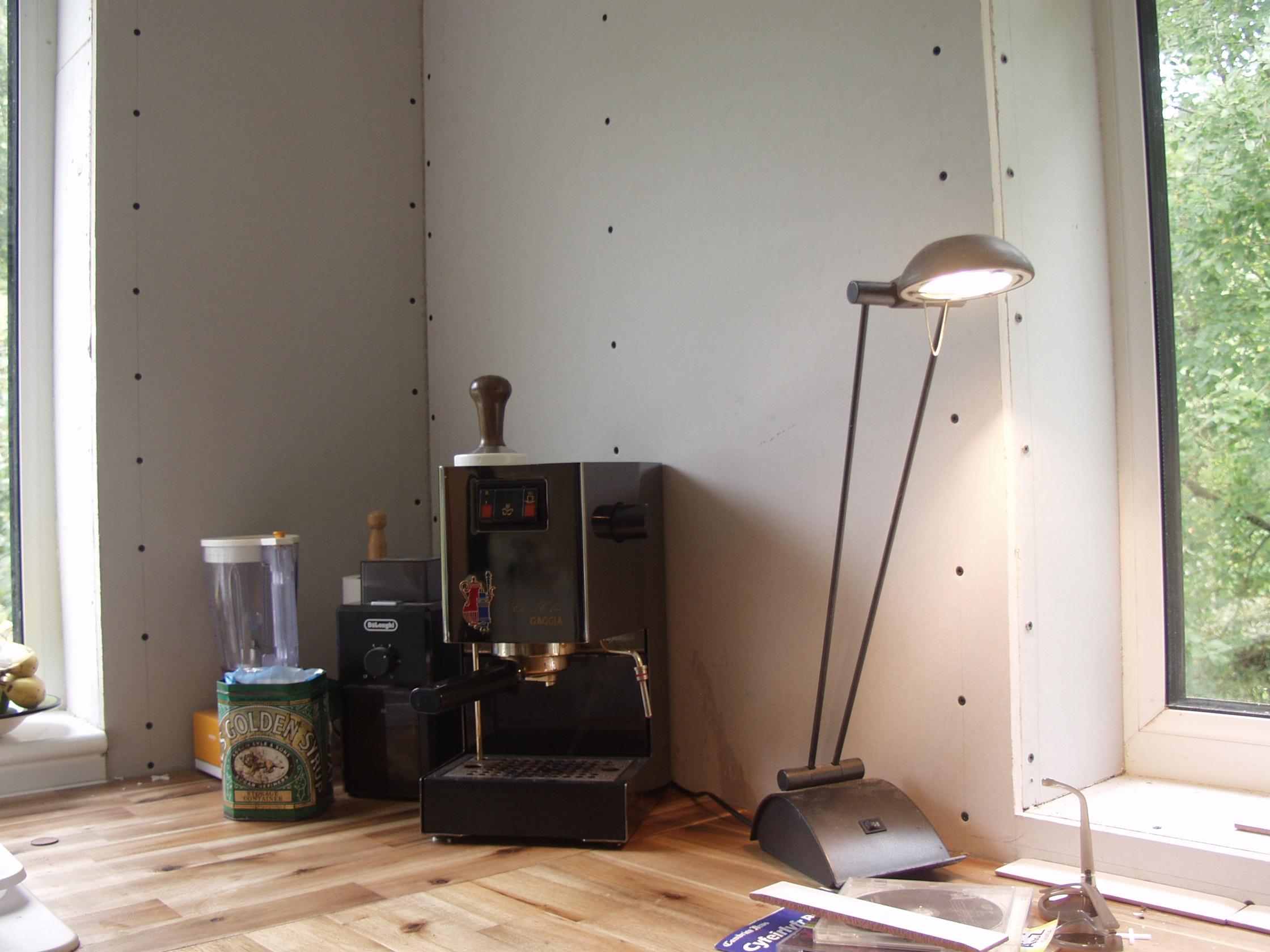

Shoot.. was hoping I wasn't going to need to prop xyz tiles up, this will be a major logistical job. I do have small brick 20x10 cm tiles.. so maybe, just maybe might be small enough to behave themselves up there w'out muggins interferring with any battens. Will do a test. Yes I'm going to have to be confident & do tile edges like so Onoff (now you've said its NOT such a daft idea): even if not perfect it'll be fine for me, here, if I put the effort in to get tile edges as best I can prior to finishing off. fingers x'd a bit tho.. but beats putting that edging on. I was dreading doing this & feathering out with plaster/ a job too far for me. Ok tiling bonanza afternoon commences. lordy.. Ive been making every excuse not to do this for 2 weeks!! -

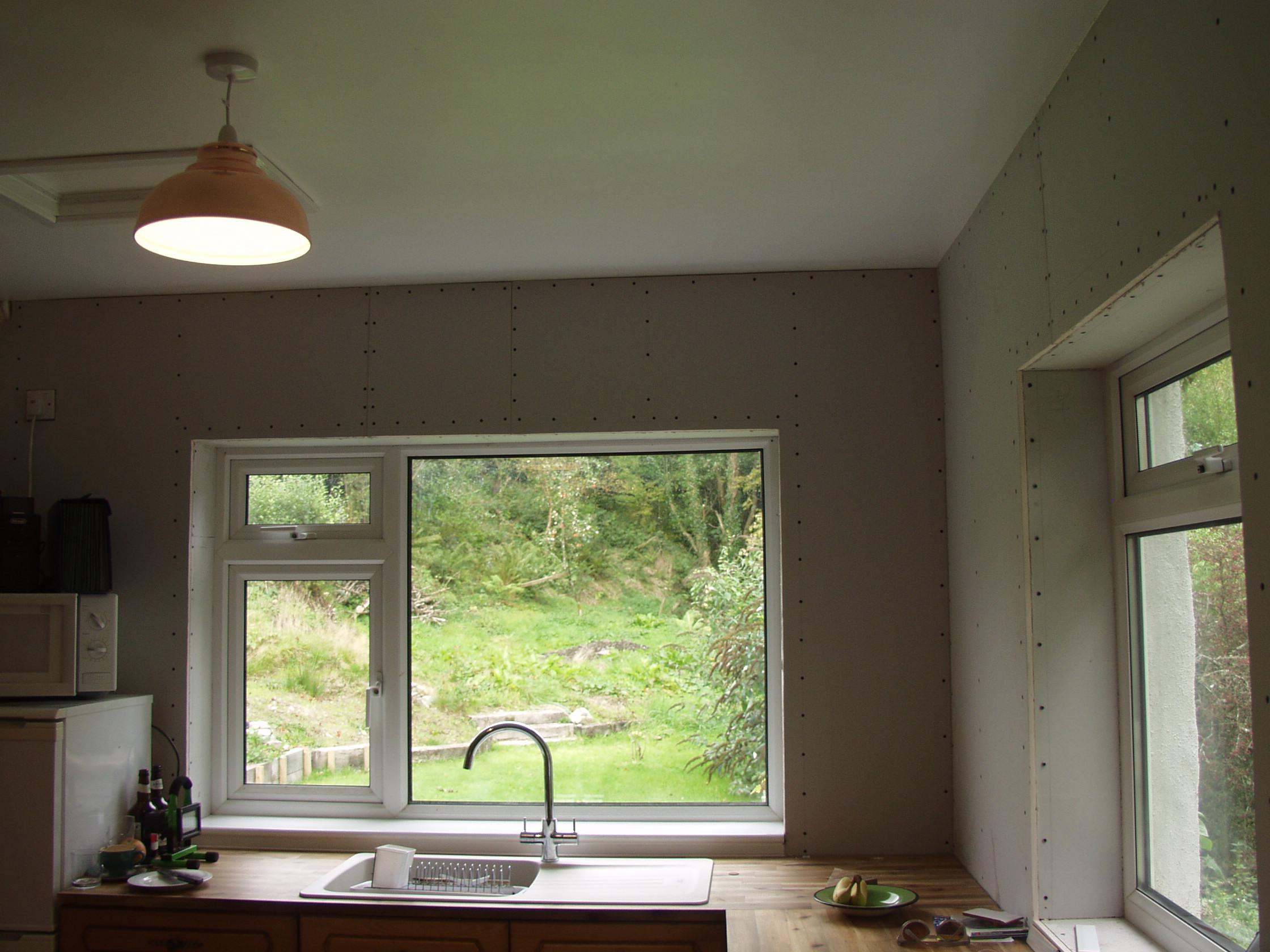

If anyone's still actually alive reading this, ie not committed hari-kari.. Can the inside top of the reveal be tiled-? can tiles hold on upside down? I've thought of a way to reduce the faff of adding the upright corner pB metal strips (which in turn rules out the 'step' on the main pB wall face).. by tiling -all- the reveal 2 sides, plus above bit, right up to the main wall edge. If I use the grey adhesive right up to edge, adding it to the cut pB edges. Then I can just neatly fill/ finish off with grout. Then the main pB face can be painted right up to this edge. Is this a feasable idea? or do these cut pB edges need more 'suring up' than my tile adhesive + grout idea? -

Great help thanks! I do like an onoff sketch in the morning.. Ok the thing I don't have, are both pB tapers @ the corner areas, where the reveal meets wall pB's. Both window reveals similar. So adding the plaster bead will cause a nasty step. I recall you saying I could feather-in this, back to the pB face (assuming I'm only filling the screw holes/ sanding flush/ = pB's done & prepped for painting: is that the grand-plan idea?**) I think I might do away with the tiling corner trims: although neater, I think a -major- faff for me to get right 1st time (especially the corner pieces). I used grout carefully moulded (& a quick job) to finish off edges of my bathroom tiles fine, in a 45* slope.. so could do same across the corner junction of the tiles (leaving a gap > fill with grout into a neat 45* angle).. & on the tops like my bathroom tiles. Maybe preferable to placcy too-? Can you just remind me though what the bigger picture is, re. **finishing off the pB itself? the last upper 3rd of reveals will still be bare pB.. & top too: I think its sensible to finish off these bits before tiling maybe, as you alluded to? -

@Onoff can you give me an idea how I finish the 3 sides of the reveal area: do these need finishing before the tiling of the corner area (simply the 2 big pB face areas above blender & gaggia)? I was thinking of tiling today, from the LHS vertical edge @ reveal here >> end on RHS vertical edge of the other sill, as I thought this simplest. But exactly where to start the very 1st tile (relative to the reveal edge, at Left, this -is- where I will start from).. I don't know. Set across the reveal edge 1cm? or flush with reveal edge? if flush then how the bare pB ends will be finished/ how much thickness this will add etc etc. I could tile the reveal.. but, I 'm only going up to 60cm of corner, which equates to 2/3rds way up reveal (if I follow this tile top line around).. so what happens to this last 1/3rd of bare pB reveal sides, & upper reveal section.. also as you can see the sink reveal side has a bad convex 'bow' half way up, so I think tiling this out might be tricky. -

Anyone know how to plan the tiling for this corner area with 2 windows either side? I'm using 20x10cm tiles in brick pattern. thanks, zoot -
