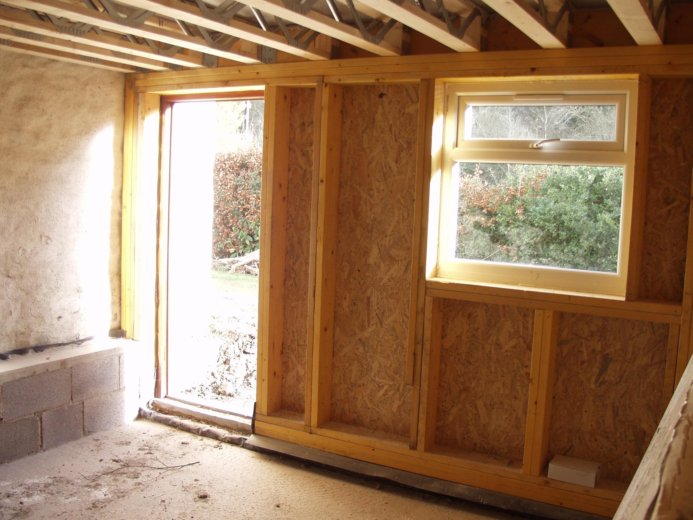

  2. So what's the way to go here. I need to establish: do I put in rockwool before electrician runs cable within/ across joists: can I fill the 'cavity' of the actual joists (pic below): what rockwool, as I have to cut it bang on 1/2 point (of 600mm width).. IE if cutting is an issue/ nasty job etc. I have 4200mm x 3800mm total ceiling (wall to wall). Joists are 100mm width. Gaps between joists are 300mm W. The height of my gaps, is 205mm.. so I could squash in 200mm slab, but then hasn't the electrician not got ample room to work? also means slight pressure on the pB (a tricky job as it is, me + someone to do ceiling). So I might go for 140mm or 180mm rockwool. Thanks, zoot

  11. Possibly not. But it didn't stop first a very stressful letter -potentially- threatening xyz.. & also a follow up council visit here. As council/ police have to follow up any complaint with a visit, my n'bors take advantage of it: more than 2 couples consistantly over 2.5 yrs instigating visits from every single dept they can think of, soley to cause me stress, less that they'd actually likely get any results. And it works. Every time the doorbell rings I get depressed/ dread fills me, another council man? they even got police visit me only weeks ago (due to my damn builder). And they think each is perfectly justified too. So in order to live here with as much relaxation as I can (not alot tbh) I need to mitigate against council visits, as best I can.
