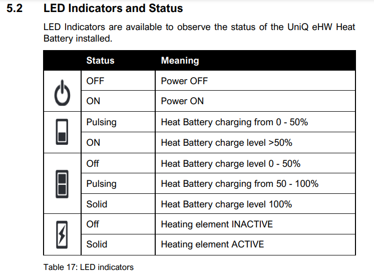

This will be a very welcome addition to these Sunamps and long overdue. Too late for the ones of us here who still have little idea as to the charge status on the older(er) units. The controller is now also built into the main unit rather than a box on its own.
- 3
