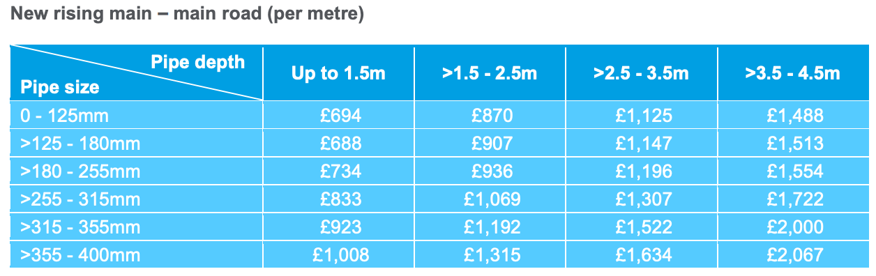

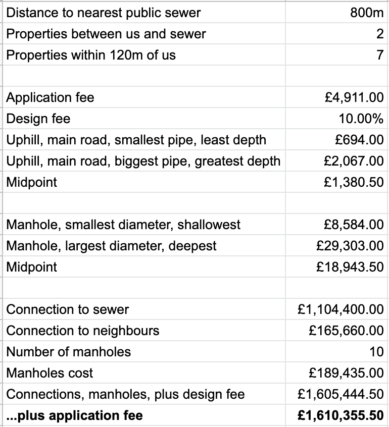

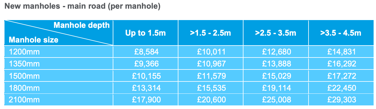

Thanks folks! Using the data from the Southern Water PDF, the midpoints on prices (I've no idea how wide or deep the pipes would need to be), and @Conor's estimate of 10 manholes, it comes out at the rather eye-watering £1.6m. Probably not practical! As for the recommendations about treatment plants - thanks, we've considered that. We're in groundwater source protection zone 1 which precludes any sort of discharge whatsoever without an Environment Agency permit. I'm planning on applying for one of those, but we're struggling to find space for the required drainage fields and so wanted to sense-check other options. -

Thanks @Conor, I really appreciate even a rough ballpark figure. I'm so new to all this, that I had no idea how many zeroes to be thinking about I've just found a guide to connection charges from the appropriate water company, so I'm going to wang some numbers in a spreadsheet and update the thread when I've got a better idea. Your estimate will give me confidence as to whether I'm reading the right document and understanding it at all -
Has anyone got any data points that they'd be willing to share on how ridiculously expensive it would be to connect to a public foul water sewer 800m away? The shortest distance to said sewer is a straight line along which a road runs, which may or may not make things harder or more expensive! My instinct is that the costs would be exorbitant, but there's a few houses all paying to empty cesspools regularly, so maybe there's some possibility to all chip in or something.
