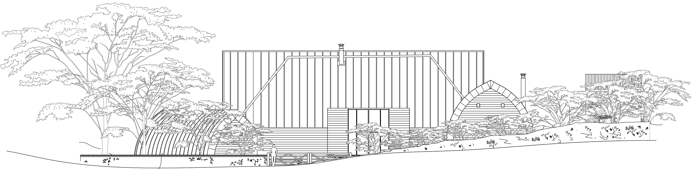

Sorry @Countryfile - I haven't checked in here for ages. Our initial proposal to make pretty drastic changes to the barn was rejected at committee on heritage grounds. The latest structural survey we've had done (third one now?) is more optimistic, and we've gone through every single timber assessing its heritage and structural value. We're hoping to get a new application submitted in the next month or two, but we've got a drainage challenge now.

Thanks for the consideration of my position, it was kind of you to defer posting. If only more people on the internet thought about the impact on the reader before posting You're absolutely correct about the massing, and that was something we were conscious of. From the road it appears 19% larger, which I'm not sure whether they'd consider significant or not. The planning committee didn't comment on that; they were more focused on the shape. The report did mention the greater visual impact, although it wasn't their leading argument. In my head the decision was "So it'll be more eco-friendly, cheaper, and give us more house? Worth a try!" Paragraph 197 of the NPPF basically says that any harm to an NDHA needs to be a balanced judgement. We were hoping that the BNG and eco credentials would be enough to tilt that balance in our favour. There have been examples of NDHAs in conservations areas being approved for demolition, so my line of thinking was "if there's nothing explicitly saying that this is unpossible, let's push the issue to find out for sure, rather than just accepting 'no chance, mate'." I wanted to prove empirically that it wasn't possible, rather than take someone else's word for it. It was a calculated gamble in which I staked money and time, and always knew it was a long shot. Gotta try with 100% effort to find out for sure, though. I used to do some martial arts, and I was told about some likely mistranslated apocryphal Japanese concepts: issen and mushin. The first can mean "single strike of lightning:" you act with 100% conviction, committing utterly to what you're doing. The latter means "empty/remaining mind", meaning that you're open to whatever happens without expectations. Combining the two is complementary but contradictory, and means going at everything full tilt, but rolling with the punches when things don't go your way. So this was a bit like that Again, thanks for the thoughts, and hopefully this journey and everyone's comments can be a useful learning for others thinking along similar lines. -

The threshing barn is a non-designated heritage asset. We proposed changing the external appearance, basically wrapping the core timber frame (the 'goal posts' that are characteristic of threshing barns) in curved crucks so we can use straw bales in the walls and roof, kinda like the stone arch in a bridge. We pledged to retain those core, historic members of the timber frame, but we weren't specific enough on what exactly would be kept. If we had been more specific, they probably would have still rejected it. We didn't provide an engineer's report, for a few reasons. First, we actually forgot to submit the one we'd paid for! It was however quite vague, and not terribly optimistic. The second reason is that the prior structural survey from the previously-approved scheme was tediously detailed, and we kinda thought it might not be necessary to supersede it (it did however accuse the rafters and purlins of being worthy of retention, when they're all modern softwood). Finally, our preferred oak framer basically said "you can say that you'll retain this, that and the other, but until we actually get in there we just won't know." I know it sounds a bit daft not supplying it, but we did provide around 40 documents, and I triple-checked my document submissions. Only problem is that I didn't double-check that the checklist was correct đ We'd need to modify the entire scheme, not changing the roof or shape, which in turn precludes the Huff Puff straw bale construction method. Hence the next application will be radically different. We've received pre-app advice on the next scheme, and it's not been great - the Ministry Of No were on full power that day. The danged AONB seemed insistent on getting us to put Kent Peg clay tiles on, despite the building not having had them for decades. Meanwhile, we're not allowed to reinstate the hipped wagon porch because it's been absent for decades đ¤ˇââī¸ TBH, it's all getting a bit awkward with the fact that if we ever get to build anything, the kids will soon be too old to live with us. We've not discussed what we want our lives to be once the kids move out. We've been putting off spending on holidays and stuff to save for the build, so the kids have been missing out for the sake of a building that they might never get to live in âšī¸ -
