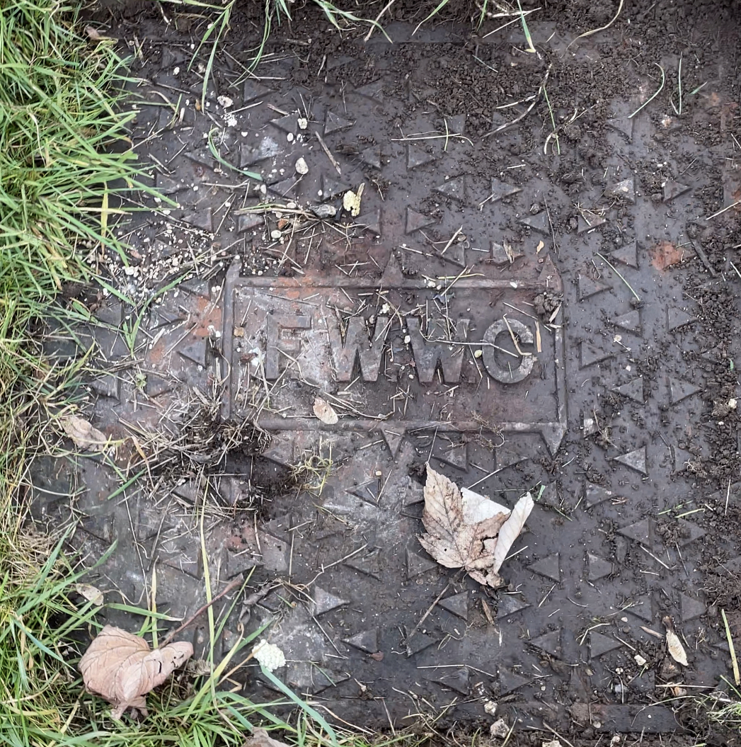

  10. I can only assume that nobody proof-read the manhole covers
  11. Ha! Ooh, good shout. Having lifted the thing, it appears to be a brick-lined weir for surface water, that then discharges into a pipe under a road, and finally infiltrates under a field (I think). No idea what the acronym might be, but it seems to be serving that purpose. Yeah, it doesn't match any extant water companies, but it is close to Folkestone. Folkestone Waste Water Company? Sounds plausible. No-one seems to know that it exists, or where it leads - Southern Water (the sewage company for the area) don't have it on record, National Highways don't have it on record, and Dover District Council only know that there's a gulley which they empty, but otherwise have zero information. Funny how this stuff gets lost to time!
  12. Does anyone know what F.W.W.C. might stand for on a manhole cover over a roadside surface water sewer?

  24. The plot already had planning permission granted with later delivery and approval of a drainage strategy as a planning condition. I mentioned that we're in groundwater source protection zone 1, so a cesspool is the only acceptable option without an EA permit - thus it's highly likely to get planning permission. Getting back on topic to the original question, the drain/ditch/gulley isn't owned by Southern Water, nor National Highways, but Kent County Council. They have confirmed that they hold no details on it whatsoever other than there are two gullies that they are responsible for occasionally clearing. Hence, this has gone as far as it can without getting surveys done at my own expense.
