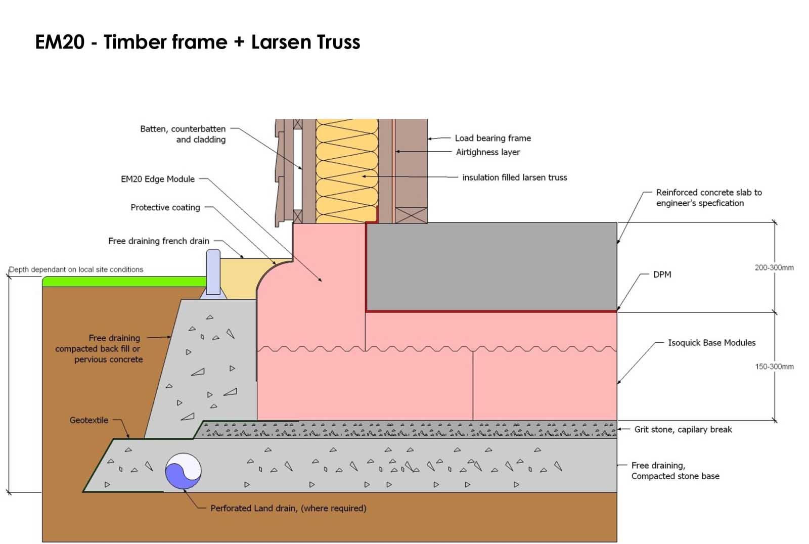

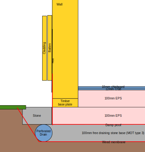

Thanks all - some really interesting points. The building will be an insulated garden room - for a garden office or children's play room. Building control would not be required. I can get a digger on site but not ready-mix concrete. It is on a slope, but I don't that overly relevant for this discussion. A suspended floor design (on pads or ground screws) would be the simpler solution and is what I designed and got approved for my planning permission (in order to be taller than permitted development allows). For aesthetic reasons I'm keen not to bring the building up higher than I need to, hence exploring other options. I come on this forum because the wisdom should put my mind at rest that I've tried and failed to find a better solution or to give me the confidence to proceed! My question is also partly theoretical. I'm aware of 'passive foundation' designs (diagram below) which are very similar to my diagram above but with the addition of a reinforced concrete slab above the insulation - even if access was easy is this necessary? It adds rigidity to the base of the the building (preventing lateral movement but I don't feel this to be an issue) and adds mass (reducing rocking/lifting, which might be an issue). I am concerned by the lifting/rocking issue. I don't think the increased rigidity of this concrete slab would help, as the weight would still be on a point if it rocked. It would add mass but only about 6 tonnes if 100mm thick - so not sure it would substantially change the situation.
I've read what I can on this and did ask on the forum some years back but shall now try on my own thread. I want to build a smallish (c. 4 metre square) garden room, single story and timber construction. This style of building is often built without conventional foundations, maybe on 'shed base' or paving slabs. I'm curious about the following design which has no concrete. I’ve consider the potential issues with this design which might not be present with conventional foundations, a passive slabs or a suspended floor. I've identified the following potential issues: The floor is unsupported: This is a somewhat standard floating floor arrangement and might have a little bit of a spring to it. The EPS under the walls could be compressed: It takes 45kn/sqm to compress EPS100 1%. The 145mm wide base plate around the perimeter has a surface area of 2.2sqm so if the building weighed 10 tonnes this would reach that level of pressure and compress the 100mm EPS to 99mm. I think the whole building will be significantly lighter than this. I know passive slabs often specify higher grade EPS but that would seem unnecessary for a light weight building. The walls could distort laterally: This is the same as a timber frame building on dwarf brick walls. Additionally the top EPS layer would prevent the walls moving inwards. If this was considered a risk the walls could be fixed to the flooring or the base plate could be connected to a strap between the EPS layers. Am I missing something - why wouldn’t this be a good idea?
Insulated Concrete Slab Garden Office - Questions

In the context of a small single story lightweight timber frame and lightweight roof, what would be the purpose of the concrete ring beam? I note viking-house have many examples where the ring beam is separated from the floor slab. I also like Moonshine's suggest of flooring directly onto insulation. I'm wondering if it would be possible to put the timber frame directly onto EPS and do without any concrete. -

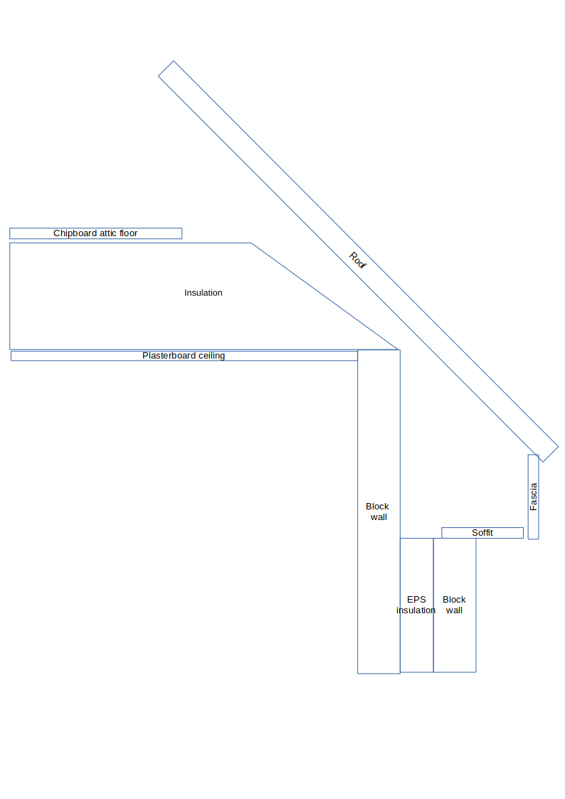

How to retrofit insulation at intersection of cavity and ceiling
sam replied to sam's topic in Heat Insulation
Thanks for the suggestions. I came to discover the issue as I intended to improve the ventilation into the attic, so agree that I need to address these together. -

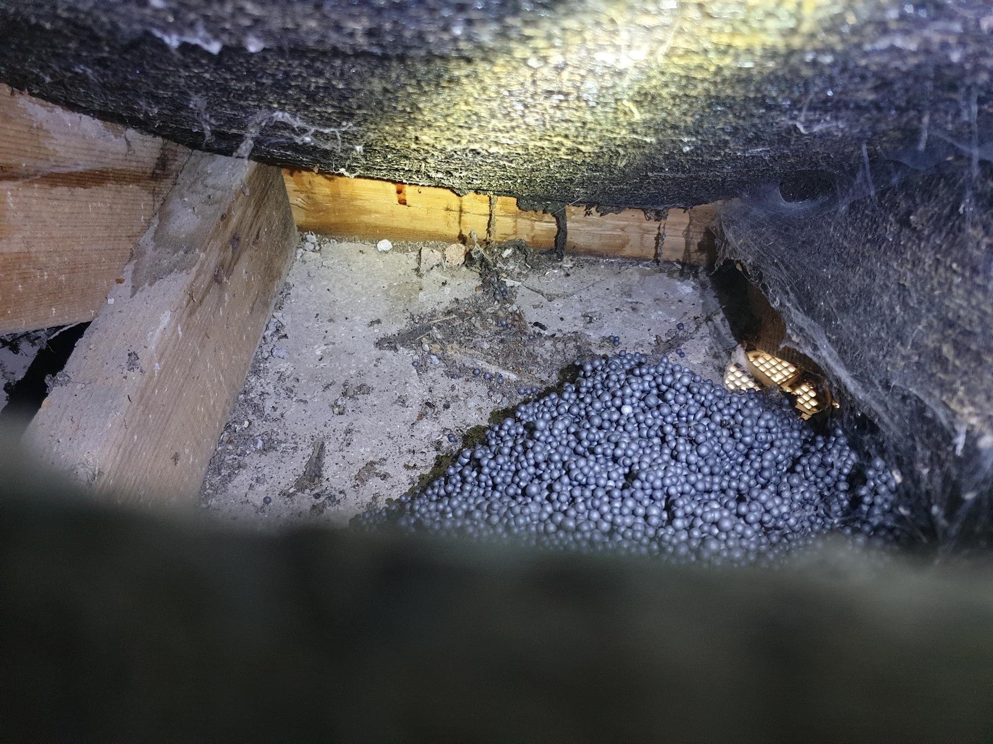

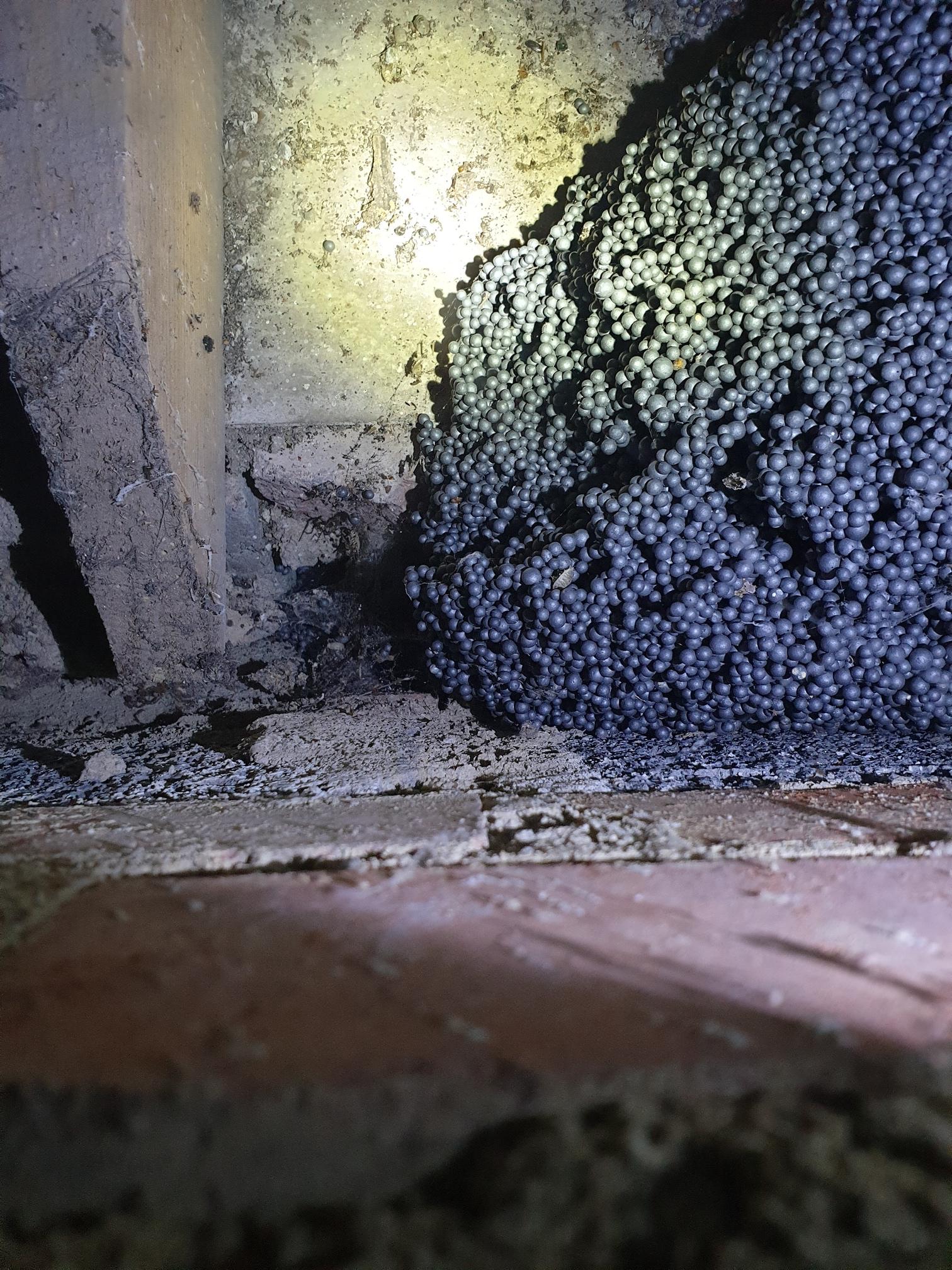

My 1950s block-cavity-block two story house had EPS beads injected into the cavity. I've recently discovered that the outer wall is c. 400mm shorter than the inner wall and the cavity is open to the eaves void and the loft. This means that the top of the wall is not insulated. Is this common? Any suggestions for insulating this area? The gap between the inner wall and the roof is small (c. 50mm), meaning it's hard to access this area.

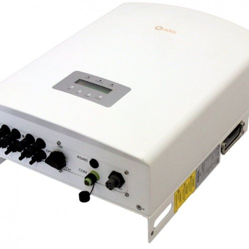

Thanks again for the useful posts. Where in the system is the official meter used for FIT and Export payments? Is it possible to use this data or is it not in a useful format or sufficiently real time for this? The Ginlong Solis inverter (and many others I believe) has a RS485 interface and a 'COM' interface. A wifi (or ethernet or GPRS) connector can be purchased. Does anyone have experience using this to get production data or again is this not in useful?
Thanks for the useful replies. At this stage I'm wondering if there is anything which is sensible to install at the same time as the panels and inverter. Can you recommend the meter chip? I'll read up on your code but at the moment my actual coding and immersion/heat pump controller side of things can come later!
Thanks @ragg987; what I'm hoping to do is be able to access the data to program other devices, rather than just view it. Do you know if that is possible with the solaredge setup?
I'm expecting to get PV installed shortly and wanted advice on anything sensible to install at the same time to assist with production monitoring. I'd like to be able to monitor the PV production and export in order to maximise my usage. I know that there are commercial systems to control immersion heaters but more likely I'd build something using Arduino (or something similar) like I think @ProDave and @JSHarris have mentioned they have done. At this stage I'm asking if there is anything I should consider installing near the inverter or meter to be able to capture the necessary data. I know I could get a clip on power meter which could easily be retro fitted but I was wondering if some kind of meter was more useful or easier to export the data from in an accessible form. I currently have a digital E7 non-smart meter and expect to have a Solis inverter. I know that Solis sell a wifi or ethernet adapter but I'm not sure if the data from this is accessible.
