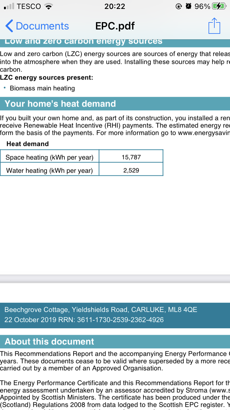

  8. Still trying to get my head around all this, heard back from Hetas today, wanting me and the installer to communicate with each other so I have answered his email questions. However it was still annoying me what @PeterW had said about the figures on the EPC so I did some digging around online and found a post by a man who does EPCs. He said he had a few complaints from people regarding their kwh figures and at first he suspected they wanted the figures to be higher so that they would get paid more through the RHI scheme however he contacted a colleague who did heat load calculations for installers and he soon discovered where the discrepancies lay. He states that installers have to calculate on a worst case scenario,so they have to make a calculation that assumes the heating will be on 24/7 365 days a year, he also says that the RHI would never pay you for this as they prefer to pay some money to a lot of people rather than a lot of money to a few people so the calculations for RHI payments are not a true picture of your heat demand and are just taken as an average. So this left me thinking that the two figures on my EPC would always be conflicting. Considering the installer never saw this EPC it makes me wonder if he didn’t do any calculations at all for this house and took a guess based on previous similar sized properties that received RHI payments.

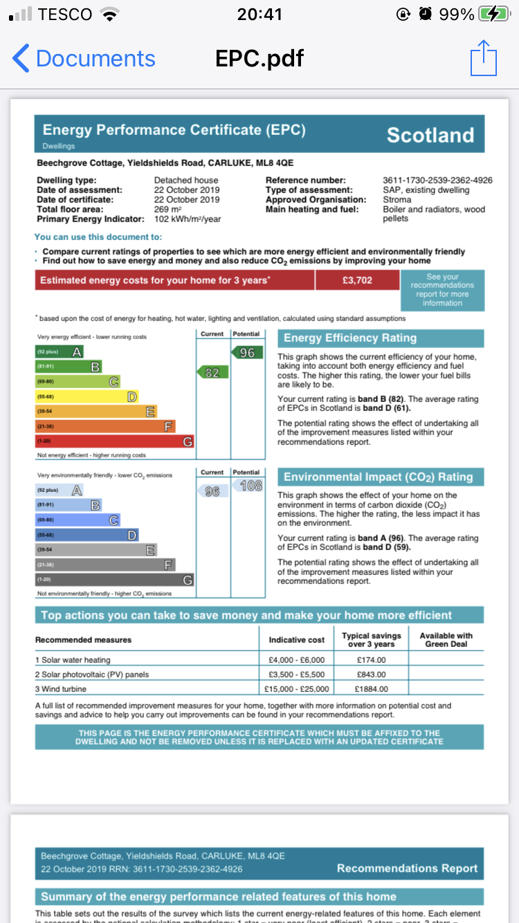

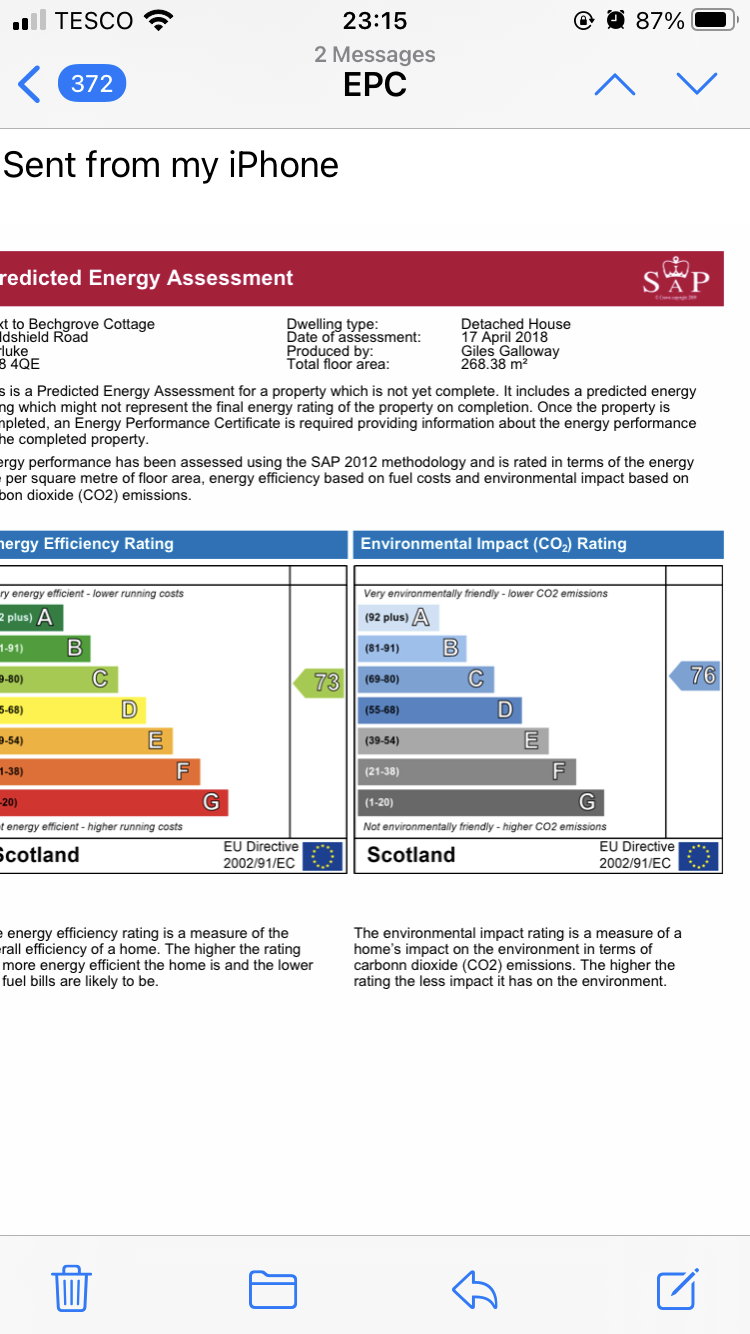

  13. I think iirc he wanted the epc before he started the job. At that point we had an epc that was what the house was expected to be if built as specced, after it was installed and details given to the person who was doing the epc we got the as built EPC which then gave the RHI figure . This was the one he was given
  14. I’ve been looking it up, I can make a complaint through the mcs scheme, if what @SteamyTea says is right he should have made calculations for each room which looks like he never did, he was always in a hurry! He even forgot to register it with the scheme at the time it was installed and it was only one I applied for the RHI payments that I discovered that and he had to do some jiggery pokery to get it registered. I now believe he has known all along that it wasn’t going to do the job but has just been fobbing us off and making it look like we didn’t know how to operate it. I have a bee in my bonnet now and need to do something, I’ve spent all day checking the tank , turning heating off then waiting till the tank got up before turning it back on, it’s costing us over £300 a month to keep it going which wouldn’t be so bad if it was giving off a good heat but realistically the upstairs bedrooms are unusable!
  15. Well I definitely don’t have that , but I do have this
  16. Thanks @PeterW I can follow what you’re saying to a degree (definitely not as technically minded as yourself!) so my next question is; who made the mistake? if I handed this epc to the installer and he just looked at the bottom part RHI number without doing the calculations that you have done, is he at fault? Or is the person who did the epc at fault? The installer had all the house plans as well as the epc so should he have done an independent calculation? Has he been lax in just reading the bottom number? in other words who the hell do I go after??

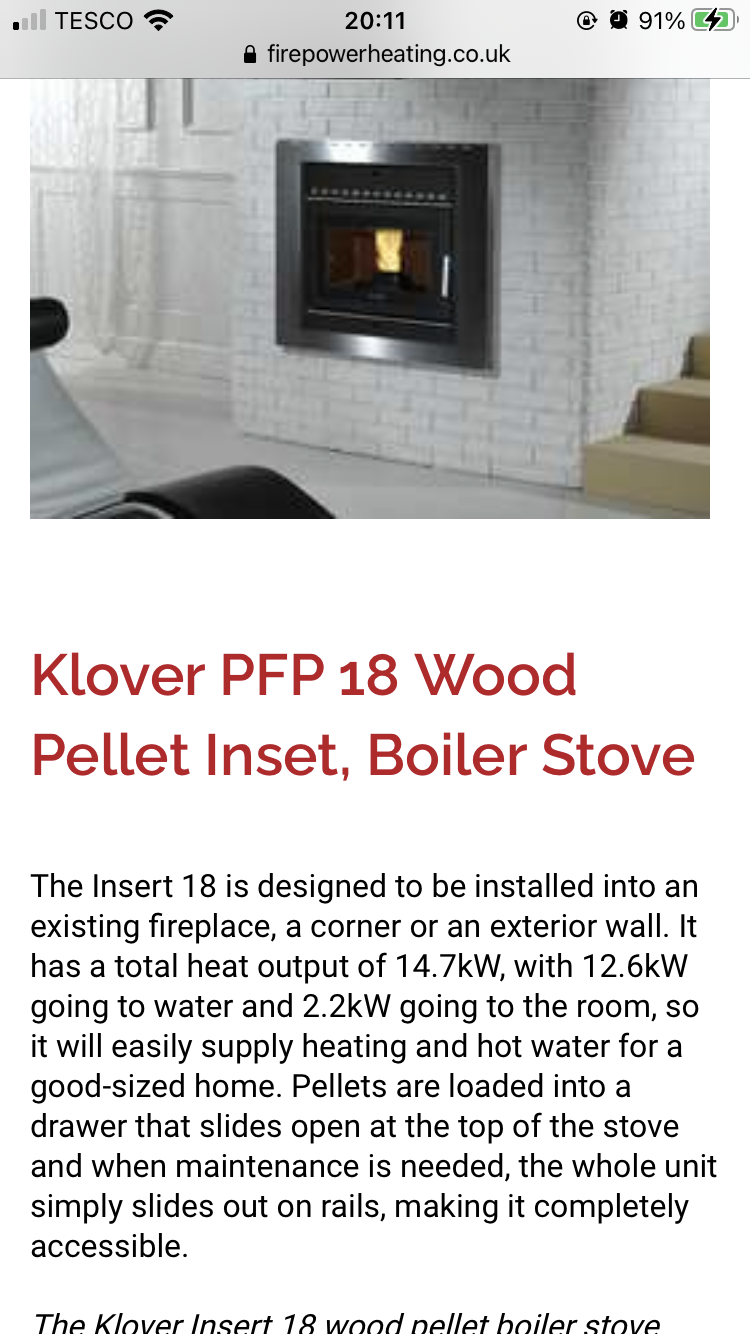

  17. So today has been really cold, a freezing fog that hasn’t lifted all day.Really struggling to get the heat up in the house, have spent most of the day tank watching, it heats up to its temperature but as soon as a couple of zones call for heat within half an hour the tank is down to about 29 degrees top and bottom, at this point there’s no point in leaving the ufh on as the water isn’t hot enough to heat it and I know the fire will burn all day but never getting the tank up to temperature. I have looked at the epc and it says heat loss is 18.15kw . I have also looked at the spec of the burner and found that despite the installer telling us it was 18kw it is in fact 14.7kw with 2.2 going to the room and 12.5 to the thermal store. Something is not adding up here, I sent the installer an email between Xmas and new year telling him we were still having problems, I knew he was not working at this point but wanted to register the complaint as quickly as possible before our warranty runs out this month, of course he hasn’t answered! I have tonight sent an email to firepower heating who are the distributor in this country and told them about all the trouble we are having and I’ve also said I suspect the installer has made a mistake on the spec and that we should have had the larger stove. I will see what response I get from them , I don’t know what else to do but was wondering if the energy savings trust would have anything to say about this since the installer is on their mcs list and also that we got the interest free loan from them for installation. Or do I get an independent engineer to have a look and end up going to a lawyer with it, I just feel I am going to be paying back this loan long after the appliance is binned!
