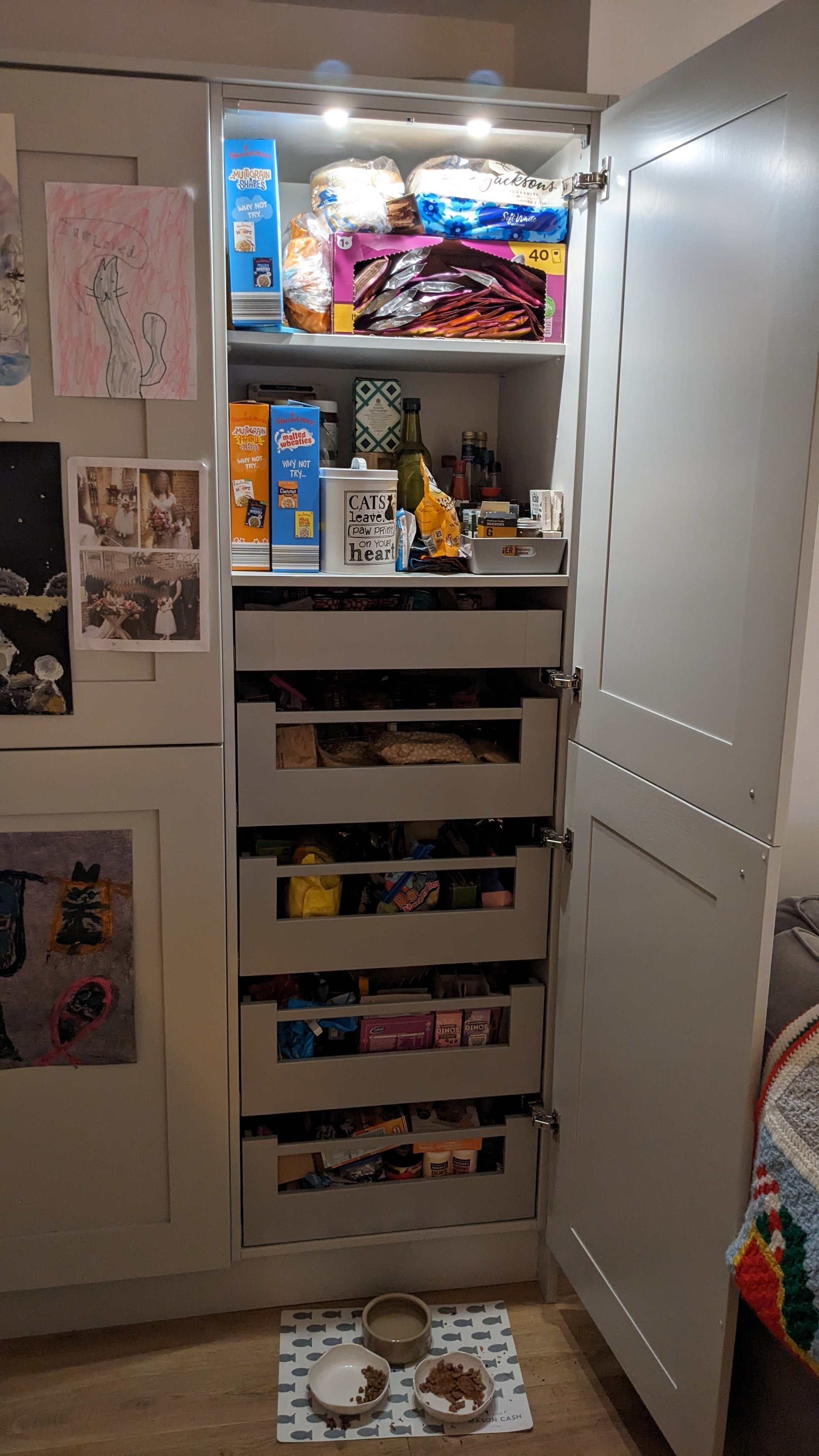

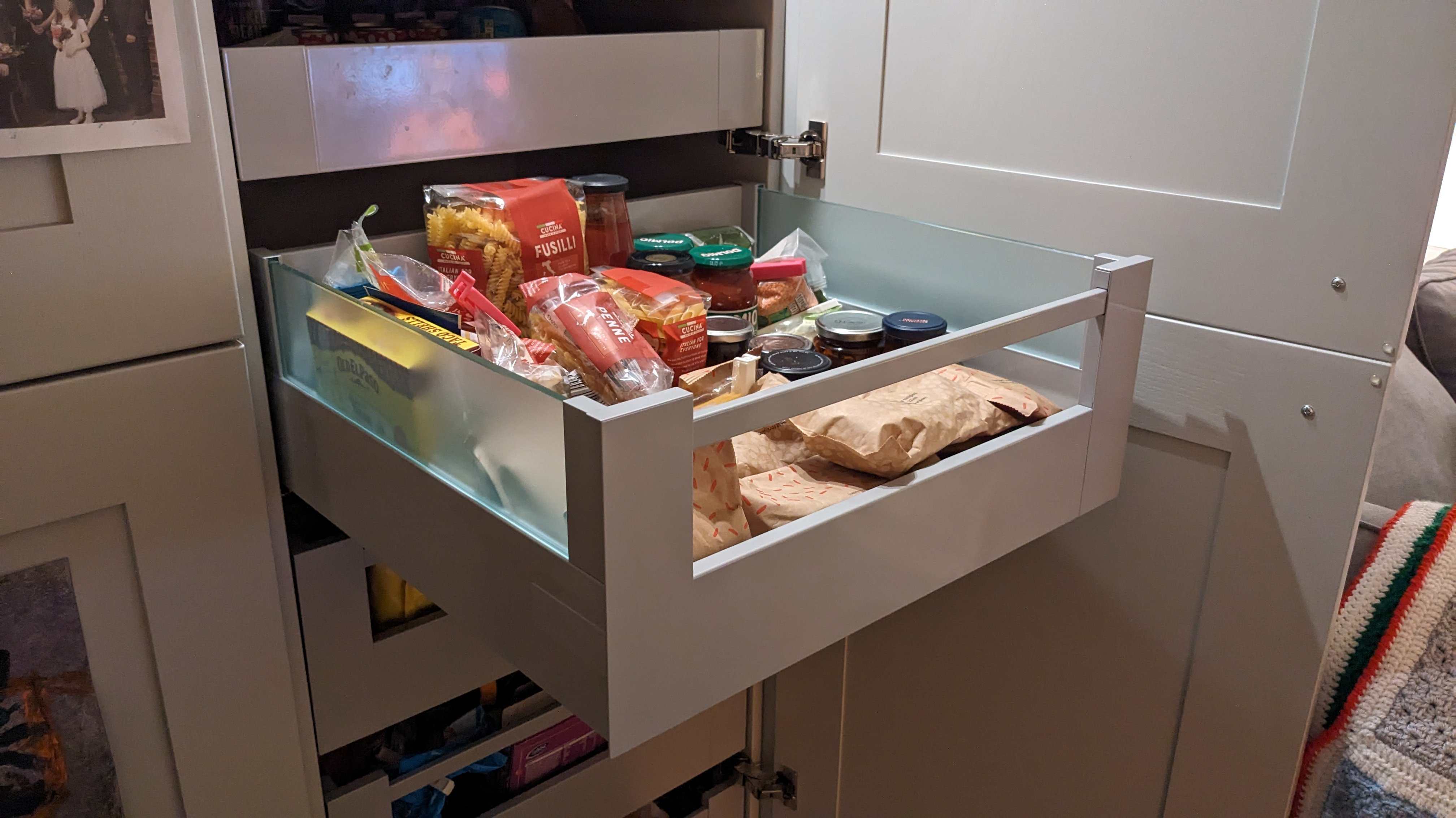

We spent ages - months in fact(!) - debating what option to go for for our 600mm larder unit and there was something about the wire frame pullouts that seemed less than ideal. Whether it was the amount of space it took up, having to pull out far more than what you actually need, reaching over things to get stuff out from the back, I don't know. We then stumbled across the much simpler approach of using full-width and fully-opening deep drawers for the section below eye level and open shelves above. There's also a shallow drawer for tins (a lot of tins - must be over 50). We've lived with it for a few years now and wouldn't change a thing about it. The drawers obviously work much better than the shelves, but we just make sure the rarely-needed items are located at the back on the latter. With drawers it doesn't matter as everything is equally accessible. (Forgive the rather messy shelves - I've just taken these photos following a whole bunch of shopping being thrown in today... I'm sure it could be dressed better!)
