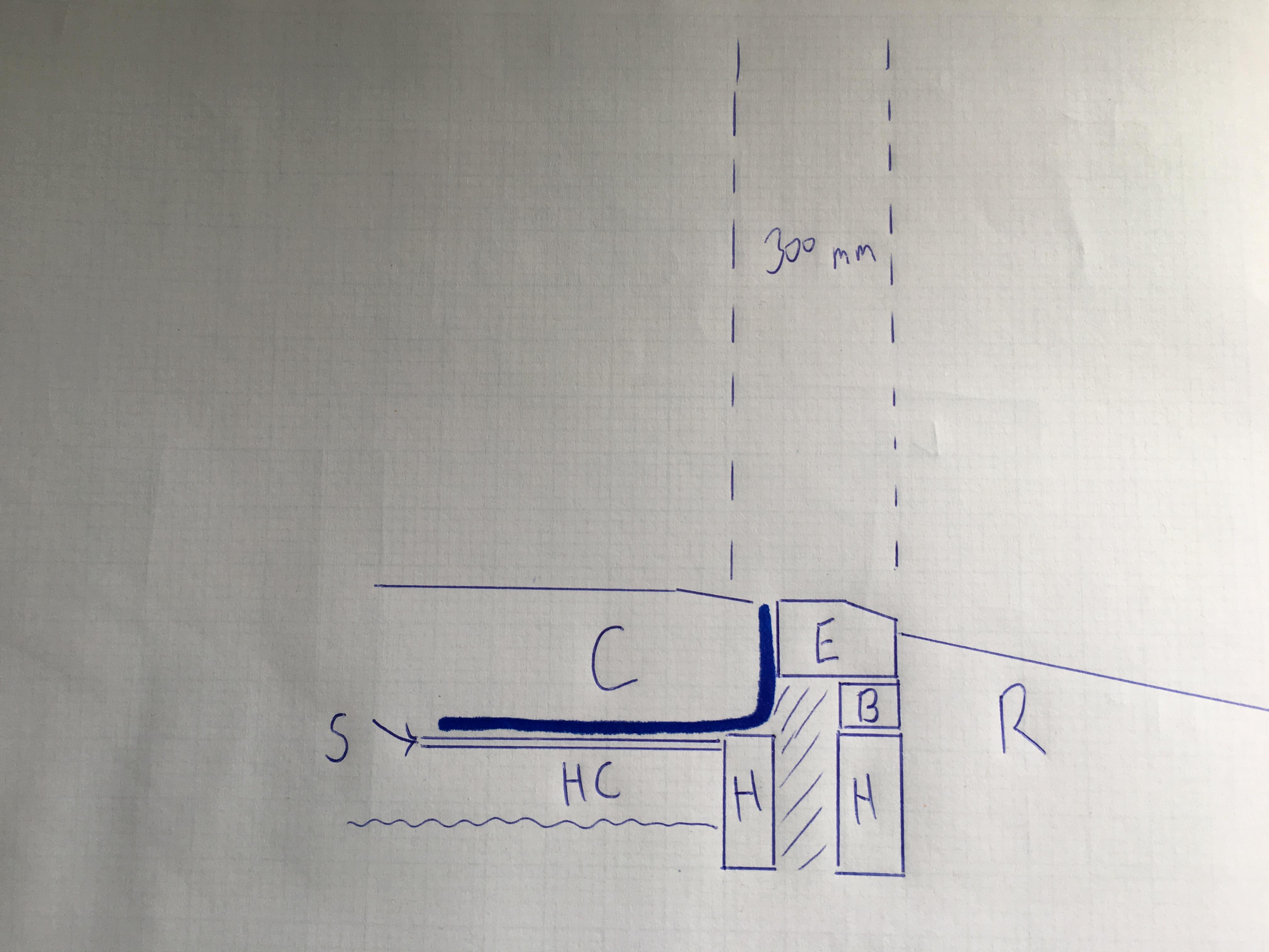

I intend to use grey edging blocks along the garage door entrance and I am debating where the dpm under the floor slab should end at the point where the slab edge meets the entrance edging blocks. In the attached diagram: E = edging block 200mm deep, 100mm high at the leading edge and 125 high where the block meets the slab. C = poured concrete slab. HC = hardcore S = Sand blinding B = coursing block H = Heavy concrete foundation block R = Approach ramp in 2" clean limestone with dressing chippings on top Hashed area is strong concrete cavity fill. My concern is that the edging blocks might wobble loose under the traction vehicle tires. To reduce that risk I would prefer to have a mortar joint between the blocks and the leading face of the concrete slab. That however would allow moisture ingress into the slab. It is a single story garage with a typical roof overhang. Where should the dpm membrane shown in the thick blue felt end at the door threshold?
