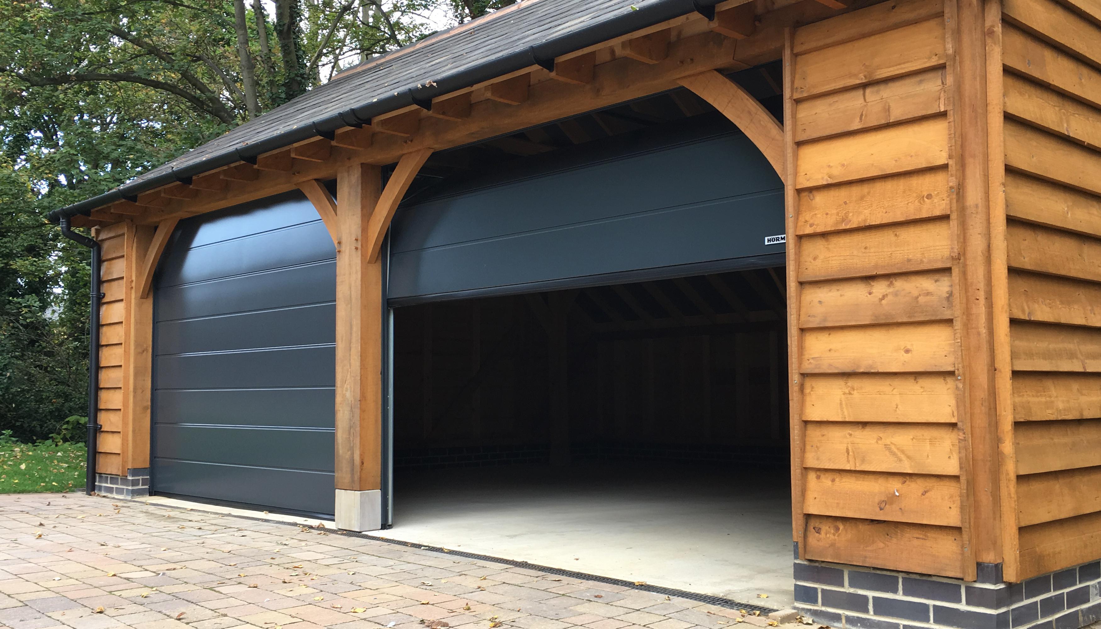

  1. In the end I chose paint grade Hemelites for the car port section of the garage, at 14kg per block they are at the upper end of medium blocks and much denser than Fibolites at 8kg per block. The Fibolites will be used for the inner cavity where it will be finished as dry lined plasterboard.
  2. New task created at position 57 on the list. The garage door faces due south so this wood will dry out under the single story roof overhang.
  3. The oak is quite fresh, it is cheap because it is a by product of another commercial activity.
  4. Ok I can picture all that coming together, would I be correct in thinking that the 8mm stud in the oversized 10mm holes in the oak provides enough free play to accommodate movement in the wood without stressing the blockwork?
  5. I am considering some decorative embellishments to my currently in-build plain brick & block garage. The intention is to retain the essential masonry structure for all 4 walls but to frame the garage door entrance with an oak frame goalpost and then clad that wall in horizontal feather board. So far I have been warned off trying to incorporate the oak frame as a structural element because as it moves there is a risk it will stress the block work at attachment points. Can someone offer tips on how to flexibly mount the goal post at the doorway? I have a source of cheap green oak 200mm square in cross section which would be heavy enough to kill someone if it peeled away from the garage wall. Here is an example of the end result I am after, though just a single door in my case. More info: The garage has standard 100mm cavity walls and I expect the rafters will rest on the inner wall over the door with a lintel across the span.
